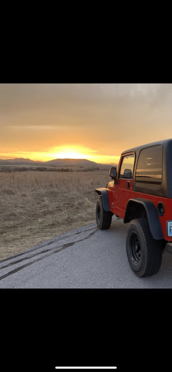

I installed a RC lift kit on my 05 TJ around 2 years ago, I am fed up with the lift. The ride is bumpy the kit said 3.25” of lift, but seems more like 2.5” lift. The springs seemed to sag right from the start. I am now in the market for a better lift kit. I am trying to decided between short arm or long arm? Brands? Heights? I do a lot of road trips in my Jeep so I want something that I can daily drive and then take out during the summer and winter to hit the trials. I am also planing for a roof rack and rooftop tent. On top of that I am saving for all the modifications needed to run 35” tires so I want a lift that is capable of that. I don’t mind running a set of metalcloak fenders to gain more clearance. Im nervous to go too high and have the weight of the tent be too much for the Jeep to feel sturdy and planted on the trials. I appreciate any responses.
