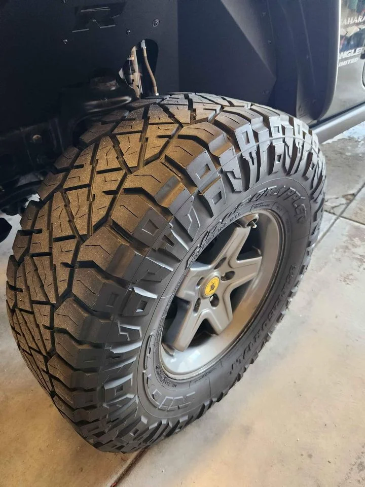

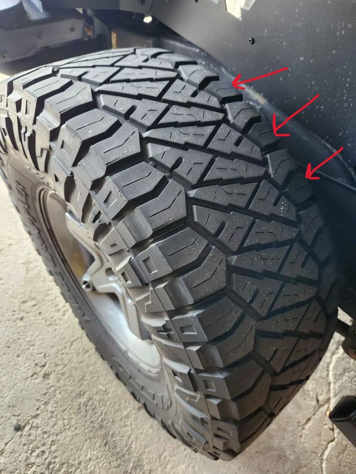

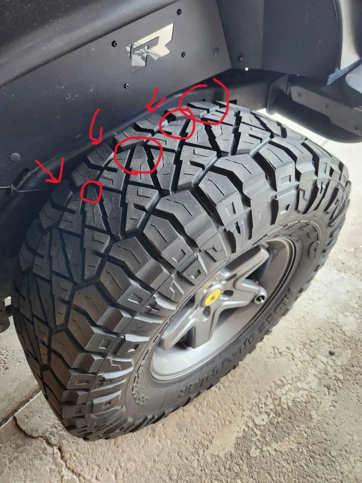

It may just be an illusion resulting from the tread design but do I see some light feathering/cupping on the inner half of the tire?

Hmm. Good point.
Here's two other photo's of them.

Hmm. Good point.
Full disclosure - I'm not saying they ARE...I just see some darker shades that looks like there are tread blocks or segments of tread blocks that are showing shadows or are picking up/shedding dust differently.
I seem to see this anomaly a LOT on Nitto tires, Ridge Grapplers and Mud Grapplers in particular, and I've never been able to convince myself whether it's real or whether it's just a visual artifact of the tread design with large, straight edged blocks. Most other tires have blocks that fit together like puzzle pieces, so any unevenness is probably harder to see.
  • Wow
I saw lifted tread blocks as well. It happens to a lot of 4x4 vehicles if the alignment isn't correct. I bought used tires from a dealer and decided to purchase two new ones due to lifted tread blocks (all at the same time). If you keep your alignment good, its generally not an issue.
You've got me convinced enough to pass on them.
I'd rather spend double on new ones, rather than waste $800 down the drain on wonky tires.
Looking at all the pics, as you said, every other tread block IS differently shaded.
I'm not knowledgeable enough in tire compounds/design to understand the severity of what that means, so thank you for pointing it out!
Probably already started cupping. The longer you wait between rotations the worse they cup. MT's are notorious for that. These hybrids seem to have similar problems. I'm anguishing over what tire to get as well. My KO2's are about done.

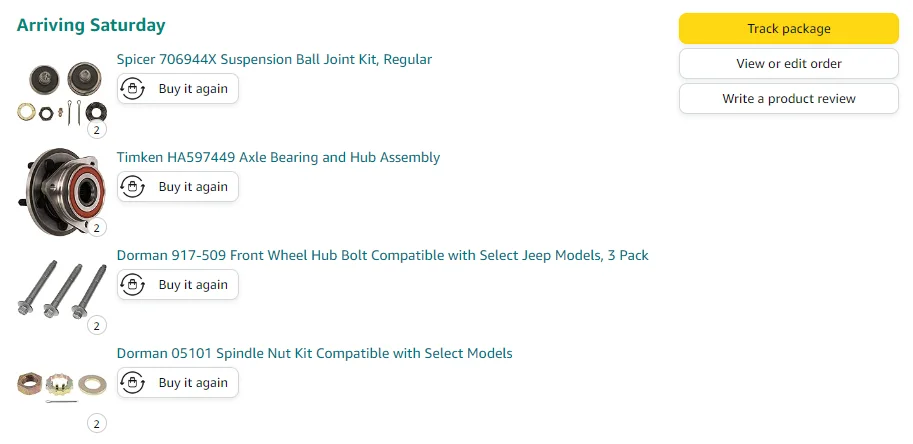

Front Axle Refresh parts have been ordered.
Went with the full set of recommended Spicer/Timken parts.
