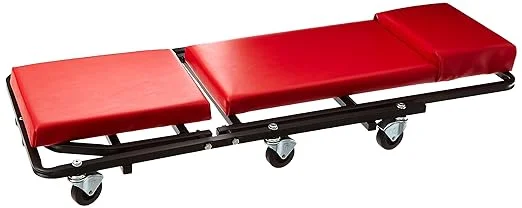

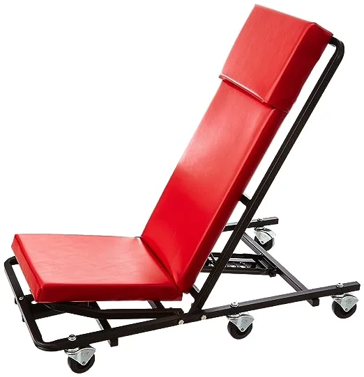

Things like this are why I bought a sit up creeper
