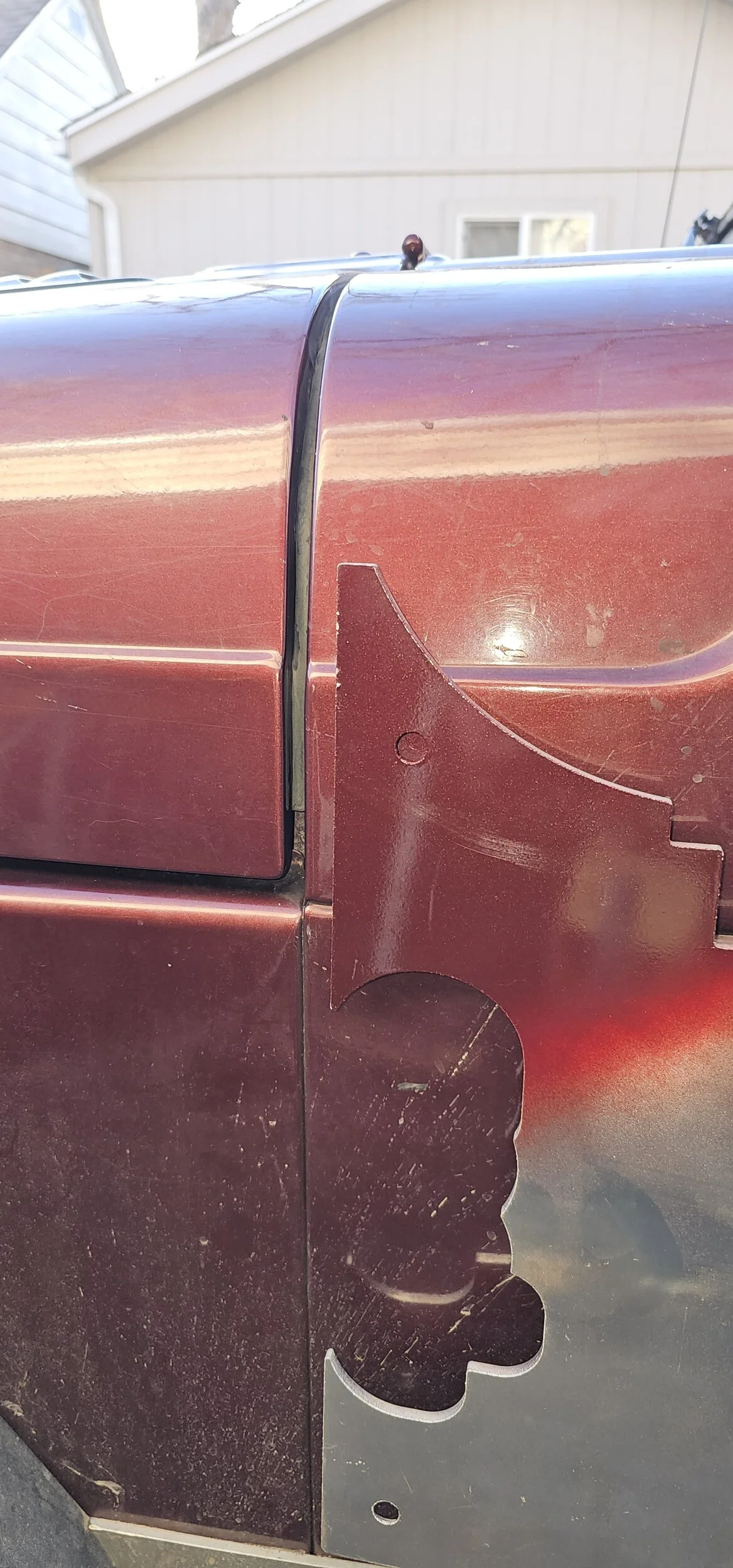

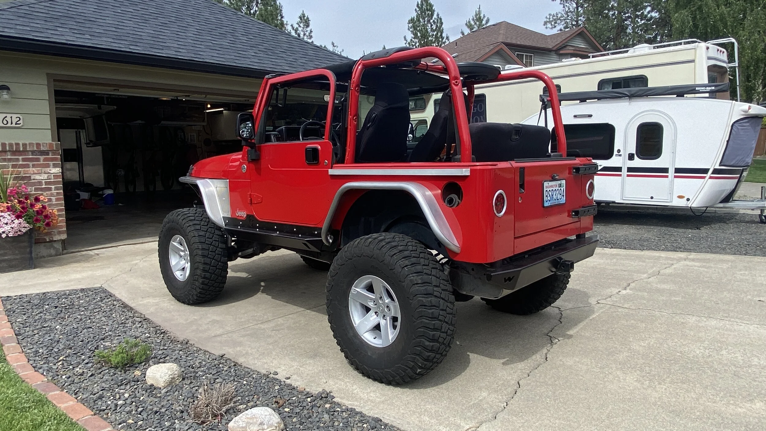

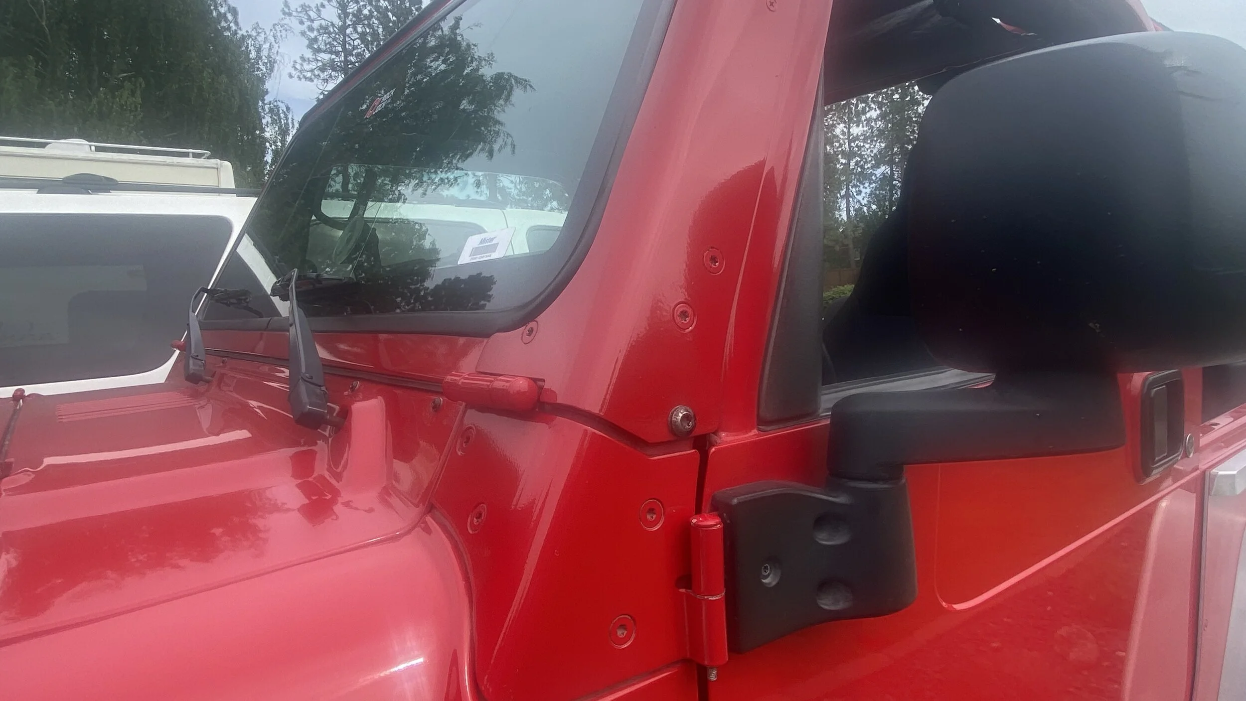

Paint shades can vary wildly now that our rigs are between 18-27 years old. The BEST option is a local auto paint supply house. They will put a camera ON your paint and their computer will baseline it off the factory paint code. Then they will give you an option of two colors and explain that one is the factory paint match and the other is what’s closest to your current paint color. In my OPINION you want the factory paint match ONLY for a complete paint job/restoration. Otherwise you want what is closest to your current color.

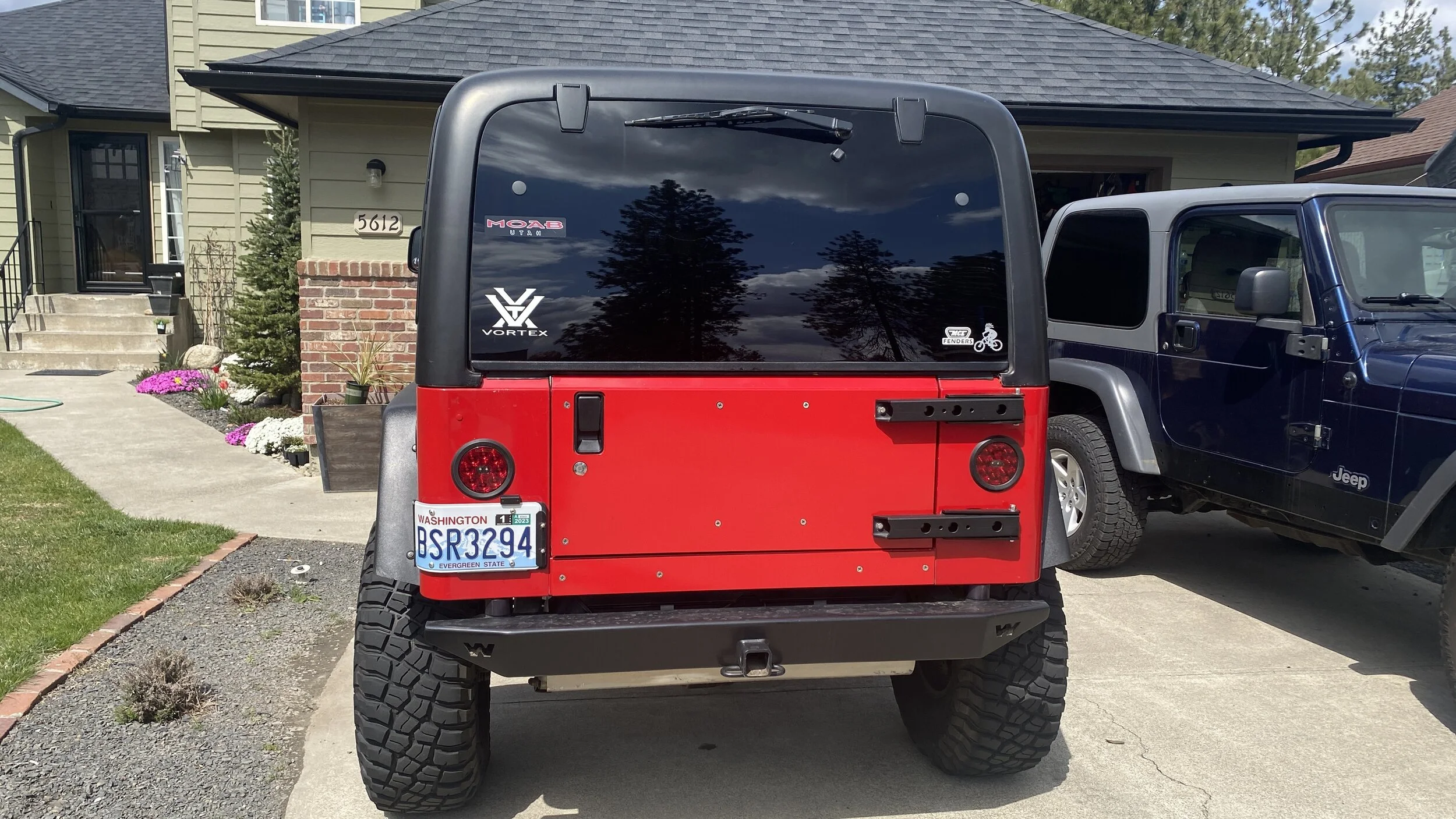

This is Rustoleum Sunrise Red on MY rig. Tailgate skin is the Rustoleum. Corners are factory. Note how close it looks to the right corner and how didfeeent from the left corner. Lighting is weird. YMMV
Same, but look how close it looks in this picture.
This is the auto paint supply color on the A-Pillar armor
This is the same auto paint store color on the corner armor and tailgate skin next to the doors which are OEM paint.
I can tell a difference up close, but I never look that close. The auto paint store match turned out to be GM Victory Red, so obviously my paint has changed color over the last 19 years or the factory guys mixed the paint wrong that Monday morning.

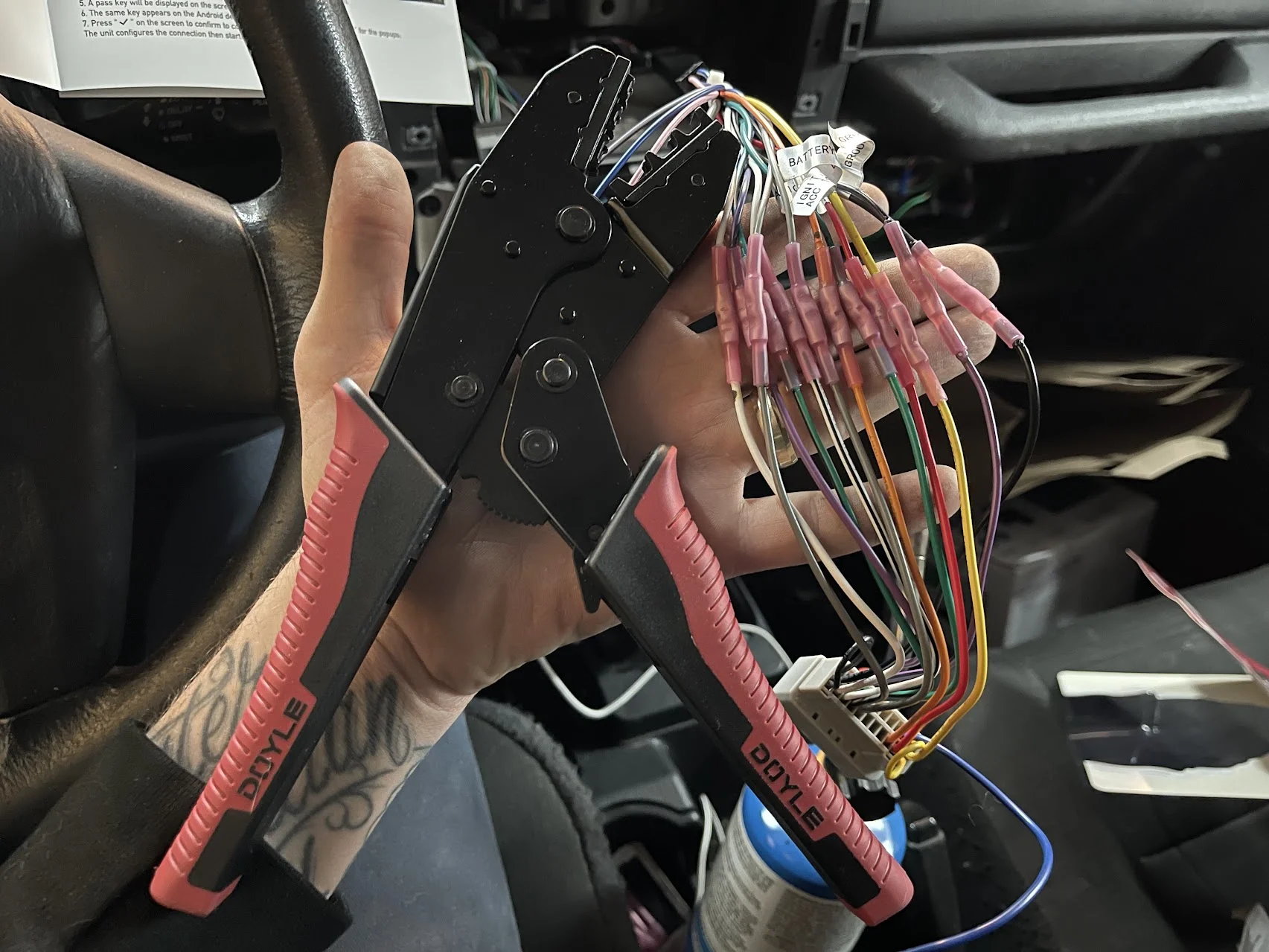

I also decided before digging into it to go buy myself a decent set of Ratcheting Wire Crimpers, and heat-shrink insulated butt connectors.
I haven't been enthused with my current selection of crimpers in my toolbox.
The previous crimpers I own all work "okay" but they don't leave that professional/OEM crimp that i'd like to see.
When dealing with wiring stuff, I think that a bit of preparation can save a load of headache in the future.

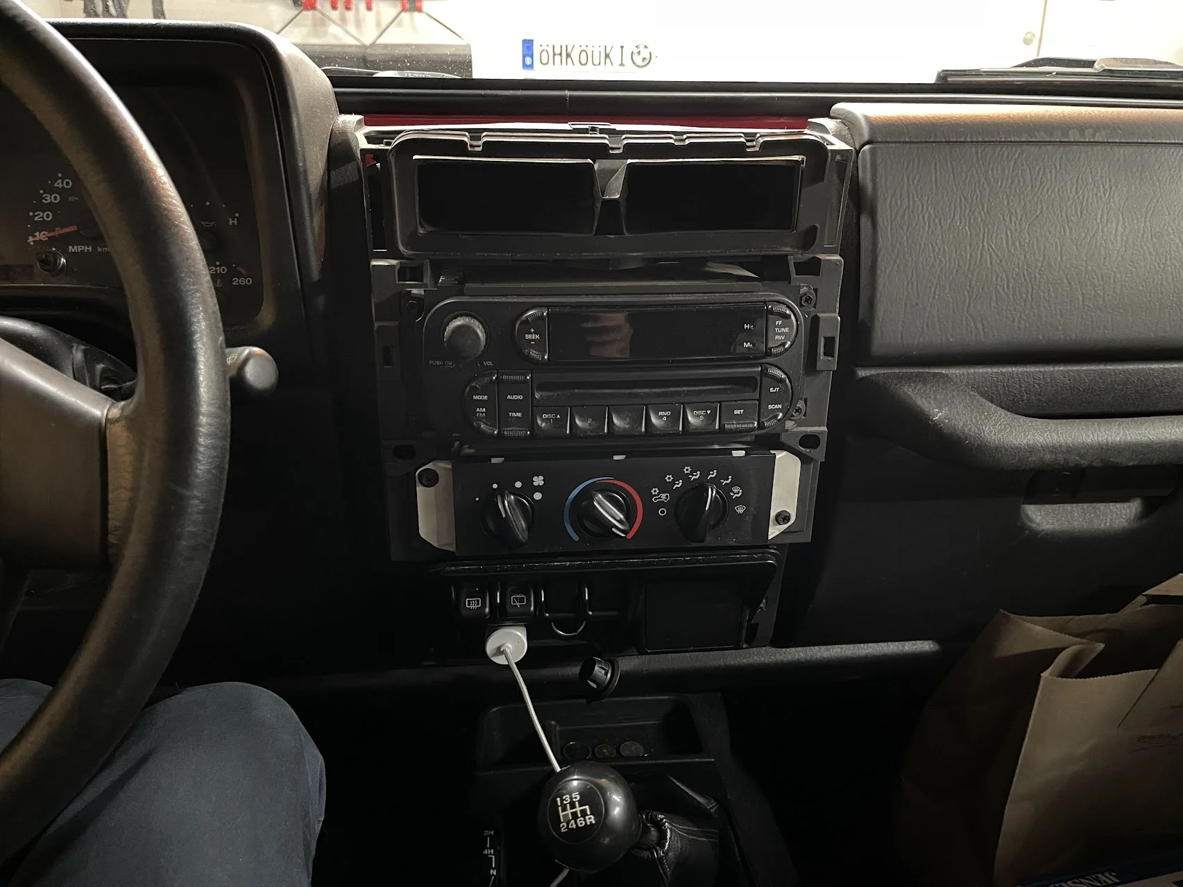

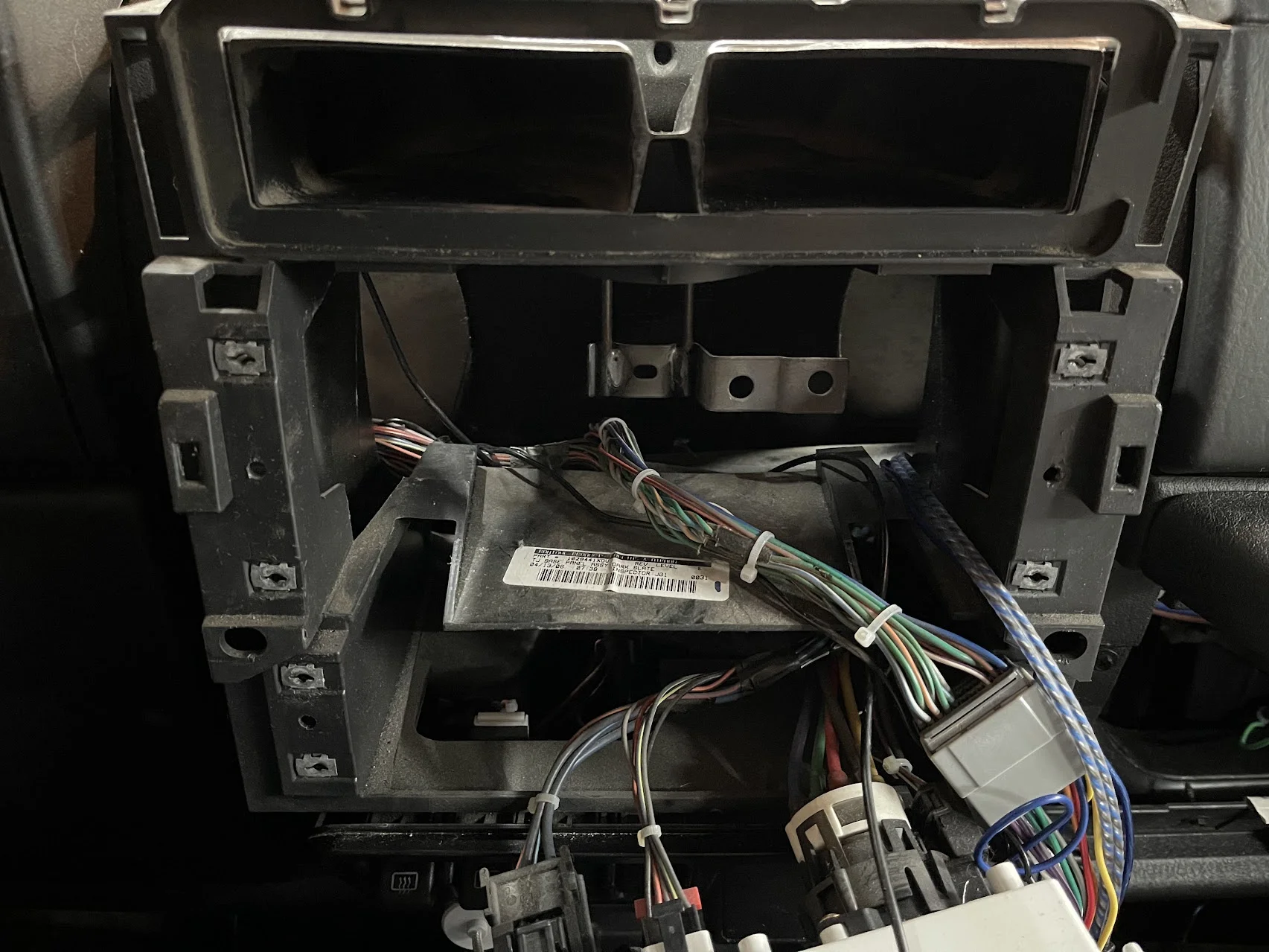

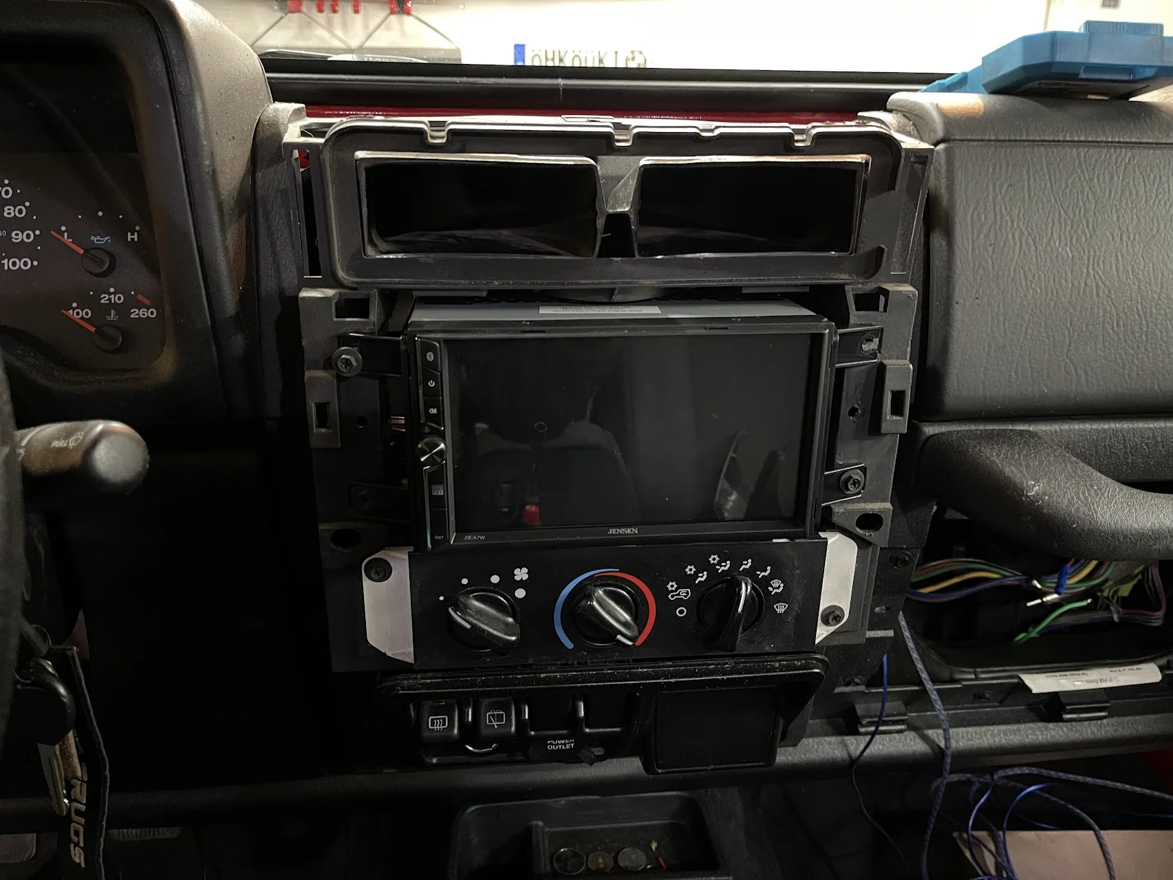

Factory Head Unit is in great shape, and works as it did from factory.
But one thing I hated in my TJ was using my phone as GPS, and I find the selection of TJ phone mounts to be ugly as hell hanging around the dash.
Not to mention my phone bouncing around, falling across the floor while climbing rocks and such.
The new unit has Wireless Carplay, and should make day to day life with the LJ that much more bearable.
(and to top it off, it's touchscreen WITH a volume knob. This was a deal-maker or breaker for me. I don't mind touch-screen, but HATE units without volume knobs)

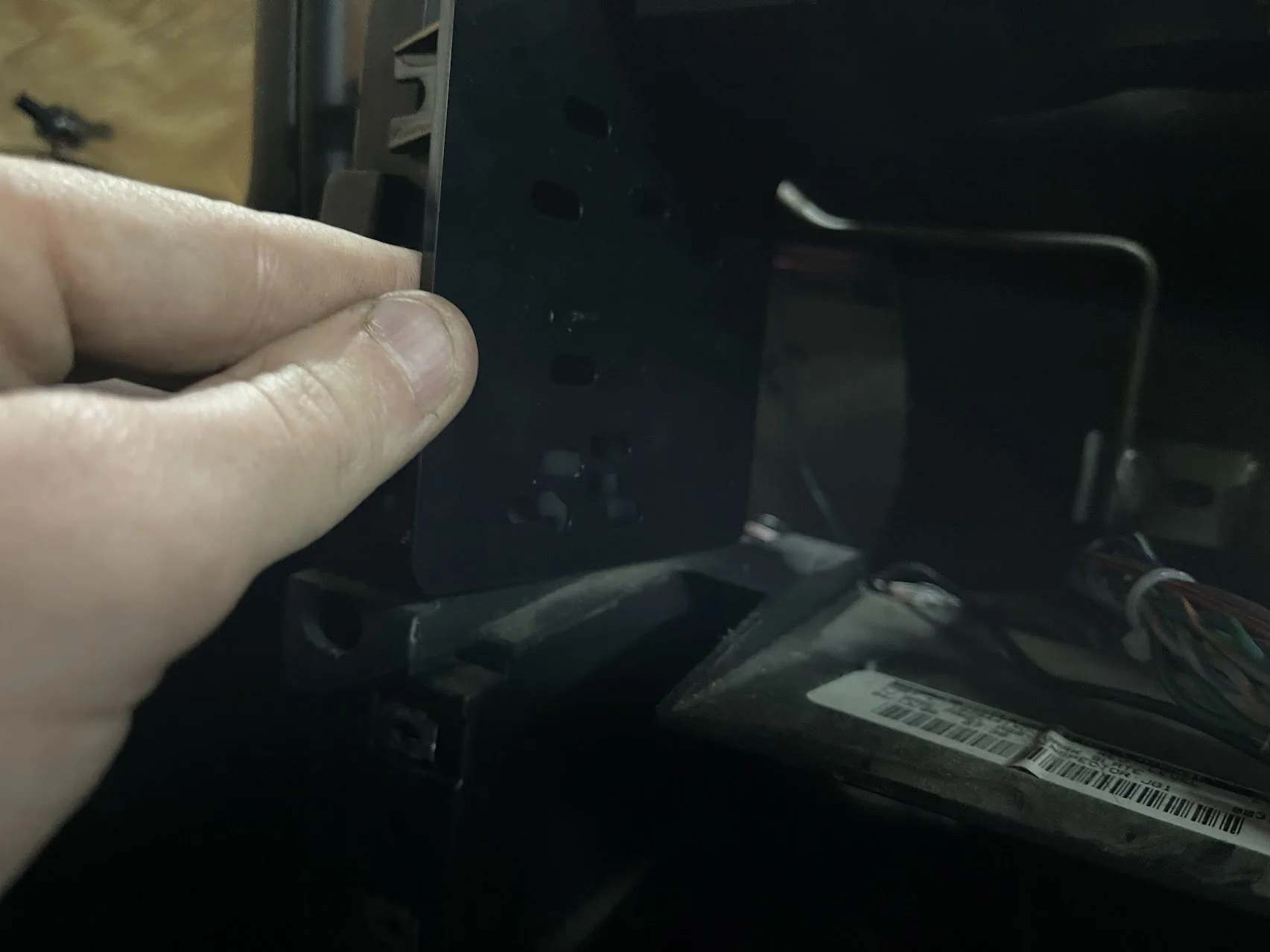

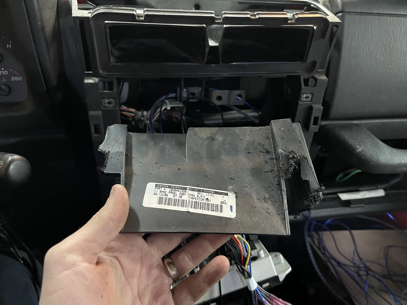

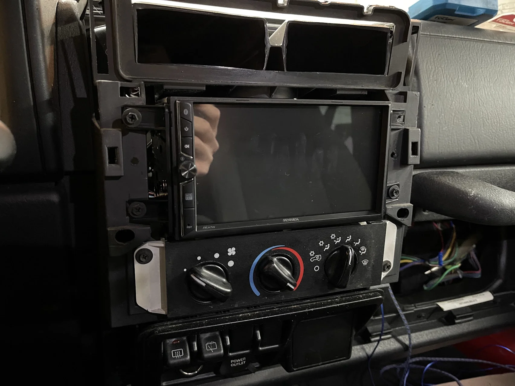

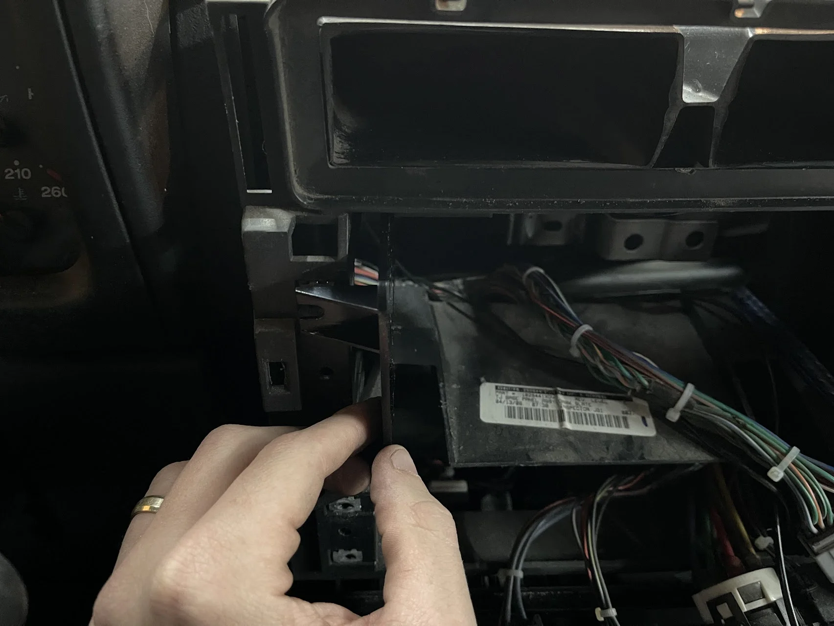

So out came the Factory Head Unit...

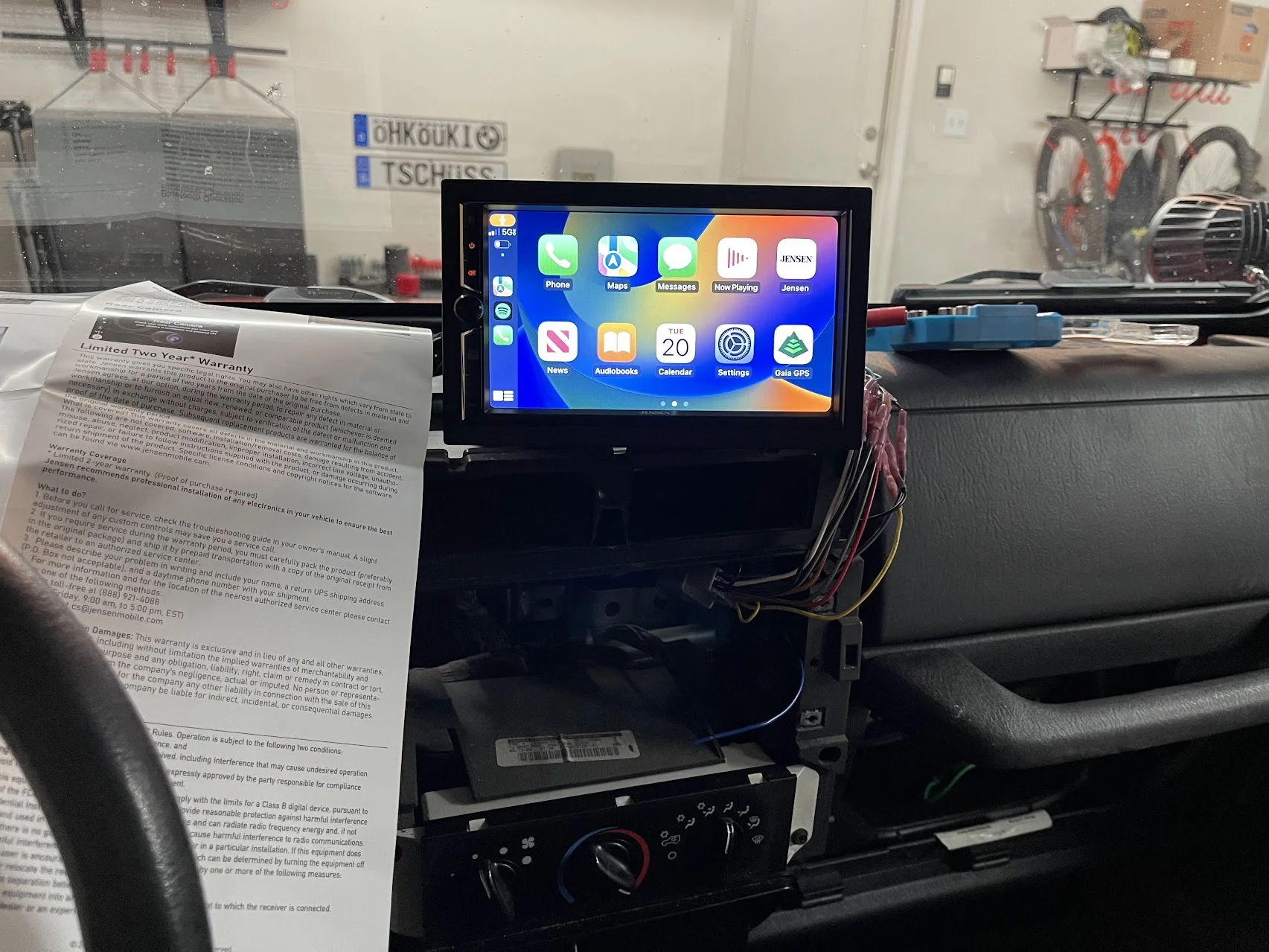

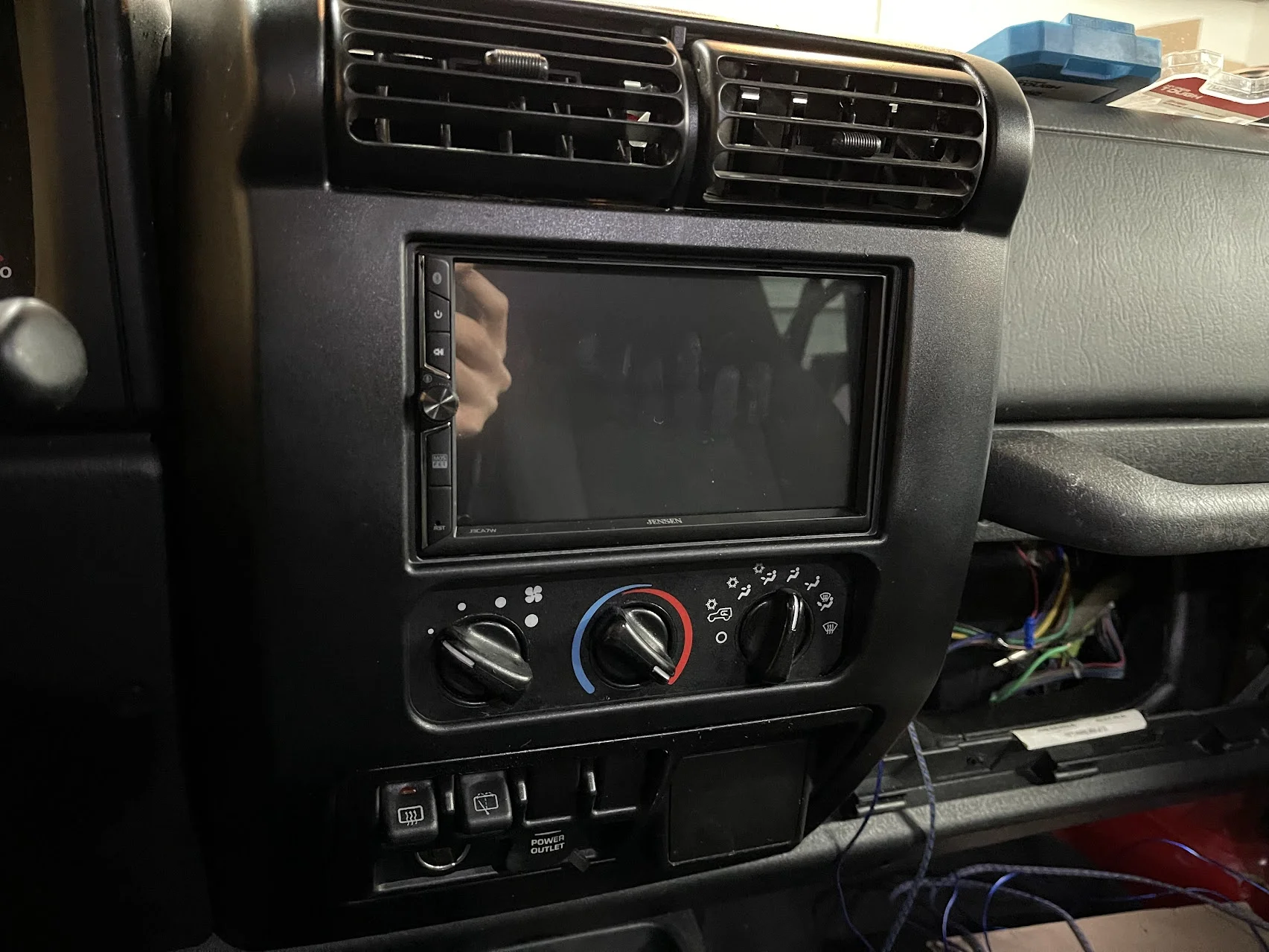

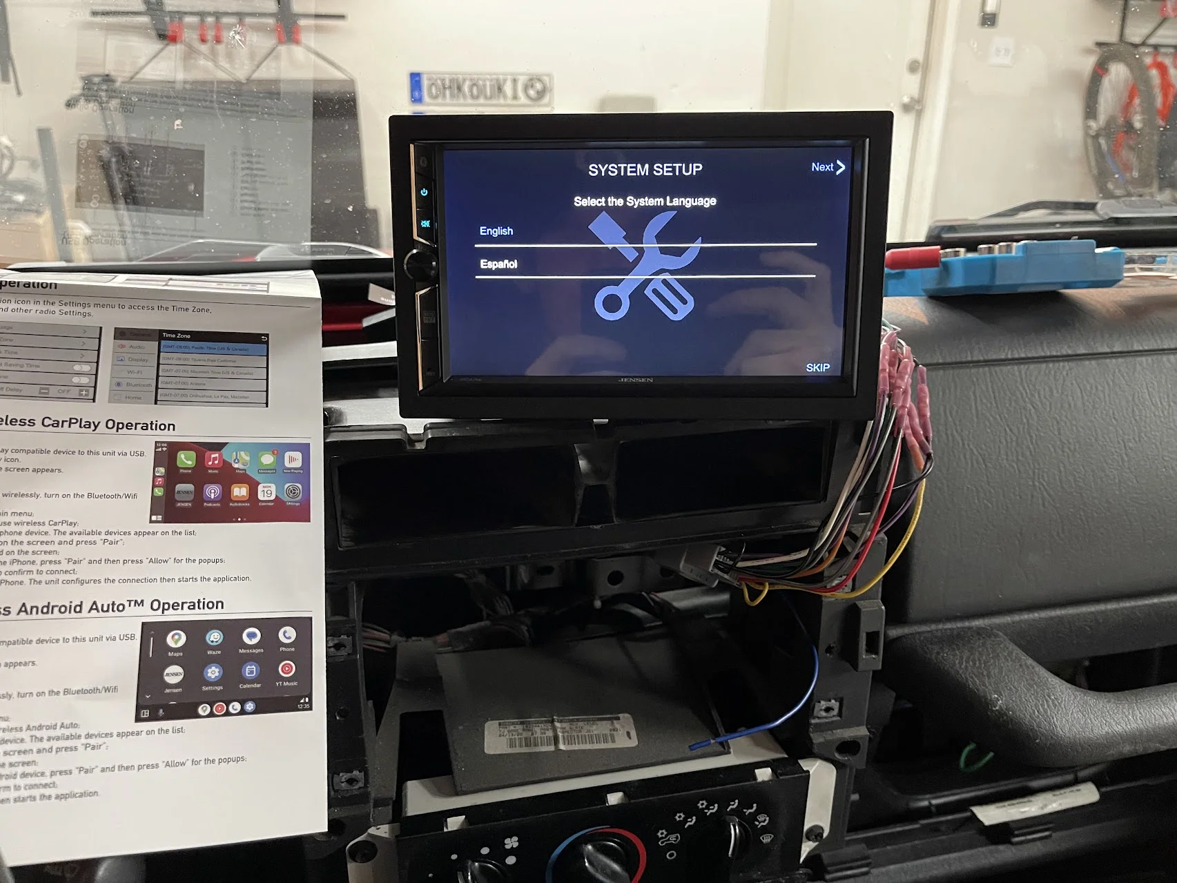

The dash kit I bought came with the TJ head unit plug adapter, and it was also color-coded correctly so wiring was fairly straight forward.
The new crimper made quick work of the job, and the waterproof insulated heat-shrink connectors made for a clean splice.
Since the wiring was so straightforward and easy, getting the radio ON and working took all of 30 minutes.
Most of which was spending time crimping wires & heating the connectors.

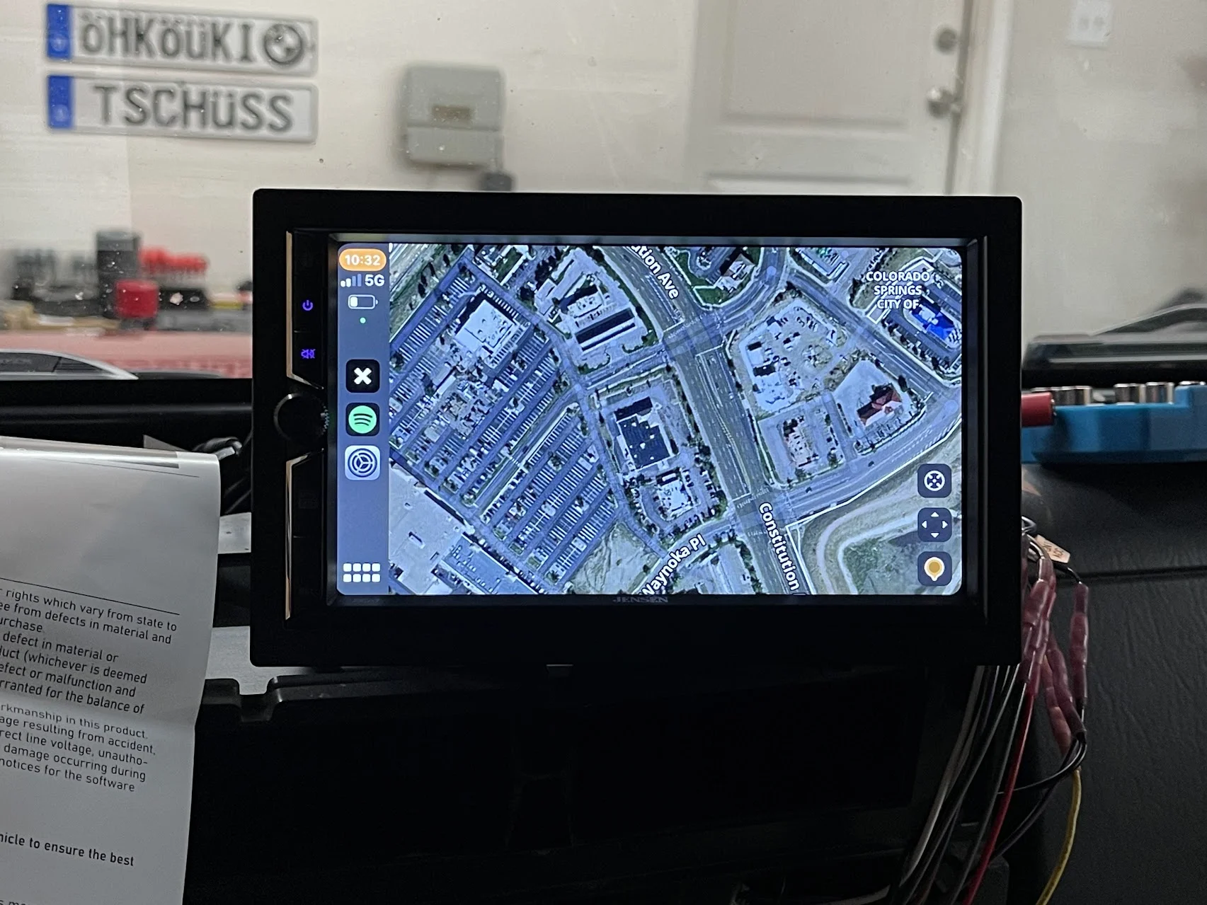

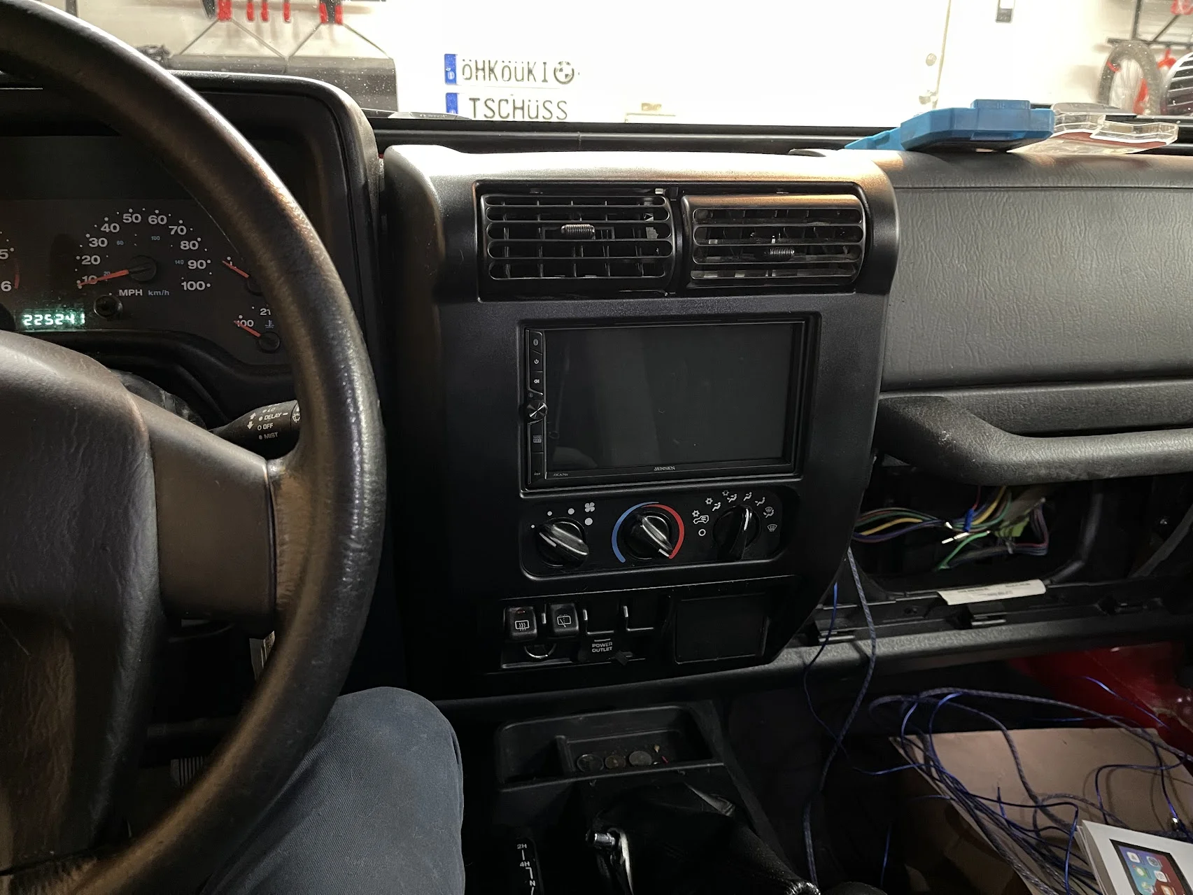

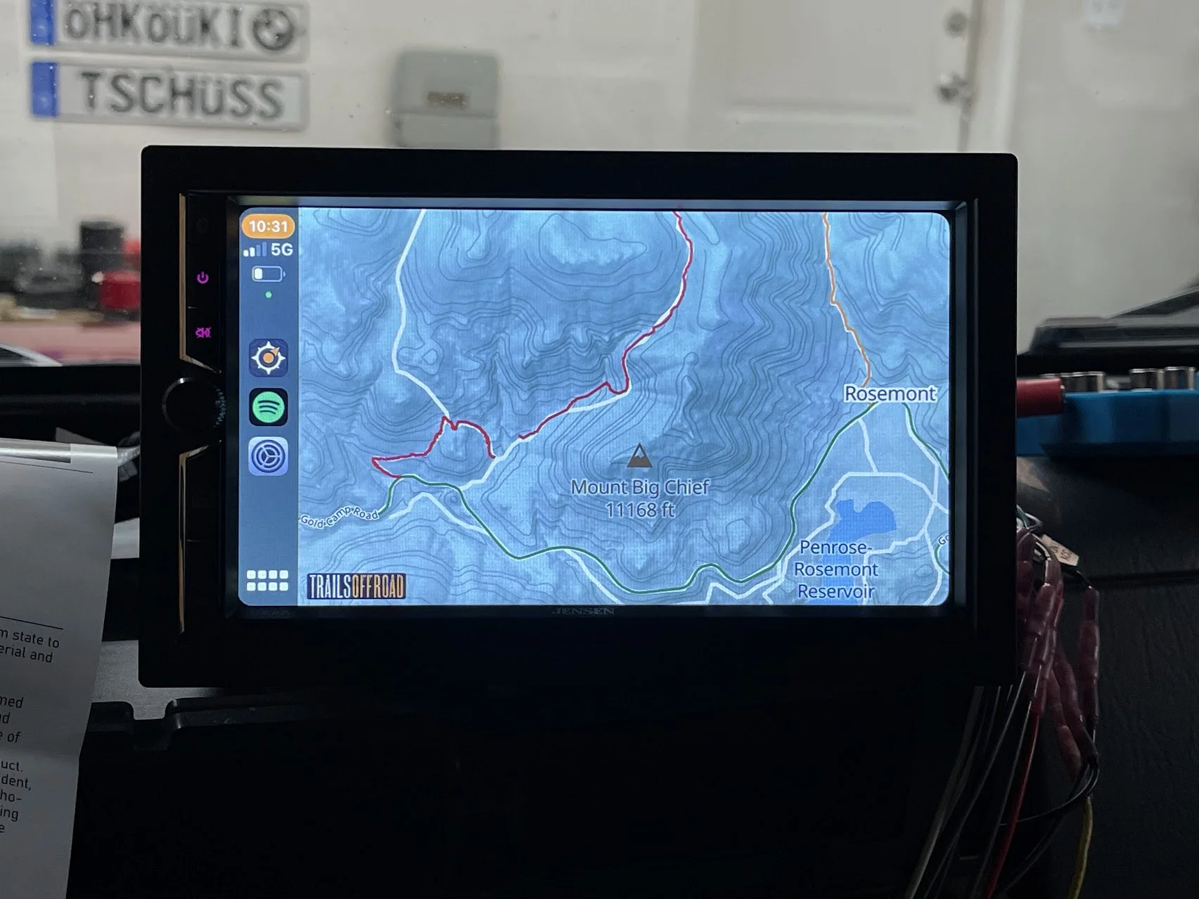

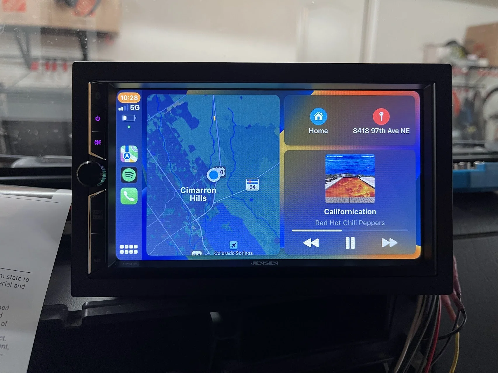

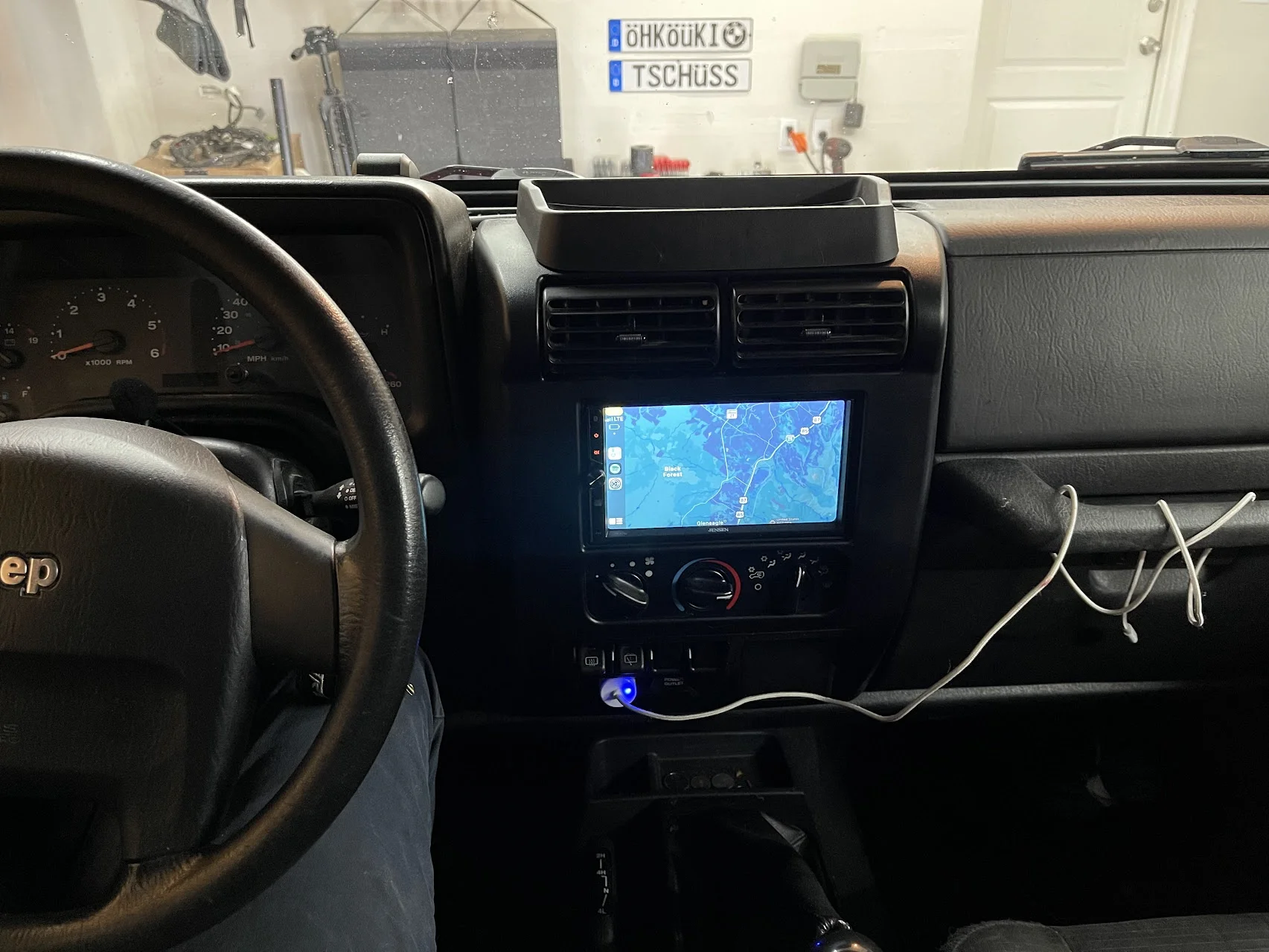

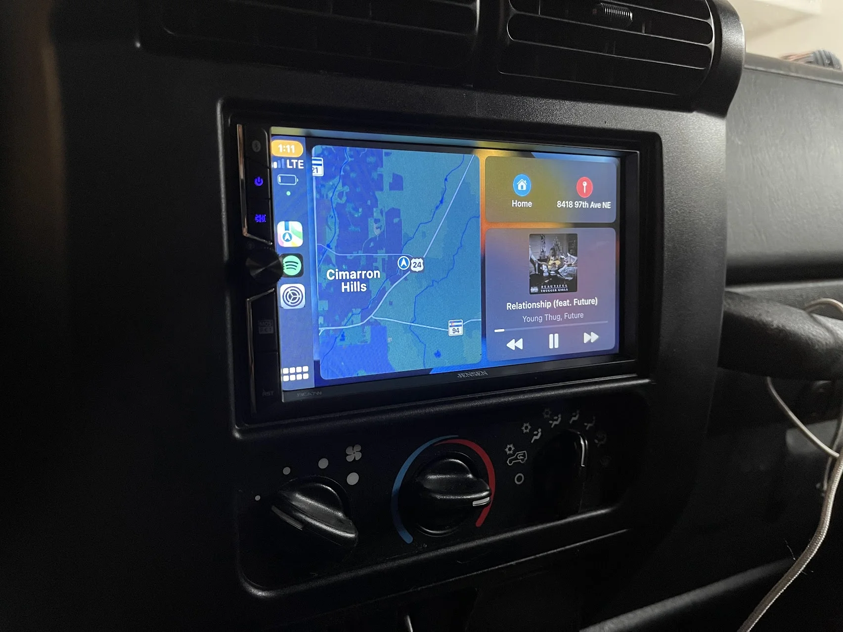

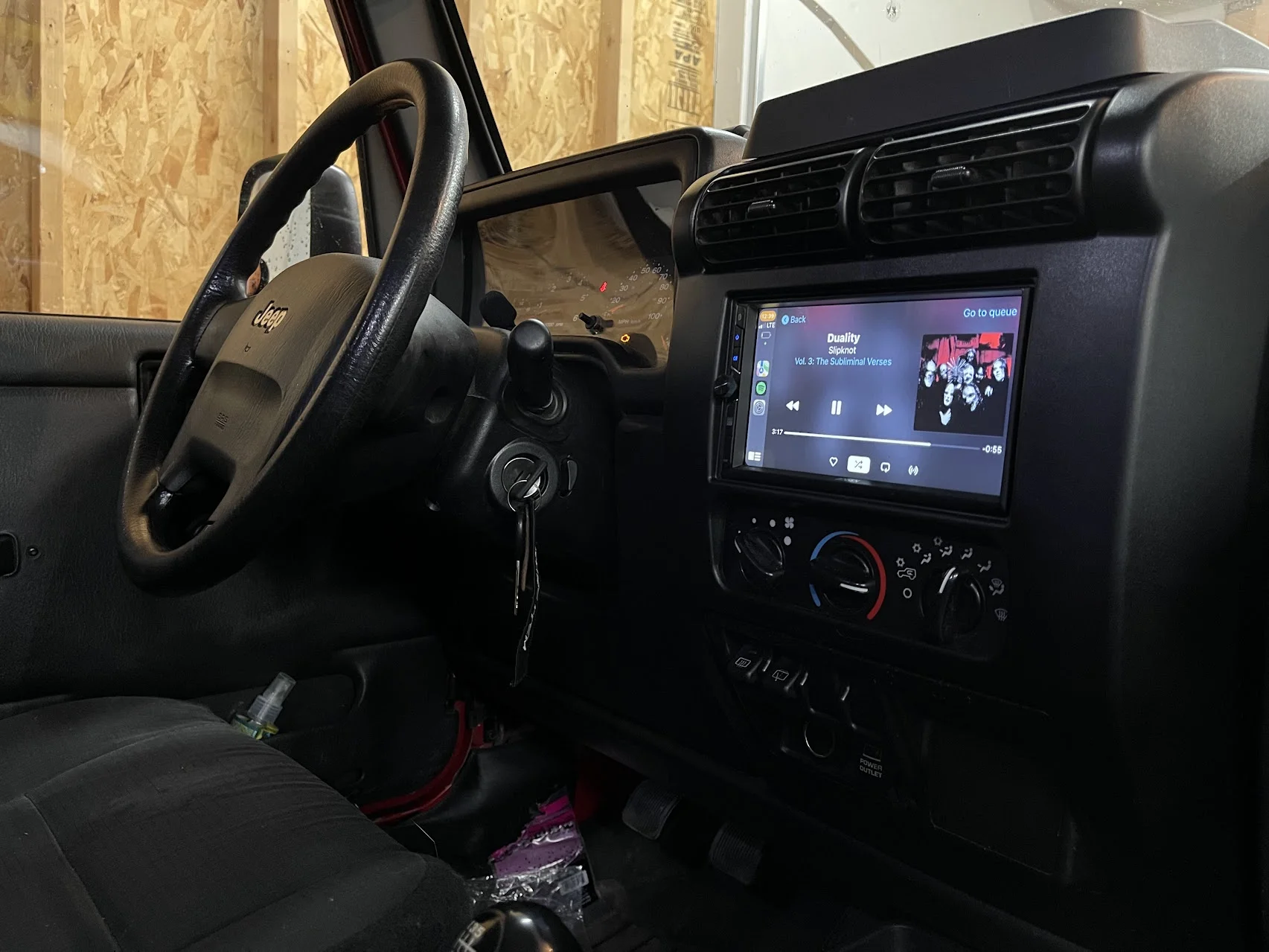

Plugged the new Unit in, and there she was.
I was extremely surprised at how easy the wireless Carplay setup was out of the box.
It's no extra bullshit to wire in, etc.

The LJ got a Head Unit Refresh...
As some of you know, I bought a new Head Unit for the LJ the other day, and it finally all arrived this afternoon.
In total I spent $220 on the head unit + $80 on the Double DIN dash kit from Amazon.
Head Unit Link - https://www.amazon.com/dp/B0CKKG6VFB?tag=wranglerorg-20
Dash Kit Link - https://www.amazon.com/dp/B0CFT4BRJZ?tag=wranglerorg-20
After all, I am young, I've wired some pretty janky shit in vehicles before, and overall just never took the effort/energy to do it the correct way.
Which ends up biting me in the ass in the long run.
But i'm getting off topic. Back to the head unit. :ROFLMAO:
Wireless Carplay/Android Auto is built into the unit itself, and within 2 minutes of fiddling with settings, my Carplay was fully functional.
Another huge plus, which I did not realize was adapted for Carplay, is that I can use both Trails Offroad AND OnX with the unit.
Displayed right on the screen, can find/track the trails without hiccups.
Now it was time to get it mounted into the dash.
I test-fit the Unit mounting brackets into the dash and realized that the dash simply was not meant to adapt this size screen.
The brackets were making contact with the factory Head Unit tray, and would not slide far enough in the hole to sit flush against the Bezel.
The solution was really quite simple.
The factory Head Unit tray had to come out.
The space was funky, there's a lot of wires to watch out for, and there just really wasn't a "good" way to do this.
It required a little hacking with various Dremel accessories to get it out.
BUT, the point is it came out, and now there was enough space to mount the new Unit in the dash.
The next part was the trickiest, and most time consuming.
There's multiple different mounting holes in the brackets, as well as multiple different mounting holes in the Head Unit.
No instruction as to which holes to use.
So it turned into a guessing game of mounting the radio to the brackets, screw it to the dash, and test fit the bezel.
Move the brackets again, mount to the dash, test fit the bezel.
Rinse & Repeat until satisfied.
Ive read a lot of information about aftermarket Bezels not sitting 'flush' or radios sitting crooked and people often referring to their installs being "good enough" or "still better than the stock radio"... you guys know what I'm talking about.
I'm OCD , so I knew that a crooked or mis-aligned screen would drive me absolutely INSANE.
It just was not an option I was willing to have.
So I took my time to do it right.
Finally on about the 10th time of removing the Head Unit, and adjusting the mounting brackets, I got it sitting very cleanly in the Bezel face.
Then of course, I powered it up again to make sure I hadn't pinched or dislocated any wiring in the process.
This unit has Microphone, GPS adapters, Factory Antenna Adapters, and all kind of stuff in the back.
I hooked all of that up while I was in there.
Mounted the microphone on the steering column below my dash cluster, and mounted the GPS/WIFI reciever at the bottom side of the windshield.
So long story short, there were a LOT of wires behind the new Head Unit..
Overall, I'm extremely happy with it, and the sound quality is up to par with some previous Alpine units i've had in recent years.
Touch screen functionality is AS GOOD as any of the higher priced Alpine Units, and the Wireless Carplay works without issue.
(obviously time will tell)
At this point, after sitting in the LJ and playing with it for about an hour, I can fully say this unit in it's entirety is as good of quality as any of the $400-700 units I have had personal experience with.
And to boot, the LJ now has Wireless Carplay, which I am absolutely stoked about.🤘
Planning to set some time aside in the next day or two to finish wiring the rest of my sound system.
I have two Kicker 10" subwoofers on the garage floor at the moment.
Planning to find a clean way to route/run the power wire from the battery to the rear-tub of the LJ, and get all of my 'boom-boom' set up behind the rear seats.
More 'pointless & stupid electronic shit' to come..🤘

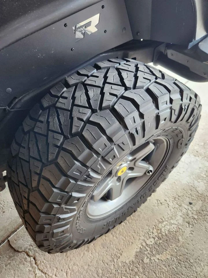

I would like to ask a question regarding Tire/Wheel size.
If any of you guys have any personal bias/opinions I'd like to hear them.
There's a guy about an hour from me selling a set of Nitto Ridge Grapplers (35x12.5 R17) for only $800.
The set is 4 used tires (claiming 75% tread left) as well as a new spare that has never been used.
In new condition, these tires are $400 each ; $2,000 for the set
Here's a photo showing the life of the tires.
I guess my hang-up is the 'taboo' of running larger wheels for our TJ's/LJ's.
I'd obviously need to push up to 17" wheels.
However this opens the door for BMB Big Brake Kit, and also opens the door to a large selection of wheels & bead-lock wheels in the future.
I just don't want to make an $800 mistake.
Is this a terrible thought process, or should I jump on this?
There are a lot of changes that need to be made when going up to 35s the right way. The list grows pretty quickly. My buddies were trying to convince me to skip 33s and go to 35s when we last went wheeling. It turned into “you just need this, oh and this, oh and this too, etc etc.” Is that a commitment you’re ready for in the near future?
That’s a good deal for the tires, especially if the AEV Pintlers in the picture are included. But I’ve also taught myself that just because it’s a good deal doesn’t mean I need to jump on it if I’m not ready.
Reactions: NDSpeed and Wildman
The only changes I would need to make for 35's to run optimally is a Big-Brake kit.
Of which I had planned to do anyways for my current 33'' setup.
Everything else for the most part has been done.
Sadly the AEV Pintlers aren't included. I tried to up the price to snag them.
Seller won't let them go. :ROFLMAO:
It may just be an illusion resulting from the tread design but do I see some light feathering/cupping on the inner half of the tire?
No taboo with 17s...if they're wrapped in 35s. I think generally as long as the wheel is no more than half the tire diameter then it looks fine.
Check the date code on the tires. So many times I’ve seen a good deal on used tire sets with high tread remaining but the manufacture date is already 6+ years old.

Man, I really like that unit. I wish I had done a double din last head unit change. Great future idea for me.
I really enjoy the way it turned out.
I'm very particular when it comes to aftermarket audio, and things fitting as well as OEM/Factory.
I messed up on the TJ when I opted to install a generic single-din unit.
I'm glad I did things correctly this go-around.
