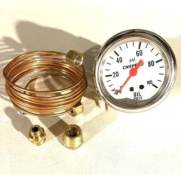

Have you used a good mechanical oil guage screwed into the sender port to verify the issue isn't electrical?
My 97 reads a false low after a new mopar sender on a motor with 20k miles. I'll diagnose it some day
I have that exact gauge installed. Maybe a different brand but copper tubing and all. I had the same thought that maybe it was a faulty factory gauge.
