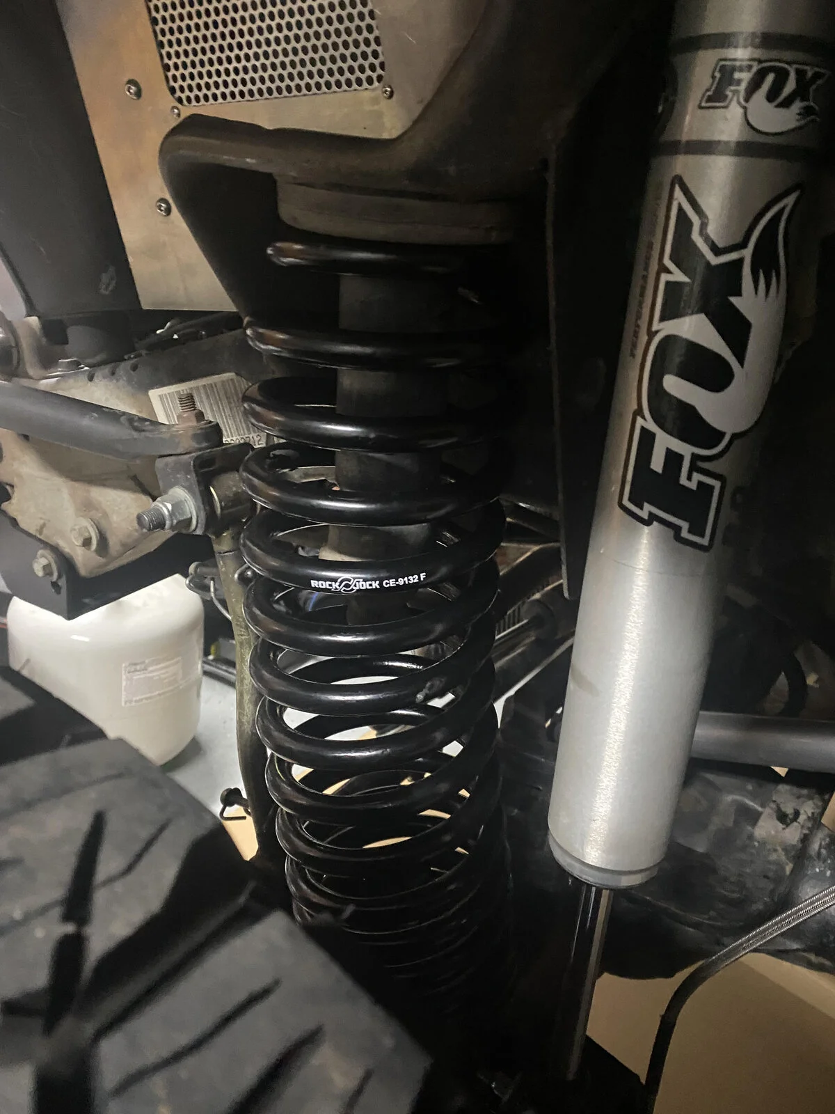

Springs are installed. Interesting, the springs have a slight bow in them. The fronts are the only ones with a bow, rears are fine. I will get the body lift installed next week.
Reactions: Jerry Bransford
Picture of the bowed front springs. Any Issues with this? Is it just cosmetic?
Thanks
Clay
