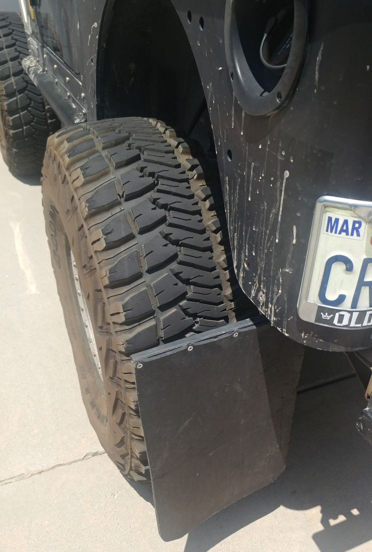

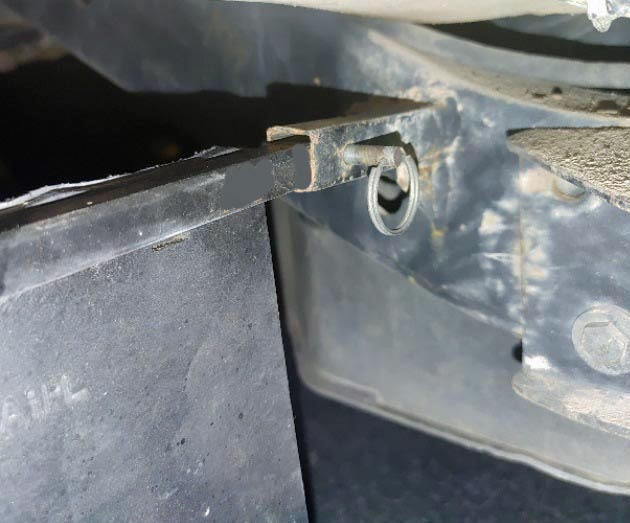

That’s way more simples than I was expecting. If that keeps the cops away that seems like a great solution for someone that’s really wheeling it hard.
Does this pass inspection? This seems like a really good idea and as simple as those are, it’s probably pretty cheap too.
When I go to 0in flares I will probably do something very similar front and rear. Boise Police Department isn't terrible on fender coverage but there is one Idaho State Police trooper that has a personal vendetta against tire coverage, mind you he's crazy enough about it that he'll ticket you for no mud flaps even if you have full tire coverage so its kinda a losing game when it comes to him XD

I lived in California then and there were no vehicle inspections, only smog tests. They kept the cops and Highway Patrol from pulling me over so they were good enough for my needs. I'd expect they'd allow you to pass your inspection so long as the inspector wasn't a complete jerk.
