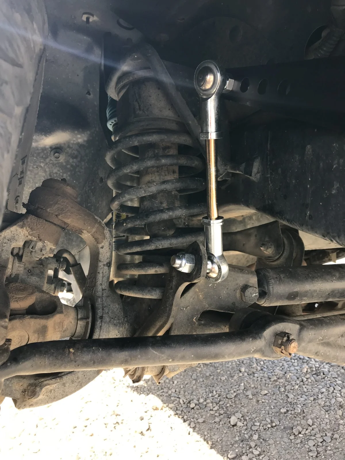

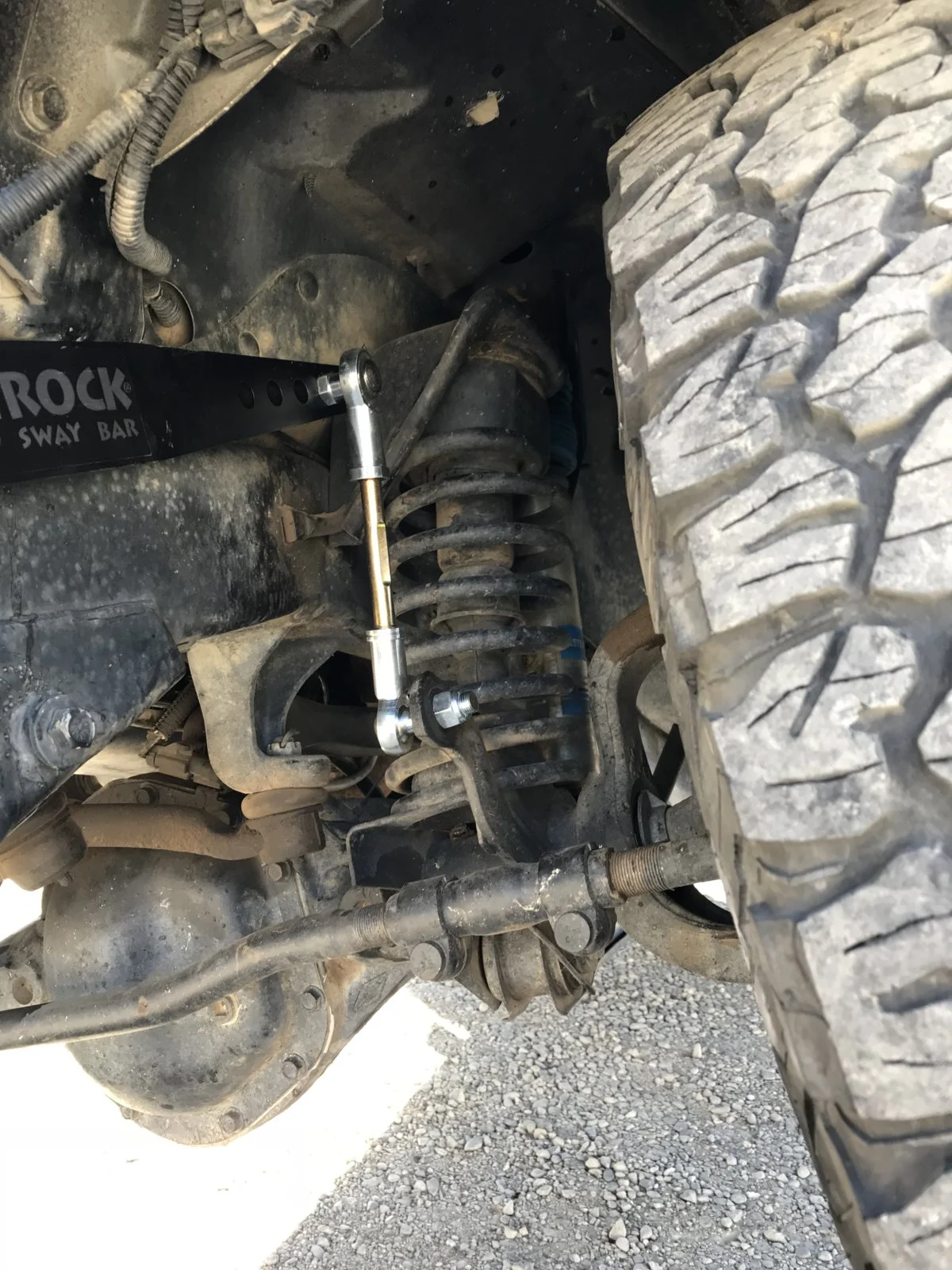

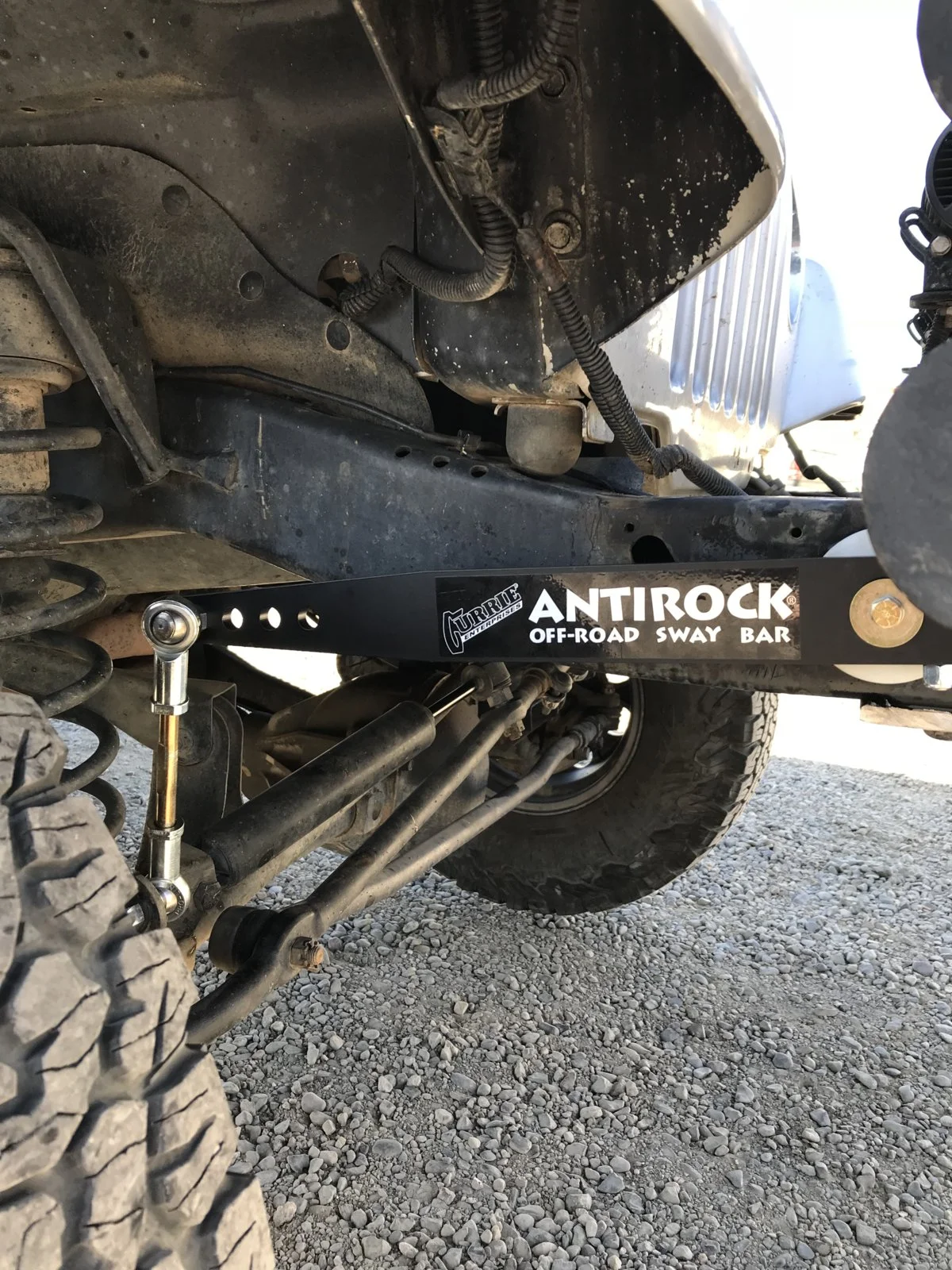

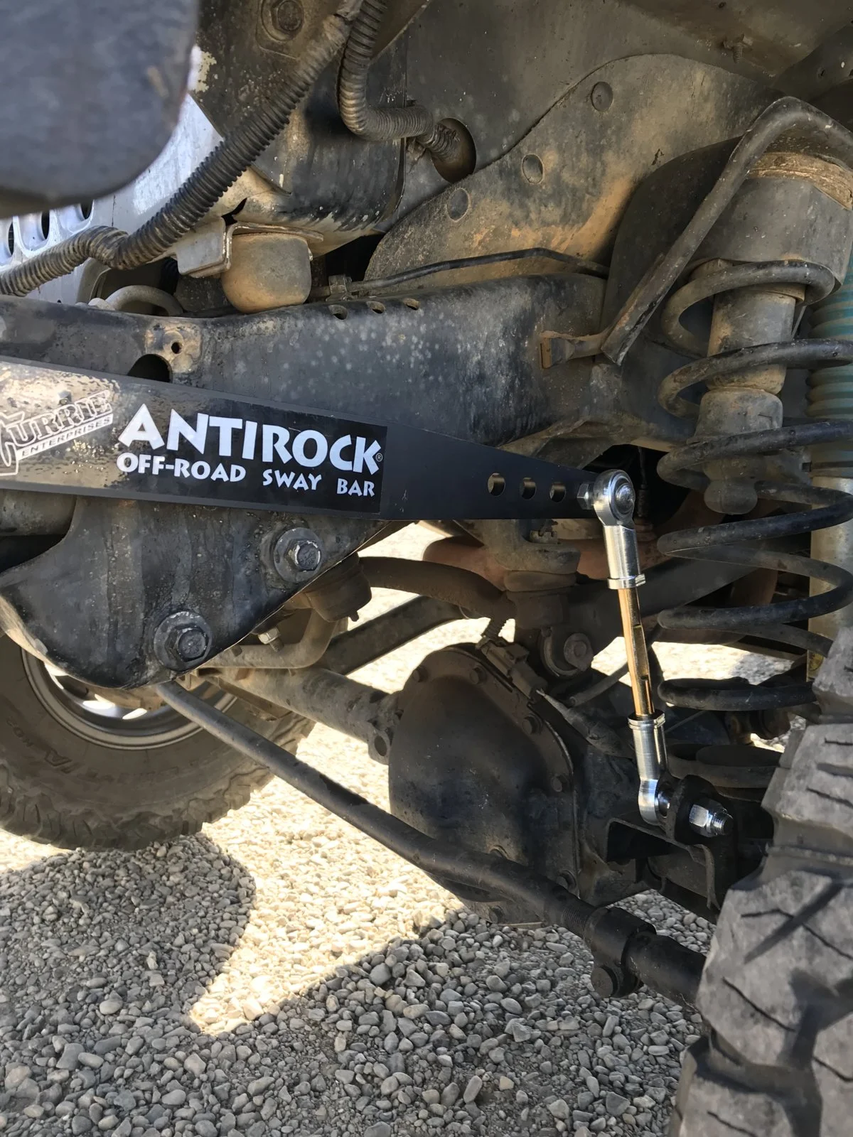

It handles fine lol. I drove around without the stock sway bar on for a day or two so the antirock is an improvement over that :)
The pics are full stuff and full droop, at rest they are slightly upwards. With 2 inches I didn't want the arm up in the fender. No room for the jam nuts either, I ground the threads till the L and R rod ends were positioned correctly then plenty of lock-tight. I will have to keep my eyes on them to make sure they don't unwind.
