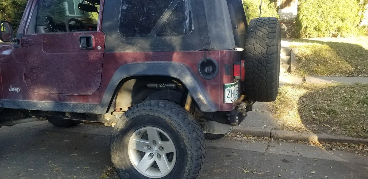

I have them... Aftermarket bumper with tire carrier, no back seat... I'm sure they'll settle a bit in time

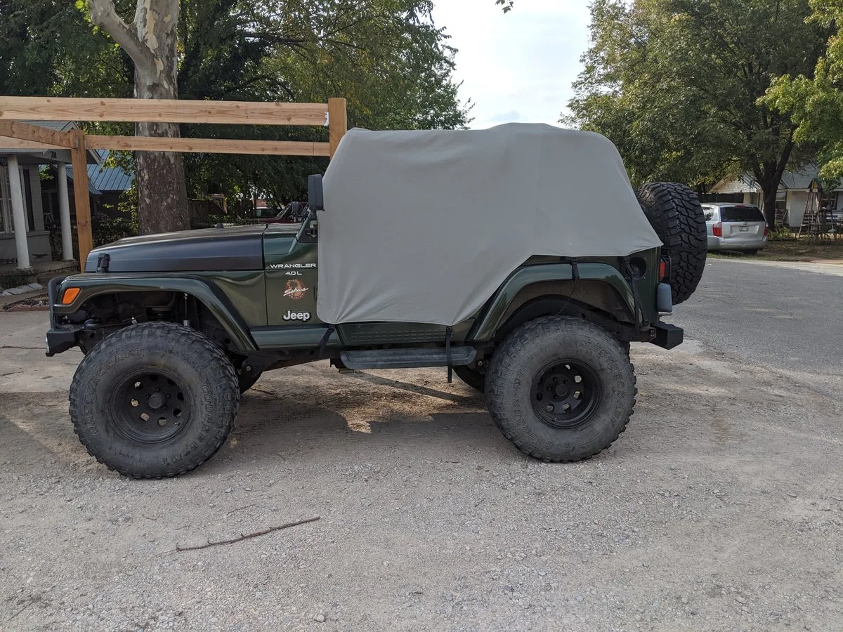

I've got the LJ coils in the rear which are a 1/2" longer than the tj coils. They netted 5.5" in the rear with a 35" spare and a steel bumper/carrier. Once you put the hardtop on they should drop a touch. They are a low spring rate coil.
Rear spring is 14" on mine. Tire is 8 3/4" to bottom of fender in rear... 7 1/4" front
My set when the heavy bumper and carrier were on settled down to an even 12". I think they are at about 12.5" now after the weight loss.
When they first went in, I remember the lift height being scary tall, but it didn't last.
Thanks, So what do you have for weight now? Hard top, spare, heavy bumper, backseat, etc...?
Thanks. Did you actually measure 12.5”? Looks pretty high like ours
That is a recent measurement. Those tires are worn 33 and there is a body lift. And the street crown might cause a lean. :)
