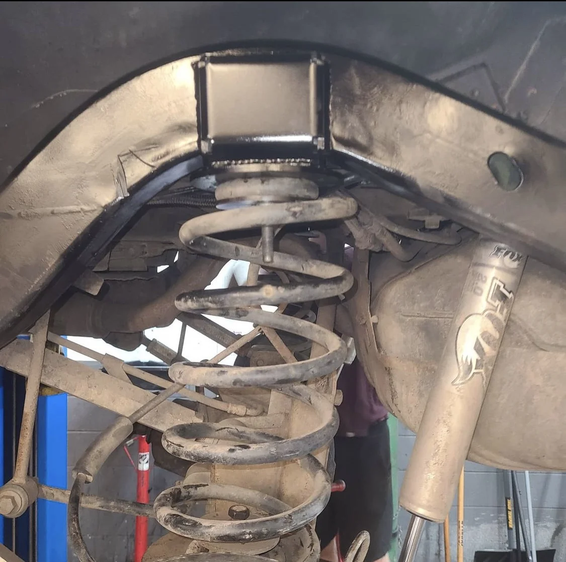

By that statement, I’m guessing there’s more than one way to do it? Here’s a pic of the job done on a TJ by the shop. Not sure if it tells the story. Which is the way to do it that maintains ride height?
If the distance between the spring perch and axle pad remain the same, the ride height won't change as the spring rate and vehicle weight haven't changed. I believe what JJVW maybe referring to is altering this distance. Some of the bolt on correction kits for example reduce the distance and add ride height as a result.

Therein lies the challenge. Since the spring perch in stock form is tilted a fair bit, there is no way to accurately measure the distance between perches at ride height and then duplicate that by simply measuring the same distance when the perch is flattened out. That is due mainly to the spring reacting slightly differently when compressed with an angled upper perch and then again with a flat perch.
The way to do it that maintains the existing ride height is to put the spring seat in a position relative to the frame that maintains the existing ride height. You're gonna have to take some measurements for reference. 😉
