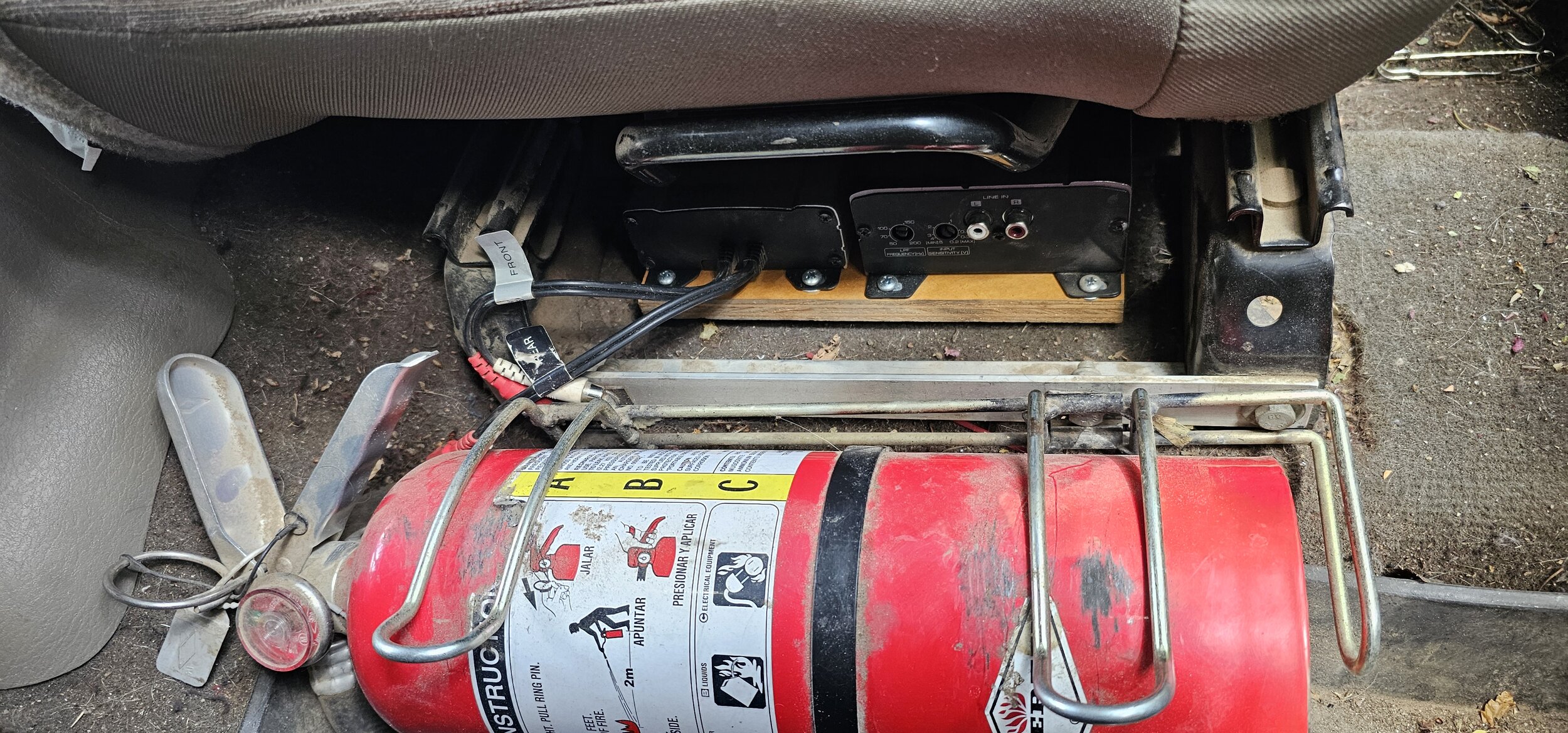

I redid every old butt connection with adhesive heat shrinks. The amps now have organized harnesses for the speakers and power that reaches under the seat. Now I need new longer audio cables to get from the head unit to the amps.

While you’re there it’s very rewarding to re-do it and make things right. Big improvement.

And that is the cleaned up version! The RCA cables are going from 3ft to 6ft which seems to be a comfortable length. Those will also get loomed. So, whatever might still be visible under the seat will be a tidy bundle.
The self-reflecting as I open up these various time capsules is enjoyable. I remember doing much of the work and trying to figure out how to do the best I could at those times. Usually, I can understand why things were done the way they were. Usually.
One thing that is clear with the wiring is the incremental accumulation of multiple single projects over the years made it easy to let things get messy and become increasingly difficult to work on. Ripping it all out and starting fresh with almost all of it makes a big difference in how well the job is done. As does the accumulation of tools, material and knowledge gained over the last ten years of messing around with the Jeep.

A good highline install always involves throwing away Jerry's fire extinguisher mount because amps.
Where should a 5lb fire extinguisher go? And how?
Reactions: psrivats
Other than the rollbar near the tailgate, not sure there is a better spot ..
