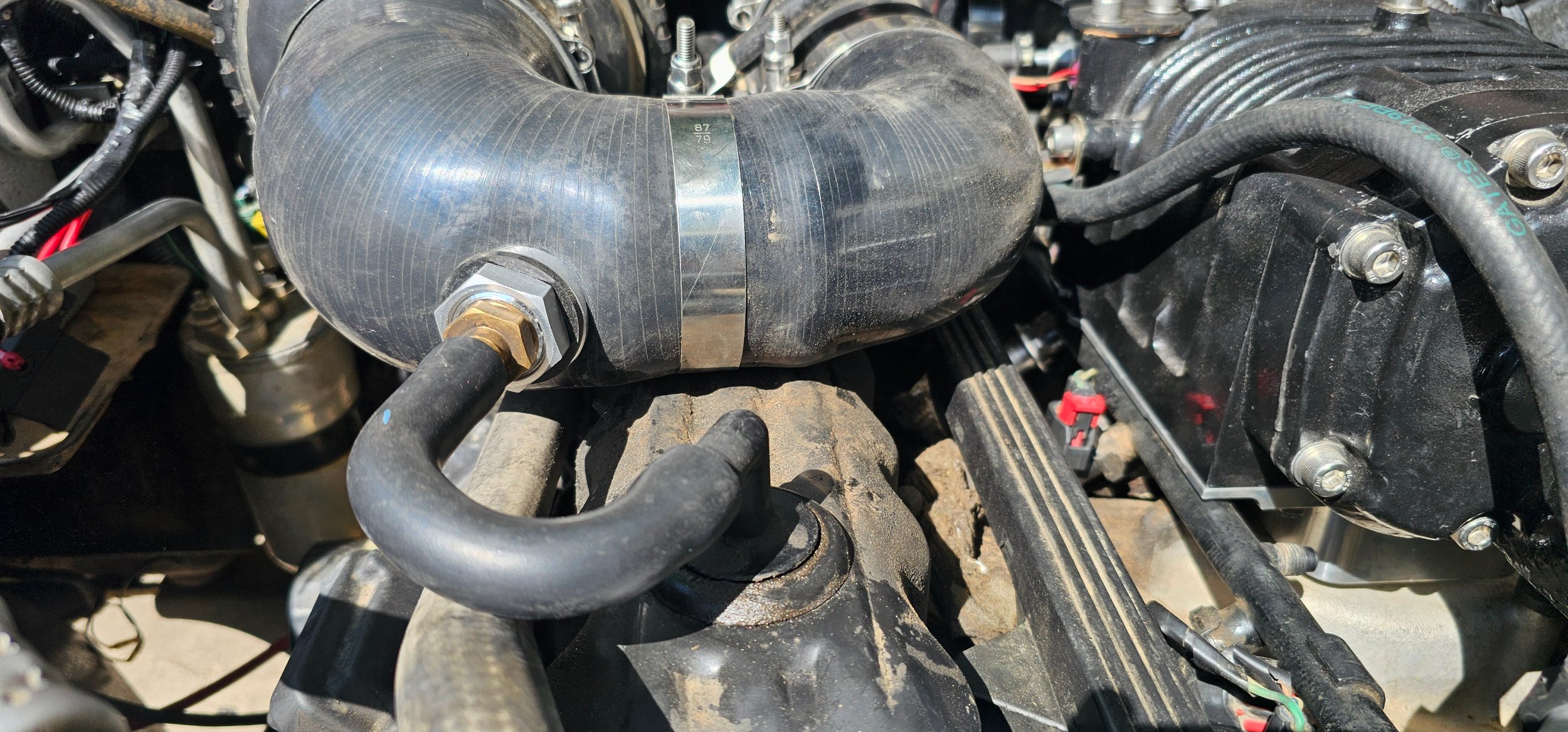

On the same trip to the junk yard, I grabbed a Ford Econoline intake filter canister. Just half of it.
This is larger than the Windstar...
...with an inlet of almost 3" compared to the Windstar's ~2". This section is all i care about.
The rubber Windstar horn that passes through the firewall into the cowl gets cut down into a grommet...
...flipped and shoved through the existing hole with a 2.75" coupler stuffed into it.
And an elbow is attached to the cowl side.

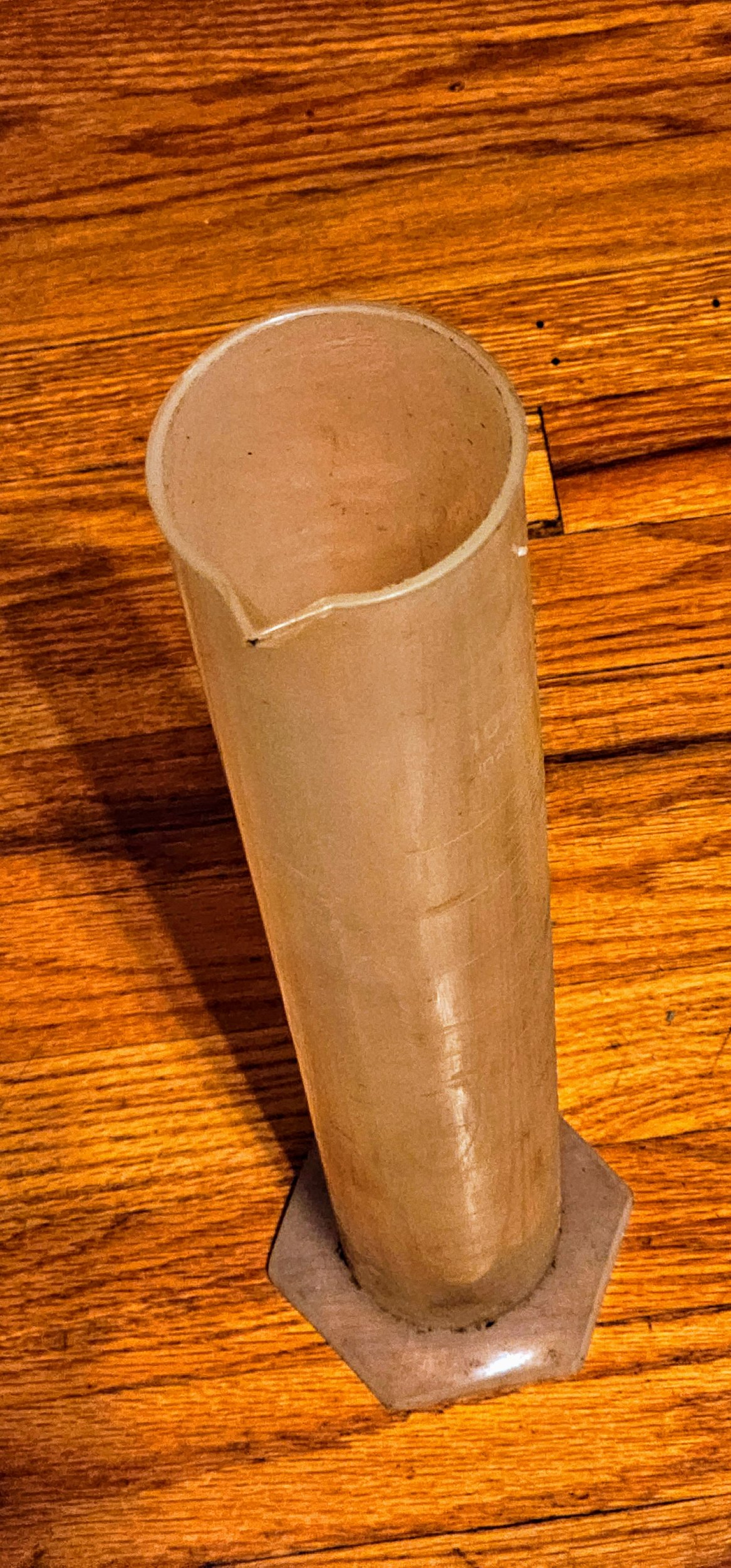

Has anyone else ever bought a big 1 liter graduated cylinder 15 something years ago, but can't remember why?
Reactions: Woodrow
This is correct.
What I do remember is yesterday ordering a long bottle brush to clean out my big dirty graduated cylinder.
I also bought a hydrometer with a tiny graduated cylinder for measuring the alcohol content in water.
Here I learned that distilled water has no alcohol in it.
I looked up the Safety Data Sheets for HEET and Peak -30F De-Icer.
HEET is supposed to be 100% methanol, which I confirmed with the hydrometer. Or I confirmed that my hydrometer is accurate.
The internet and the SDS both say the Peak stuff is 30% methanol. The hydrometer shows it is really 40%.
The less expensive generic blue windshield washer fluid is also 40%, contrary to the internet.
And the Boost Juice I bought from Summit is supposed to be a 50/50 mix of water and meth. It is really 58% methanol.
The goal here is to build a spreadsheet that will allow me to know what to buy for the meth injection in an emergency at the gas station. I'll work out the proportions in the big graduated cylinder after I clean it.
In the meantime, for normal mixing I will use distilled water from the grocery store and methanol fuel from the local race shop. This is the most cost effective way to do it at about $3/gallon after mixing, compared to $13-15/gallon for Boost Juice.
