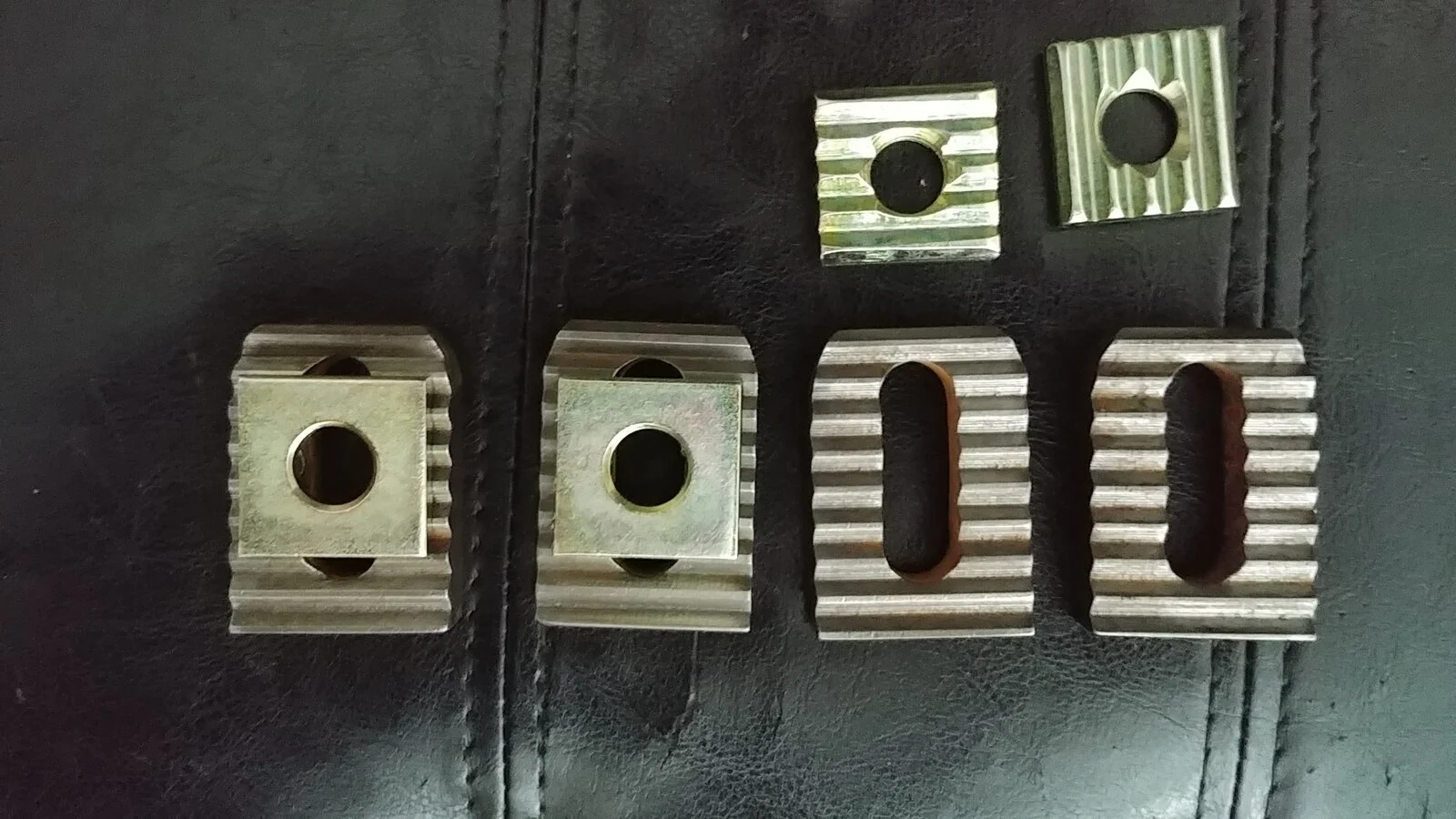

I bought these at a circle track swap meet. I'm thinking of using these to allow the upper axle mount to move in small increments. It would give me 5 positions and 1" of movement for the UCA. They are very thick and would be fully welded. Slotting the UCA axle mounts would be a pain though X4.
