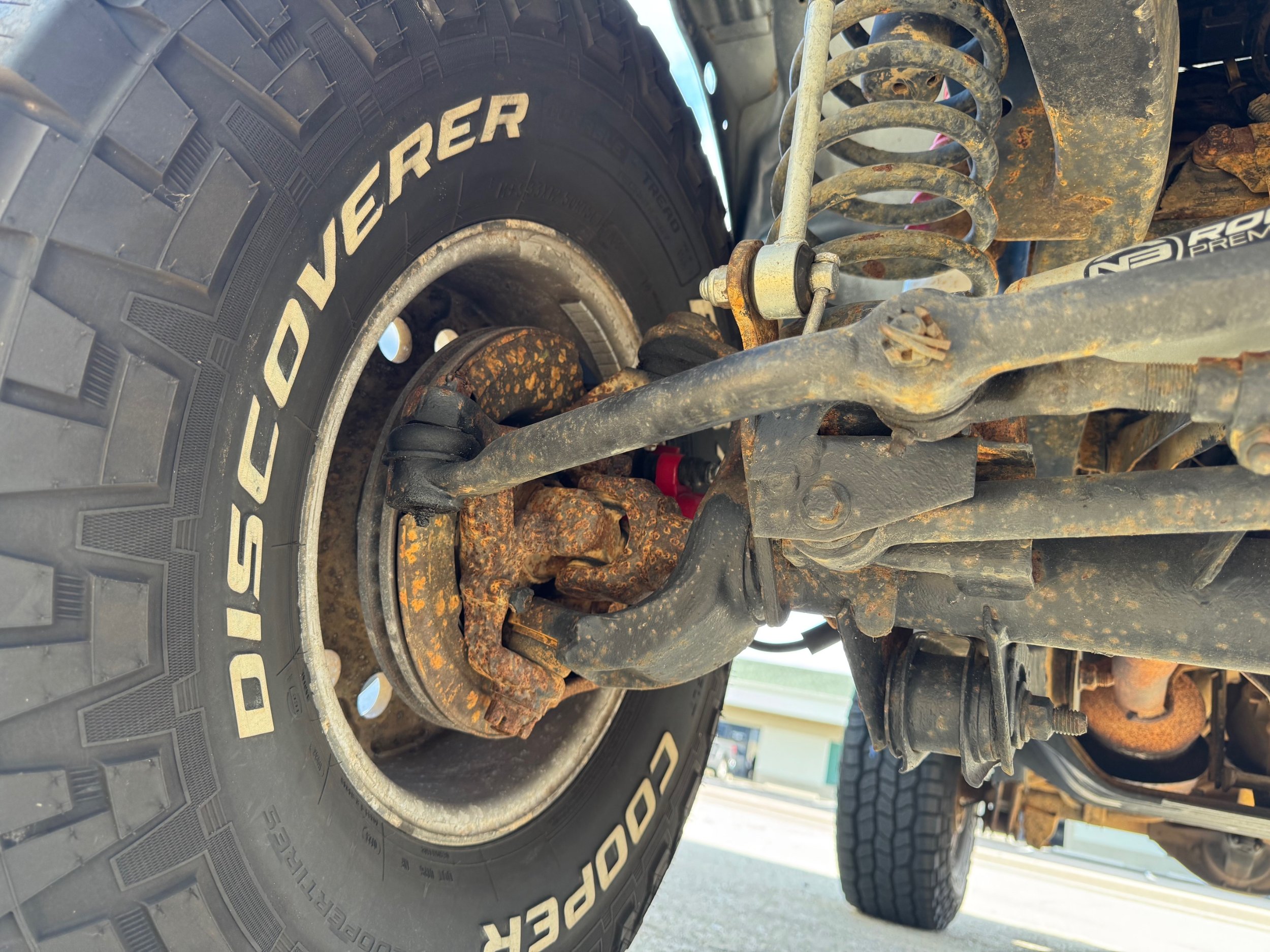

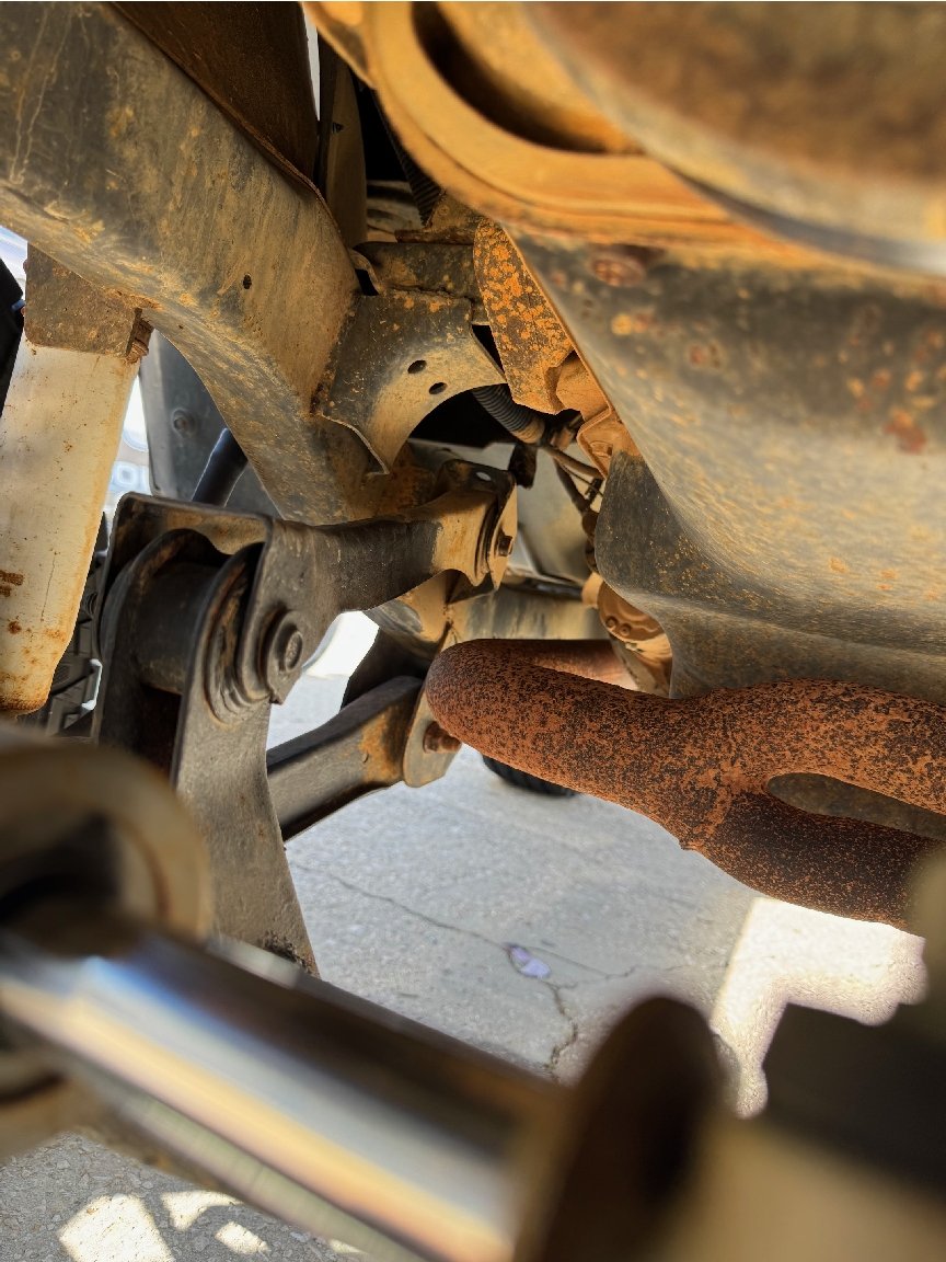

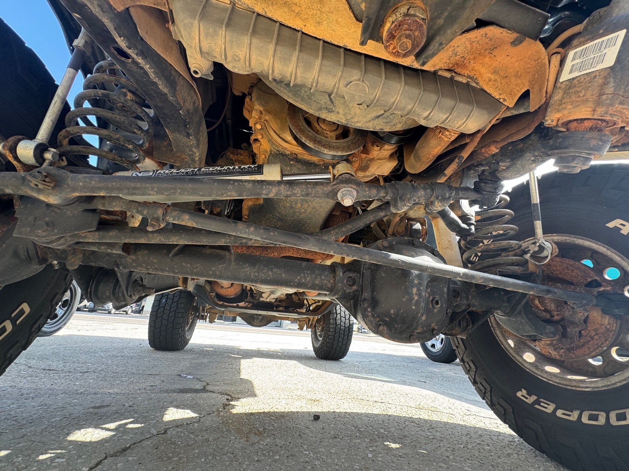

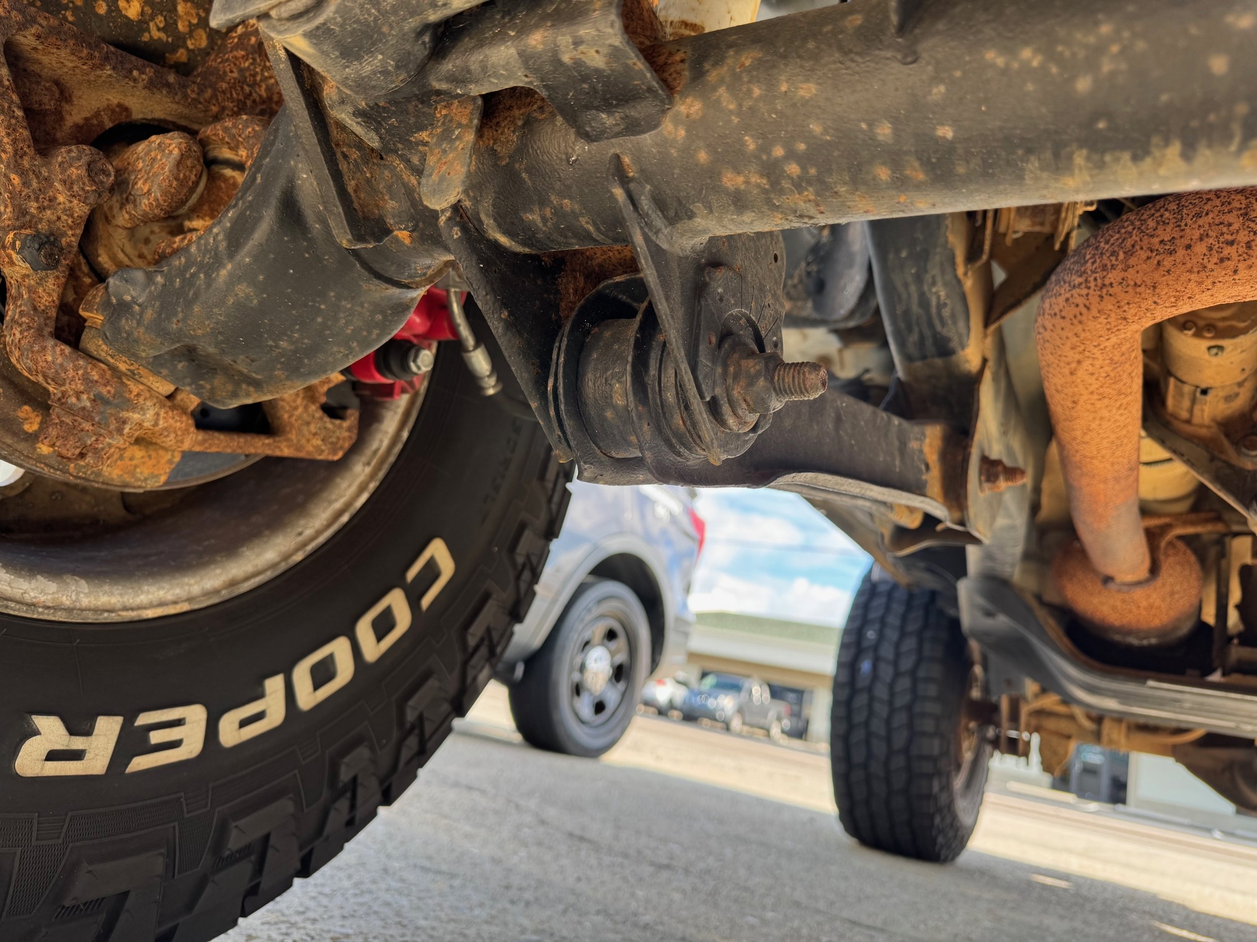

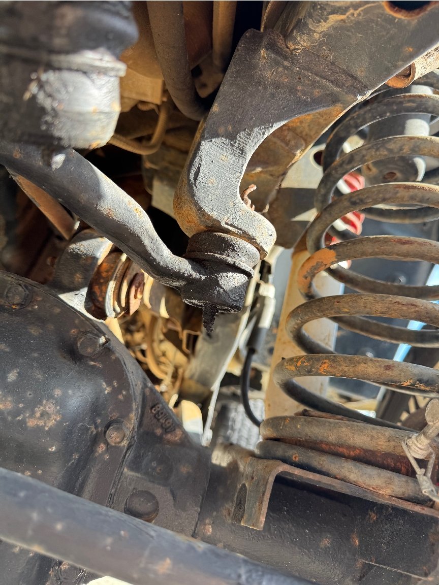

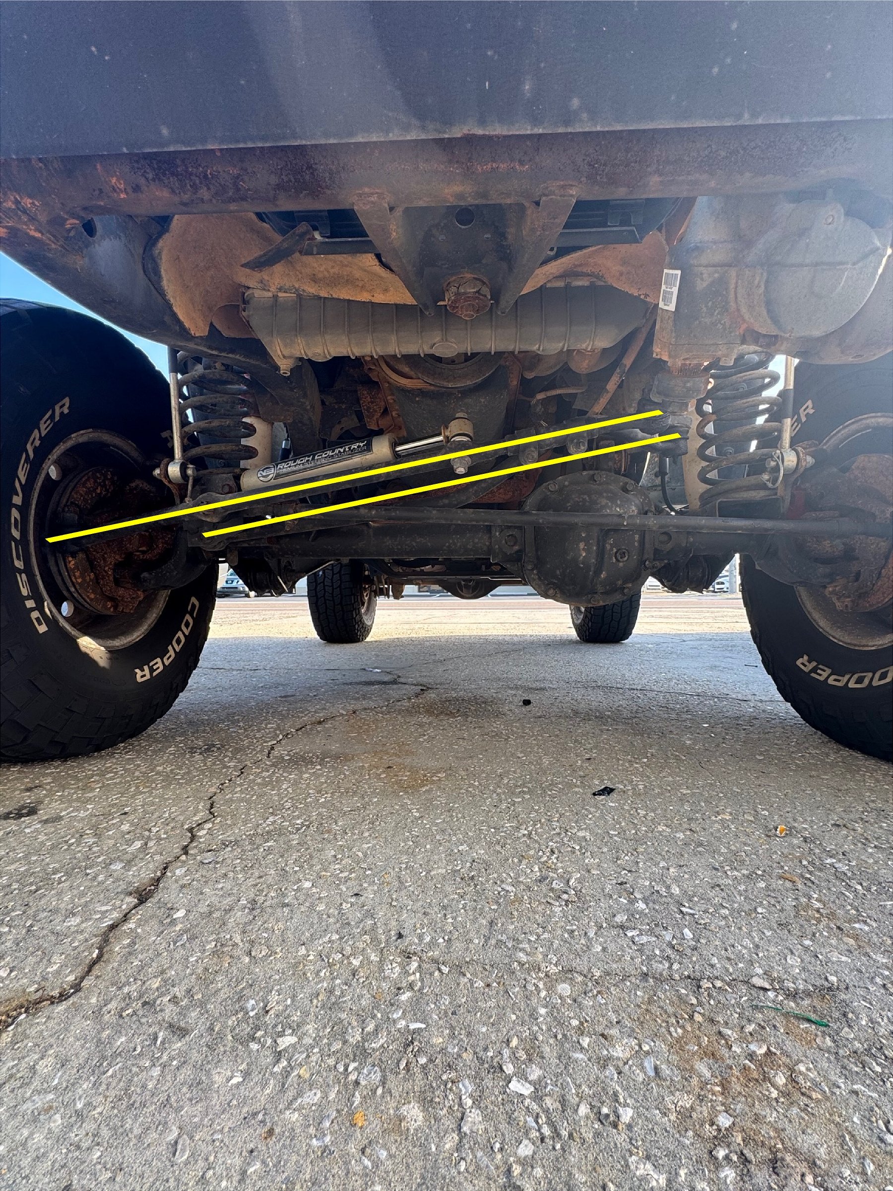

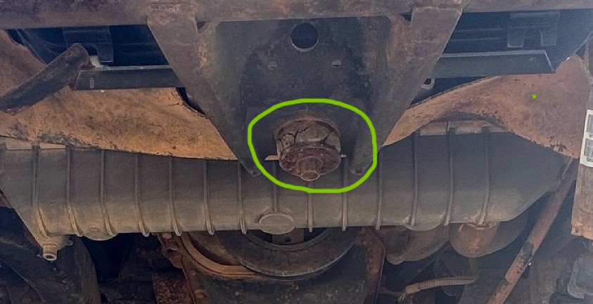

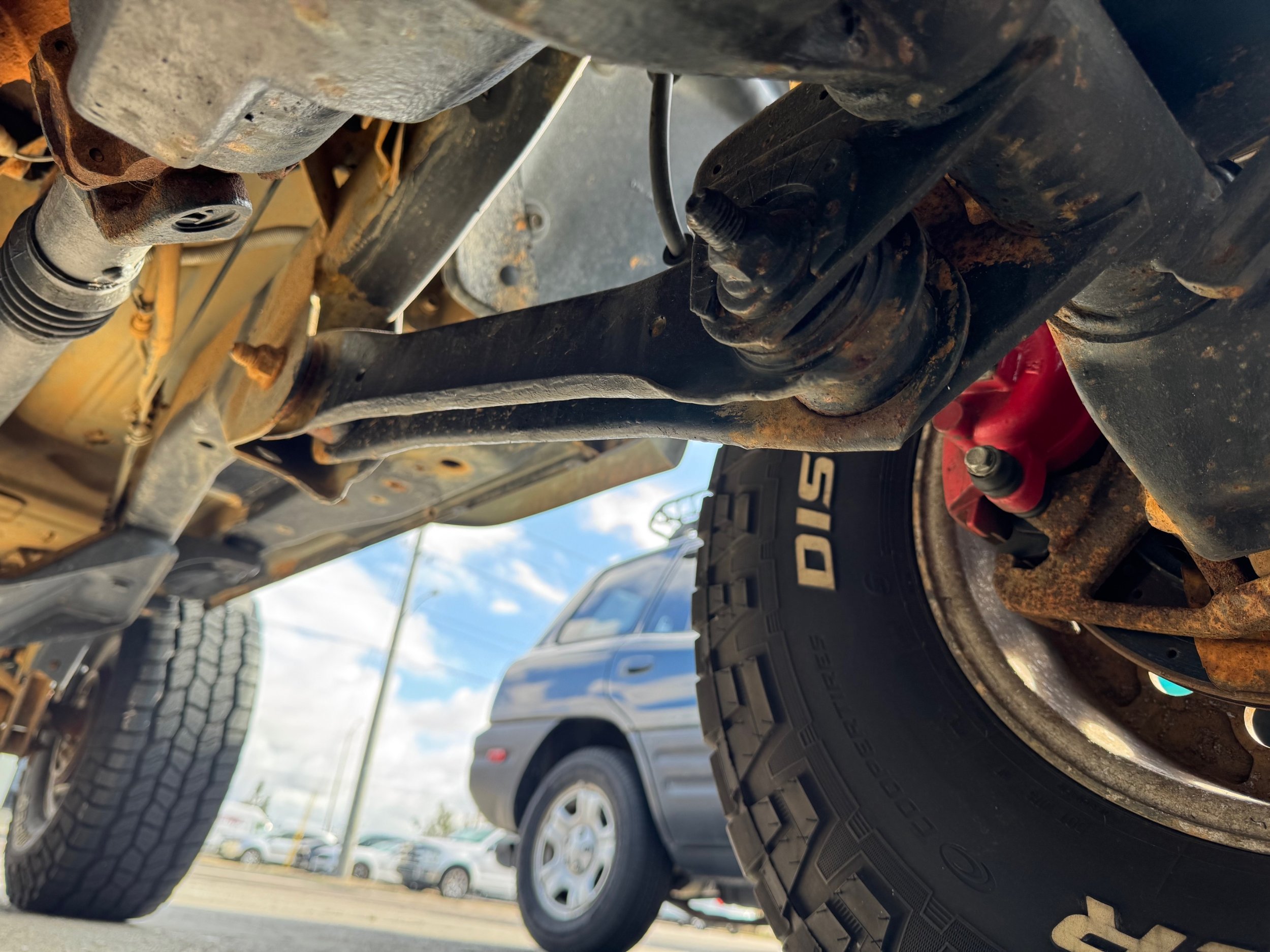

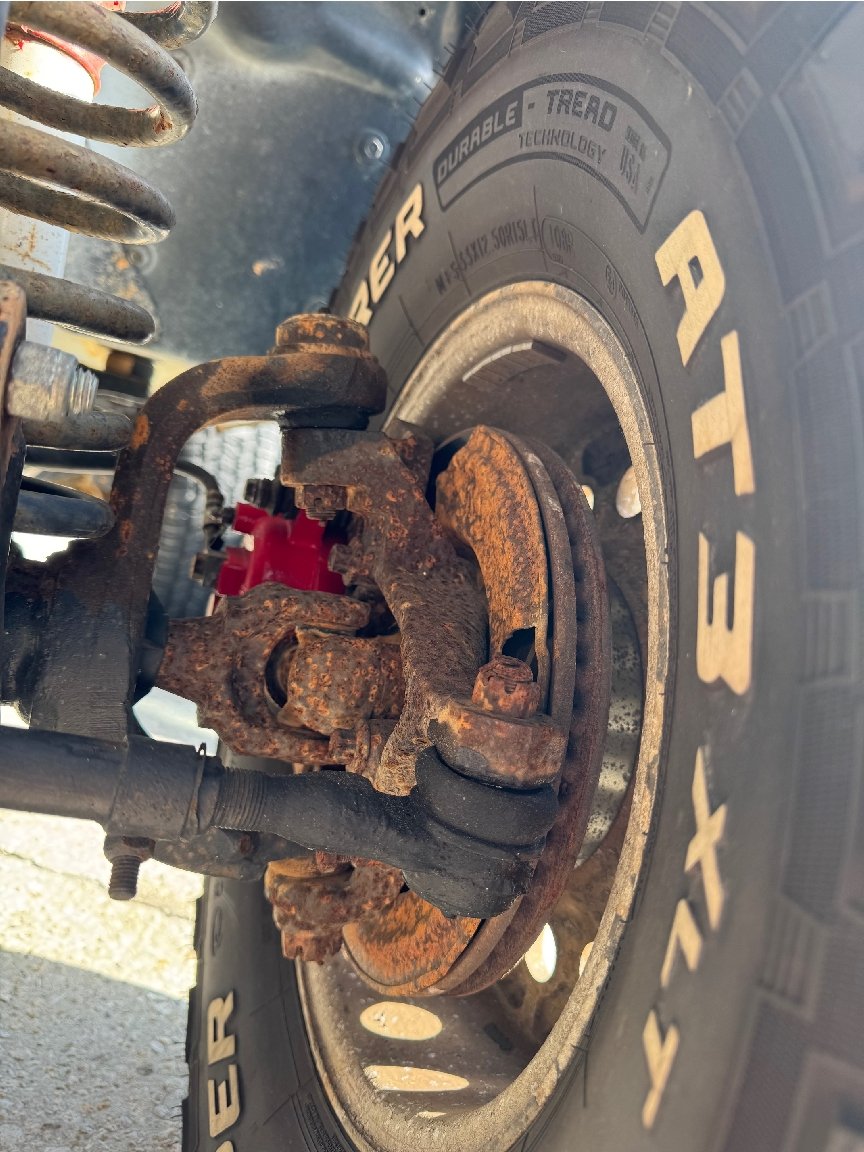

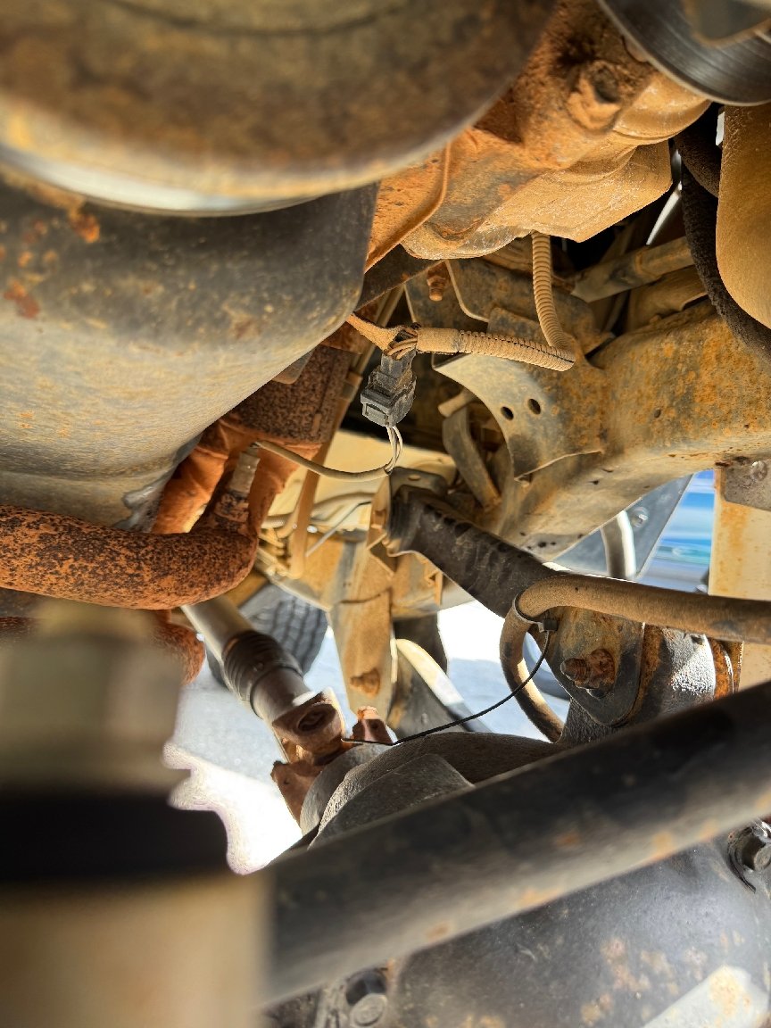

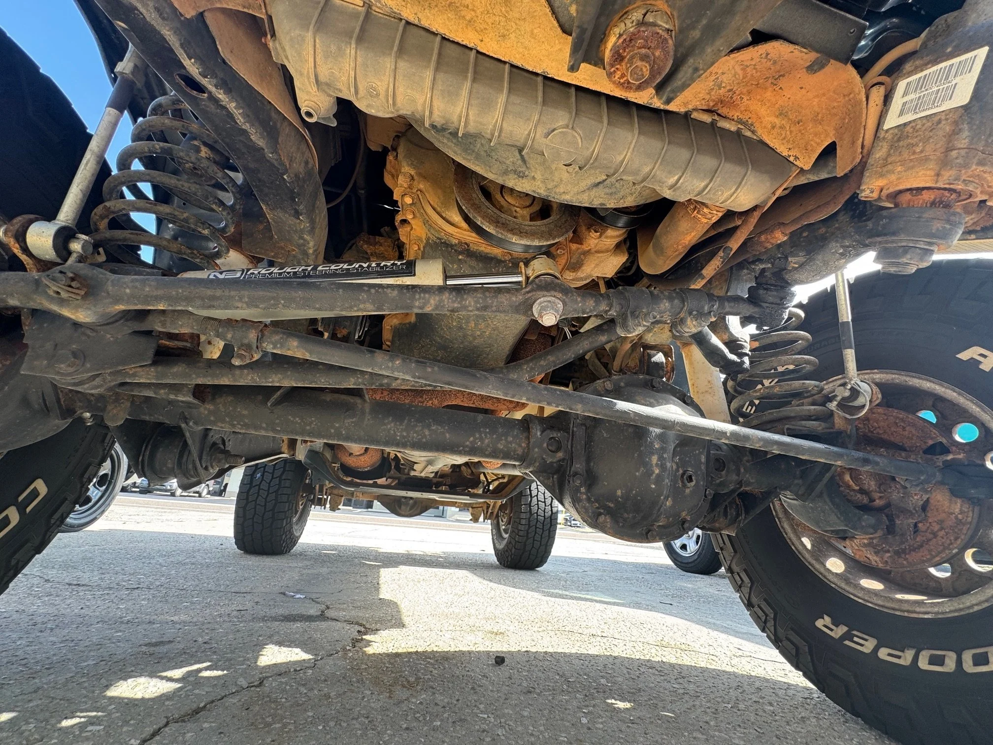

Hello all, I have been researching and coming back to this forum site and wanted to help support the forum as yall have been very helpful in the past with me just reading reply and discussions. Long story short I got my jeep back from a friend (no longer) who was paying me monthly until the full amount, but ended up stop paying so I recovered it. He had moved with it to Georgia from Florida, so there's a lot of mud that has caked everywhere. He blew out the clutch (which i've replaced) and it runs fine, but he also put a 4" lift on it, now it has the death wobble. I'm attaching pics so that yall can maybe have a better idea. I took it to a shop yesterday to have an alignment done on it as I put new tires on, but they told me the alignment has nothing to do with the wobble (I know from research it can have something to do with it, but it may not be my root cause). He did however come out and look it over with me and we found there is some play with the track bar when I moved the wheels back and fourth. I wanted to see if you guys saw anything wrong with the geometry and if there is anything else I should replace while I'm down there anyways. I'm kind of on a budget but I have to do what I have to do. It's a daily driver, I don't take it out mudding or anything - it will be a toy down the road but I need to be able to take it over 50mph for the foreseeable future.
I'm attaching a photo dump for reference. I noticed the tie rod ends aren't ideal but they're sturdy. Let me know what you think and any recommendations. I'm already looking at an adjustable track bar.
Thanks for your help, and happy to be here

Geometry wise I don't see anything wrong there.

From those pictures, all of the steering components and joints look to be original. I've worked on stock Jeeps in my circle that had death wobble and worn steering components were the culprit. A lift and bigger tires will only increase the stress on the stock worn components and make death wobble more likely. A worn track bar is usually a big contributor, as well as tie rod ends, control arm bushings, etc.
