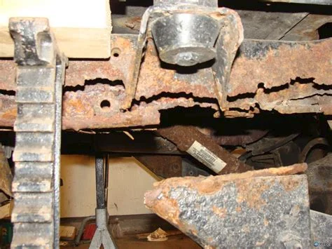

That is not frame rust....This is frame rust

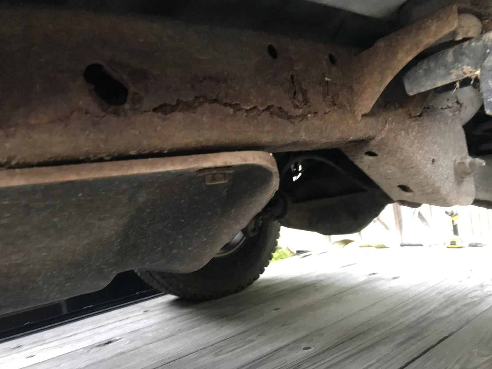

I bought this 2004 blue LJ and I went over this thing like crazy and everything looked flawless with zero rust. I get home today to take the chrome steps off and I am crawling around under neath again. Except this time I spot rust inside the frame by the front lower control arms...... I should have caught this before but having already purchased this, how bad did I screw up?
2004 LJ 83k miles
first picture is passenger side
Second is driver side
I stuck a scope inside some of the holes but I guess I missed these two.
I will scope around some more later tonight when my neighbor gets home with the scope.
