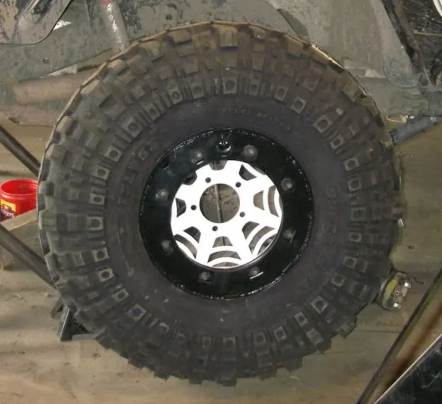

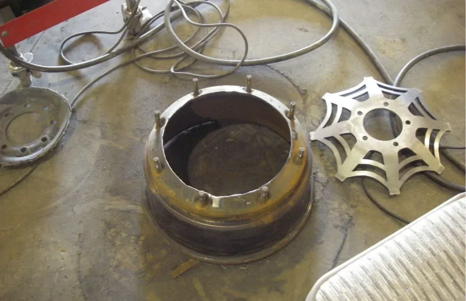

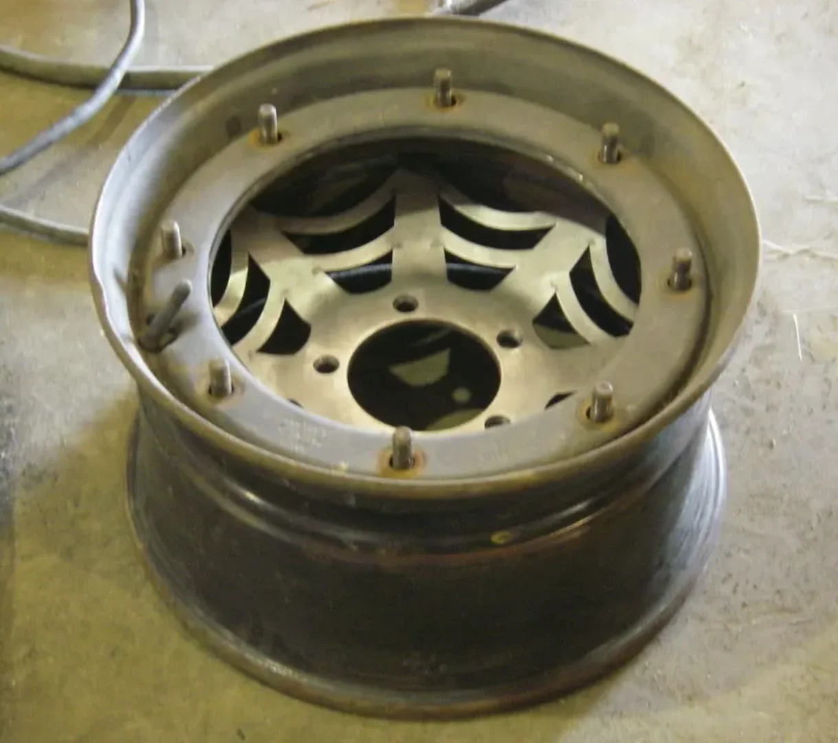

You cut out the centers and weld in new centers with the bolt pattern you want and you set your back spacing where you want.
Rock rings are your friend when running steel wheel.

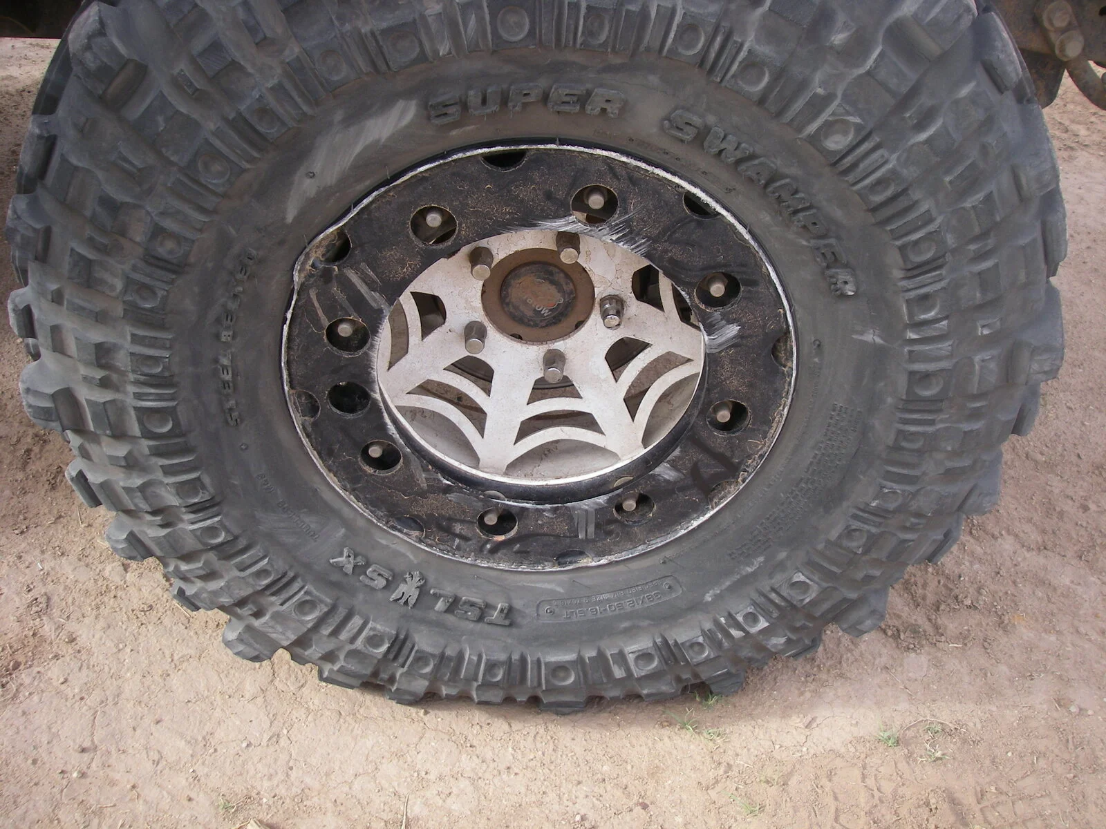

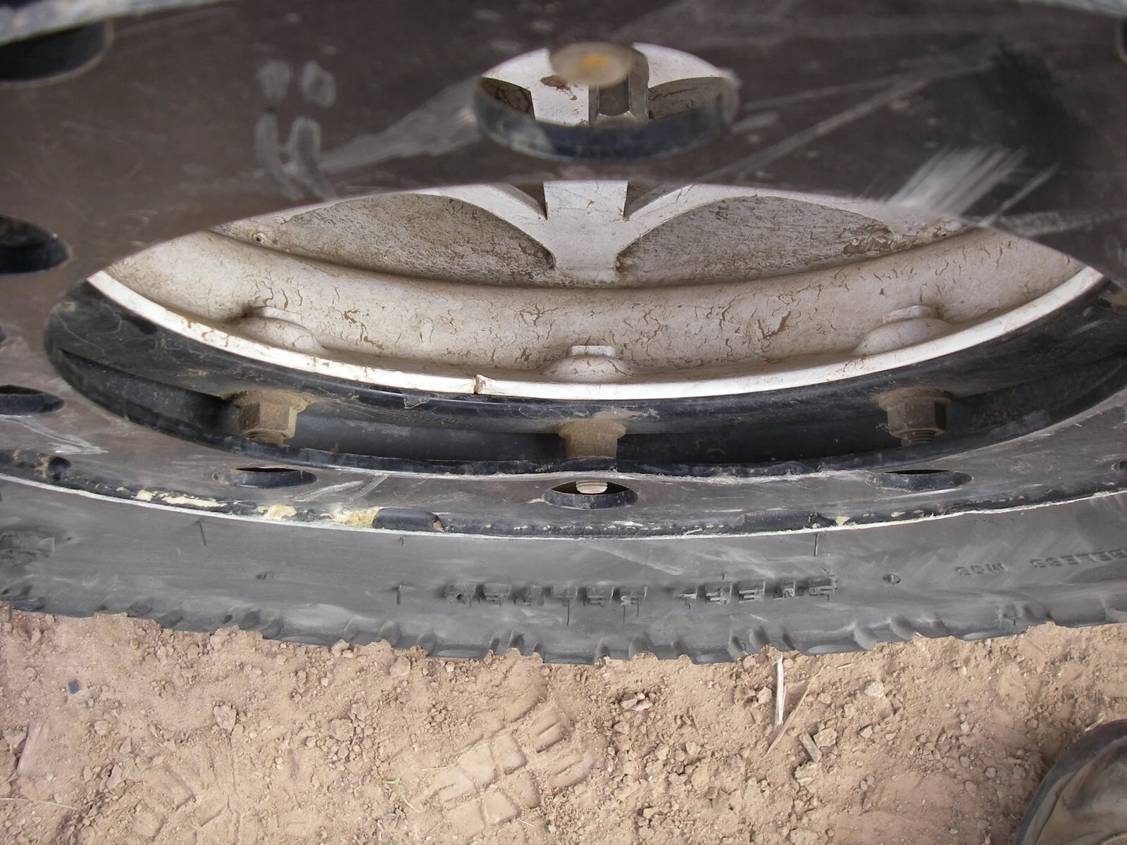

They looked really good for a short time.
First day in Moab I scratched them and bent them...

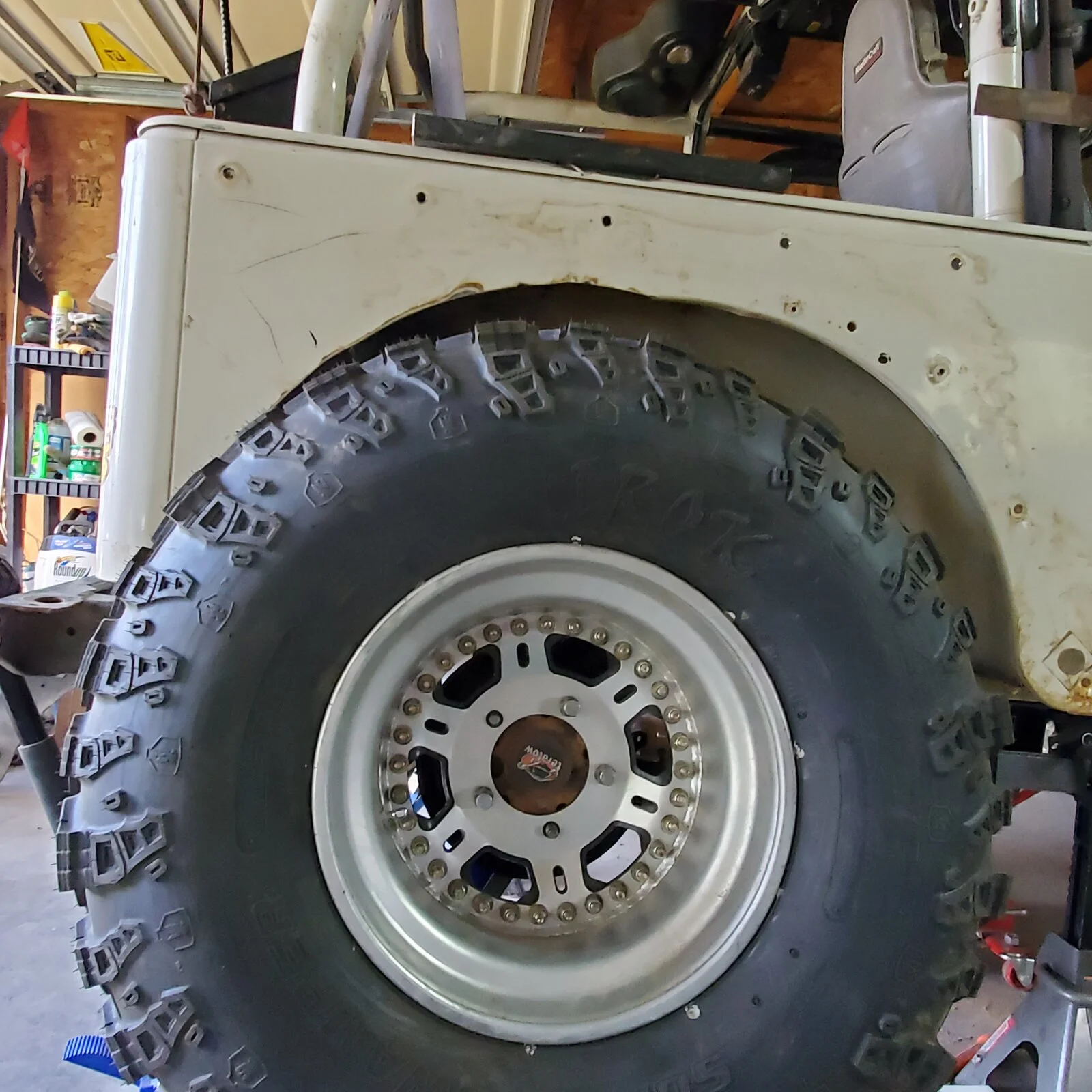

The main drawback to Hummer rims is the 16.5 size and you're about only going to find Interco tires in that size.

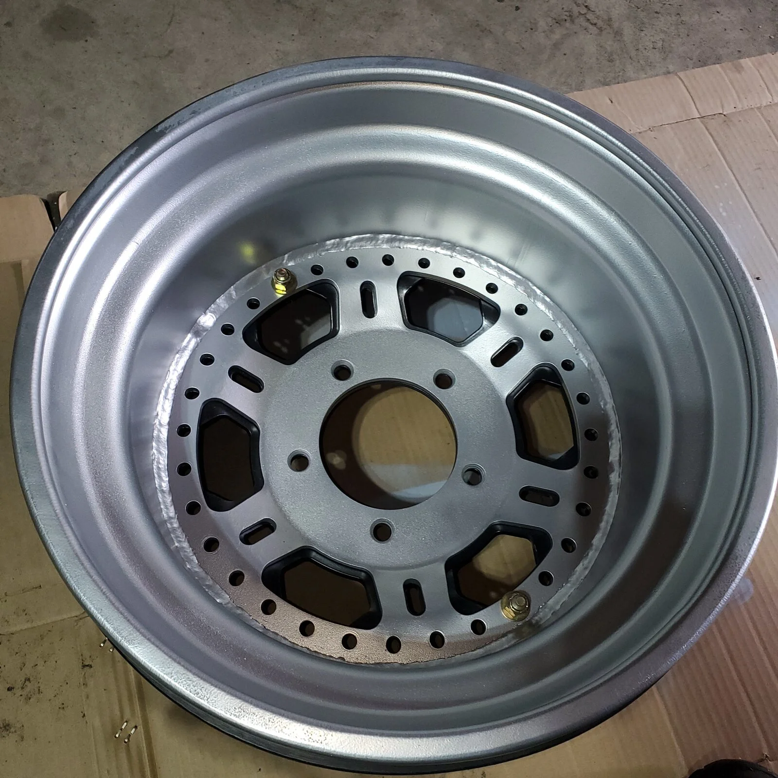

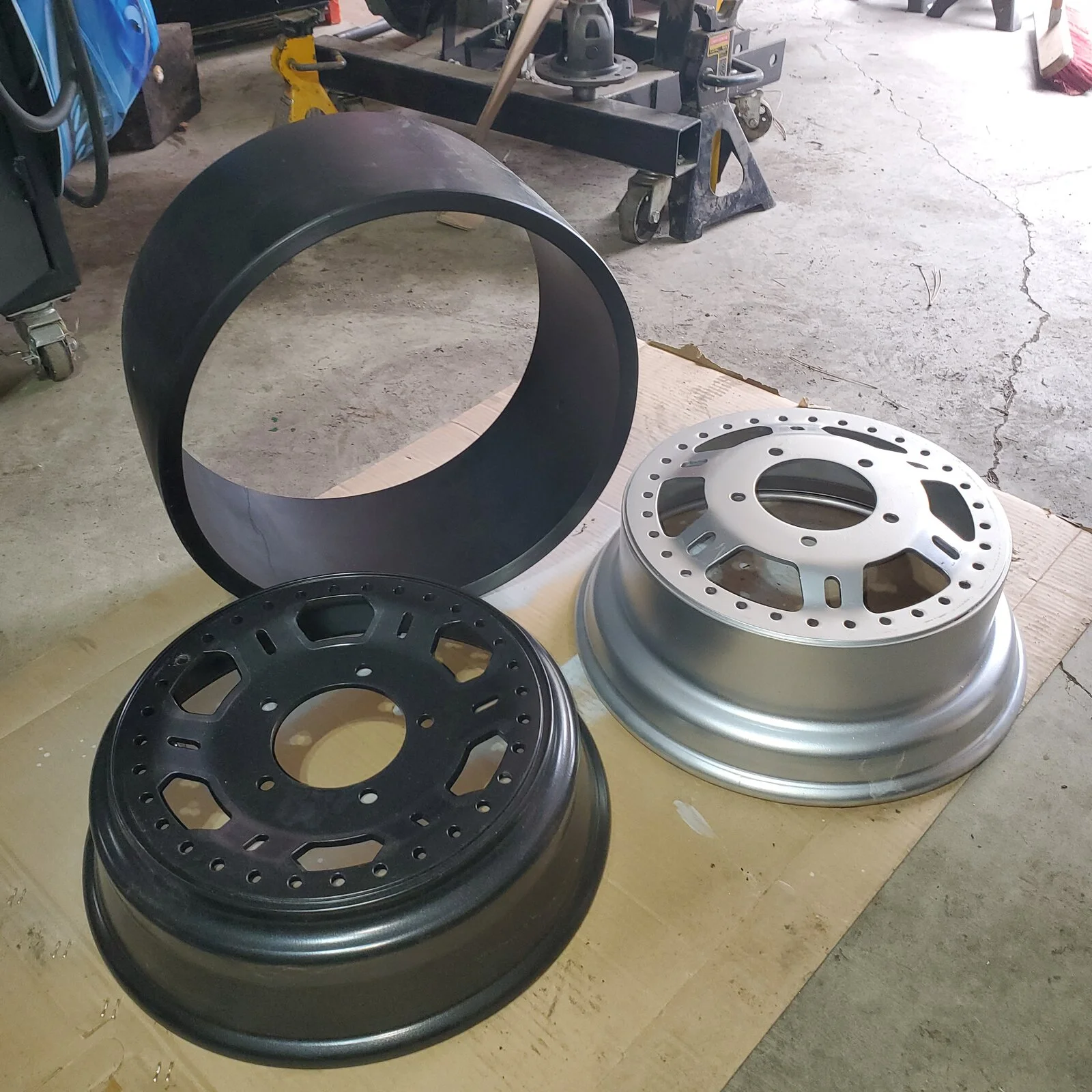

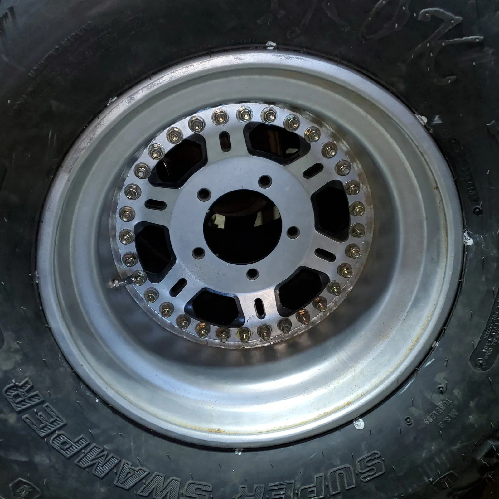

There is a company called StazWorks that makes the dual beadlock wheels in whatever size you want. They are steel so they ain't lite but they are nice wheels.
The insert fits in-between the two half's of the rim
Bolt them together and you have a dual beadlock wheel. I've ran them all the way down to 1 PSI too.

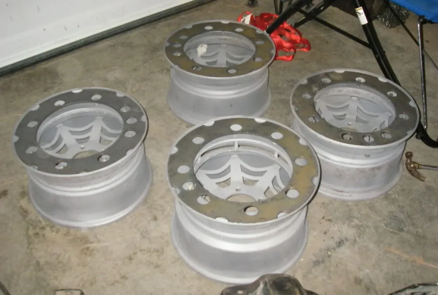

I ran the hummer wheels with weld in centers on a couple of off-road trucks but I don’t think I would run them on the highway. There was someone that took those wheels and recentered them on a lathe to your specs but I can’t remember who that was.
10 years ago I think it was easier to find a few companies that recentered the Hummer wheels. For the price StazWorks is your better deal. And you can get a 17" or 15" or whichever you want. You have a choice of different center designs and widths plus they come powder coated in your choice of colors too.
My recentered wheels were not highway friendly.
