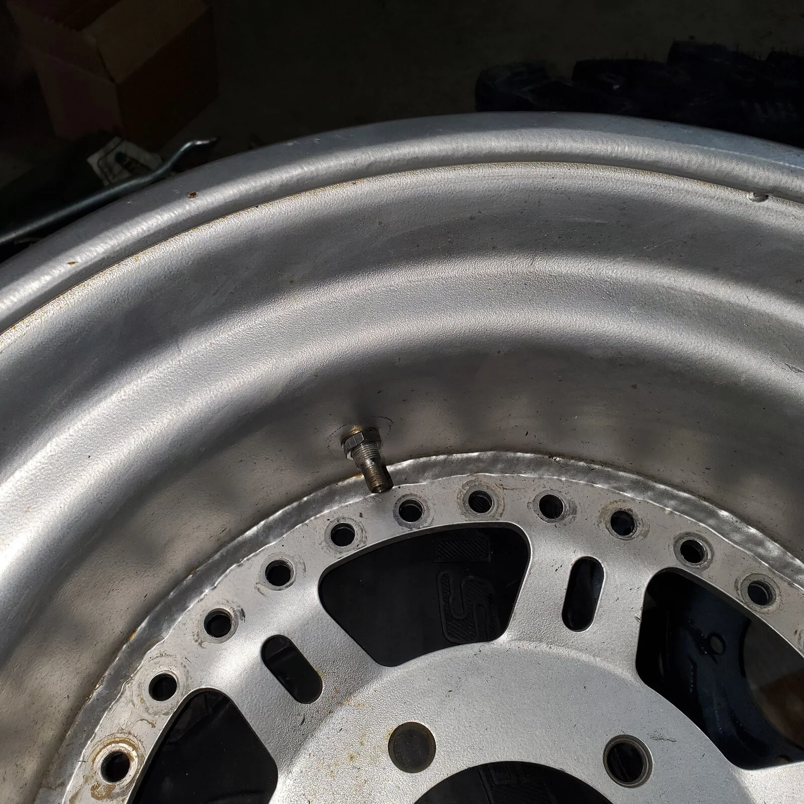

See how big the lip on this rim is? It's because of the cold role ring.

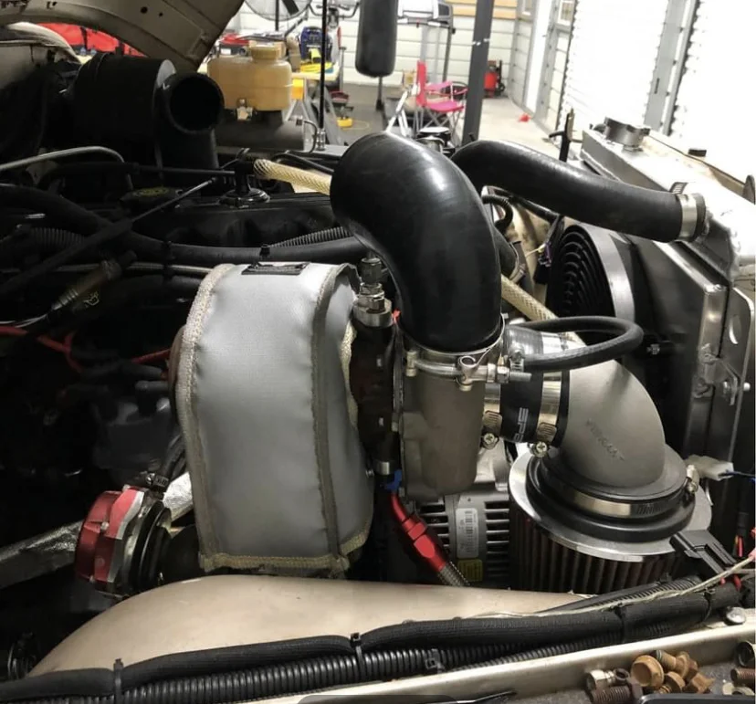

I might have mentioned it but I bought a used turbo setup for the 4.0. I plan to run it in the interim until the om617 is ready to go in. Couple buddies have already informed me I might not want to go back to the diesel after running the turbo setup. This is is a built setup that runs about 7psi in normal operation. Quick spring change in the wastegate will push it to 10 if needed. Current owner states it’s a hell of a lot of fun to drive. Ha!! I queasy we will find out.

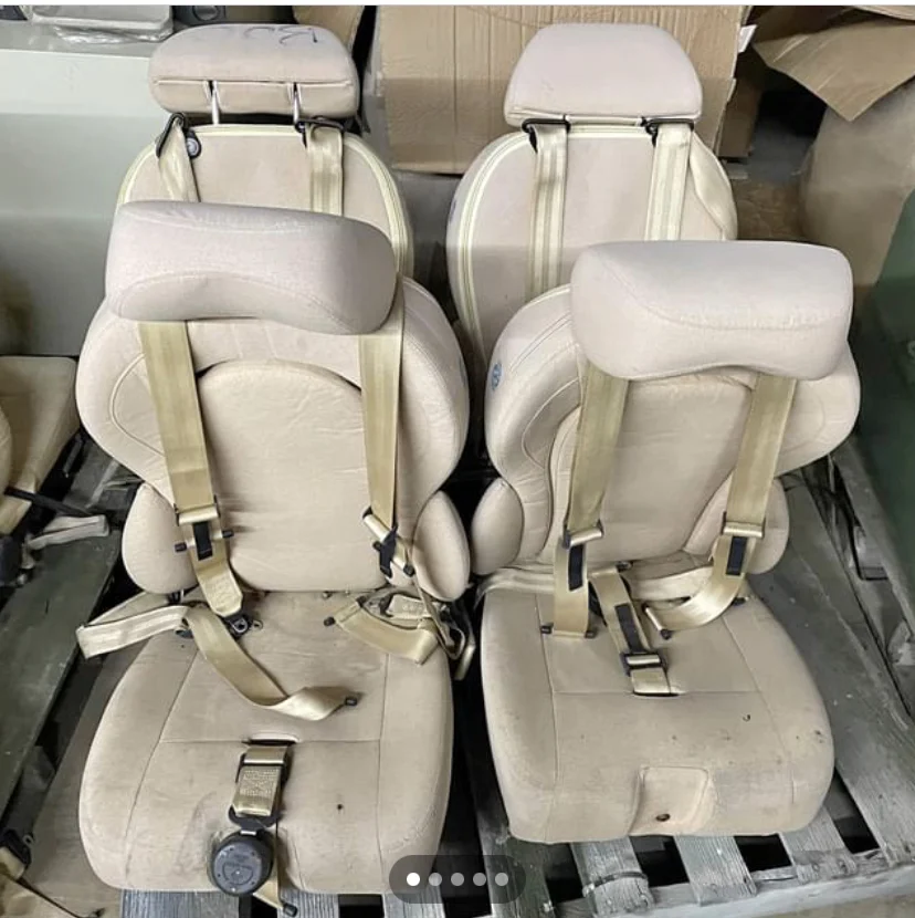

Another part I picked up was a pair of these MRAP seats. I’ve used them in the past for builds and I really like them. I’ll graft these to the jeep seat bases for now. Then mount them to the new cage after it’s built. The super dense memory foam in these seats makes riding for long road trips really nice. If you get a chance I highly recommend a set.
