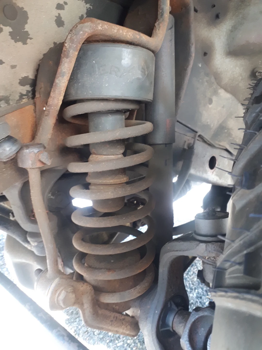

Ya, Athena, that's what my fronts looked like. I wiped them down to see if I could identify them and came up with a KYB Excel-G decal. Don't know what people think of KYB's on this forum, but on the ebodies.org forum, people don't like'em much. (My other toy is a 440 Challenger)
If you had to wipe them down, then they might be leaking.
Did a little reading on Jerry's alignment thread and went out to inspect the front end for 'other' issues even though a garage just certified it. Found the tie rod has a definite arc to it. Prolly supposed to be straight.![]()
