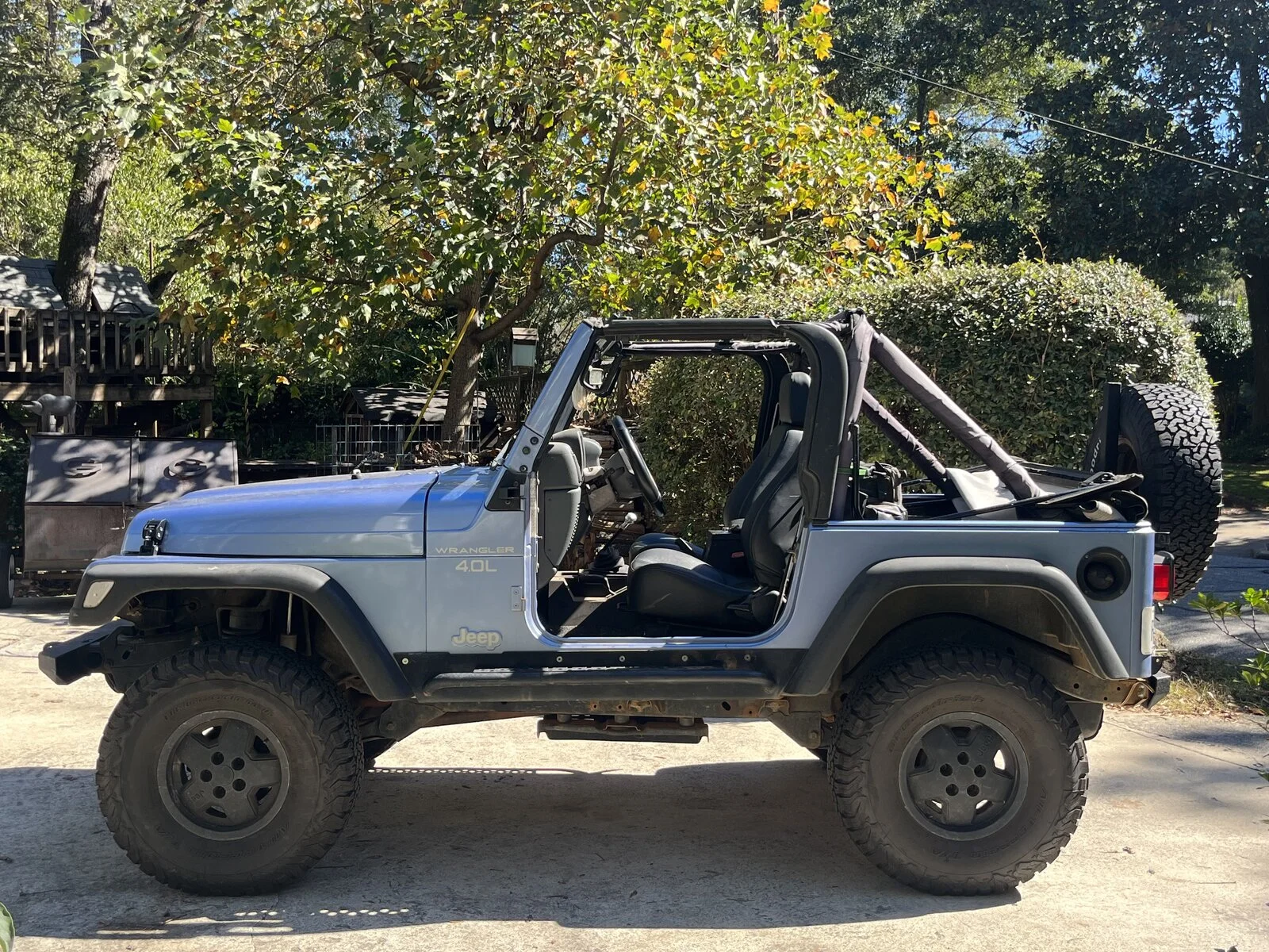

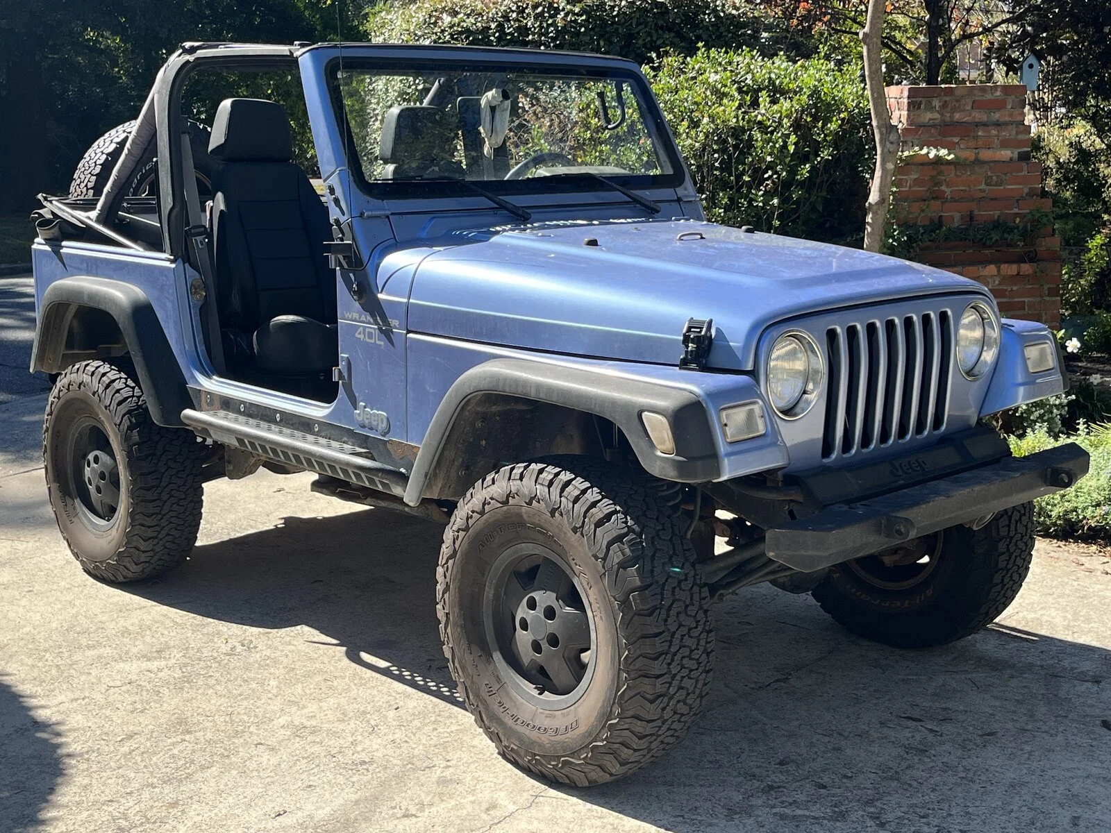

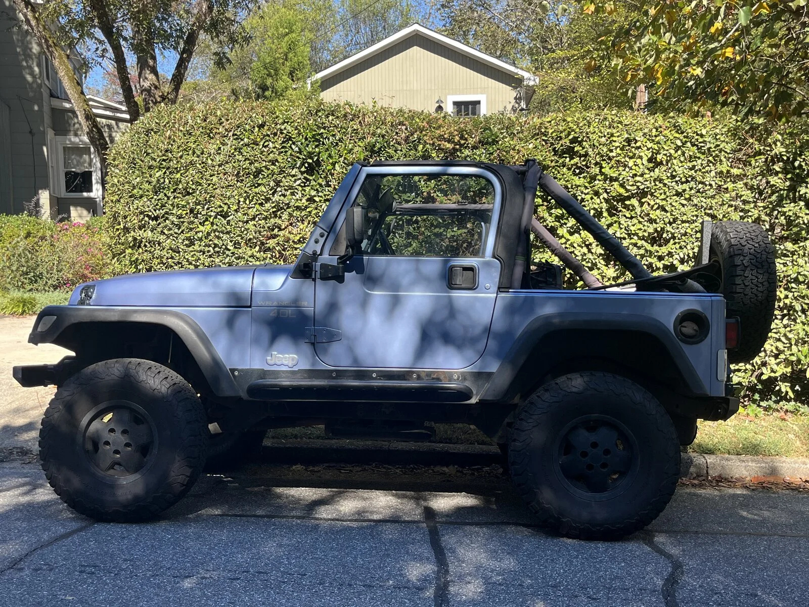

I may be tripping but does my rake look right? I just put a heavier bumper on the back and now I’m worried that my Jeep is squatted a little or something stupid.

The 'factory' rake will change slightly and constantly with the weight of passengers, fuel, gear, and modifications.
It is what it is.
Or add a winch to the front. ;)
How much more distance should the front fenders have from the tires compared to the rear?
This is how I understand it, and I could be wrong.
The tops of the flares are mounted at the same height on the Jeep.
The rear flare hangs down farther than the front, so the rake is less noticeable.
The space between the flares and the tires is what you notice the most.
If your Jeep is exactly level, it may look like it's squatting due to less space in the rear (with factory flares).

All jokes aside I'm pretty sure your jeep is spot on as far as the factory rake. If you were aiming for a bit of rake in the rear, you got it.
I personally like to keep only a bare minimum rake of half an inch or three quarters, for the purposes of cargo loading in the rear, towing a trailer, etc. How much rake is desirable is highly subjective and depends on what you're going to be doing, what weight, what springs, and personal taste. My TJ had a rake of 1.5 inches, when it was bone stock. I added a 1.25 inch spacer to the front and it's close to level. My LJ had a rake of 2 inches but the previous owner's lift had made it worse from stock (it was 2 inches lift in front 2.25 rear). So now I'm at 3.5 inches lift front and 2.25 inches rear and I think it's perfect. I have a rake of about half an inch with hardtop, stock bumpers, rear seats and spare tire included.
If you plan on going to a hardtop then you need to add the top and put all your gear inside then measure from the fender flares. It's not a precise method of doing things but let's face it, that's what were looking at right. No one is taking a tape measure to a jeeps springs in a parking lot, they are just eyeballing the gap in the fenders.
