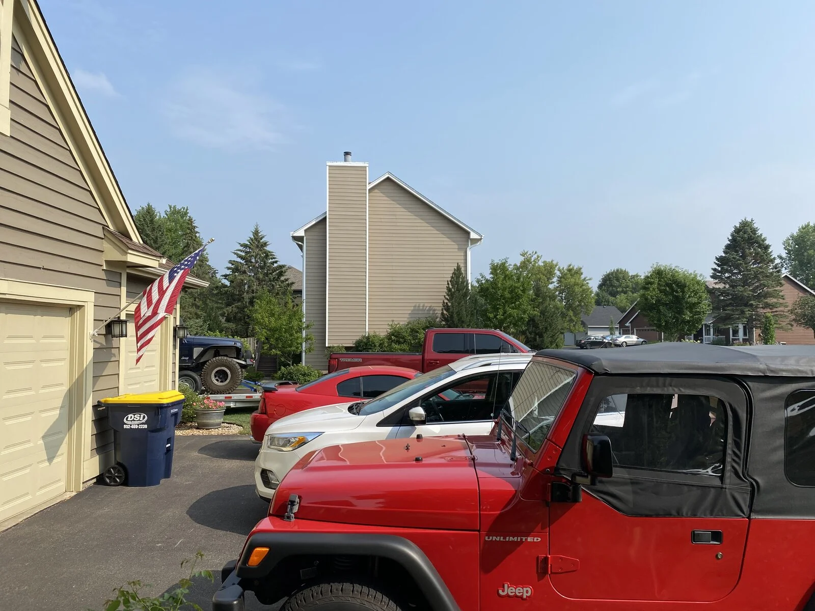

How about my red Jeep?That would be OK in @JMT’s red jeep - but not so much in yours, Ryan.
Think about it…
