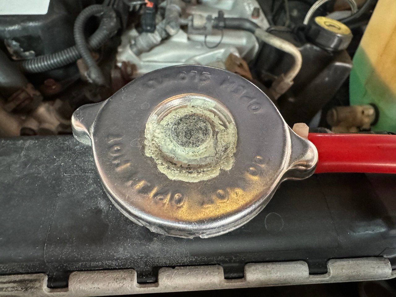

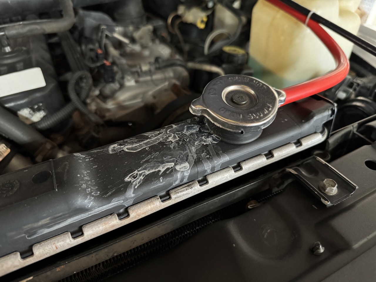

Looks like I might be needing a new radiator cap. Is Stant the go-to recommendation?
I might not bother with this, but I'm thinking of swapping my driver and passenger seat around so that I can mount them farther apart. I've got Corbeau seats that aren't designed for a TJ and the recline lever runs into the roll bar. Because of that, the seat isn't quite centered on the steering wheel. It looks like I can move it at least an inch or two before it touches the door.
I'll have to make sure the seat belt receiver doesn't get in the way of the lever though.
FYI, Liberties of the same vintage use the same PDC as well. I went to the pick and pull, looking for a cherokee, but ended up salvaging a PDC from a liberty for 15 bucks or something.
Try to get a Mopar radiator cap and thermostat when at all possible.
The quality on Stant nowadays is highly suspect. MotoRad pretty much rules both those markets now and they are lacking…
Good info. Looking at my radiator cap, it does look similar to what MotoRad sells, so maybe there's correlation there. I'm sure my thermostat is just some parts store junk I put in about 6 years ago. Mopar stuff is getting harder to find for these Jeeps, but looks like Summit has what I need. Thinking of just going ahead and doing a thermocure flush while I've got the system opened up for a new thermostat.

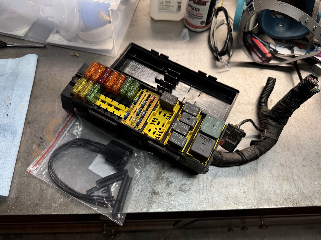

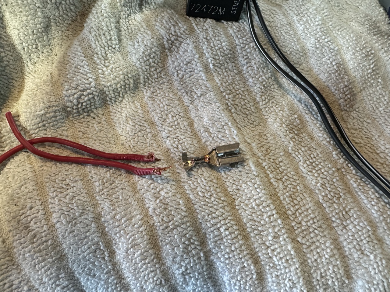

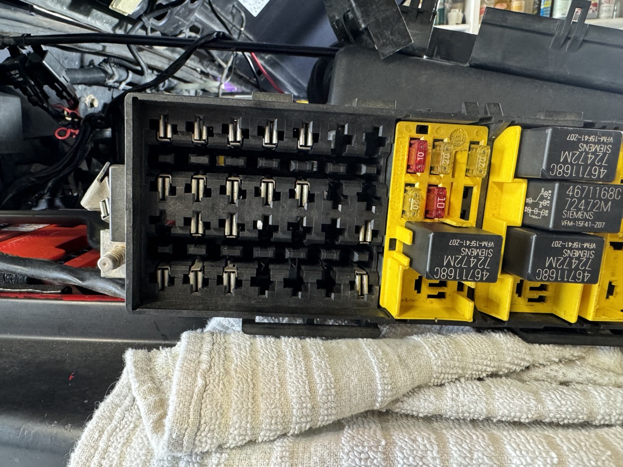

Got the XJ PDC in, along with the JK fan connector pigtail. The pigtail I ordered was actually for a '10-15 mustang, way cheaper on eBay than the ones for a JK, but it is the same connector.

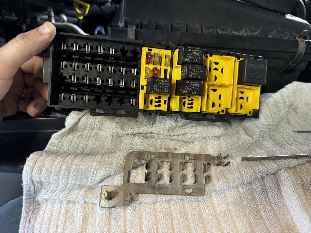

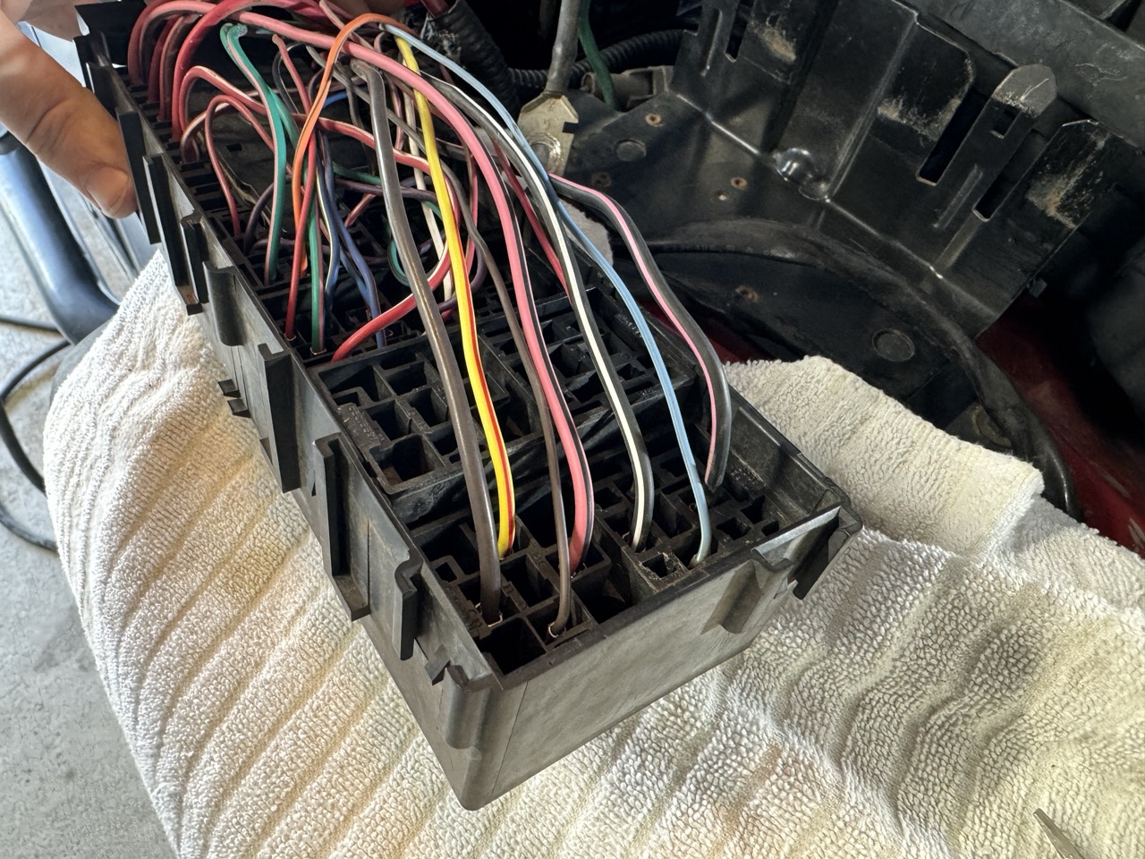

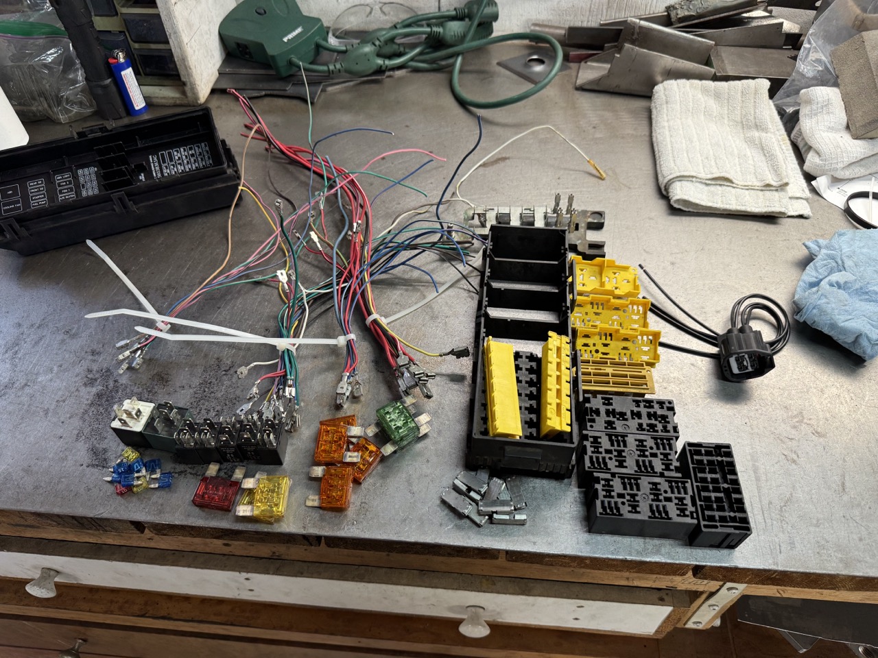

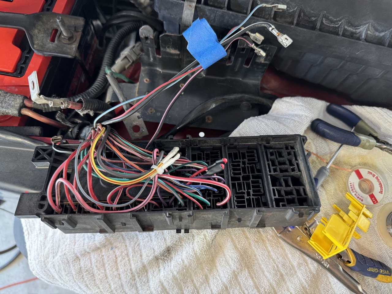

After a very tedious time, it's fully disassembled:
The plastics are extremely brittle and I ended up breaking a number of the plastic tabs. Glad I got some practice in before messing with the TJ PDC.

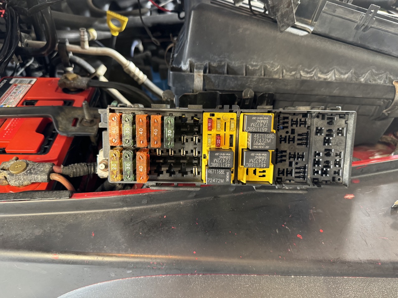

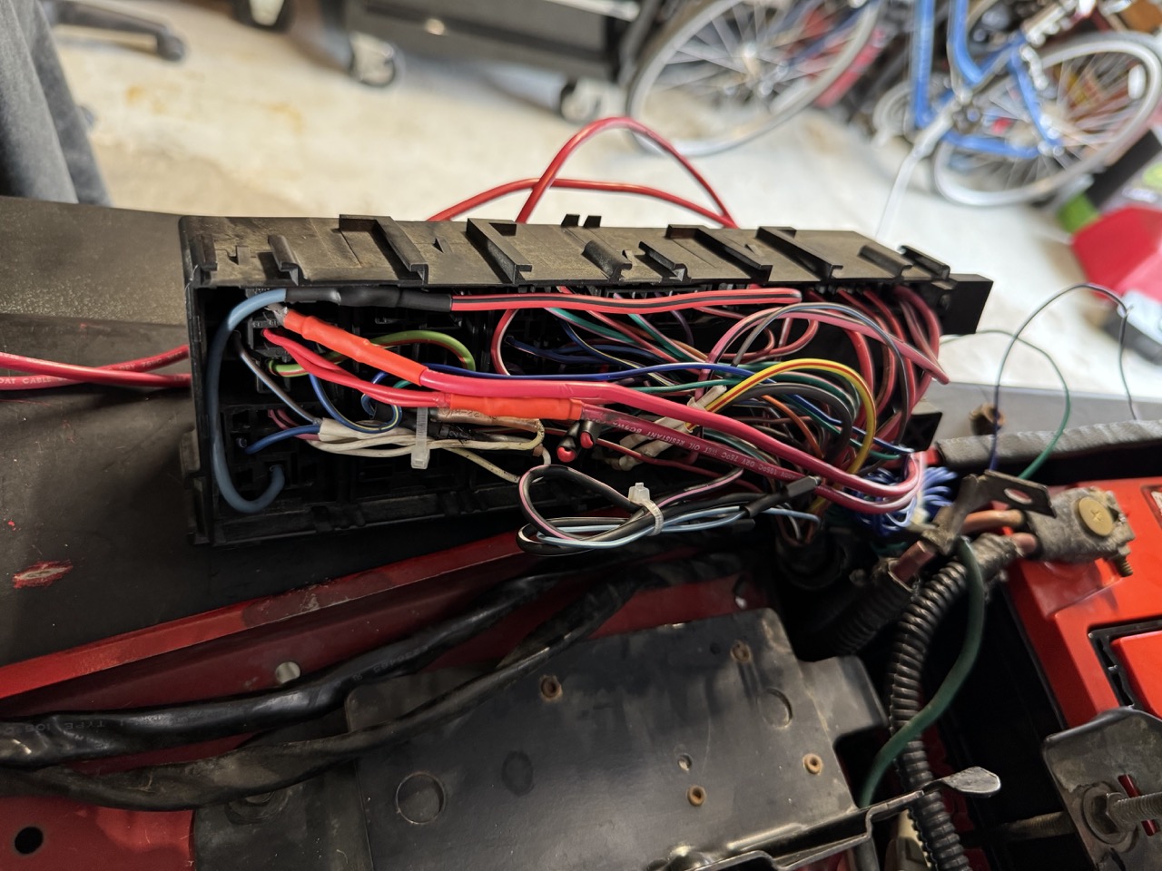

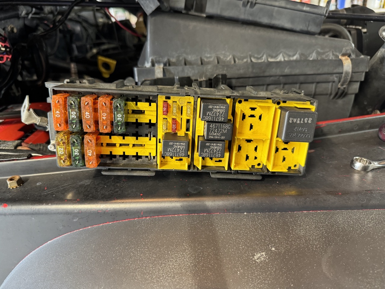

Here's a before shot of mine, just for reference:
As you can see here, I've got 5 empty maxi fuse slots. I wanted to make them all available for future use, so needed to insert some connectors.
After carefully prying the bus bar out the back, I popped in the missing connectors down the middle two rows. The outside rows are added in with the wiring, which I'll just add when needed.

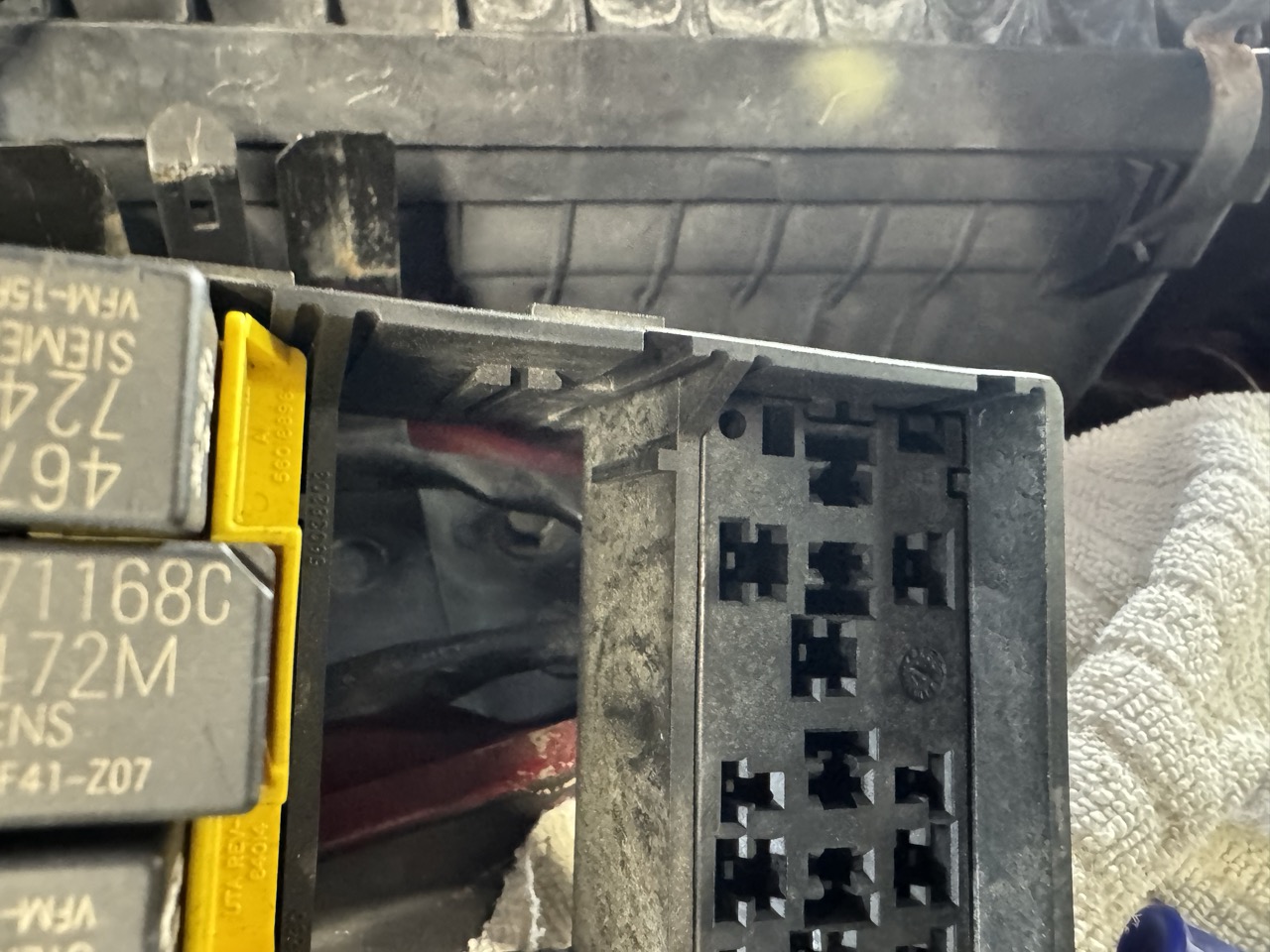

Next, wanted to swap one of my 2 slot large relay inserts for a 4 slot small relay insert. I wasn't able to get it past the wiring, so I had to de-pin the last row as well.
You will need to file off this tab from the PDC frame to fit in the different relay configuration

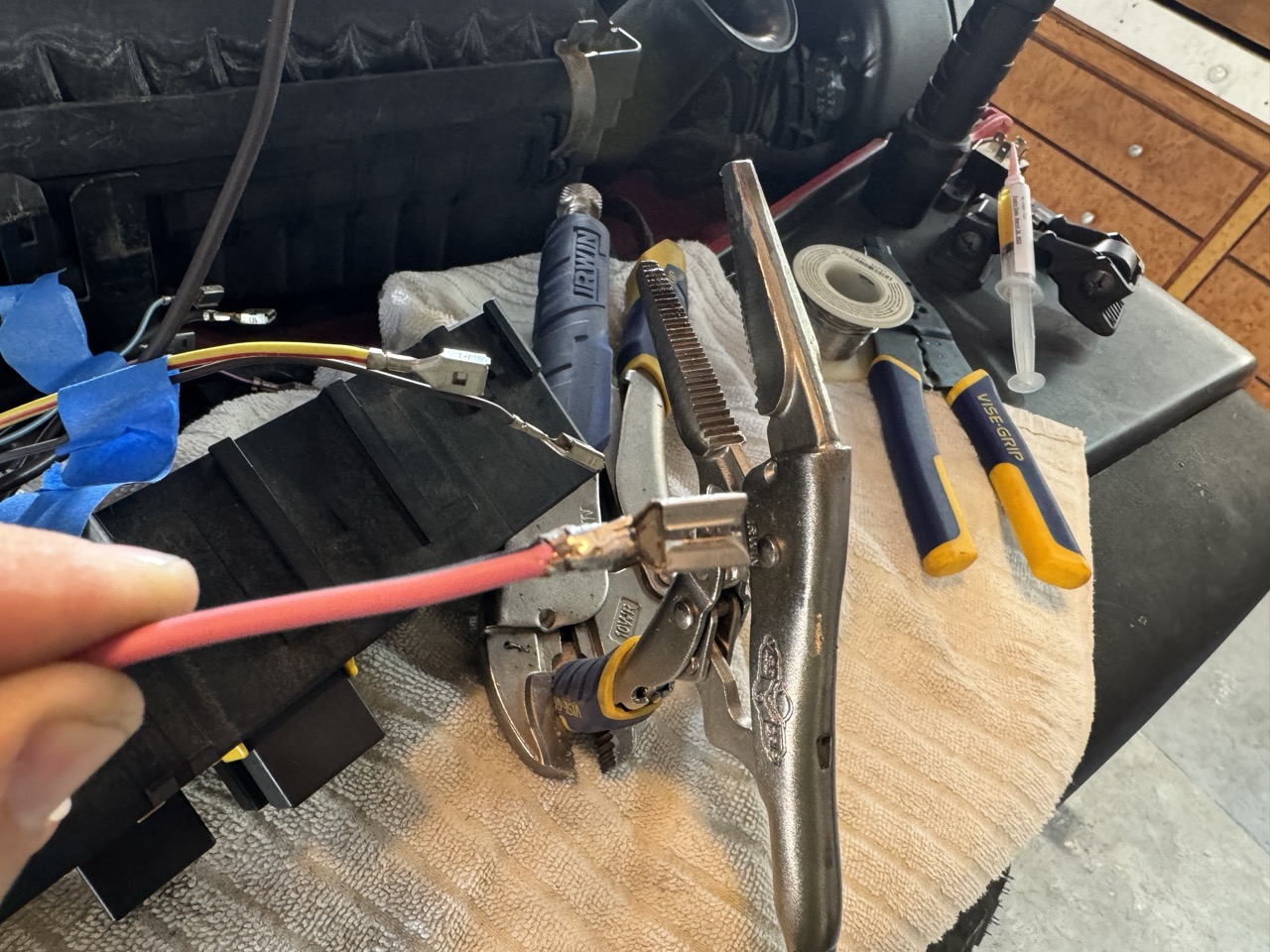

Next, since the starter relay was already de-pinned from the end, I wanted to convert it to a small relay like you see on later TJs and also relocate it. I'm not sure what the current requirements are for the circuit, just assuming it will be fine since it is on later models.
The connectors are different, so I needed to snip the end off the factory harness and add in one of the harvested ones from the XJ. I (carefully) ripped the connector off the wire.
Then I soldered it onto the factory wire. I don't generally like to solder automotive wires, but none of the harvested wires were close enough in wire size to just use a butt connector. I had heat shrink on there for strain relief, but I had to cut it back off for it to fit in the fuse box.
Got the relay moved to up near the mini fuses. Zip tie so the wires share any strain. The other wires in the background with the blue tape are for the rear window defrost, but I don't use that so I'll just insulate the contacts and tuck those wires away somewhere.
As careful as I was, I still broke two plastic tabs when inserting the connectors to the housing, so had to load them up with some hot glue. Seemed to be adequate to get the relay plugged in though. I used butt connectors for the smaller trigger wires.
Got the box reassembled enough to test that the Jeep still starts, and it did!
The two big relay spots will be used for low/high speed fan relays, and that leaves me with 5 more slots for other things, like lights or air pumps.
Overall I think it will make it so my PDC does everything I will need it to do, but I can't say I'd recommend this to others. The plastics are just so brittle you're likely to screw something up, like those two contacts that are only held in by hot glue now.

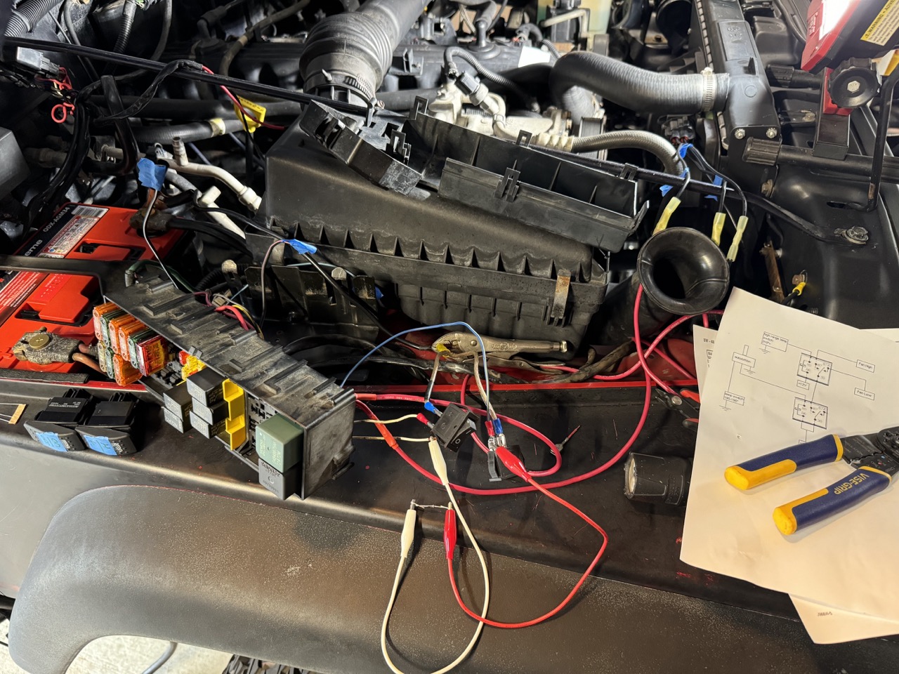

Alright, I'm no electrician but I think I've got this figured out.
The fan is just High-Low-Off. Low just sends power through a resistor before the DC motor. No PWM or anything. This probably won't apply to more complicated fans.
The diagram I'm using for reference is from another forum, but I liked the functionality and simplicity. I did have to modify it slightly, so I'll try to make my own diagram of what I did and post it later on. I probably won't bother with the auto/off/on switch, but will definitely be adding an A/C switch somehow.
Here's the mess I've got put together for testing.
  • Switched +12v is supplied from the previously de-pinned rear defrost trigger wire (red/light green). It is fused at #11 behind the glove box and goes to 86 on both relays. This is on ACC power, so the fan can still run when the engine is off but key is on
  • The black relay is the ON/OFF trigger
  • The green relay is for speed control. Normal state sends power to LOW, triggering the relay diverts power to HIGH
  • The left rocker switch simulates the LOW temp trigger, which would be a thermal switch in the coolant loop, or trigger from some fan controller
  • The right rocker switch simulates the HIGH temp trigger, would be another thermal switch -or- A/C on (I think normally done through a refrigerant pressure switch/trinary switch)
  • The input side of both rocker switches are connected so that when HIGH is triggered, it also triggers the ON/OFF relay so the circuit will complete. This is so the A/C can trigger the fan even if the coolant temp is below the low threshold.
  • A diode was added (seen on alligator clips) to prevent the ON trigger from also completing the HIGH circuit
Everything seems to be working as expected in this configuration, so I guess it's time to get it more finalized. I don't really know anything about diodes, so I'll need to make sure the one I used is appropriate. It's just one I had. Wiring is tricky!
Reactions: Wildman and Sj's TJ

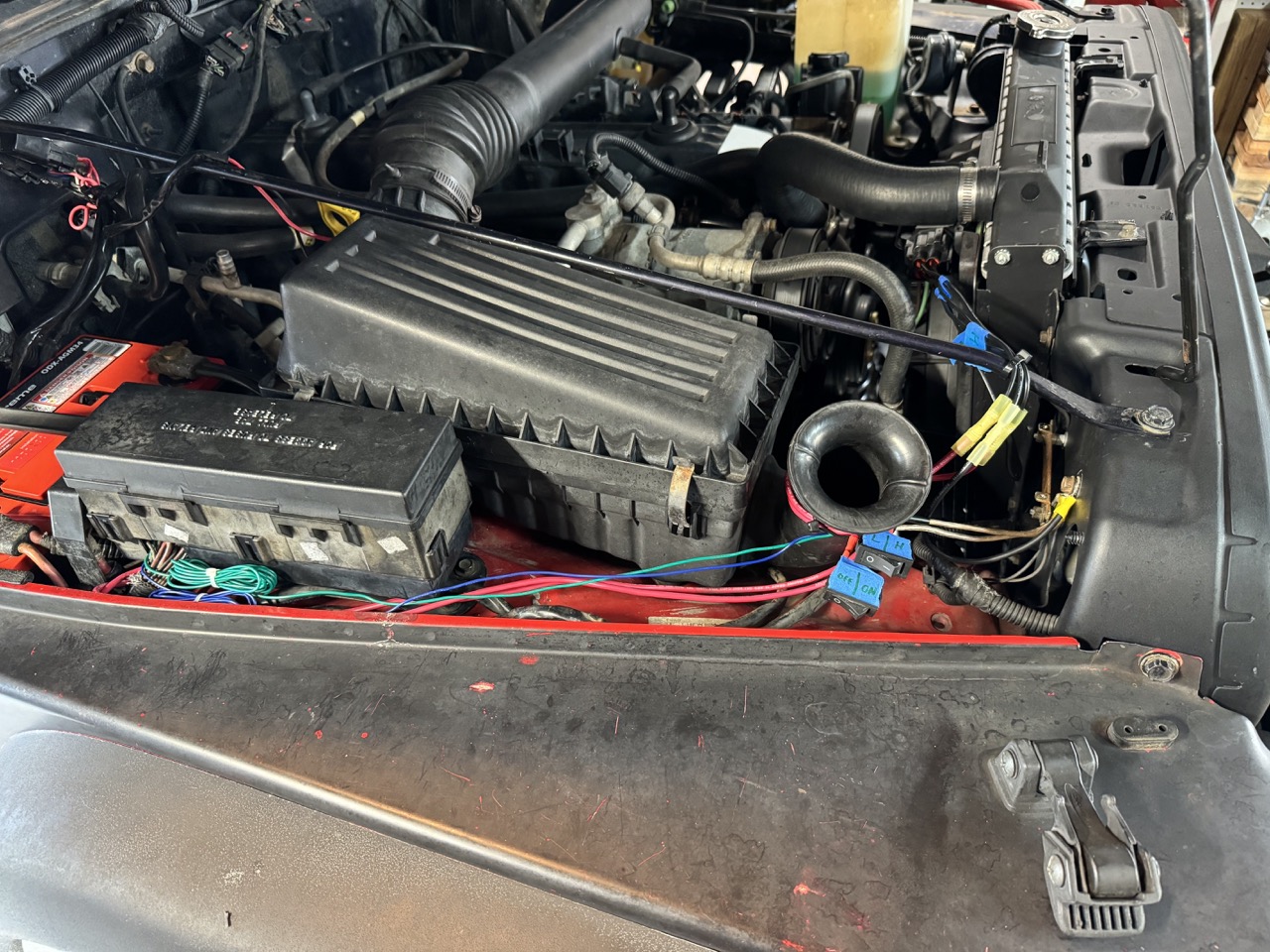

Realized I never posted a final pic of my fan wiring, at least how it is for now.
Having the relay control on a switched power source has been great, I don't have to pop the hood open and connect or disconnect an alligator clip from the battery every time I park or start a drive. It just turns the fan on when I put the key in. Wow!

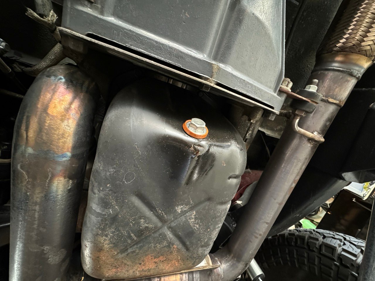

I went ahead and did fluid changes on my transmission and transfer case. I wish I could remember what fluid I used last time, because it didn't do well at all. I want to say it was valvoline syncromesh in the transmission, not sure about the transfer case. Both have less than 10k miles on the fill and had significant metal contamination. The transmission fluid was very thin when it came out, like 0w20 thin. I don't know if it broke down or what. My first gear synchro is basically shot so I was expecting to see brass, but not as much as I did.
Filled both up with Rotella T1 30w straight grade because I had it, we'll see how that does. Seems fine so far.

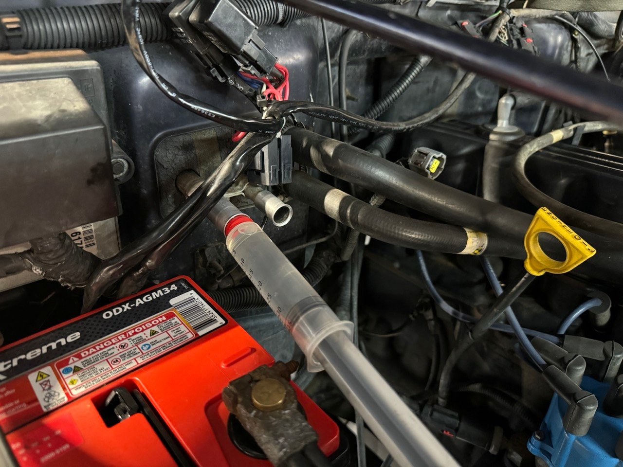

I developed a heat issue with my power steering as well. I siphoned out what old fluid was in the reservoir and added ATF+4 to it, thoroughly bled any air, then went and drove on the highway for the first time, and pretty quickly had it sounding like a supercharger from 2k to 3k rpm. PS pump temp by the time I was able to check was 250°F.
Not knowing if it was from the ATF I added or just because it was my first highway drive, I decided to flush the system and put in fresh NAPA power steering fluid. I took the same drive with that, and no more whine, but the temp was the same. 250°F is too high, right? I obviously have the extra variable of a JL steering box complicating things, but I'm inclined to think it isn't related since the temps go up with RPM rather than steering effort.
Pump on its way out? Need to enlarge the restrictor valve orifice? Just throw a cooler on it?

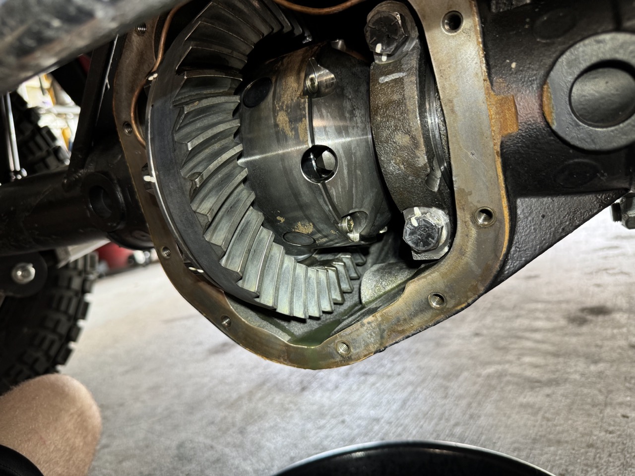

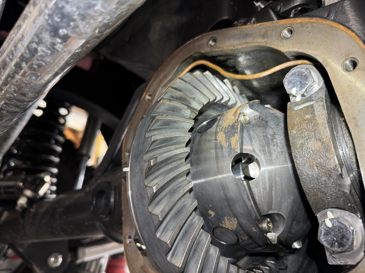

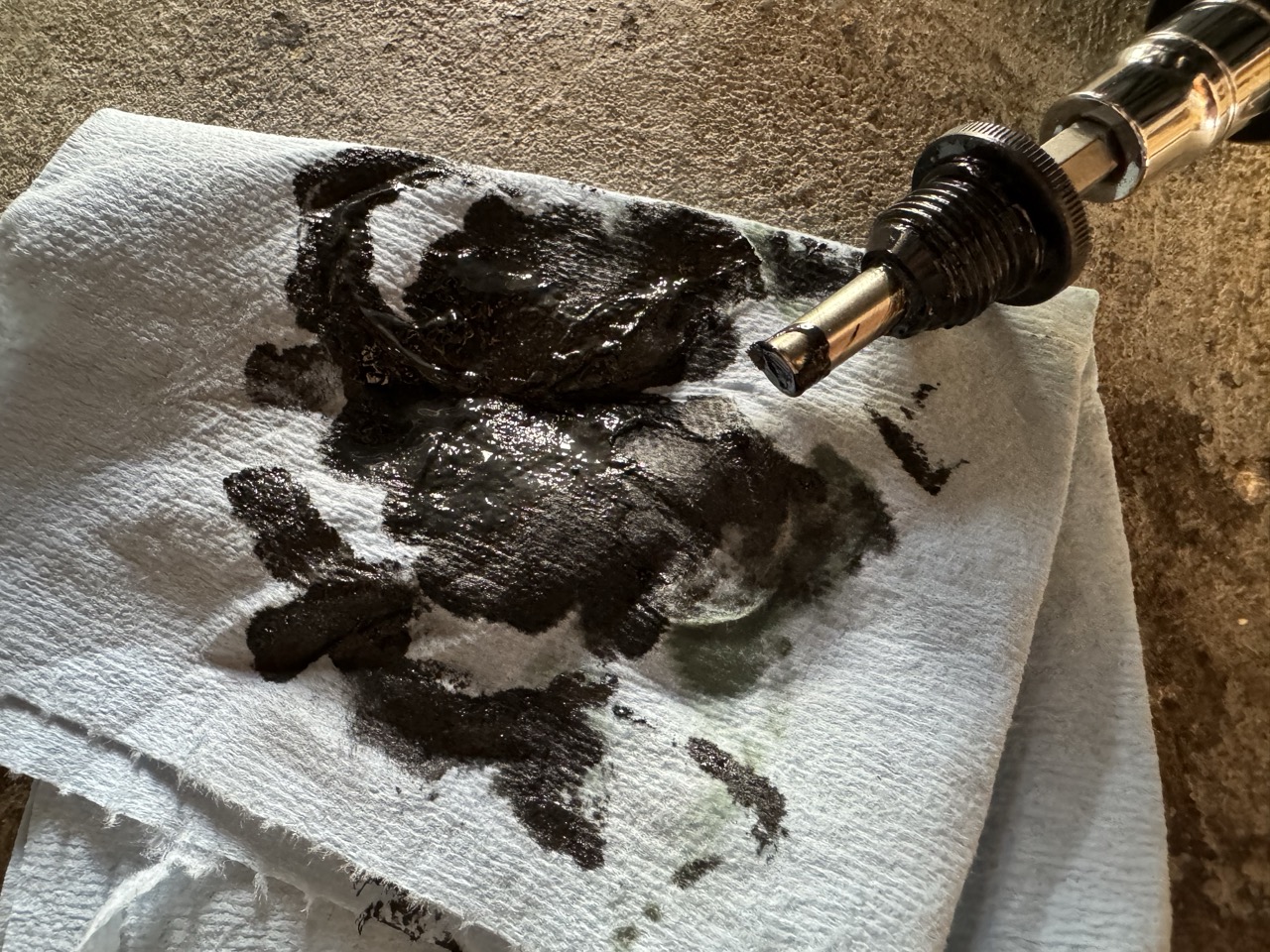

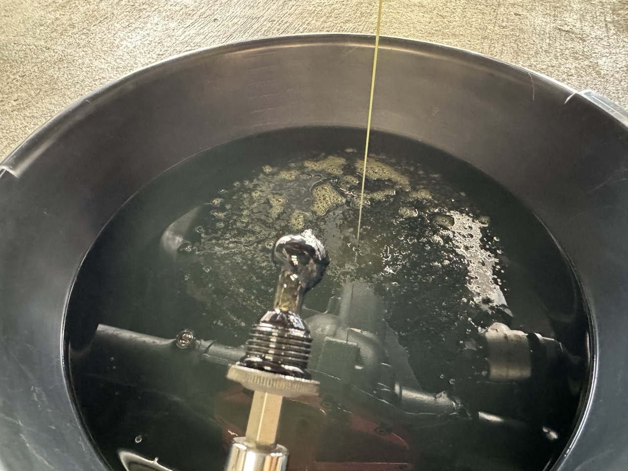

I got the front diff drained and took the cover off to inspect it. There was definitely a lot of very fine metal particles in the oil, but I assume this is normal for a break in.
Here is the magnetic drain plug:
Everything on there was extremely fine, like anti seize:
Oil looks like it was getting a little frothy in there, some foamy oil left on everything 2-3 hours after I parked. Kinda weird but I don't know if that means anything.
@hosejockey61 @Blackjack how are these wear patterns looking to you? Should I run a paint pattern?
Seems like the pinion maybe could have gone a touch deeper but I don't think its worth changing it now. Remember I don't have a front driveshaft so this was 100% driven by the wheels, not through the pinion, so I don't even know if this constitutes a proper break-in...
Reactions: hosejockey61

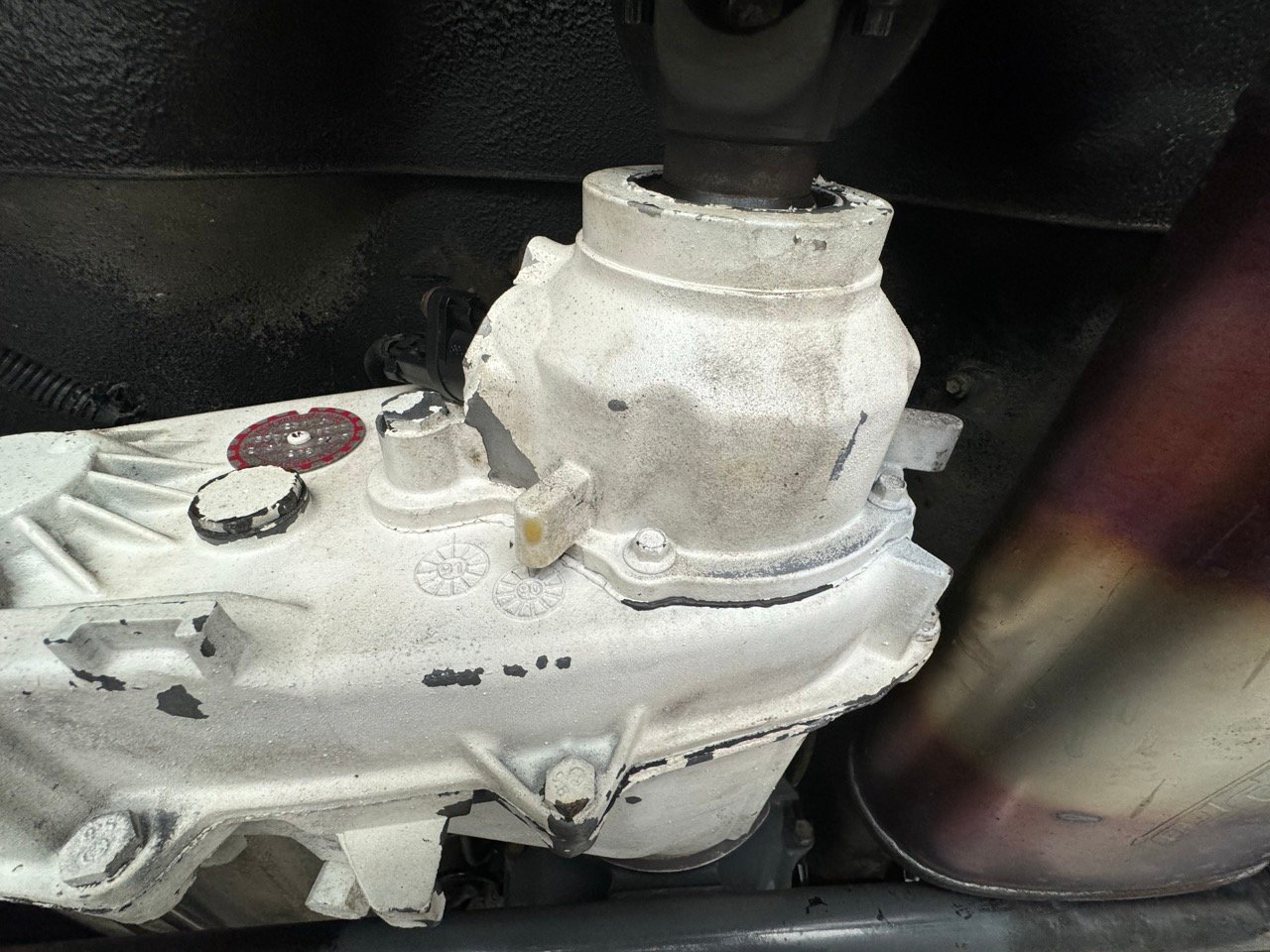

Got a random drop of oil on the back of my transfer case too but I can't tell where it came out of, there's no trail.

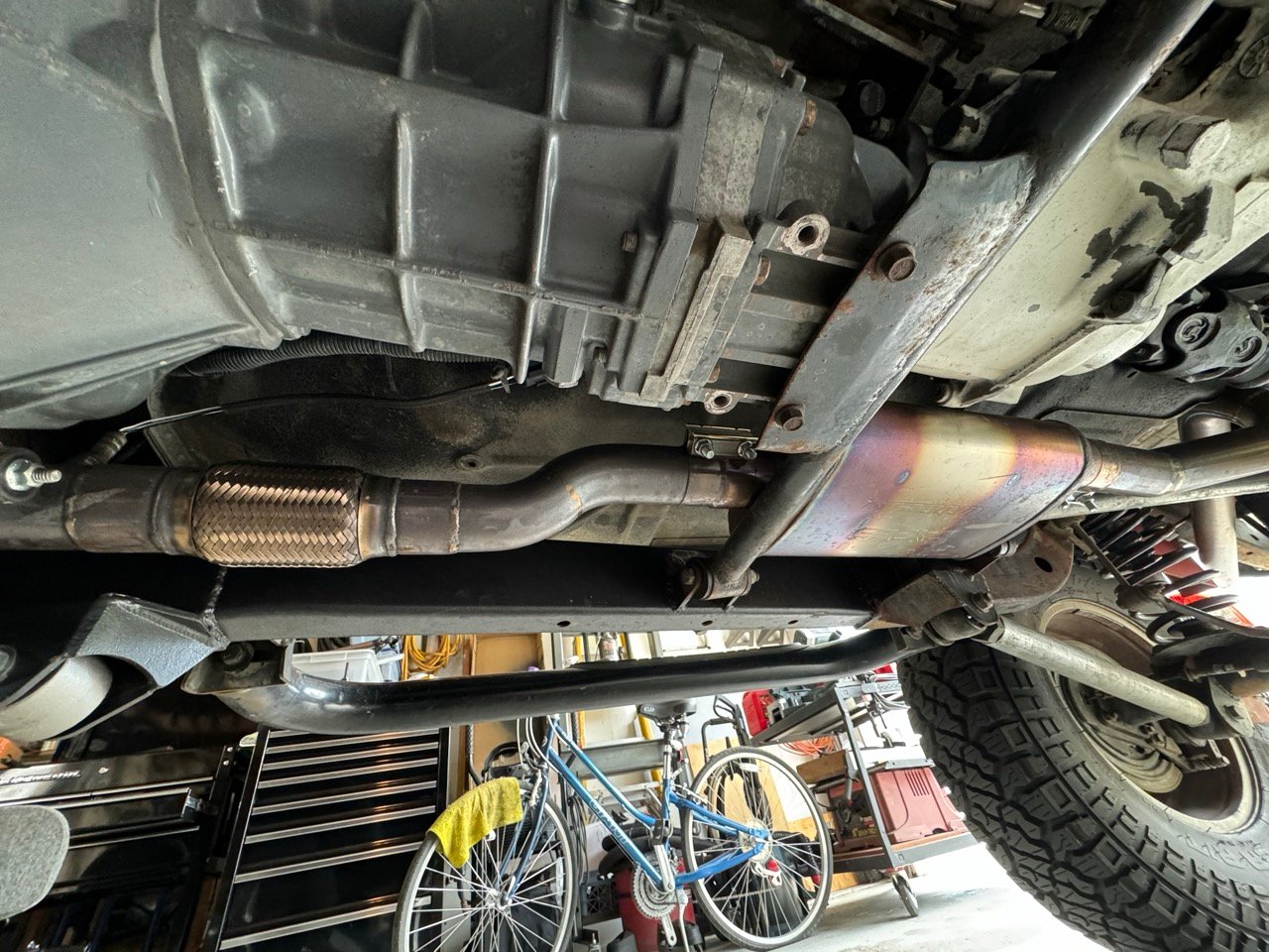

Exhaust is holding up fine, searched for cracks at my welds but didn't find any.
Exhaust is definitely going through heat cycles based on the color. The DIY hanger done off the transmission is working great so far!
...however the one by the rear UCA is too close to the hot muffler and melted a bit.

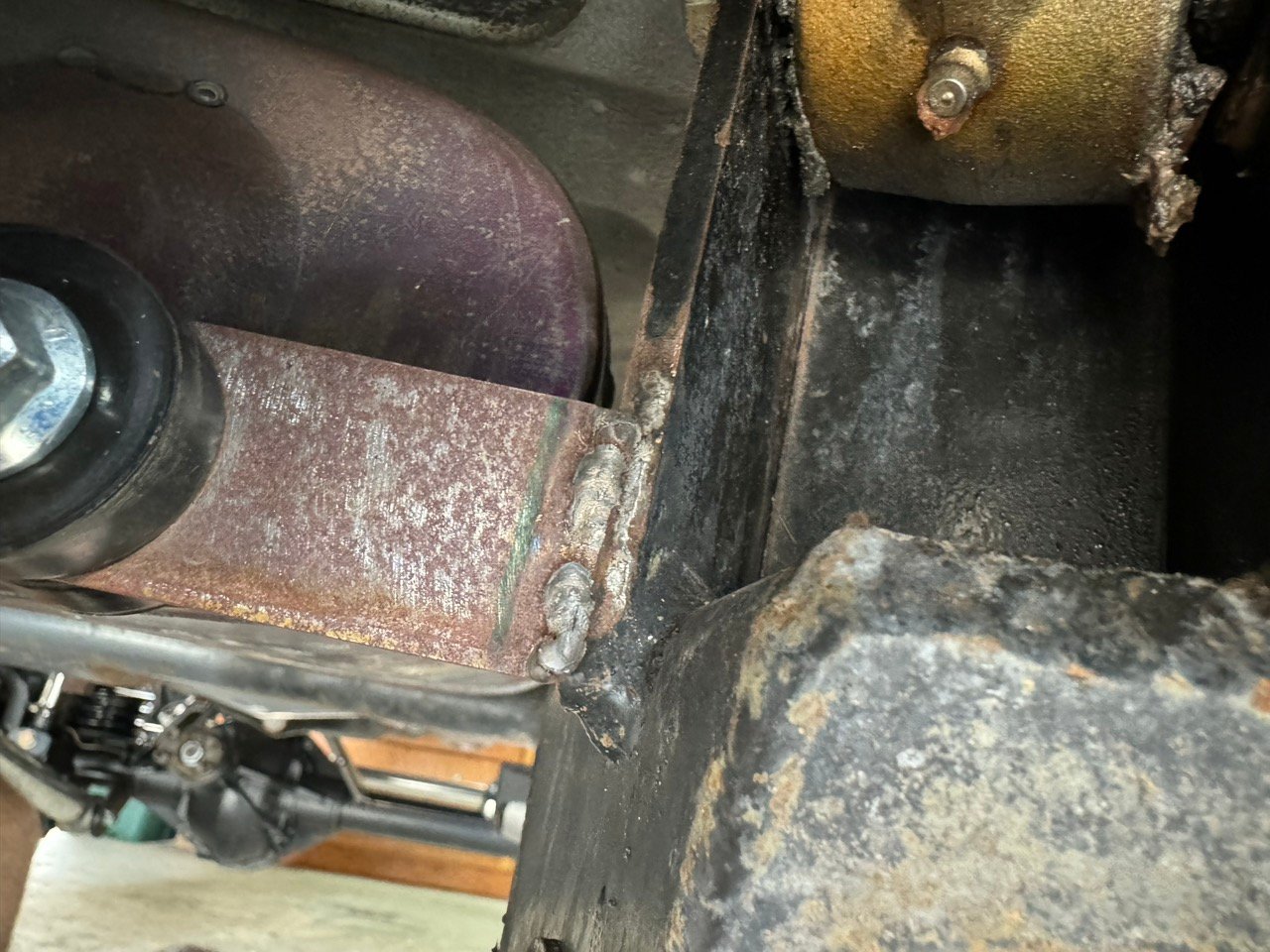

The weld on that tab also failed, so I'll need to address that.

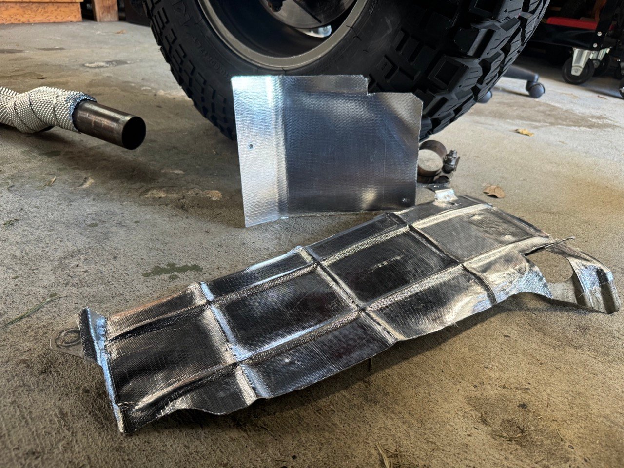

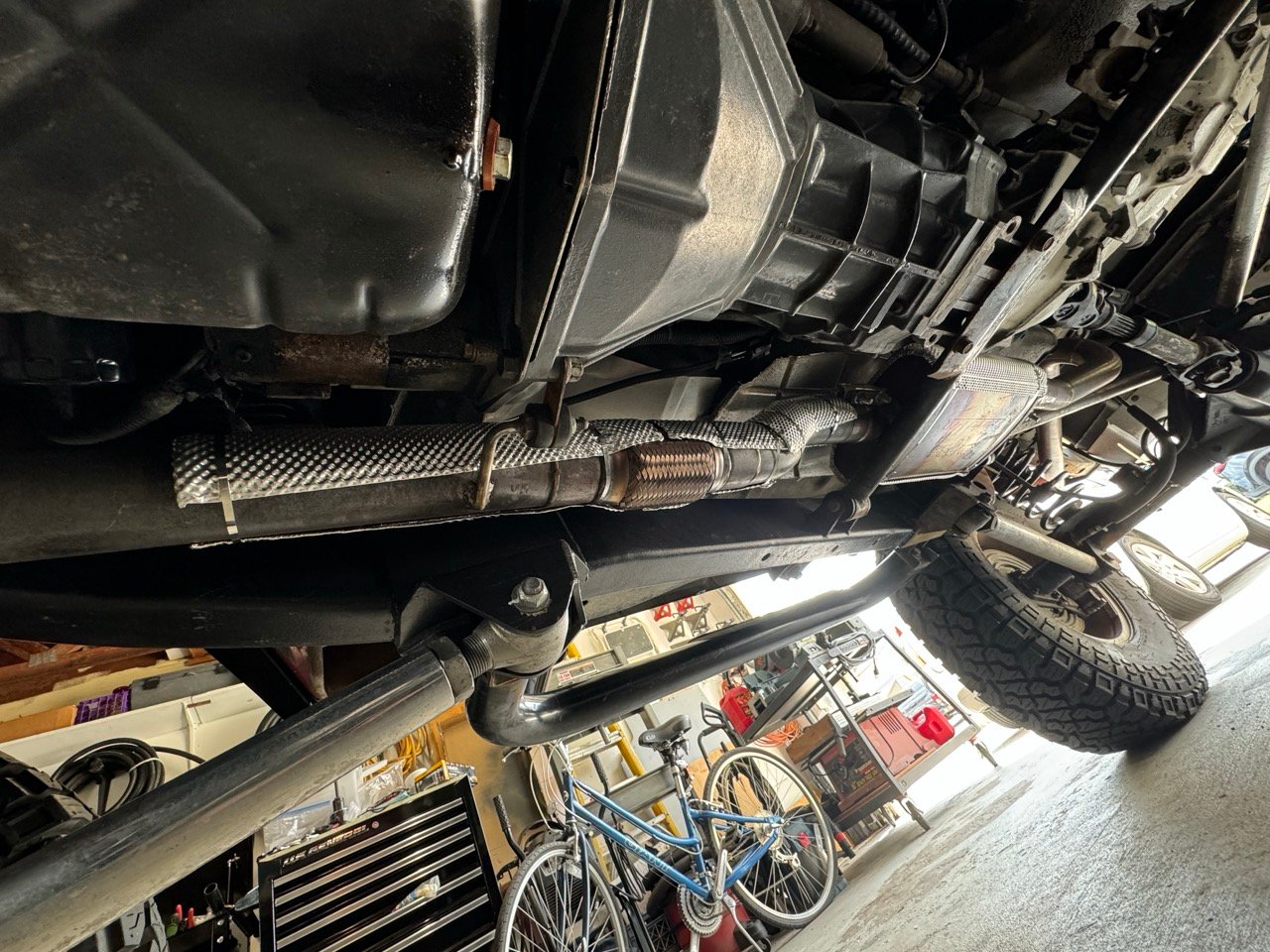

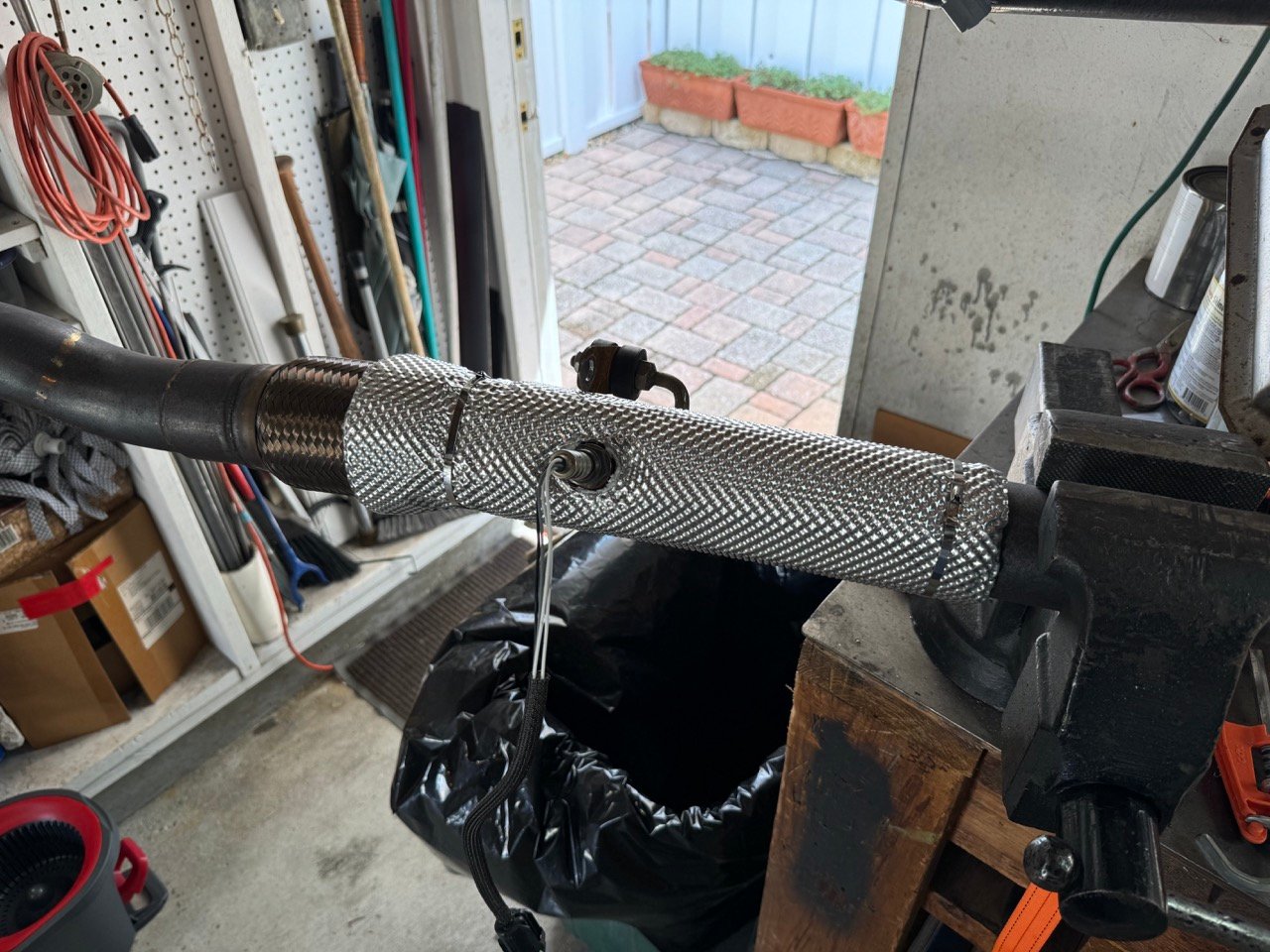

Tackled my floor heat issues today. After about 15 minutes of highway driving, I could see temps up to 150°F on the passenger floorboard.

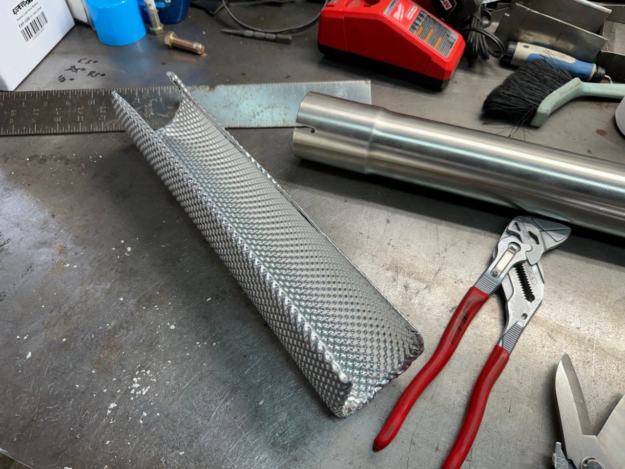

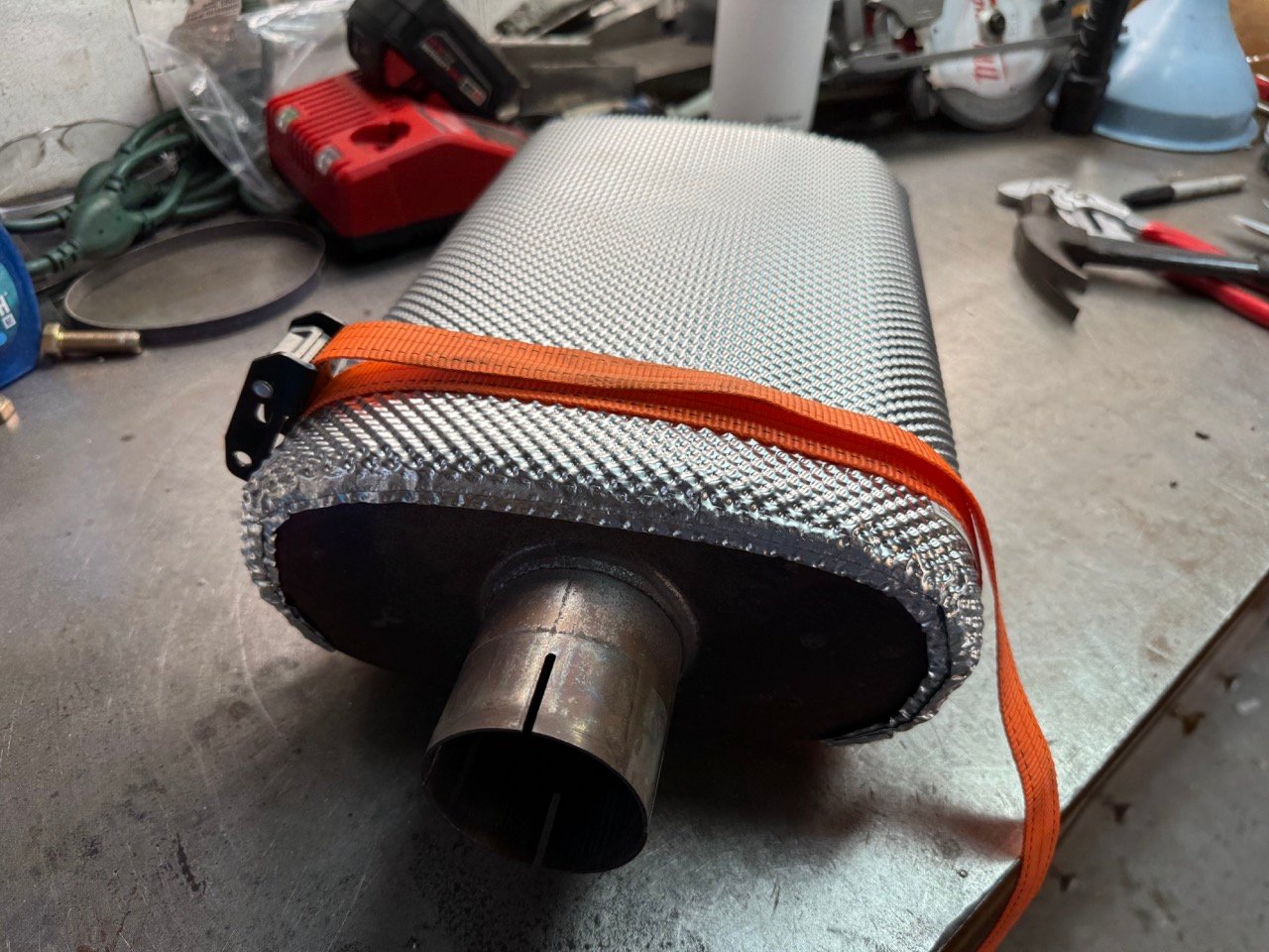

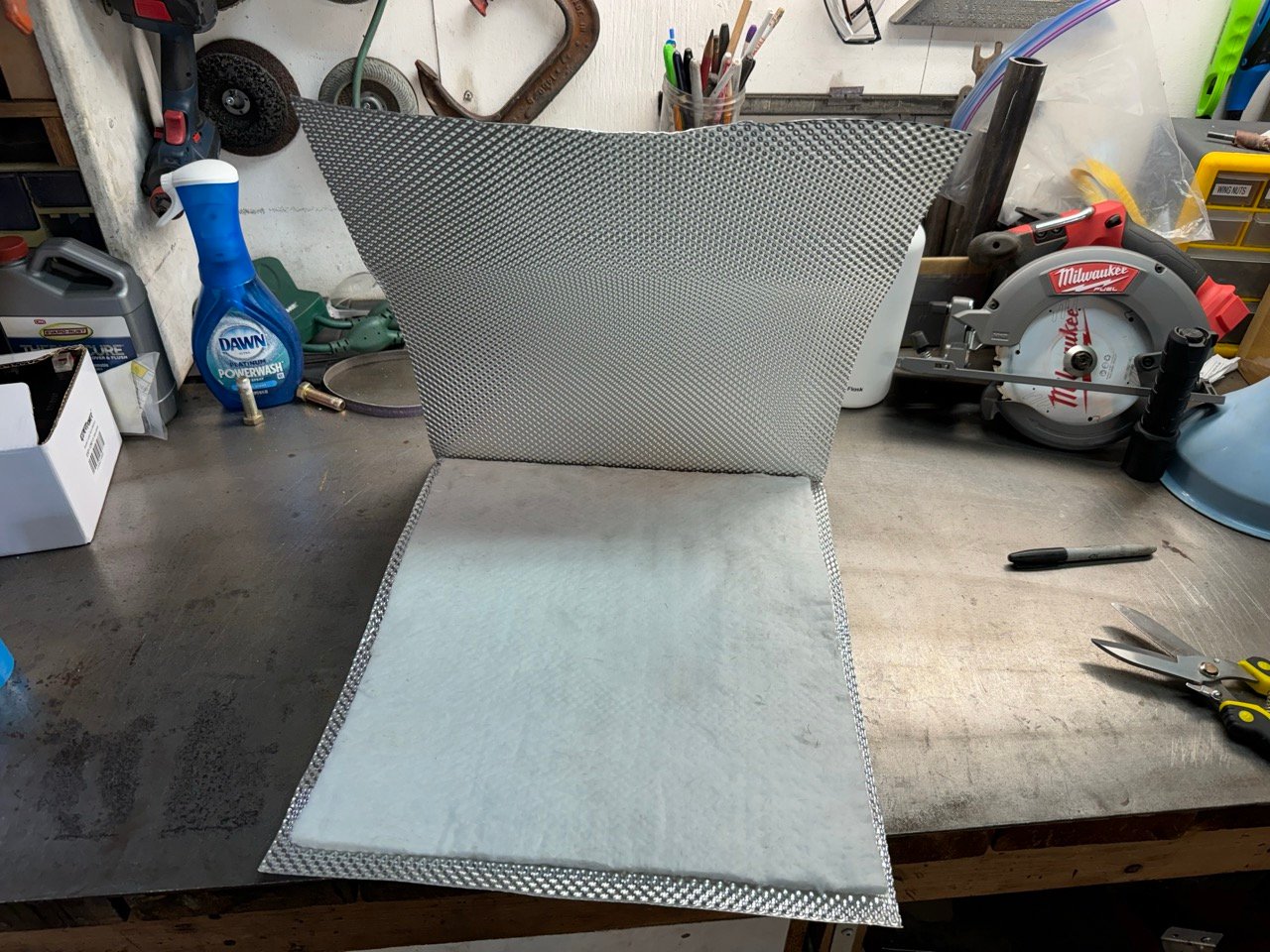

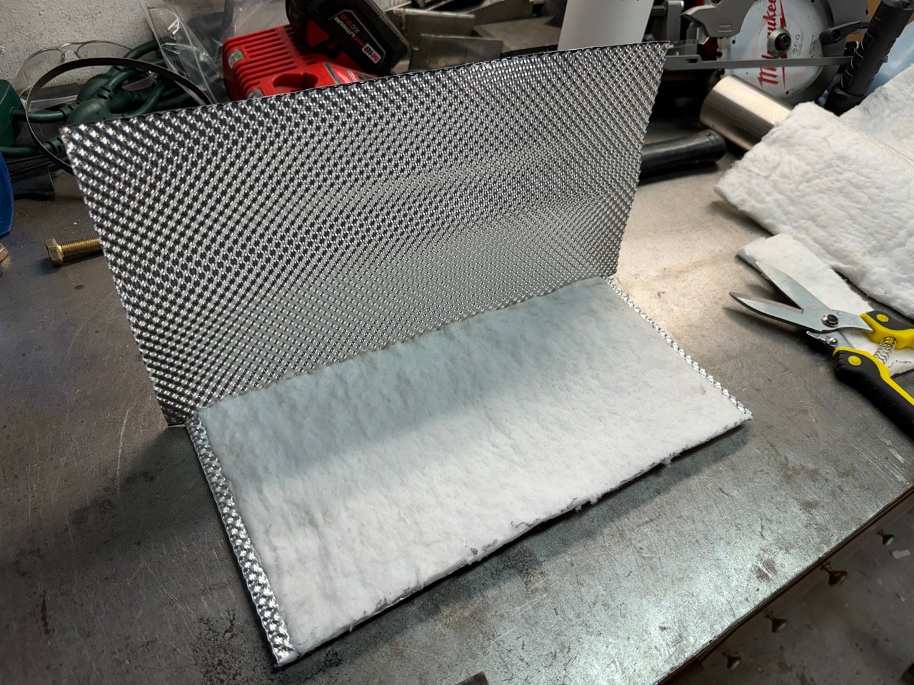

I decided to make my own heat shields using embossed aluminum and ceramic fireplace insulation. I also put the original heat shields I had back in, but I put some adhesive backed aluminized fiberglass heat barrier on the top side of them.
Made a sandwich with the materials with some extra overlap on the edges

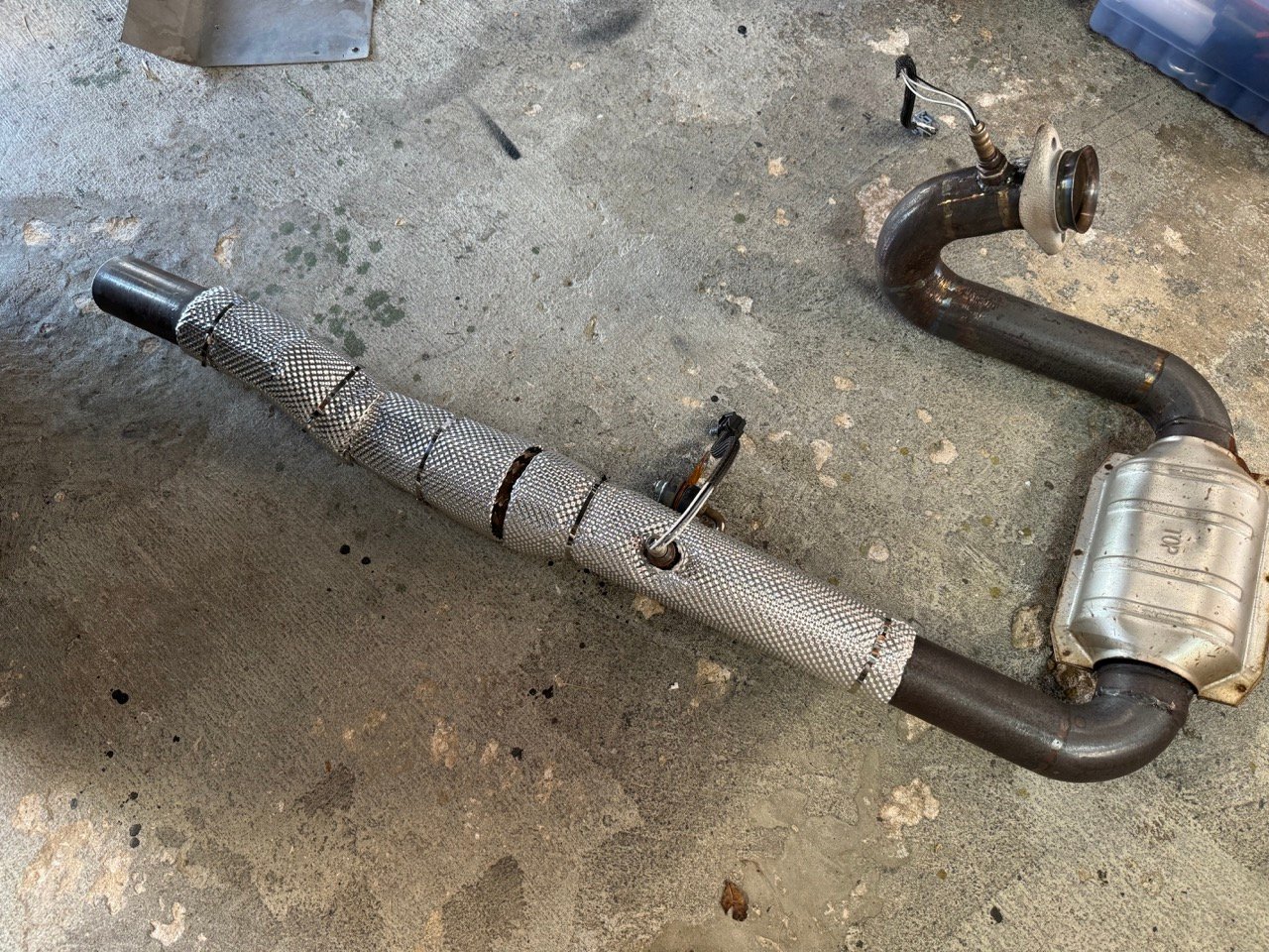

The muffler was pretty easy, just formed it into place around the edges with a hammer
Made the next one a little neater and folded in the inner layer first
Getting the pieces formed around where the exhaust curved were a lot more complicated, but I got it done
Peel and stick stuff on the top side of these heat shields. Its probably more effective on the underside, but I don't trust the adhesive.
All back together! I'd like to add some shielding to the parts under the cargo area, but I was tired of messing with it.
I haven't done a highway test yet but I'm pretty sure I'll see an improvement.

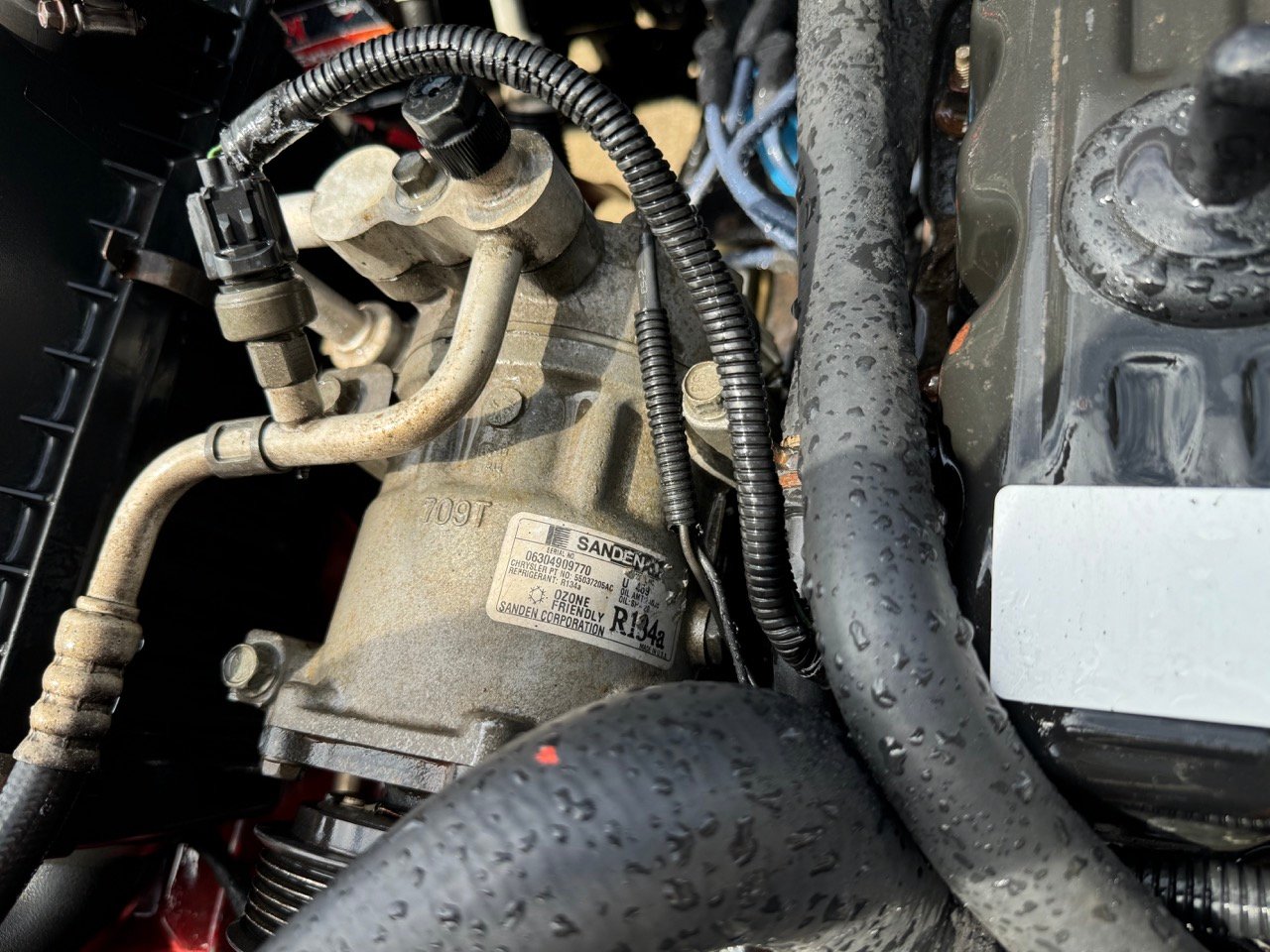

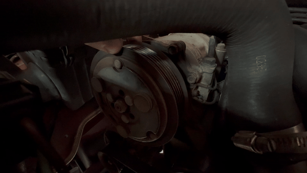

I've been having a random issue where I'd smell a noxious burning smell while driving around, but I couldn't pinpoint what it was. It would only last for a couple minutes at a time and seemed to happen next to construction sites or parking lots getting new asphalt, so I just assumed it was that. I was starting to get paranoid that my heat insulation or some wiring was catching on fire, but fortunately it wasn't that. After it started to make noise, I figured out it was my AC compressor clutch rapidly failing, which also explains the nasty smell.
I took the belt off and sure enough:
Threw on a non-AC belt so I can still drive around, but man, I miss that AC already. The electric fan does make it a fair bit easier to change a belt.

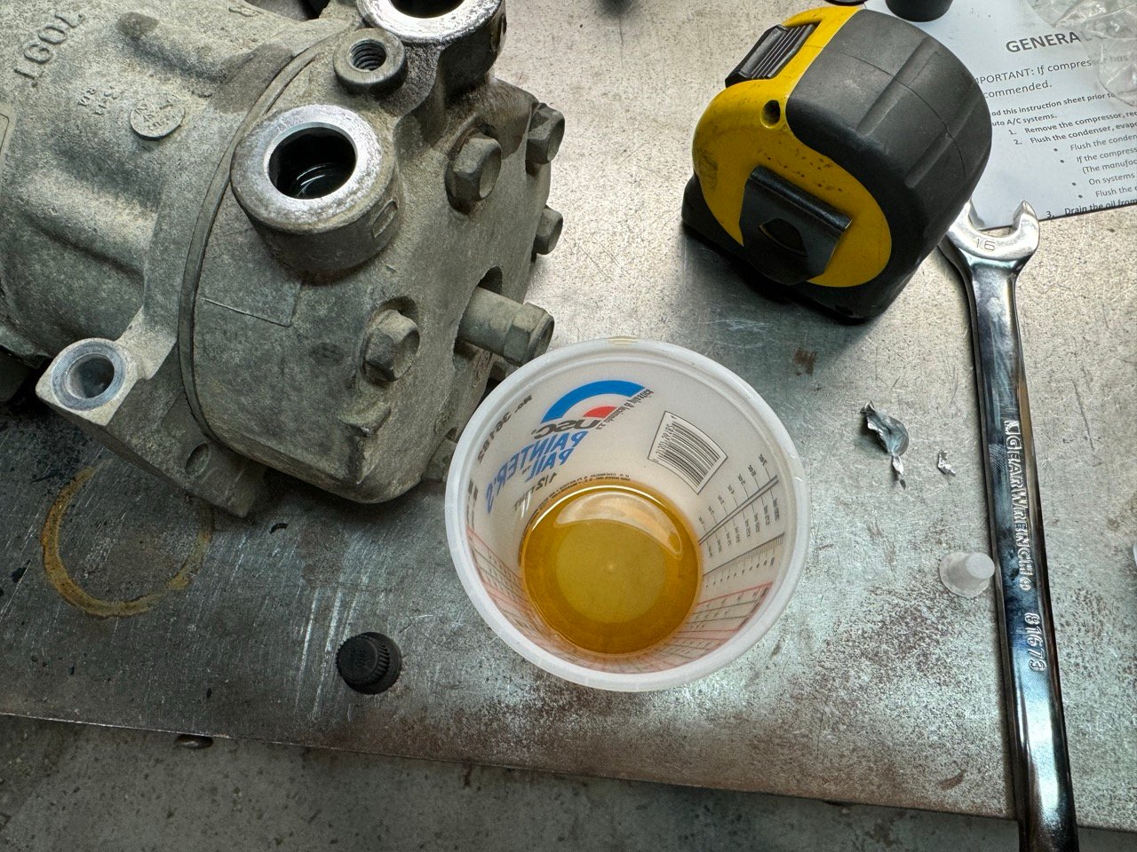

My compressor is the SD709 type, but I went ahead and ordered an SD7H15 style compressor from Rockauto under the UAC brand. I couldn't tell for sure, but it seems to just be a newer model but is a drop in replacement. We'll see. Got a full system aside from the evaporator. Mine isn't leaking and I'm not interested in taking the dash apart right now. Hopefully all the new chinesium holds up! Whole system for about $340 shipped and including the R134a. Maybe the old compressor itself is ok and I can get a new clutch for it, might turn it into an OBA setup.

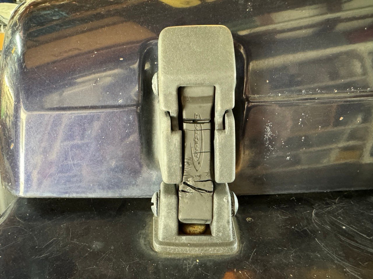

Speaking of chinesium, check out how well these Daystar hood latch pieces are holding up after 6 years.
The 20 year old factory ones looked better than these when I replaced them. Why are aftermarket rubber parts always so terrible?
I'm considering ordering a set of JL latches and rigging them on there, at least I can avoid another rubber part.

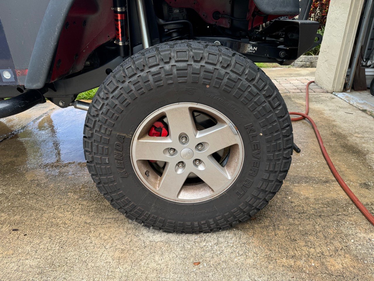

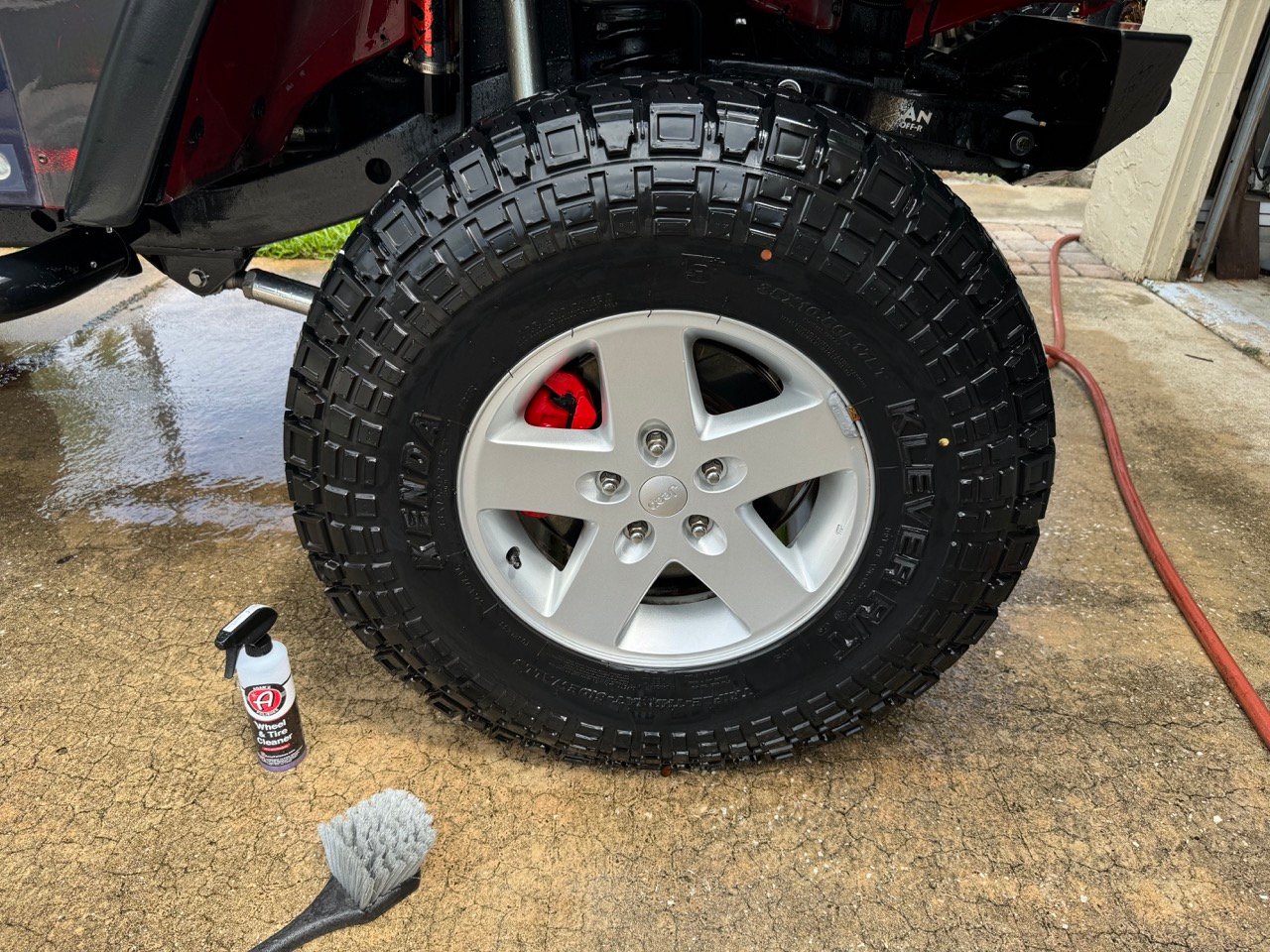

On a side note, my front wheels were starting to look pretty nasty, so I picked up some Adam's wheel cleaner. The stuff works!
My coolant cap is continuing to do some weird stuff too. Gonna try to do a full system flush and replace the consumable parts with Mopar before too long.

I got my whole A/C system changed out last weekend using all UAC parts from RockAuto, aside from the evaporator in the dash. In the end I got it done, but I would recommend trying one of the other brands to someone else. Just about every part had an issue with it.
  • Condenser was made with 40 rows of fins instead of the 41 rows the factory unit had, so the mounting holes were about 3/4" off. This was a total pain and I ended up just mounting it with zip ties at the bottom. Not ideal.
  • High pressure line needed to be bent away from the compressor so it wouldn't contact, and the mounting bracket was installed on it backwards.
  • Low pressure line was too short, bends needed to be flattened a bit so it would connect on both ends
  • Lines coming out the top of the accumulator were too tall/out of spec and got in the way of the line connecting to the evaporator
  • The compressor itself did seem fine, though time will tell.

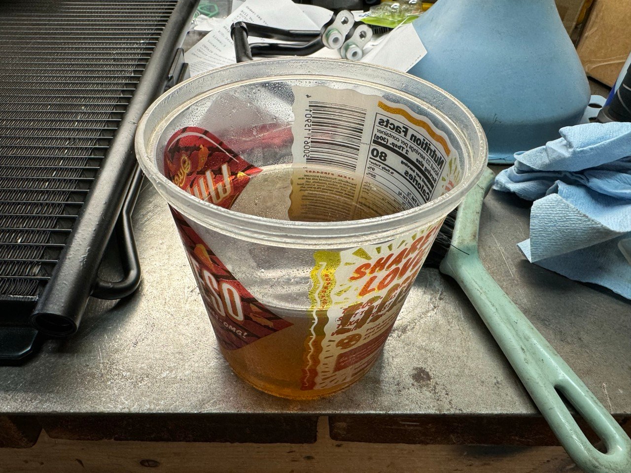

I didn't want to take my dash apart, but I wanted to clean my evaporator. I stuck a plug in one end with a hole drilled through it and used a syringe to fill it with acetone. It took quite a bit, close to a quart I think.
I blasted it out as well as I could with high pressure compressed air, this is what it looked like:
Then I stuck the air hose in one end, set the regulator to about 35psi and blew air through it for about 40 minutes. Hopefully this was enough to evaporate any remaining acetone in there.

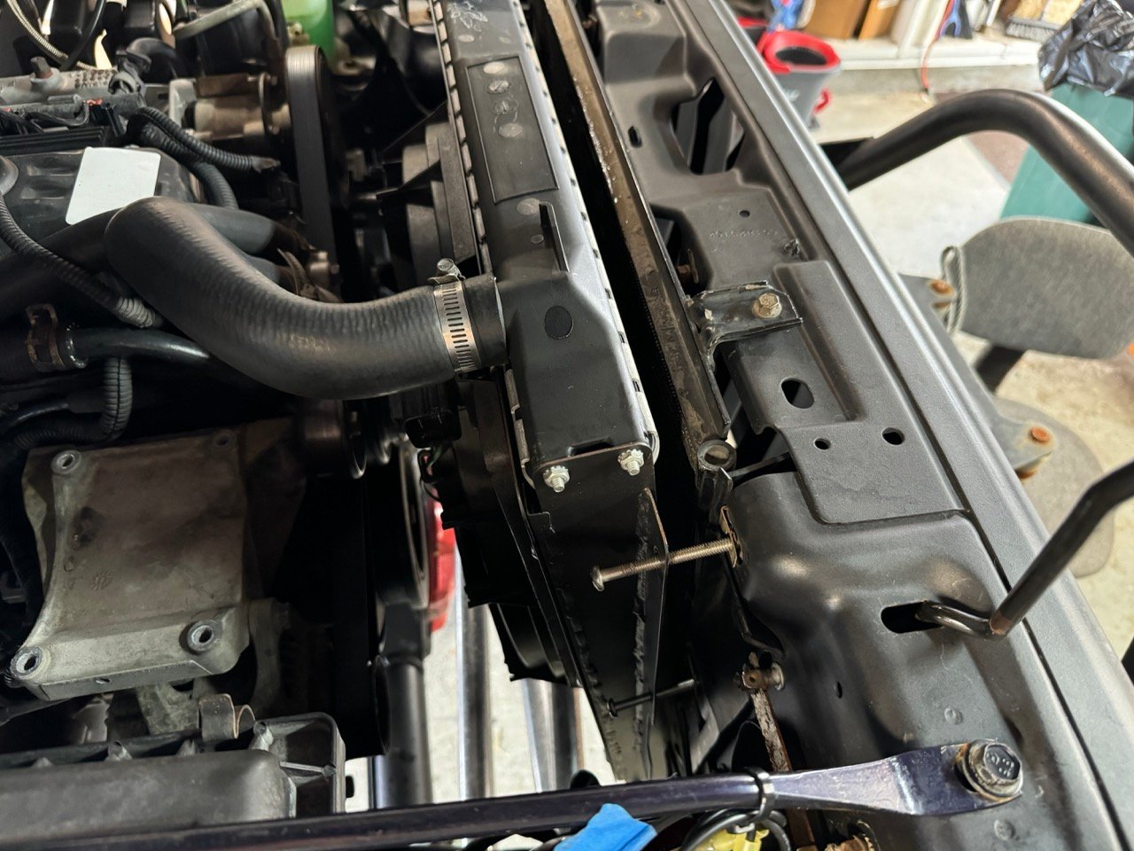

To get the condenser out without removing the radiator, I replaced the radiator mounting bolts one at a time with longer ones, that way I could slide it back enough to get the condenser in and out. That worked pretty great, but I'd be extra careful not to put too much torque on those bolts given they just screw into those body clip things.
I forgot to grab a picture of the new condenser, but you get the idea.
Here is all of the oil that came out of my old compressor. Barely a few drops. I'm not sure if that's normal or not, there seemed to be a lot of oil everywhere else in the system. It definitely looks old and smells weird, but I'm thinking it was just a clutch failure.
