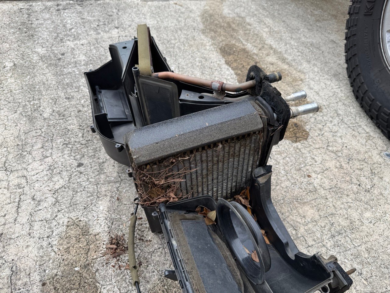

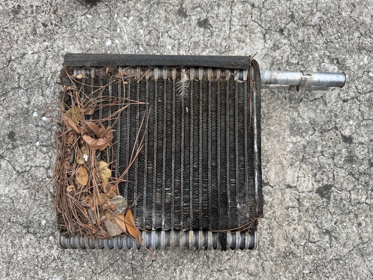

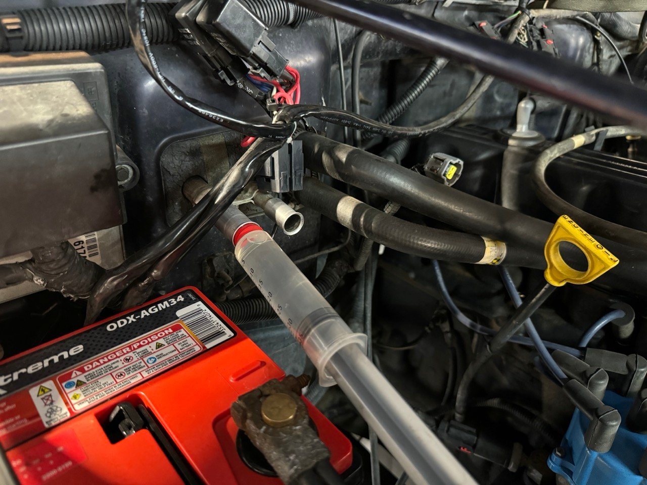

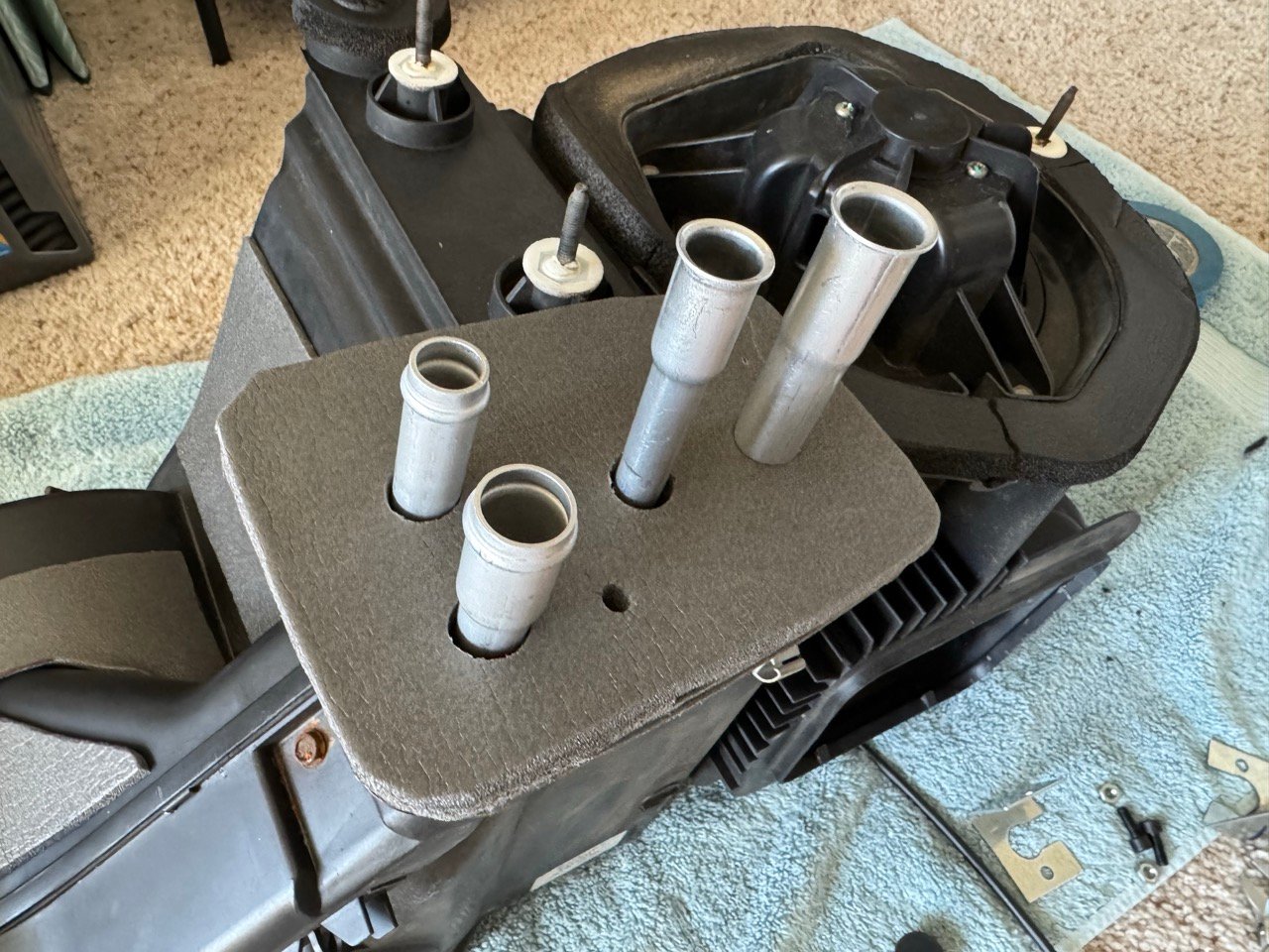

I didn't want to take my dash apart, but I wanted to clean my evaporator. I stuck a plug in one end with a hole drilled through it and used a syringe to fill it with acetone. It took quite a bit, close to a quart I think.
I blasted it out as well as I could with high pressure compressed air, this is what it looked like:
Then I stuck the air hose in one end, set the regulator to about 35psi and blew air through it for about 40 minutes. Hopefully this was enough to evaporate any remaining acetone in there.

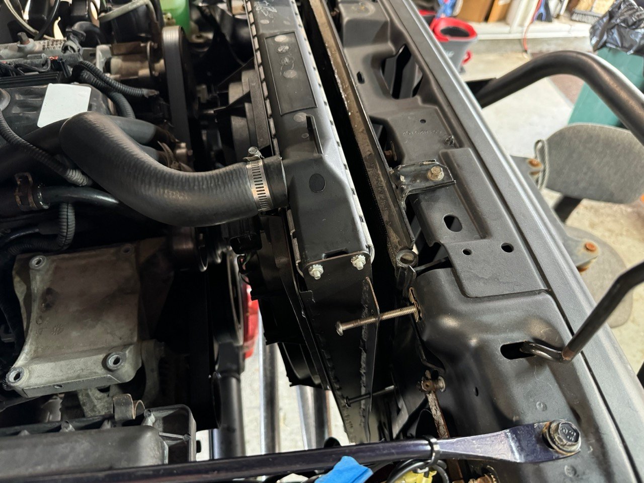

To get the condenser out without removing the radiator, I replaced the radiator mounting bolts one at a time with longer ones, that way I could slide it back enough to get the condenser in and out. That worked pretty great, but I'd be extra careful not to put too much torque on those bolts given they just screw into those body clip things.

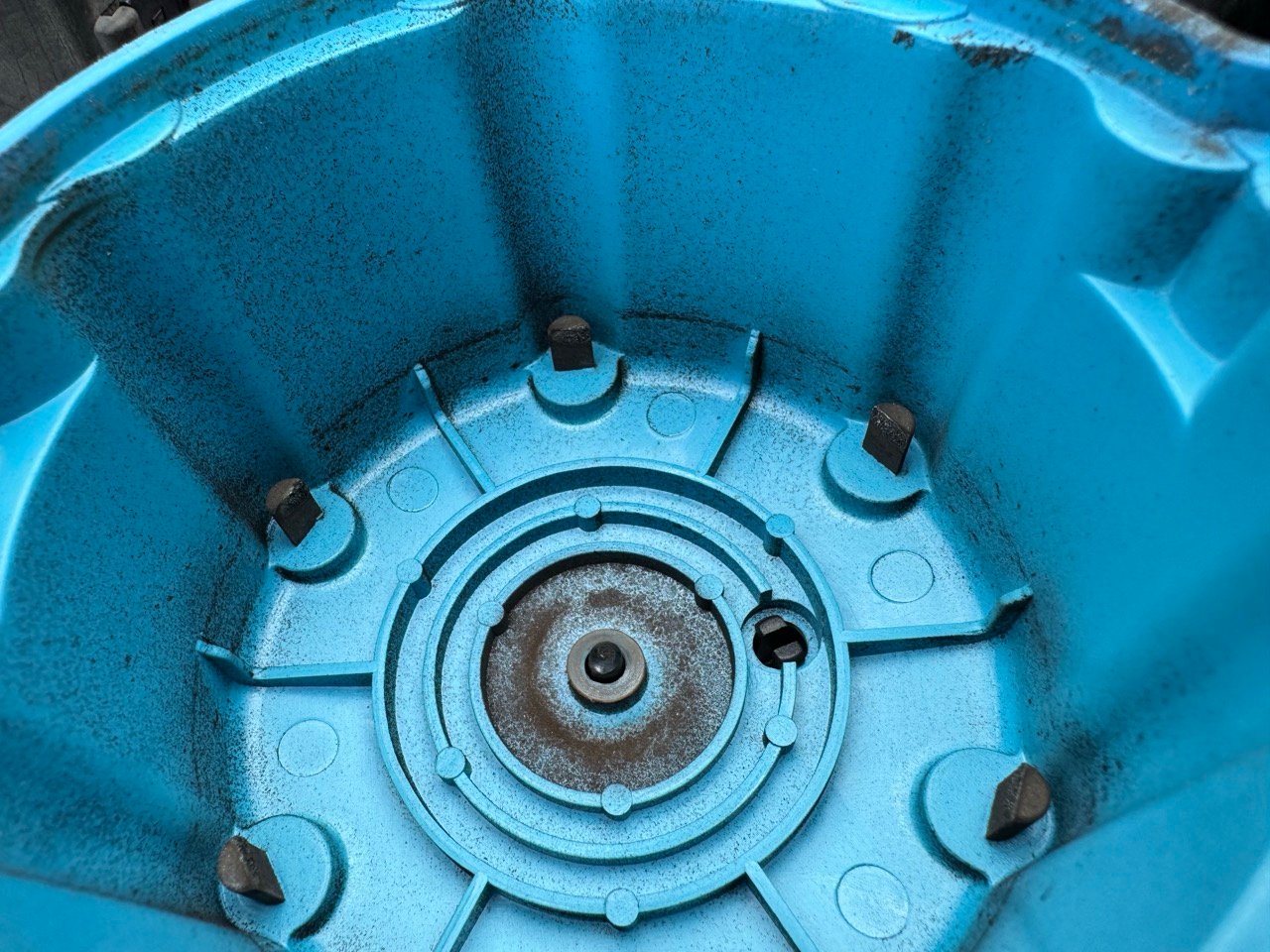

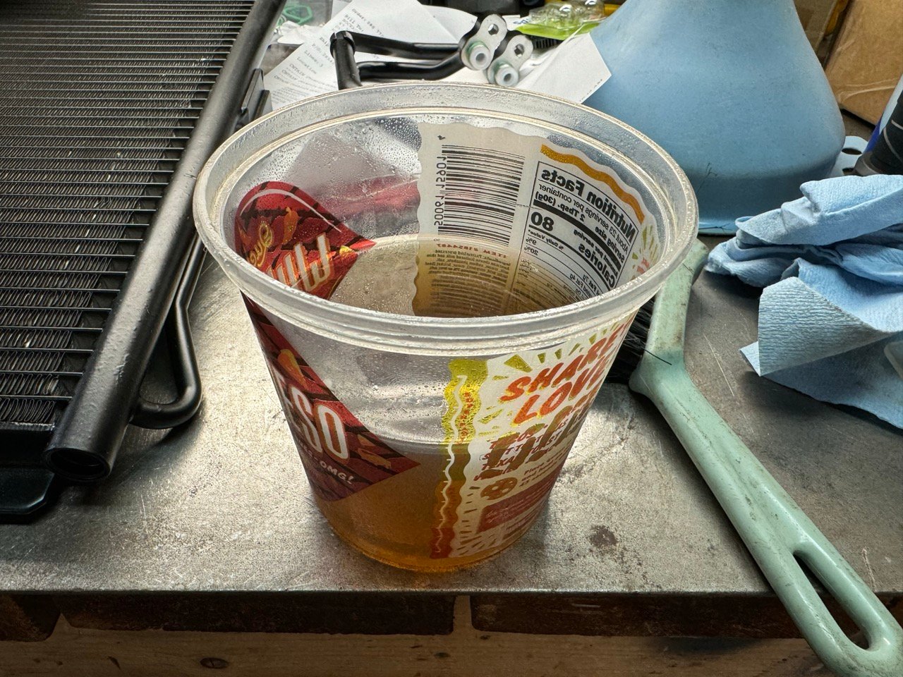

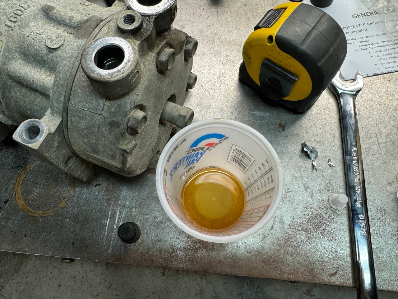

Here is all of the oil that came out of my old compressor. Barely a few drops. I'm not sure if that's normal or not, there seemed to be a lot of oil everywhere else in the system. It definitely looks old and smells weird, but I'm thinking it was just a clutch failure.

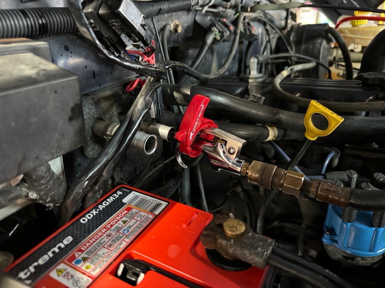

While I'm not impressed with the components, it is still blowing ice cold after a week, so no major leaks or malfunctions yet. 🤞

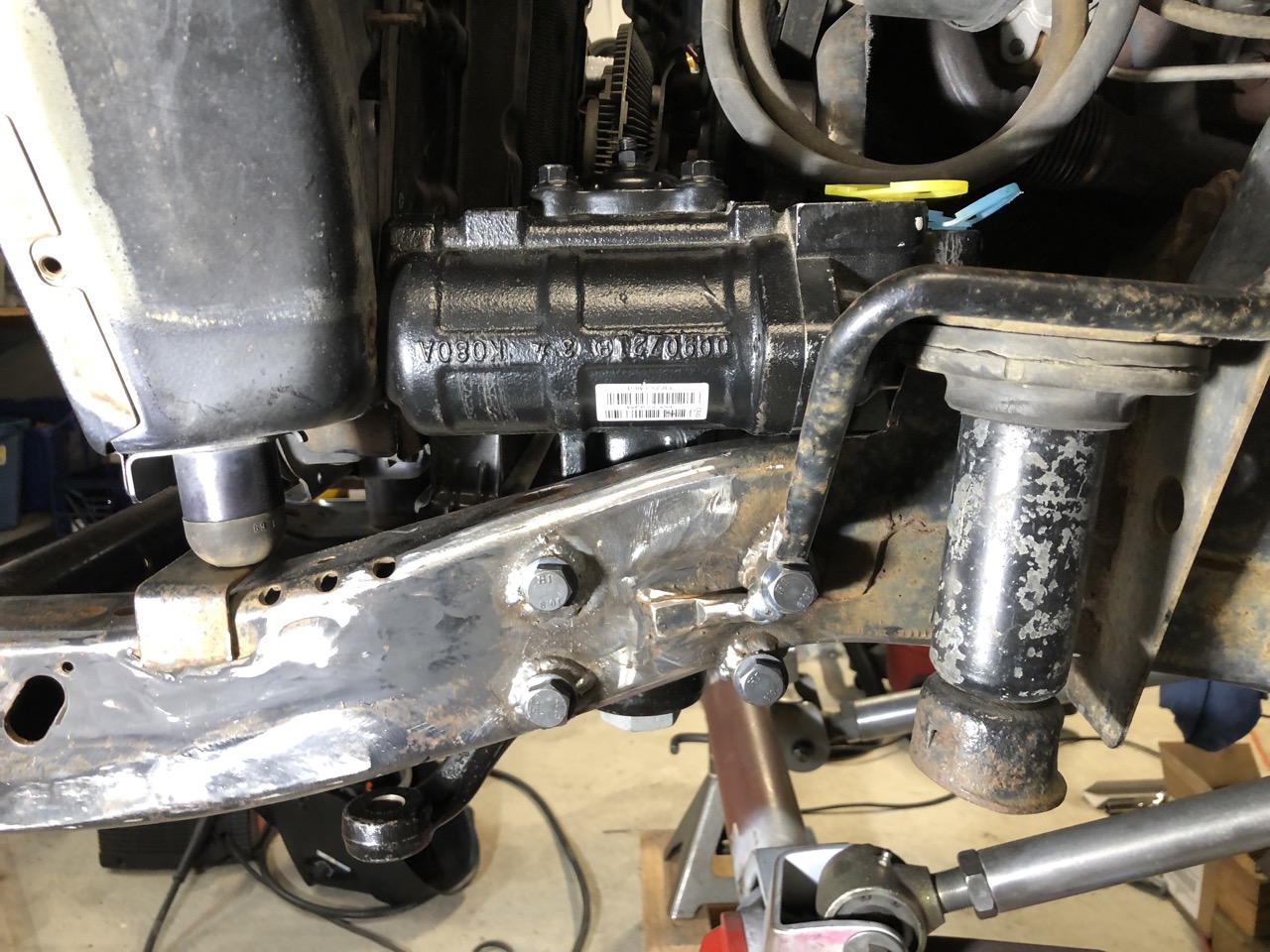

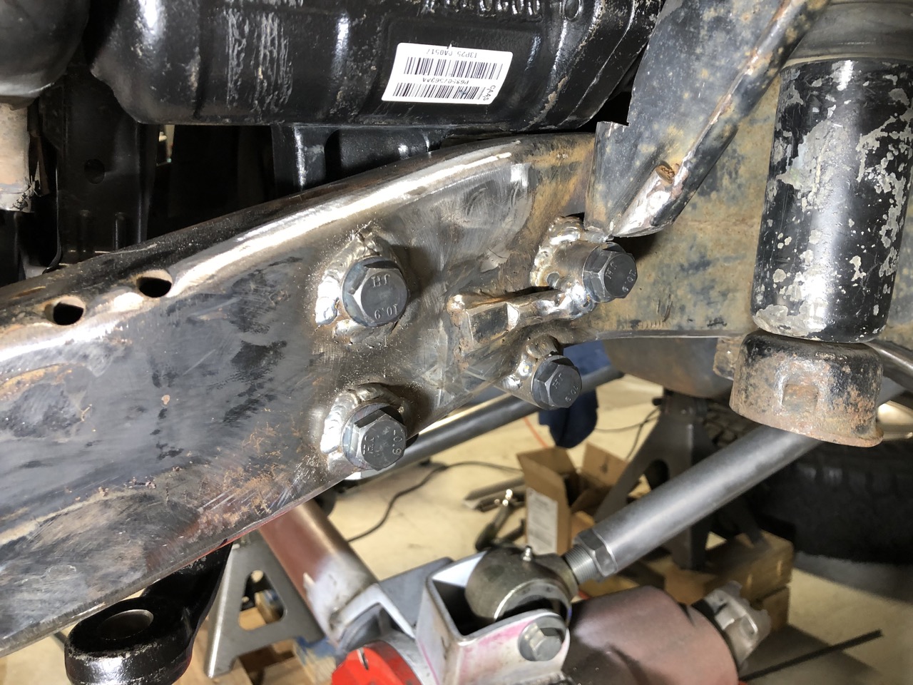

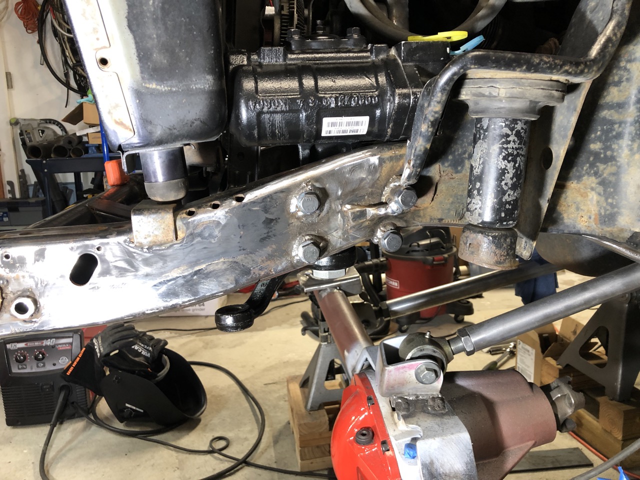

I did the thing, I got the JL steering gear mounted to the frame!
The welds aren't pretty, but they'll hold. I'm not showing the ones Ray Charles did on the inside half...
The placement of that last bolt was rather unfortunate, but it worked out ok. If I were to do this again, which I definitely wouldn't, I'd hammer in the corner of the grille about 1/2" so the steering gear clears it and last bolt could clear the coil bucket. You know, advice for anyone unhinged enough to copy what I'm doing. It seems like the coil spring will have enough clearance, but we'll see.

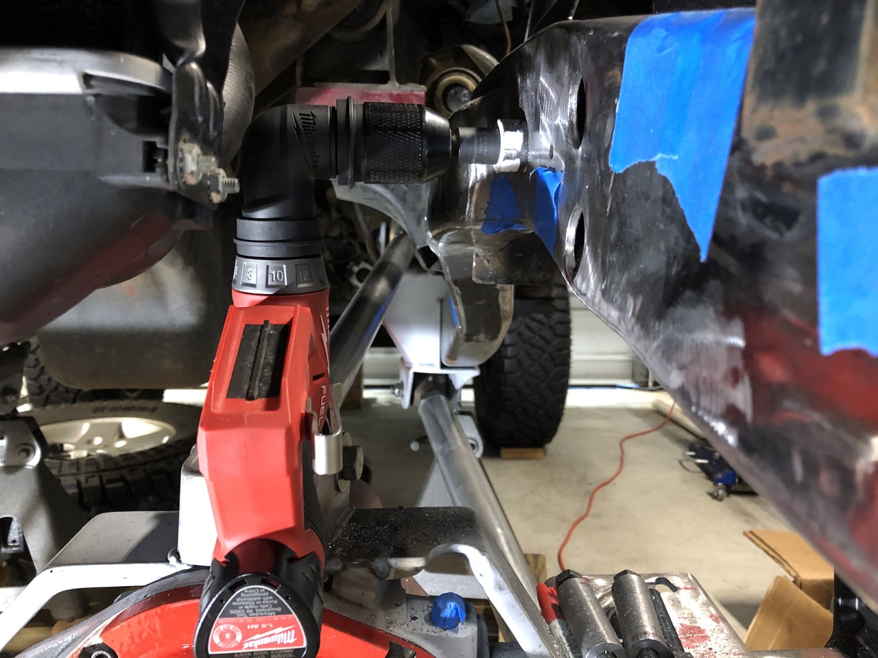

It took that under powered drill contraption about 30 minutes and 4 batteries to get through that one hole. I'm glad I didn't have to drain the radiator though.

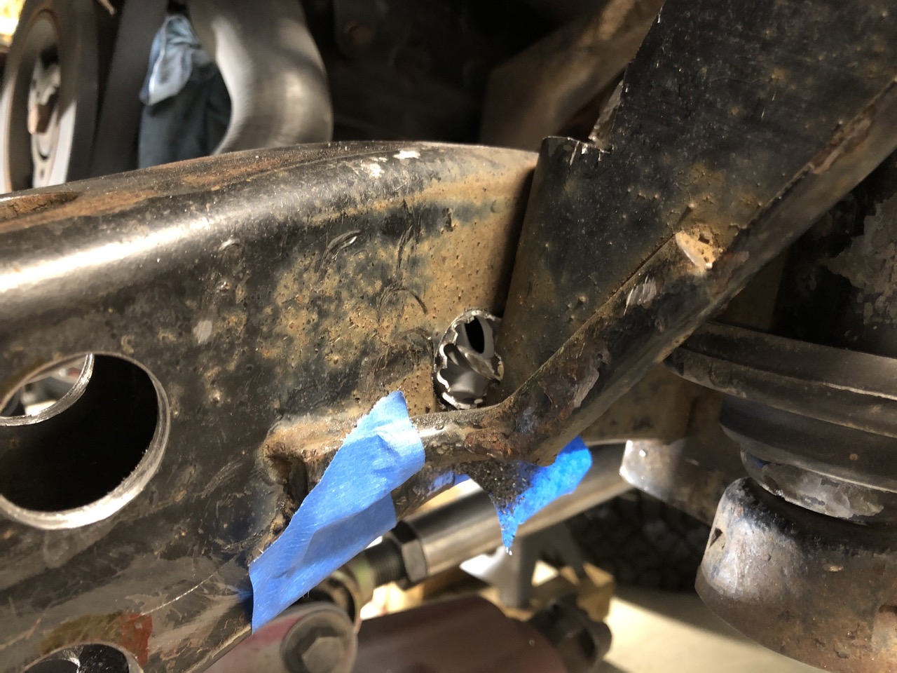

Still need to clearance the frame where the stud comes through the pitman arm, after that I think the track bar is the next hurdle. Feels good getting this part over with.
