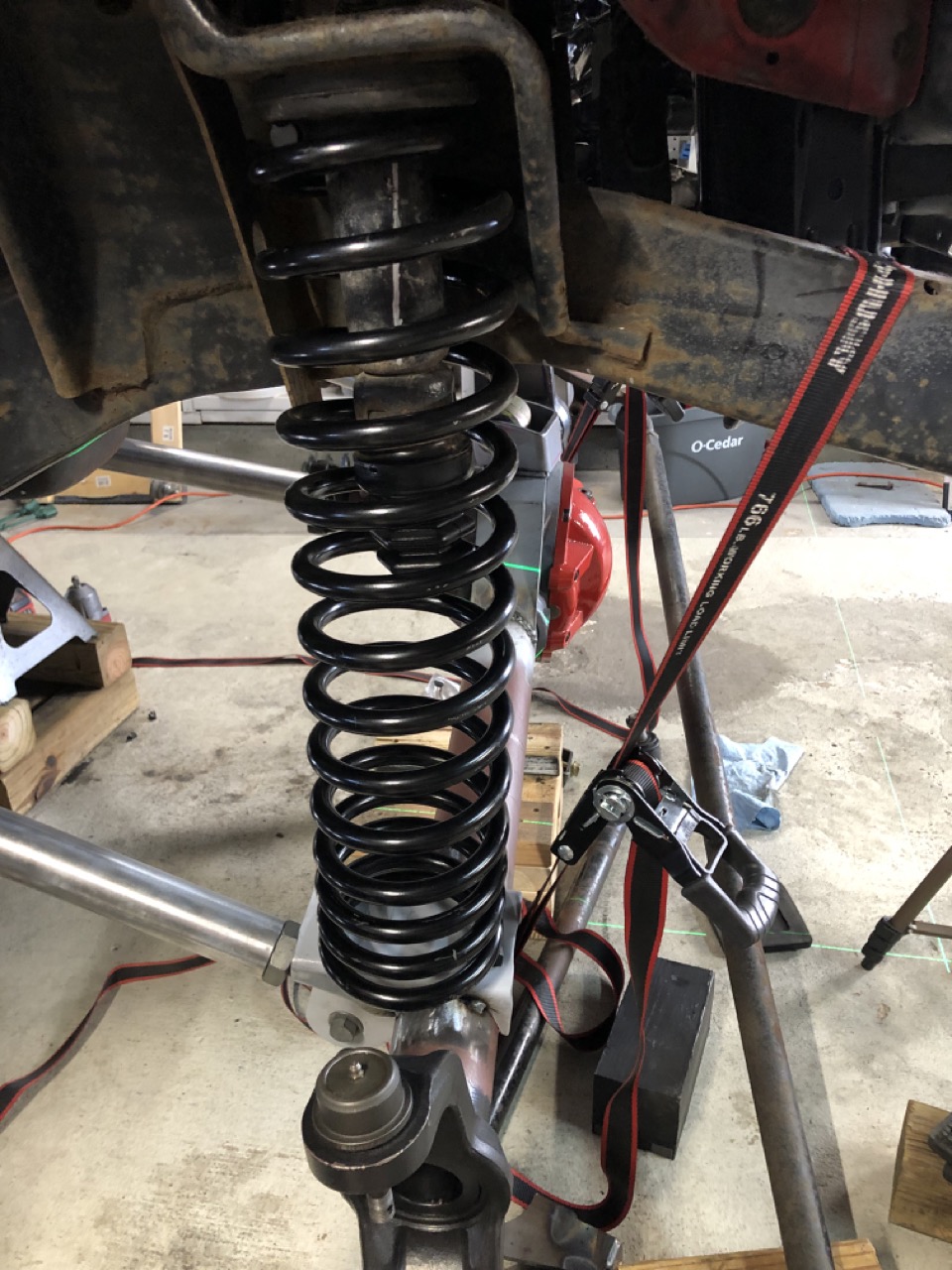

Chopped off my JK spring seats and tacked on my backwards TJ ones. Everything seems to line up way better now. Picture is at full droop. I think the trick to keeping the jounce bucket off the front of the spring is to make sure the back of the spring seat is a few degrees higher than the front. It bows the spring slightly which gives it the clearance it needs.
I was planning on just using hockey pucks for the lower bump stop, but I'm thinking of getting 4" diameter UHMW instead. This should fit the ID of the spring pretty close and should keep the coil in its channel at droop better.

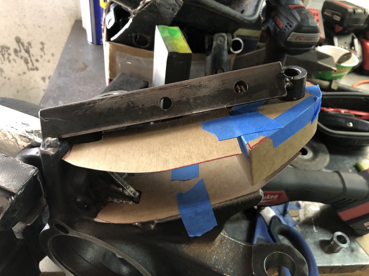

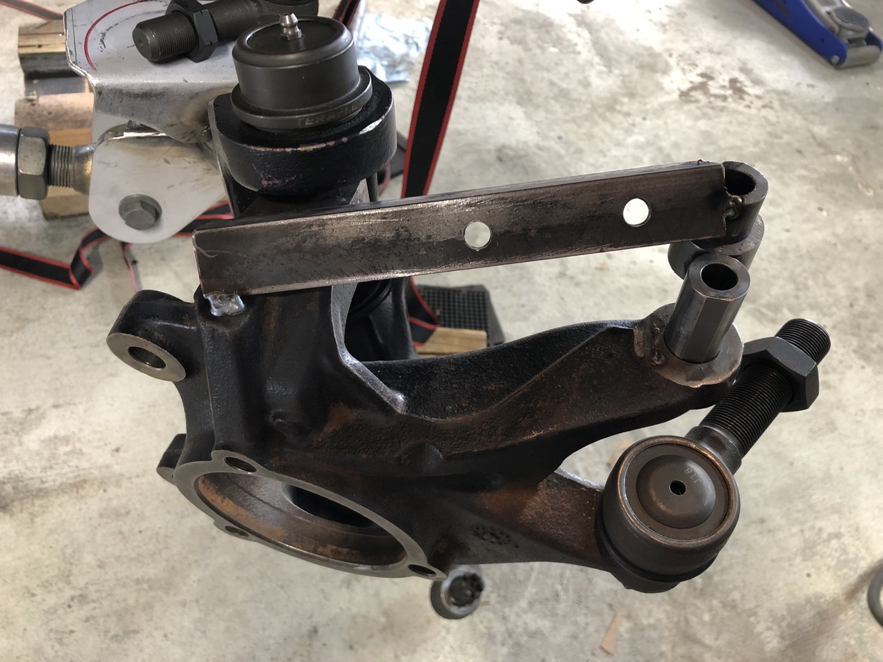

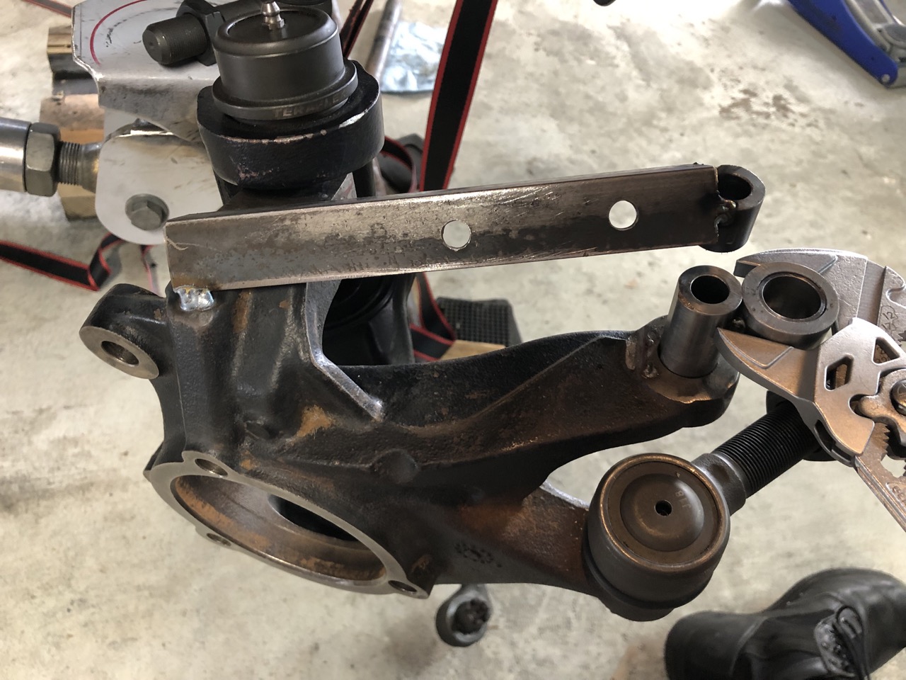

It's time to start figuring out that high steer arm, but I needed to figure out how to retain the position I came up with for where the drag link needs to go. My fixture was attached to the portion of the arm that needs to be cut off. Here's what I came up with:
That worked out! Now I have a pilot hole to use later on and a reference surface to build to.

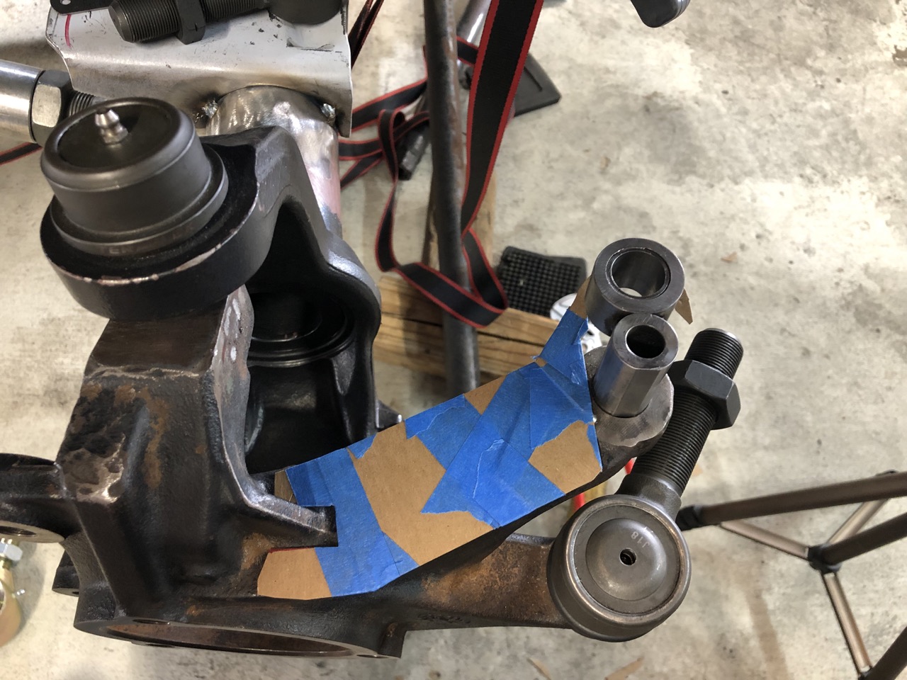

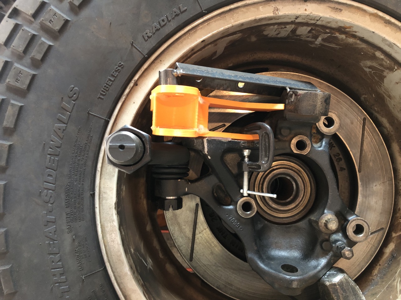

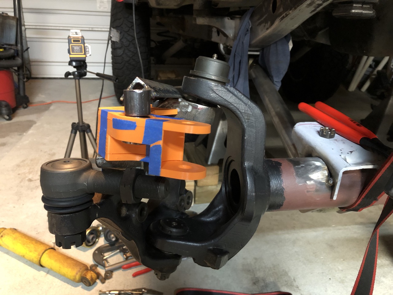

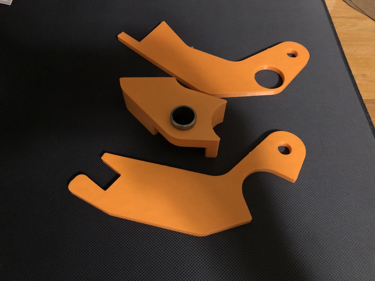

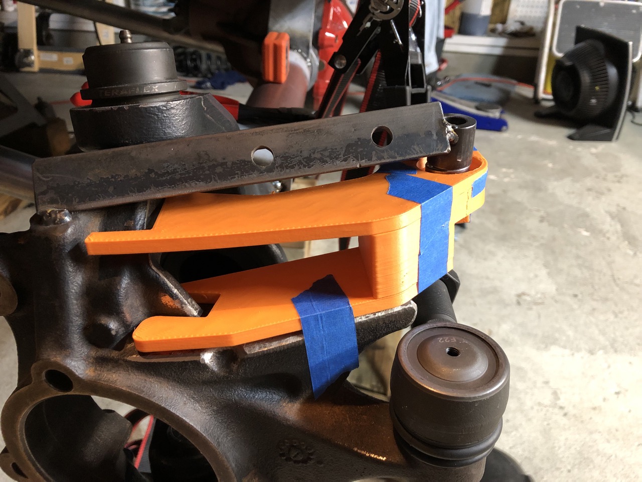

Alright so I made some progress on my steering arm idea. Converted the CADboard to actual CAD, printed it out in PLA, then mocked it up after a few iterations. Not sure this will be the final design yet, but I'm close enough to see if everything fits nicely. The construction will be 1/4" top and bottom plates, then a milled out chunk of 1.25" steel in the middle. That's gonna be a tough task in my mini mill, but I have a feeling it'll be alright.
The drag link would go into that tapered insert, then the double shear part of the bracket would be for a steering damper, or possibly in the future, a hydro assist ram.
I don't want to cut any steel yet. I don't actually have the tie rod ends I'll be using yet, those should arrive Saturday. Once I confirm those fit, then confirm the position of the double shear mount works, I'll go ahead and cut the parts out. Would be great to send this off to SendCutSend, but I really don't want to wait on the parts.

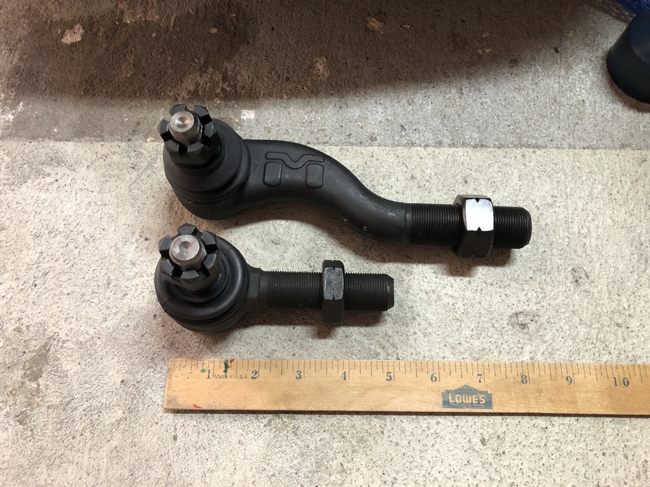

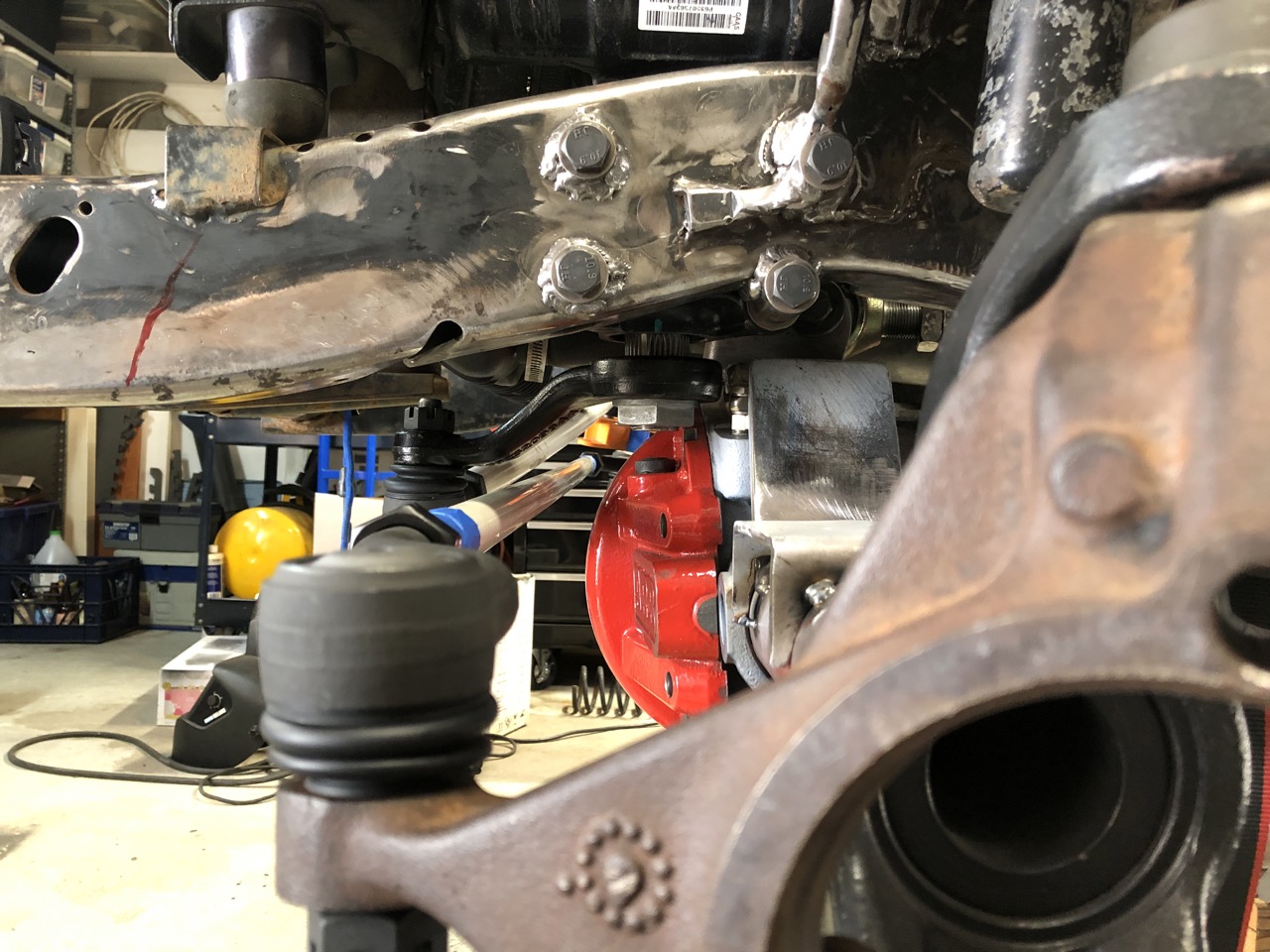

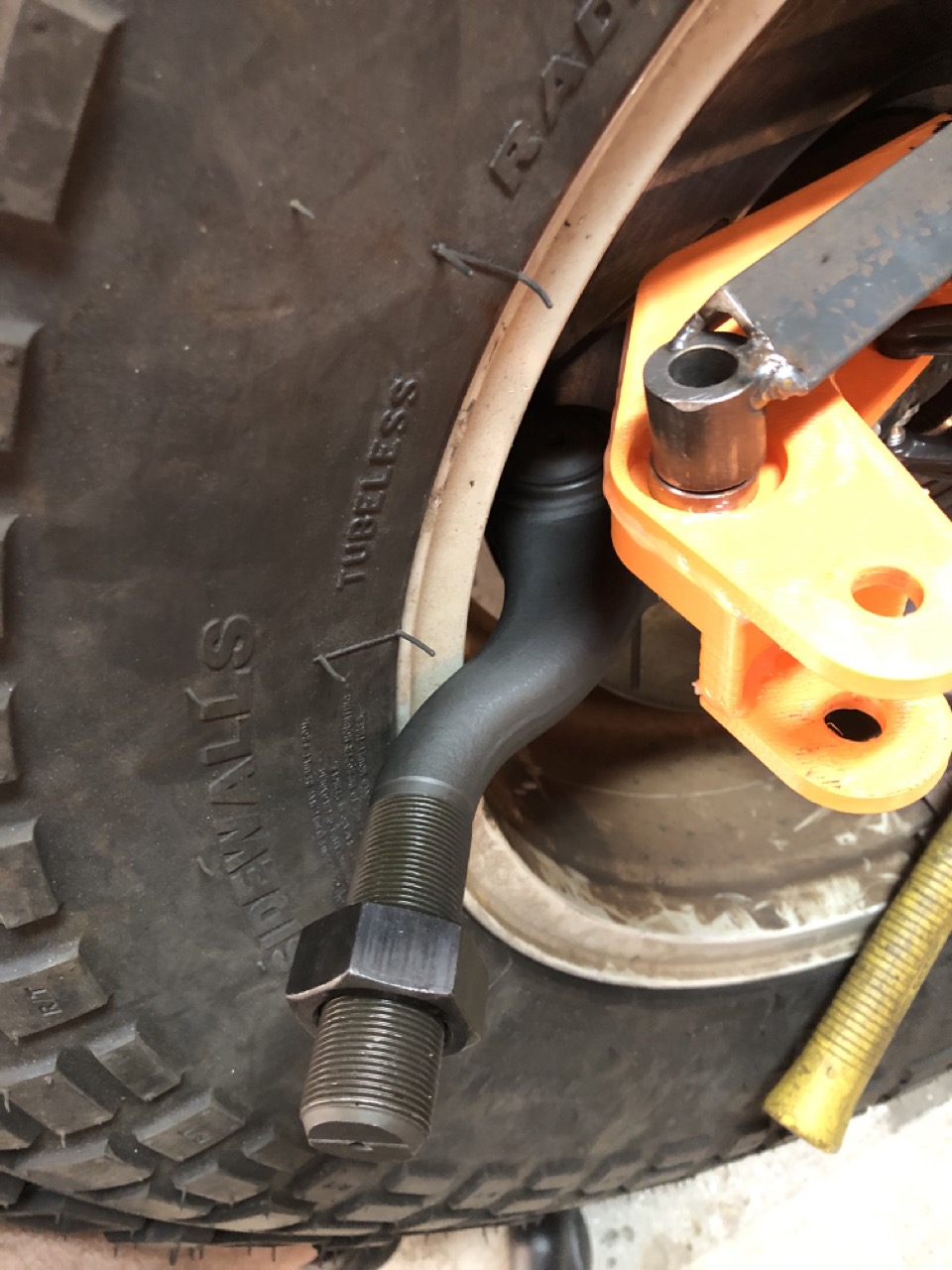

I've been busy with non-jeep stuff the past few days, but my Metalcloak dog leg TREs came in. Threw one on real quick to see how it looks, and I think everything might clear just fine. Need to trim a tiny bit more off the knuckle casting though.
The TRE might interfere with the stabilizer bolt, but the joint also will point down and away from it as it steers towards the bolt due to the steering axis at the ball joints, so it might just sneak on by.
Looks like it gets to a nice steep angle before it hits the rim, though a 1/4" wheel spacer might put it in a better spot if it isn't enough.

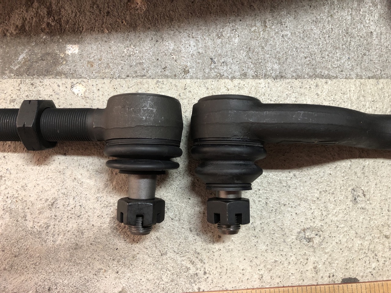

Here is the size difference compared to a normal 1-ton joint from Synergy
The shank is larger at 1" instead of 7/8", but the actual joint is the same size:
Metalcloak doesn't actually list these for sale on their website, but I was able to purchase the pair by emailing them. Hopefully they hold up, they seem like good quality!

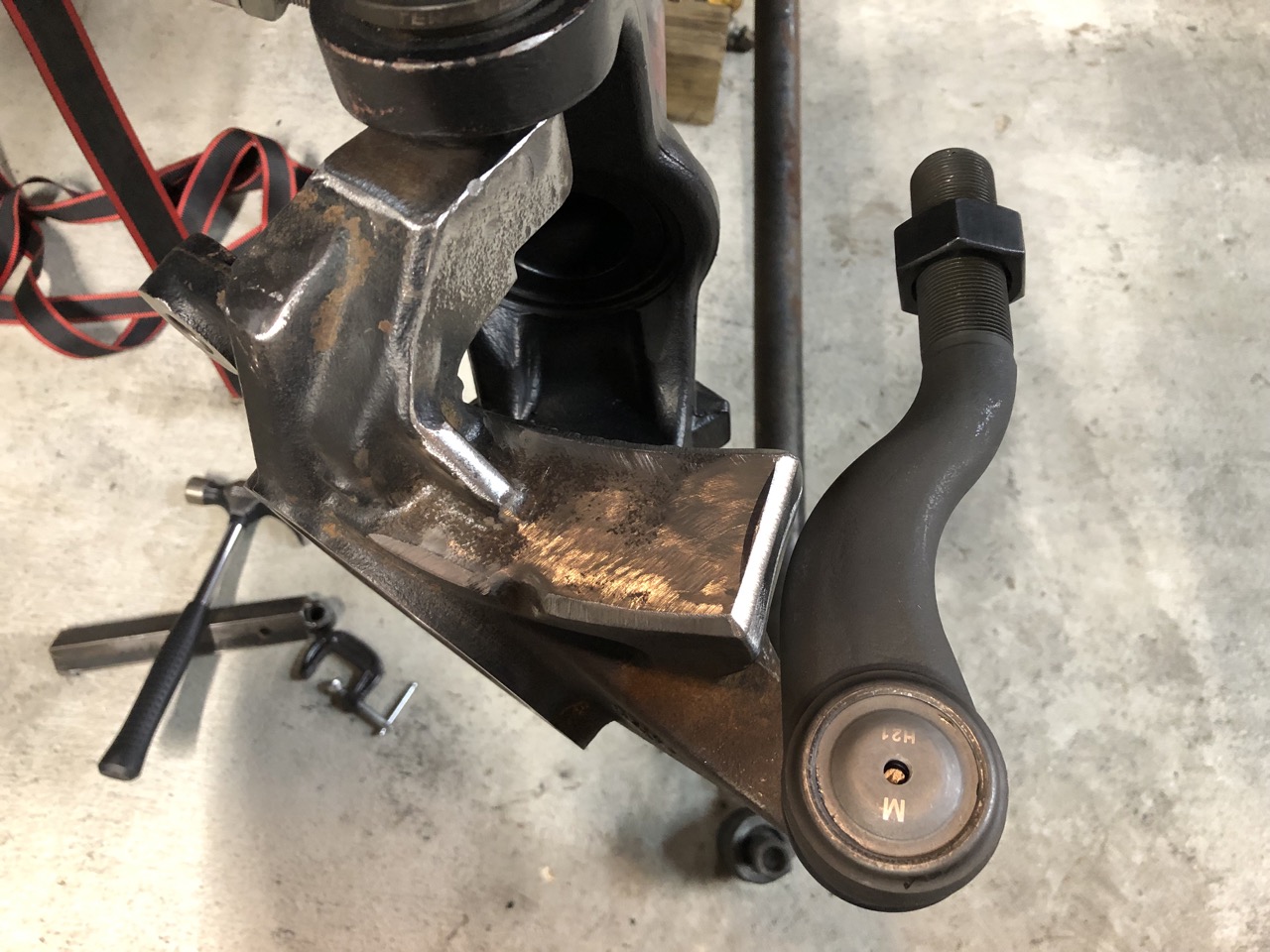

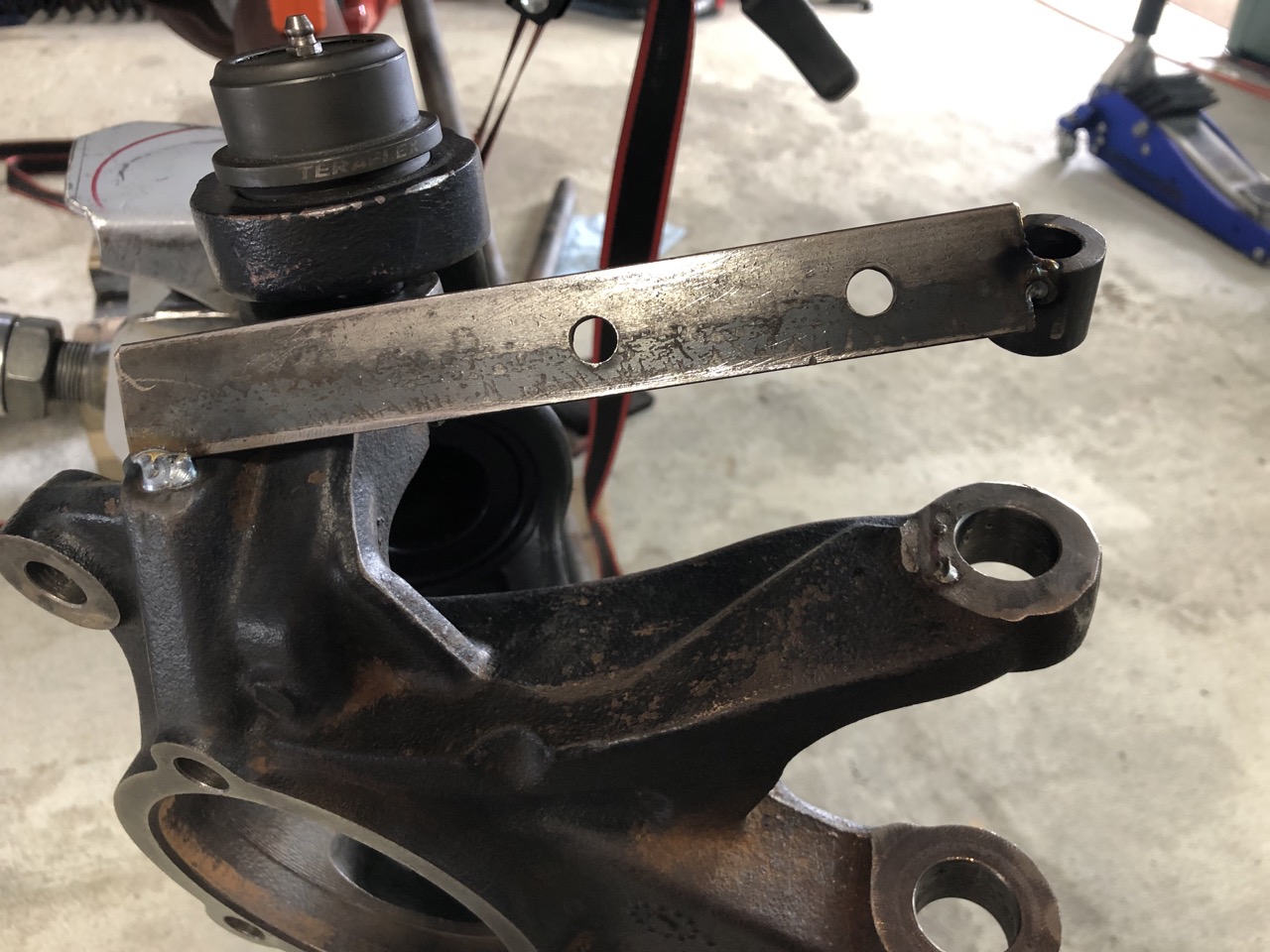

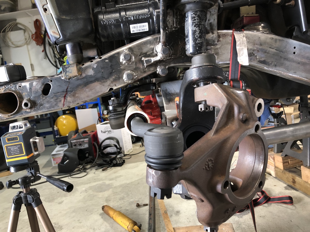

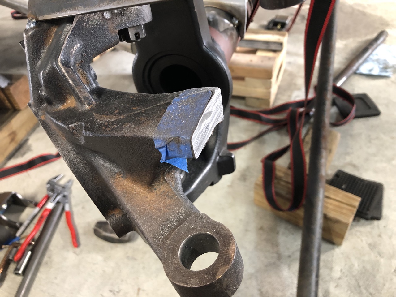

Cut another chunk off my knuckle:
Cut an even smaller chunk off my other knuckle:
Joint now clears the casting at the max angle it will see when steering, unless I adjust the steering stops for more:

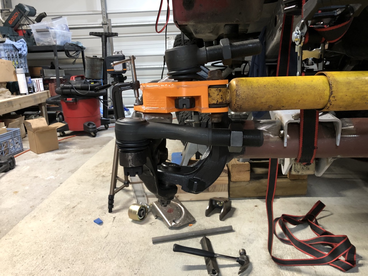

Here is the general idea:
The steering stabilizer might pose a couple issues being here, mainly the bolt hitting the TRE shanks and the drag link might collide with it at full stuff. Still need to move the axle around and see if it will be an issue before making it out of steel. Worst case, the drag link portion of the arm is perfect so I can just mount the stabilizer elsewhere if needed and remove that portion of the mount.

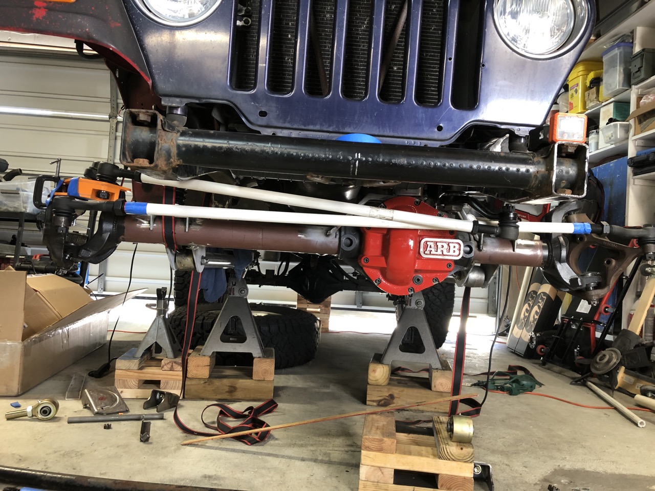

Not gonna lie, I panicked a little yesterday when I mocked up the tie rod at full stuff and saw this:
A couple things working against me in this pic though are that I stuck larger 2" PVC on there for mockup and the pitman arm itself was biased to the left side. I removed the pitman clocking key and rotated it right one tooth which gives me more front to back clearance when turning fully left. I really almost bought Rancho knuckles! I don't really know why JK/JL pitman arms have that offset to them, maybe just so the link can be an inch longer.
Clearances are still extremely tight with it so high up. I don't know if I measured something wrong when planning it out or what but I wasn't expecting it to be higher than the pitman arm joint. After thinking about it for a bit, I think I've devised a plan that should work and maintain optimal geometry.
Full stuff full right turn is ok, everything clears:
Full left turn is a bit tighter though:
Same viewed from the front:
Before, I was planning on just running straight aluminum bar for all 3 linkages with double adjustable ends, but I don't think there's any way around doing a bent trackbar. The bar needs to go over/in front of the diff cover then sneak under the pitman arm bolt. I threw my old currie track bar up there, and it does seem like it will work with a fairly similar shape. The frame side joint has enough space to live between the fully turned tie rod and the spring perch and can still be in line with the pitman joint. I've never bent tubing before so hopefully I can make it work on my shop press. Not aware of anyone locally that does that sort of stuff.

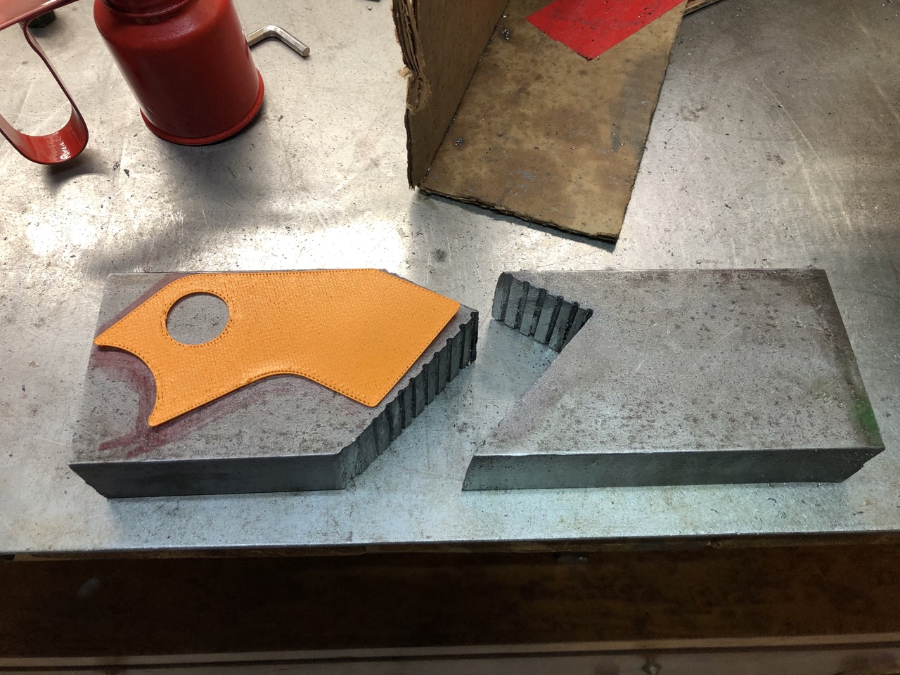

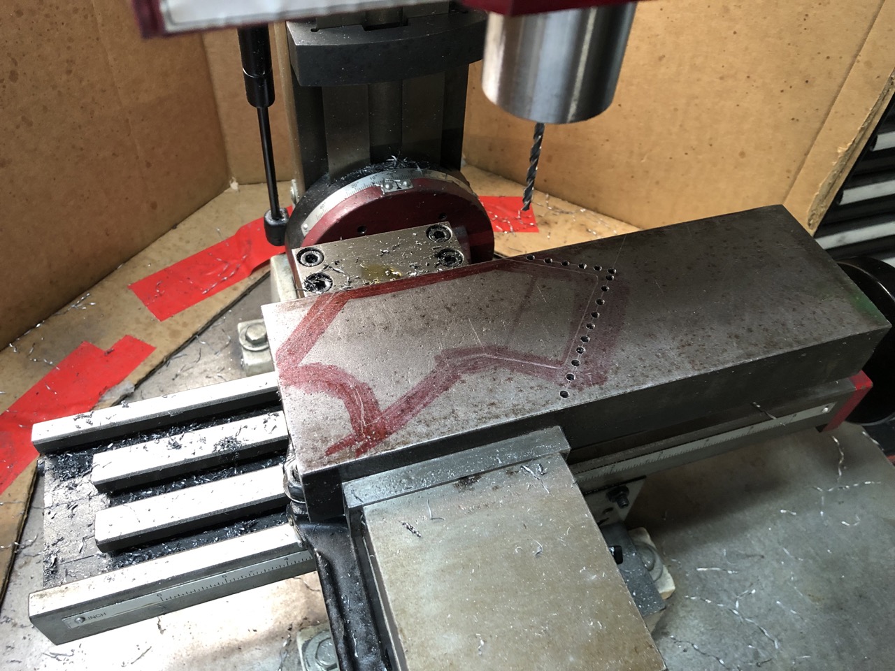

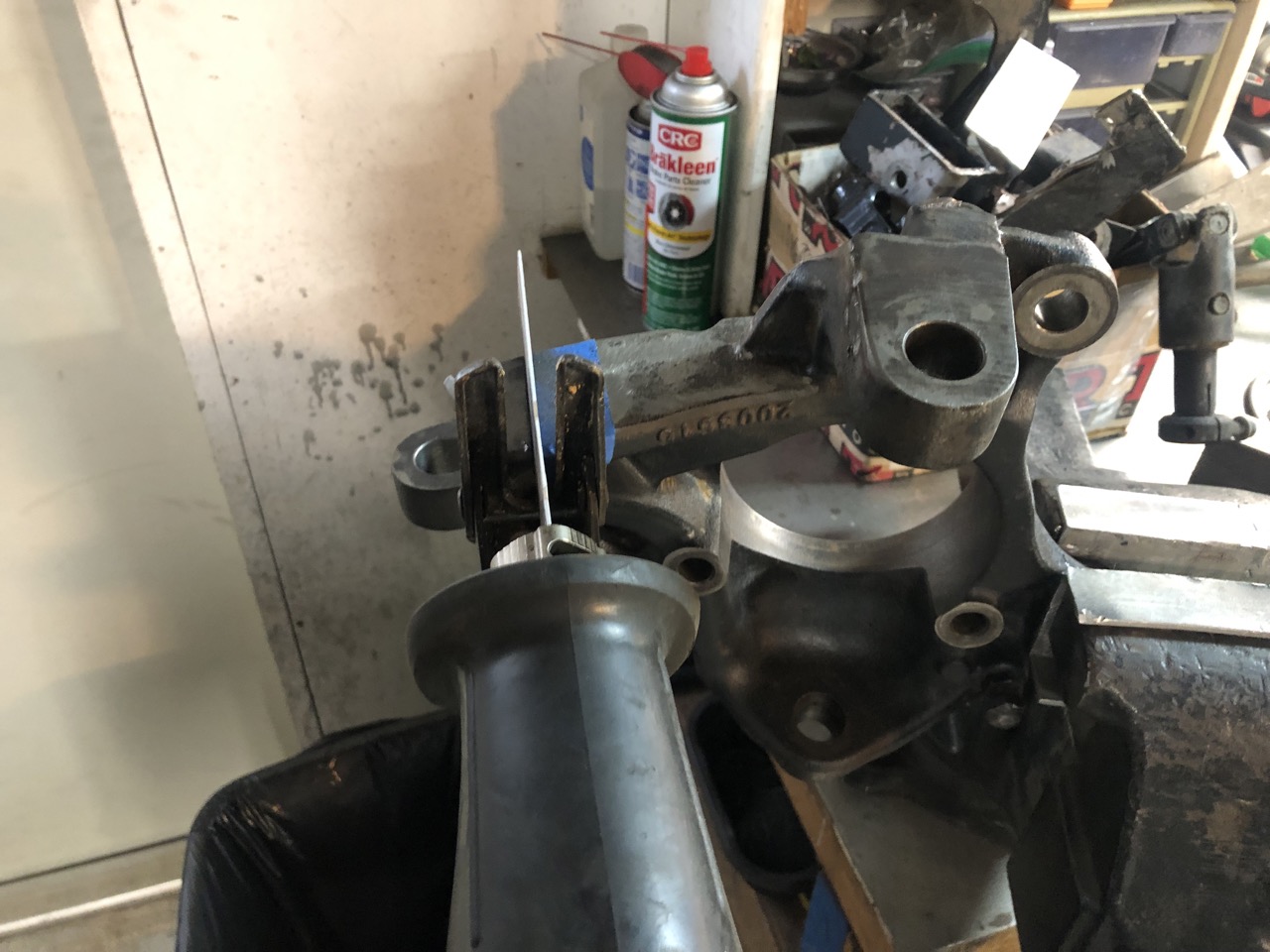

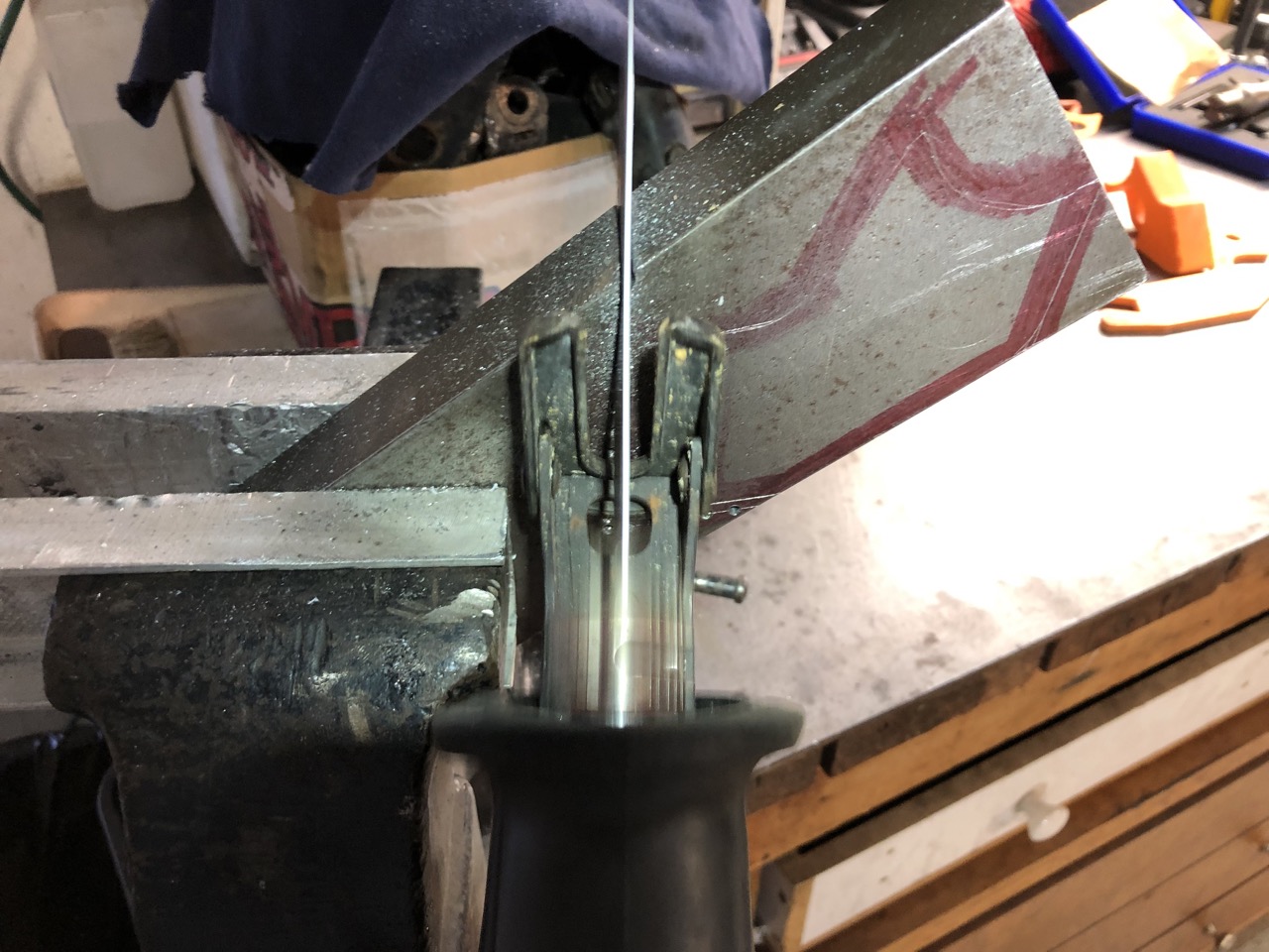

I made a bit of progress on that steering arm. 1.25" steel takes a while to cut!
I should have spaced the drilled holes closer because the sawzall part of that was not fun.
