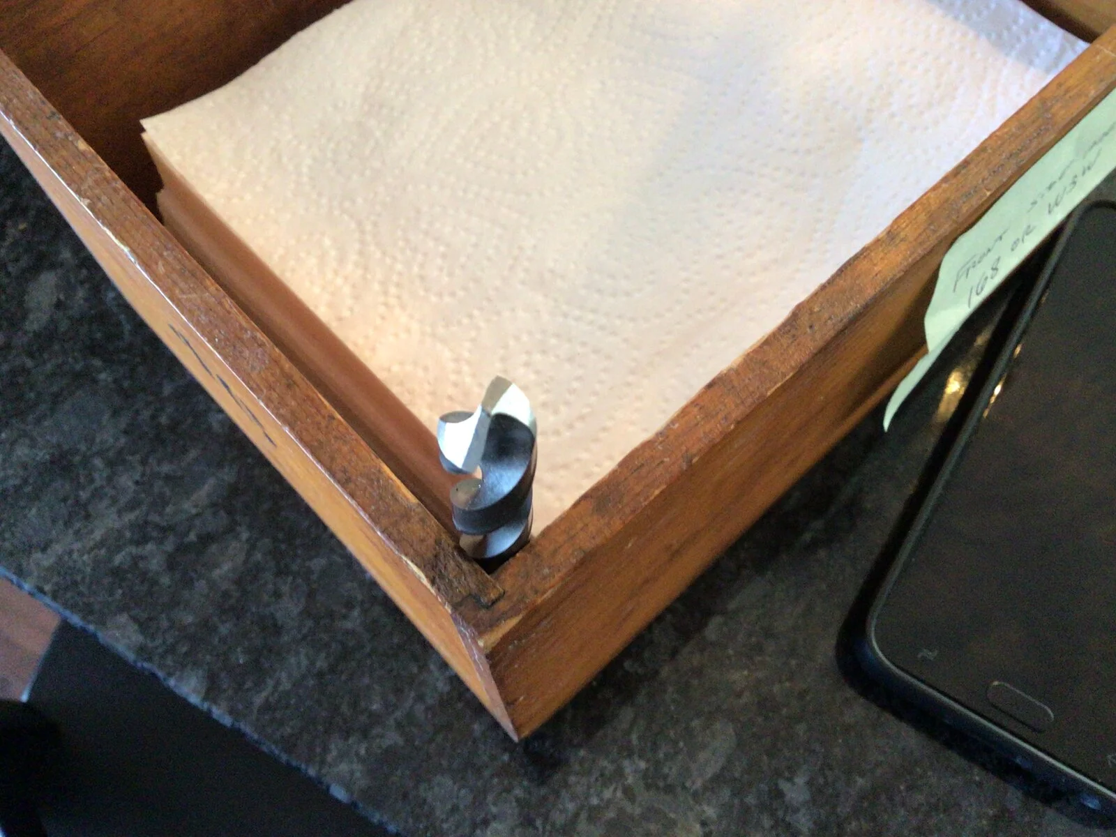

Another vote for bench grinder. It doesn’t have to be perfect. What I do is grind down the relief farther then needed, then sharpen the cutting flutes, leaving the flats around 1/16 or 1/8 depending on drill size. Cuts better and faster with the relief ground down. See pic.

LOL. I better be damn good.
