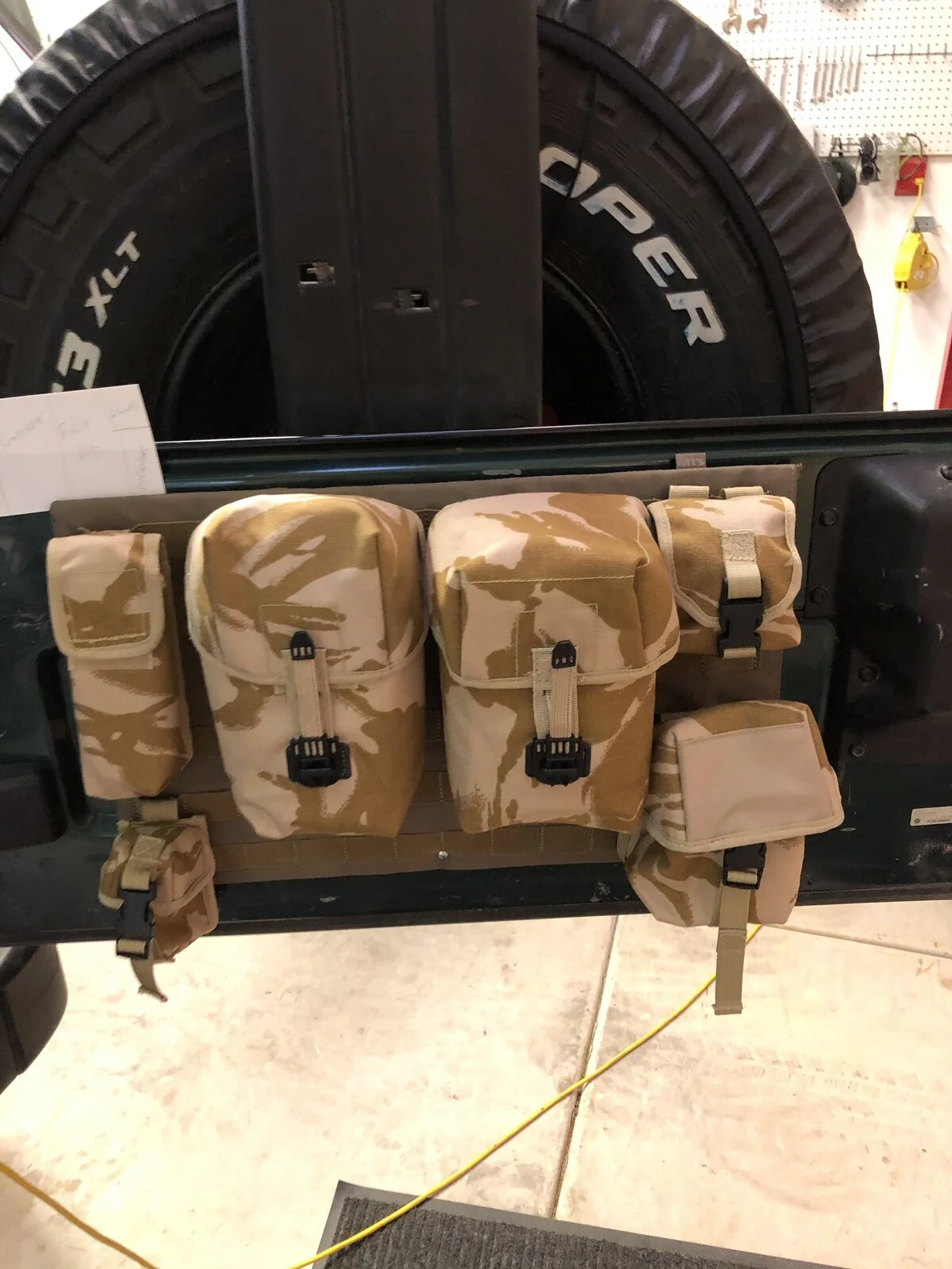

Those bags are pretty cool. I did a similar thing with a molle panel and molle pouches. infinitely customizable
