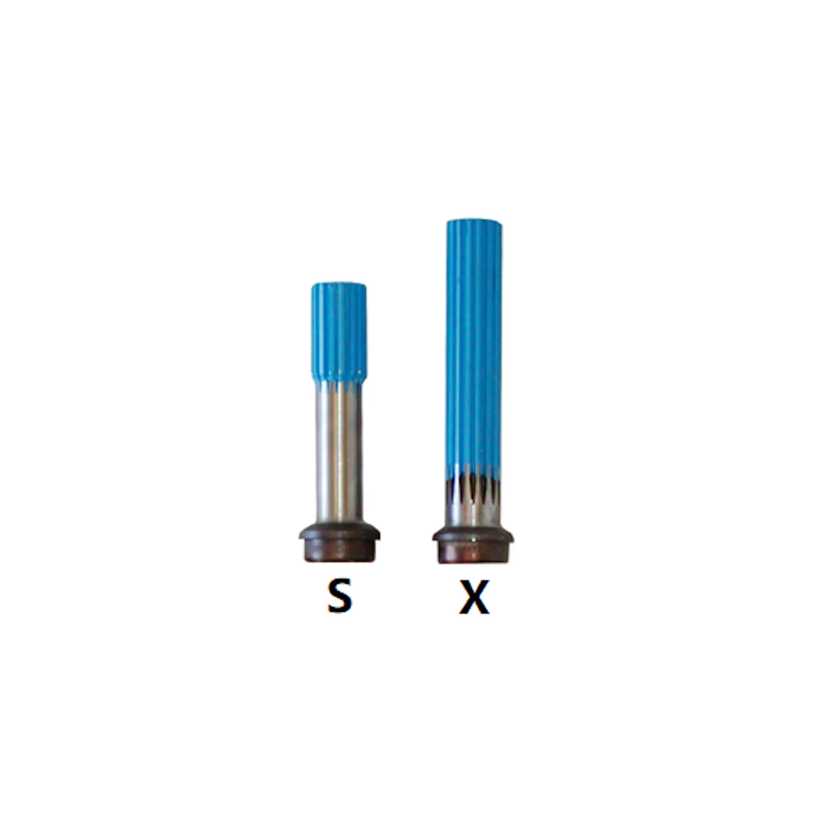

Hi everyone. Thanks to those who have recommended us. Here's some answers to questions.
Yes, you can get a shaft now that will work now and will also work when you install the tummy tuck. Just make sure to get the shaft built with a long spline, what we call the X spline and XC slip yoke. This will give you more compression and extension that you really need so there is some extra to accommodate minor length changes due to raising the transfer case.
*Edit* If you do this, you should probably add 1/2" to your current length to lead the target and get you closer to what you'll need when the tummy tuck in installed.
Here's my take on the greaseable vs non-greaseable question https://4xshaft.com/blogs/faq/greaseable-vs-non-greaseable-joints-which-is-better. They are both good options with advantages and disadvantages. There is no right answer to which is best and I consider it to mostly be a personal preference thing.
