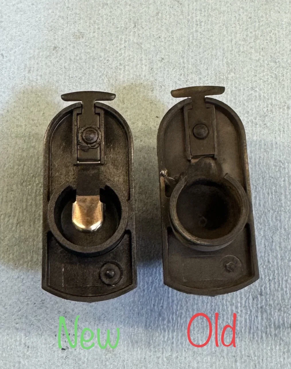

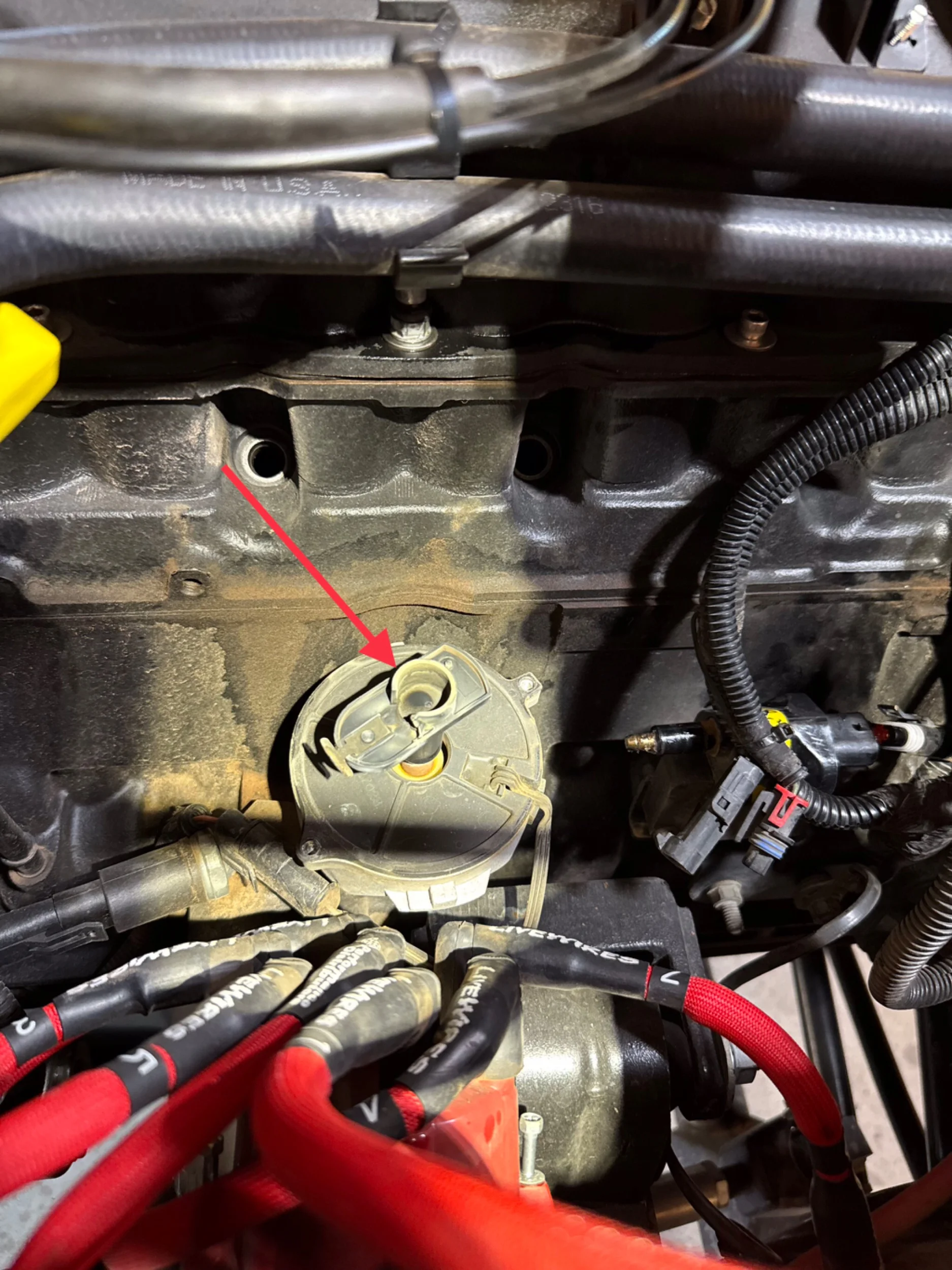

My '97 had its distributor rotor break last year causing it to die while driving and then crank but no start with fuel and no codes. $10 part.
Holy Cow! I kinda expected the plastic to be what broke. Anyway, How old is that old one?
About 10K miles on it as I recall. Haven’t seen that before but now I keep a spare in my recovery bag.
