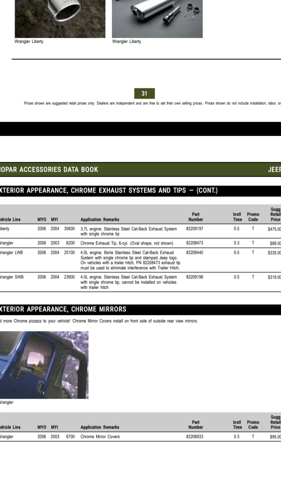

Thanks for looking out, but yes I do have an LJ. That cheaper Borla was a factory option so my assumption is that the quality and fitment will be spot on. What do you think the difference would be between the more expensive one and the Mopar Borla considering Borla only offers one? Product numbers for the LJ and TJ are in the picture.
The more expensive Borla’s will use the higher quality T304 stainless steel instead of factory quality T409 SS. Here is the touring LJ exhaust with T304 SS:

I've also been pondering this and read that Borla made an OEM exhaust for the TJ. Went searching for it and found one for sale on Ebay. Anyone know about this exhaust, opinions or anything? You need a different tip if you have the towing package, which I do, so curious to know if anyone else has this one.
http://rover.ebay.com/rover/1/711-5...0001&campid=5337789113&icep_item=322977359028
The bad: I bought that exact set-up years ago for $150 from a guy who bought a lot (i.e. cargo container) of Mopar parts. An internal weld in the muffler failed causing an annoying metal banging within a year.
The good: I called up Borla looking to pay for a replacement and the customer service guy said he'd send me out a replacement free of charge. It ended up being the higher dollar one in mots' post.
