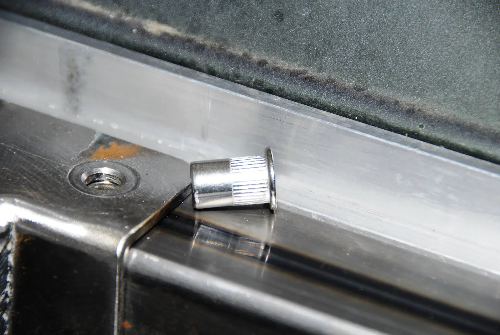

I saw a post a while back that mentioned using nutserts on the lower side of the steel slider so it can be removed without removing the aluminum base. But normal nutserts are too thick at the flange to let it sit flush. And now I can't find the post because this forum has 4 bazillion threads that talk about savvy and/or nutserts in a limitless variety of contexts.
Anybody have a source for ones like savvy provides, or better yet, have some leftovers I could buy off you so I don't have to order 100? Looks like I need 14.

They don't have to sit flush but you can take a countersink to the outer edge of the hole and get them to sit more flush. If you really want them to sit flush, that is very doable if you are sufficiently motivated by using a piloted counterbore. I needed the flange on the ones below to sit flush so I used a piloted counterbore after I drilled the hole.
A Rotabroach kit is a game changer for sure.

It’s handy for sure, I got it on the recommendation from Blaine on another thread. I used it on my sliders, I also found it did an amazing job at the factory nutserts that hold the flare extension on. With the rotobroach I was able to cut them flush to the tub.
I became a rotabroach believer after doing my driver side slider install with twist and stepper bits and my passenger side with the rotabroach. I did the bigger kit since I wasn’t sure on necessary sizing.
