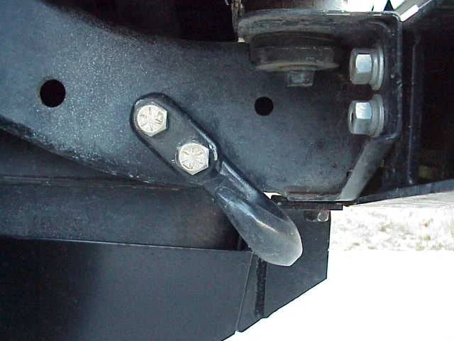

One reason I got rid of the dirtworx bumper and went to the savvy was to decrease the amount of overhang on the rear end. Adding a tow hook to the frame would negate that gain.
Sundowner said:
Yeah, how so?
79299
My jeep never have that tow hook. So I was not aware. The way the savvy bumper frame tie ins are placed I'm not sure I would be able to use that mounting location. I will have to look when I get home.
Nobody's Jeep has that tow hook; that's an aftermarket model that's been mounted into an existing hole, with a second hole drilled in an appropriate location. Regardless of location, the same idea applies: make a direct connection and skip mounting something to something to something to a shackle if possible.

As i suspected I cannot place a tow hook were the above picture shows one do to the design of the savvy frame tie in, seems I am very limited in my options. what would be the difference in side loading a hitch link vs. side loading the tow hook shown above? Does the tow hook have a rating that is that much higher? In the picture posted above by @Mr.Bills wouldn't you be side loading that hook anytime you use it? Does that tow hook have a rated capacity on it? in looking at the hitch link they are rated for 9k lbs. I know you have to reduce that amount when side loading, but how much?

If you have a soft shackle and a receiver pin, stick the shackle in the receiver, stab the pin through it and there is all the recovery point you will likely ever need. Personal preference only, I've never been a fan of the frame hook mounted that way.

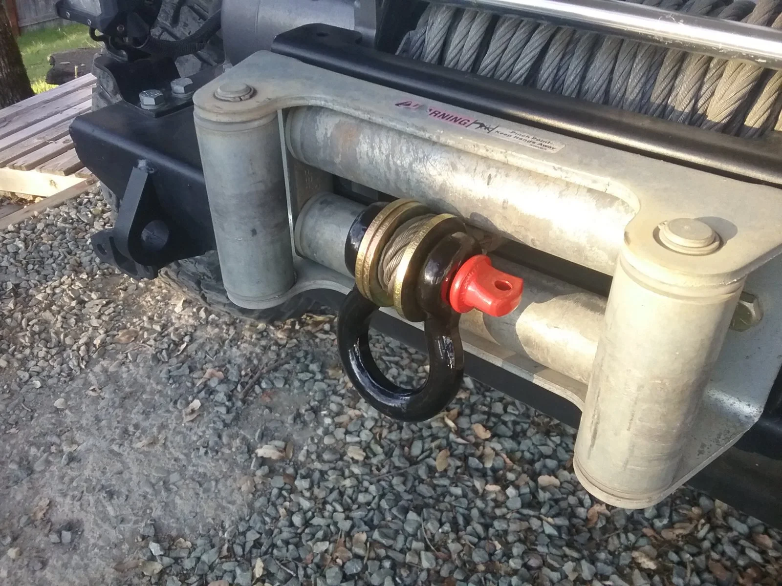

I have steel line and the typical roller fairlead. While not the most glamorous looking, I use a shackle and some big ass washers. The washers keep the shackle snug and protect the rollers and my hand. Also keeps it out of the way so I can mount my license plate to the rollers. Any problems with this setup?
