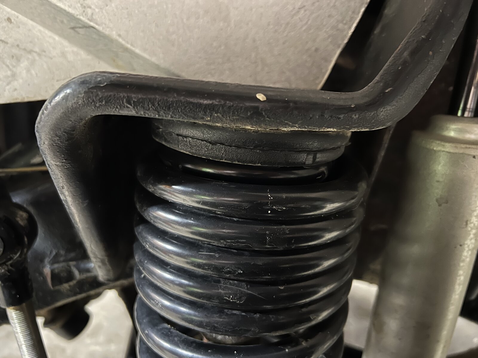

I can try spinning the isolate itself sure
But as you see the coil is actually running up against the coil tower.
In the front side of the spring correct? That’s why I’m saying the upper spring needs to be shifted towards the rear some. You have it on the very edge of the isolator
I’ll take a look at it tomorrow and see if I can possibly shift it some

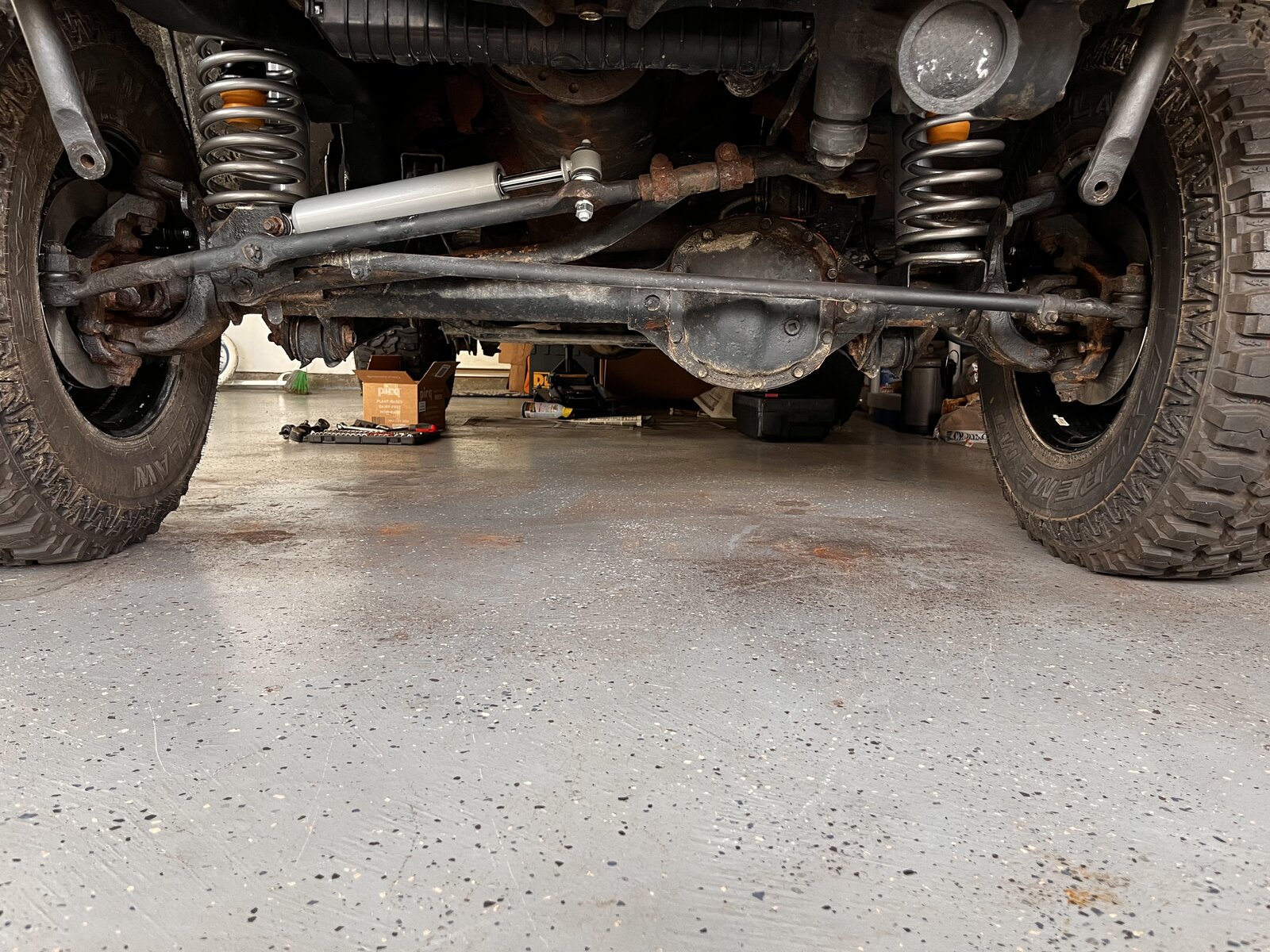

i think we're wasting our time here trying to decode if a spring is rotated into an isolator correctly or not. to cause a bow that severe?
were looking at an axle misalignment (less likely with non adjustable arms, but more with frame correction)
potentially a replaced spring bucket or something?
poorly relocated track bar hole with a lateral bow in spring?
I don't think a spring not being rotated properly would cause a bow like that.
maybe try measuring from center skid plate bolt to axle end control arm bolts on both sides and see what you come up with?

Did we ever get a tire to tire measurement on each side
Your right, not sure if that is THE issue but definitely needs addressing. they are 4" springs and the axle end track bar hole hasn't been relocated for the stock track bar. you can see the shift even over on the passenger spring.
Guys- There’s the story right there-
Just do this-
Disconnect one end of the track bar in bounce the frame up and down
Watch what happens
Now get ready not to be able to reconnect the track bar if it’s not adjustable- Rough country actually sells one that’s pretty decent now for 129 and both ends are completely rebuildable
Only issue is the OP said they were 2.5” springs.
I still think you’re on to a major suspect. Even at 2.5, I’m curious if these are still stock arms, the bushings are old, and a Track Bar that is fixed and not for this height, the axle gets squirrely.
This is the bait and switch, “plug and play 2.5” yea right, it all has to work together.
