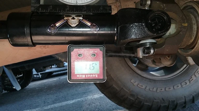

Did you ever come up with a good spot to measure that rear drive shaft? On my rubicon there are two raised spots just ahead of the slip joint. Between them or accross them is what I have been doing. I can’t see a good spot up on that double cardon that looks flat.
