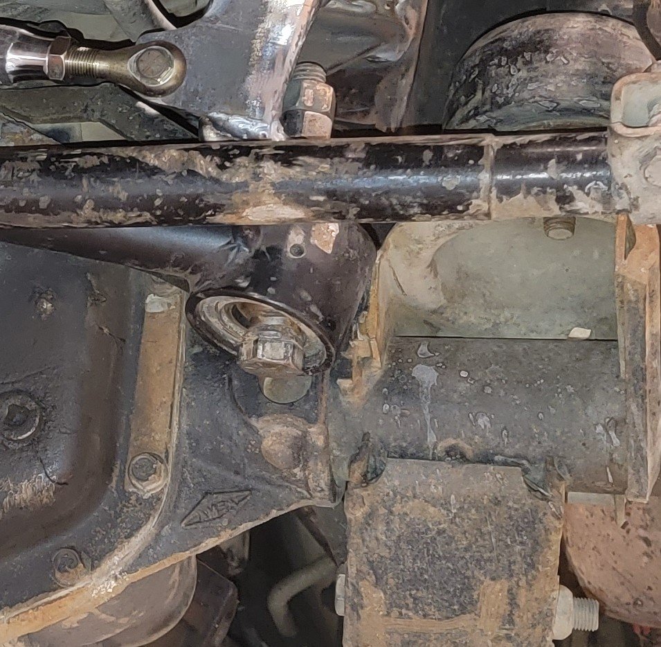

Pull the zerk and see what that gets you.

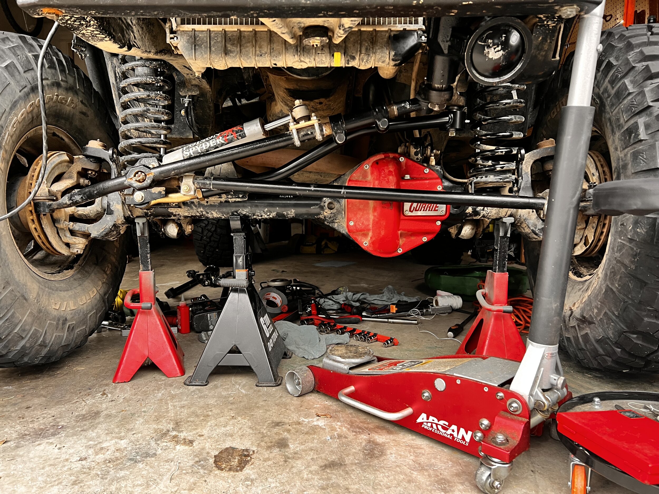

How much forward stretch did you get ?

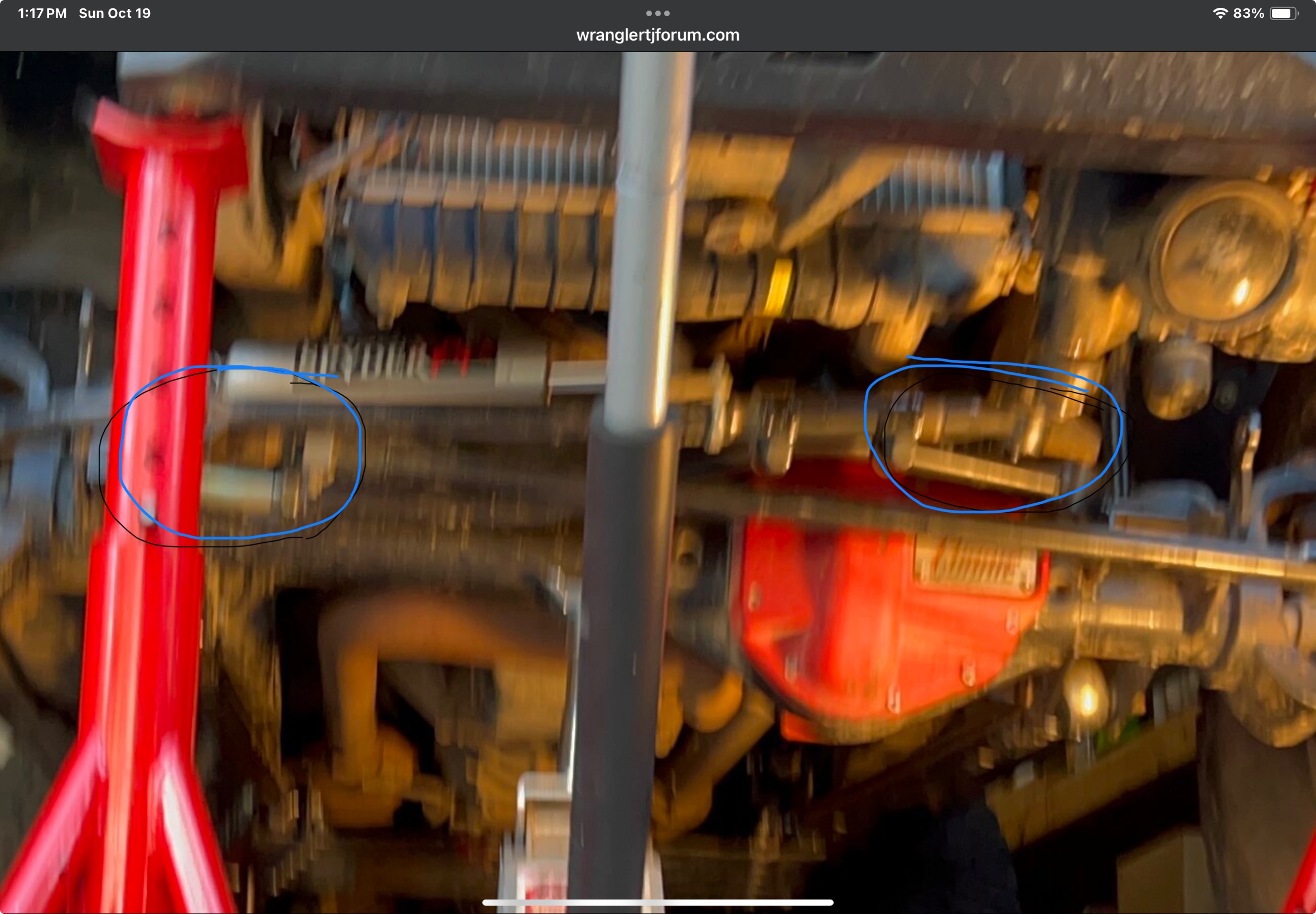

here is zerk making contact
I know my camera sucks. I tried to post a video of me cycling it but can’t figure that out.
Depending on where the starting point is, about 1.75". My current wheelbase is 95".
That's more than I thought you could get . Cool .
The limit becomes the track bar contacting the drag link near the pitman arm. This is after reshaping the drag link and track bar with a press and trimming whatever else is in the way on the axle. The TB frame side Johnny joint covers about half the case spreader hole on the axle at full shock compression. Anything further forward requires moving the steering gear.

If the zerk is making contact with the spring perch, trim the perch so it clears.

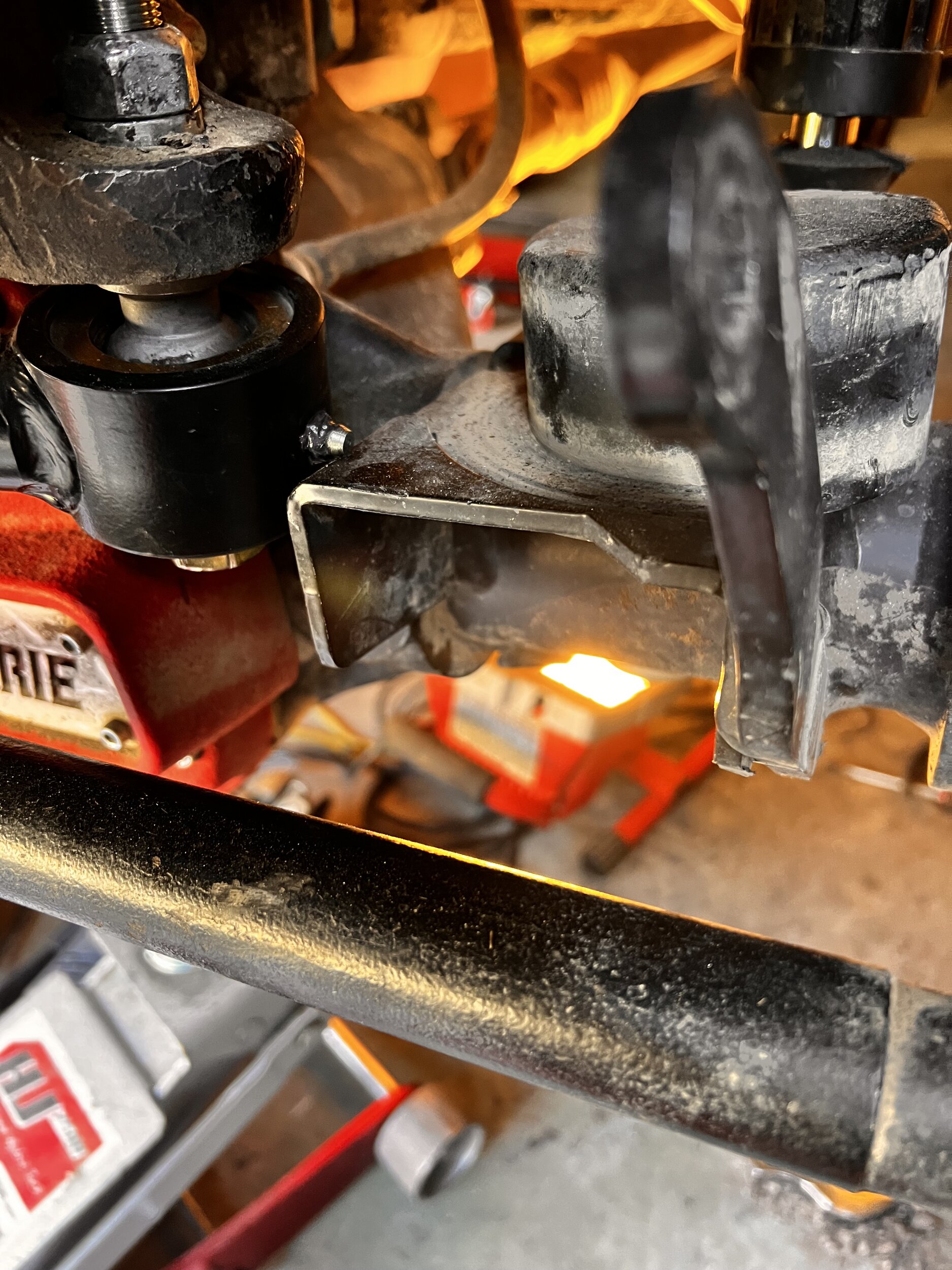

I probably will have to. As far as putting more bend into the trac bar what the best method for accomplishing that? Do I just bend more where the existing bend is?
You’ve got a Currie TB, so the bend is good. The circled parts are what I dont’ understand, perhaps because i can’t see them clearly, but they look odd. Additionally, perhaps the Currie diff cover could be replaced with something not as deep to make room for the TB.

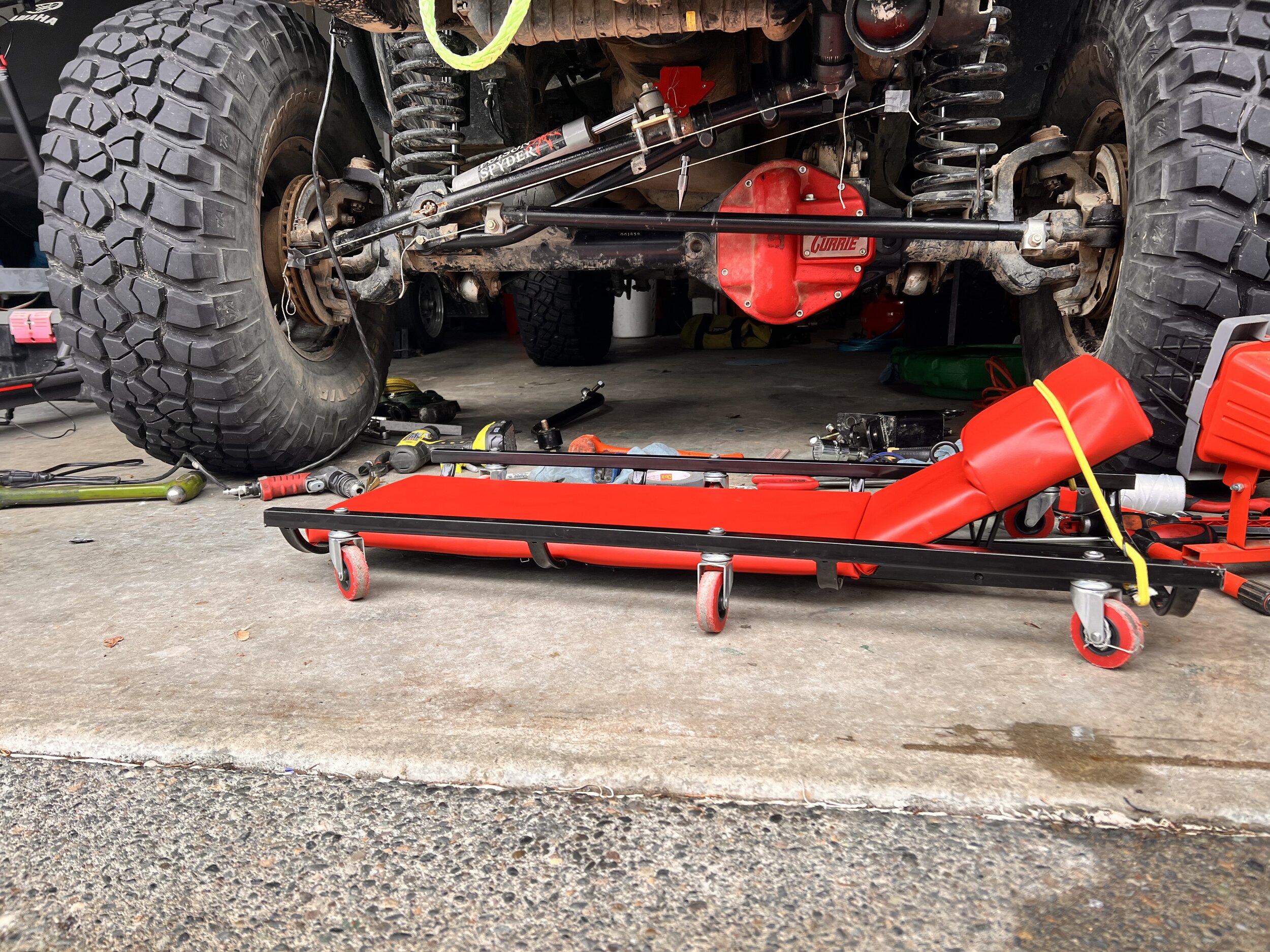

Or this with it on the ground under it own weight.
Hold still while taking pictures.
We use a shop press and the mark that hits the diff as the bend point. That mark would be up and pressed down across two press blocks. Be aware you may need to add a compensating bend to line the joint back up in the axle side mount. That means adding a slight amount of bend at the end of the first straight section.I probably will have to. As far as putting more bend into the trac bar what the best method for accomplishing that? Do I just bend more where the existing bend is?
