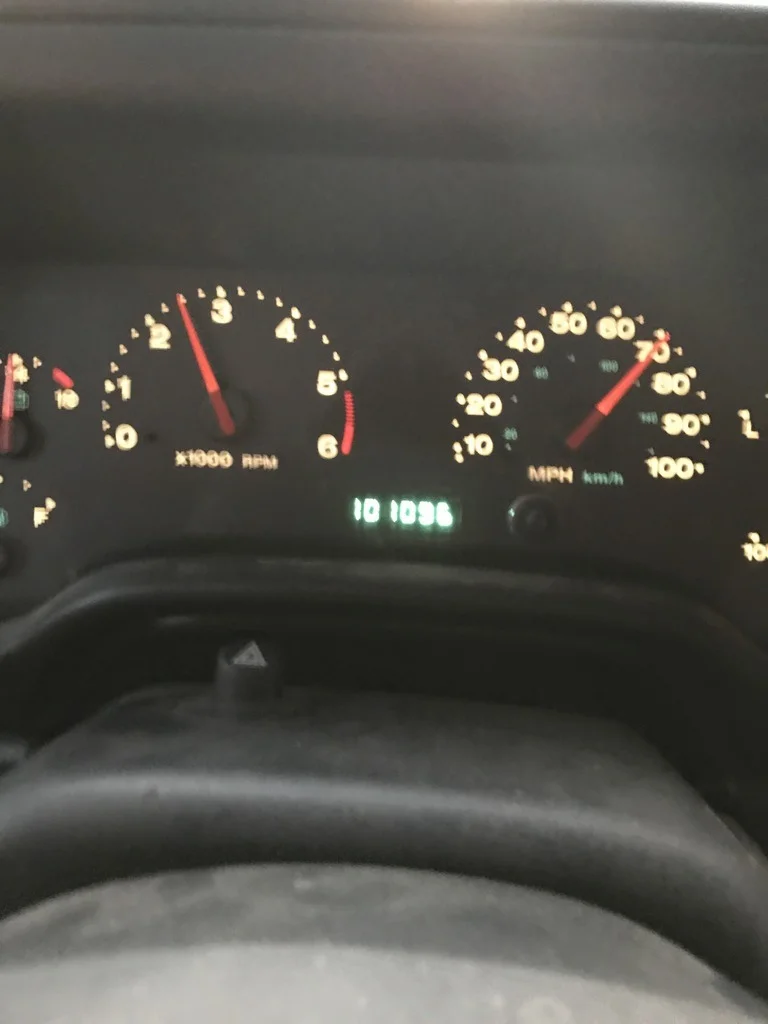

My jeep is an '05 with the 42rle. I'm running 33's and geared to 5.13.
Should have done it years ago.
Thanks that really helped!! So if the jeep did have over drive the gears would be different then? This is just for my curiosity at this point lol
Those rpms in his photo are exactly what you want to see at that speed and those are the rpms you would see with 5.13 on the highway with 33's. Perfect rpms and as you can see, they're not even close to being too high.
