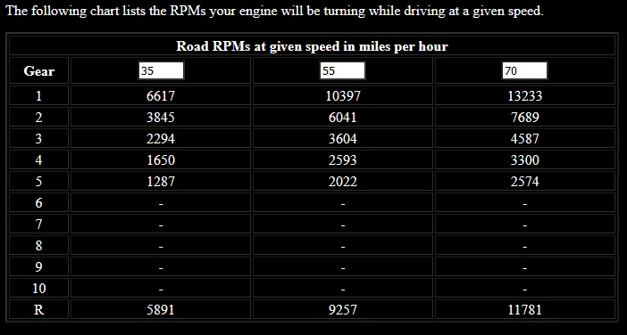

For the RPM question my 33s measure closer to 32 so I am running just shy of 3000 RPM at 70 on 4.88s, but most of the roads around here are 60 - 65 so I am in the 2600-2700 range most of the time.
