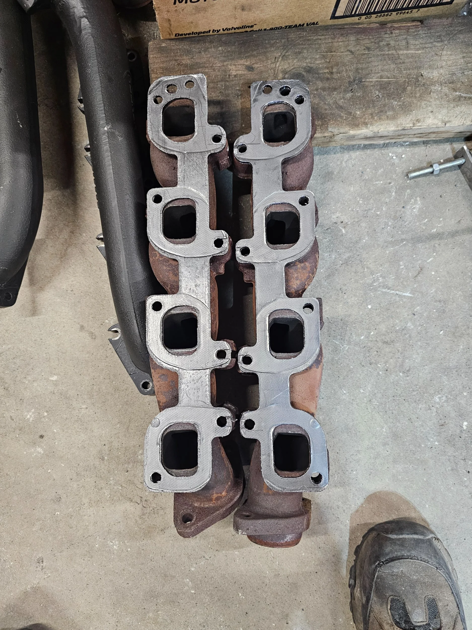

It looks like there is enough material on most of the ports to blend them some.
At this point I'm going to wait for the new exhaust manifolds to arrive before I try anything. Then if the new ones don't fit/work I'll look at trying to make these flow better.

Is there a comparable set of manifolds from later hemi's?
Don't know yet. I've ordered a set of later model GC manifolds and I'll see how they fit once they arrive.

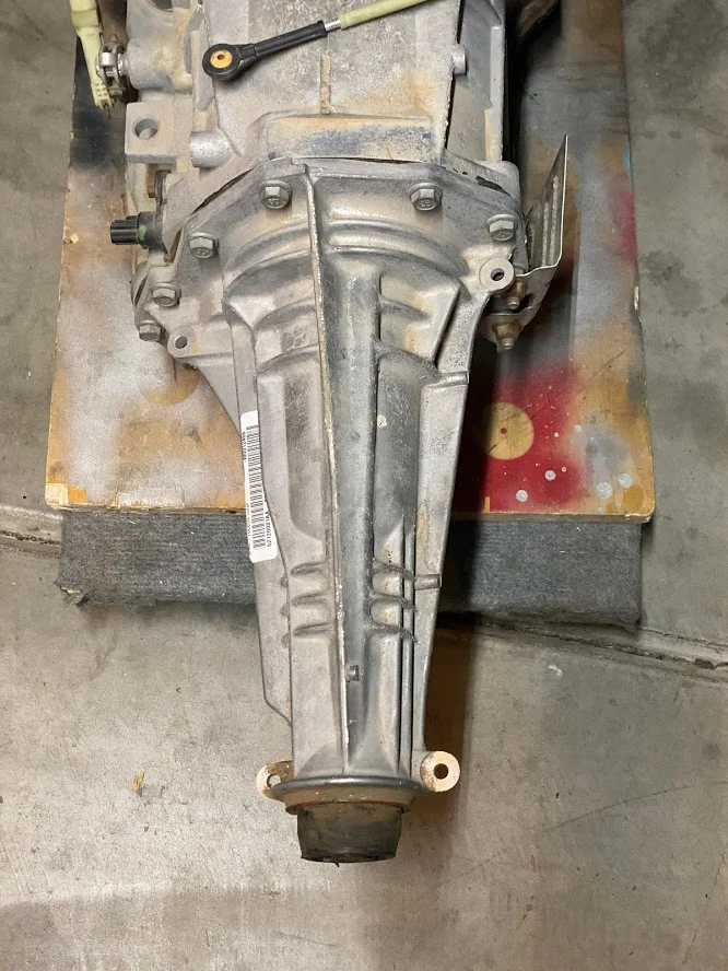

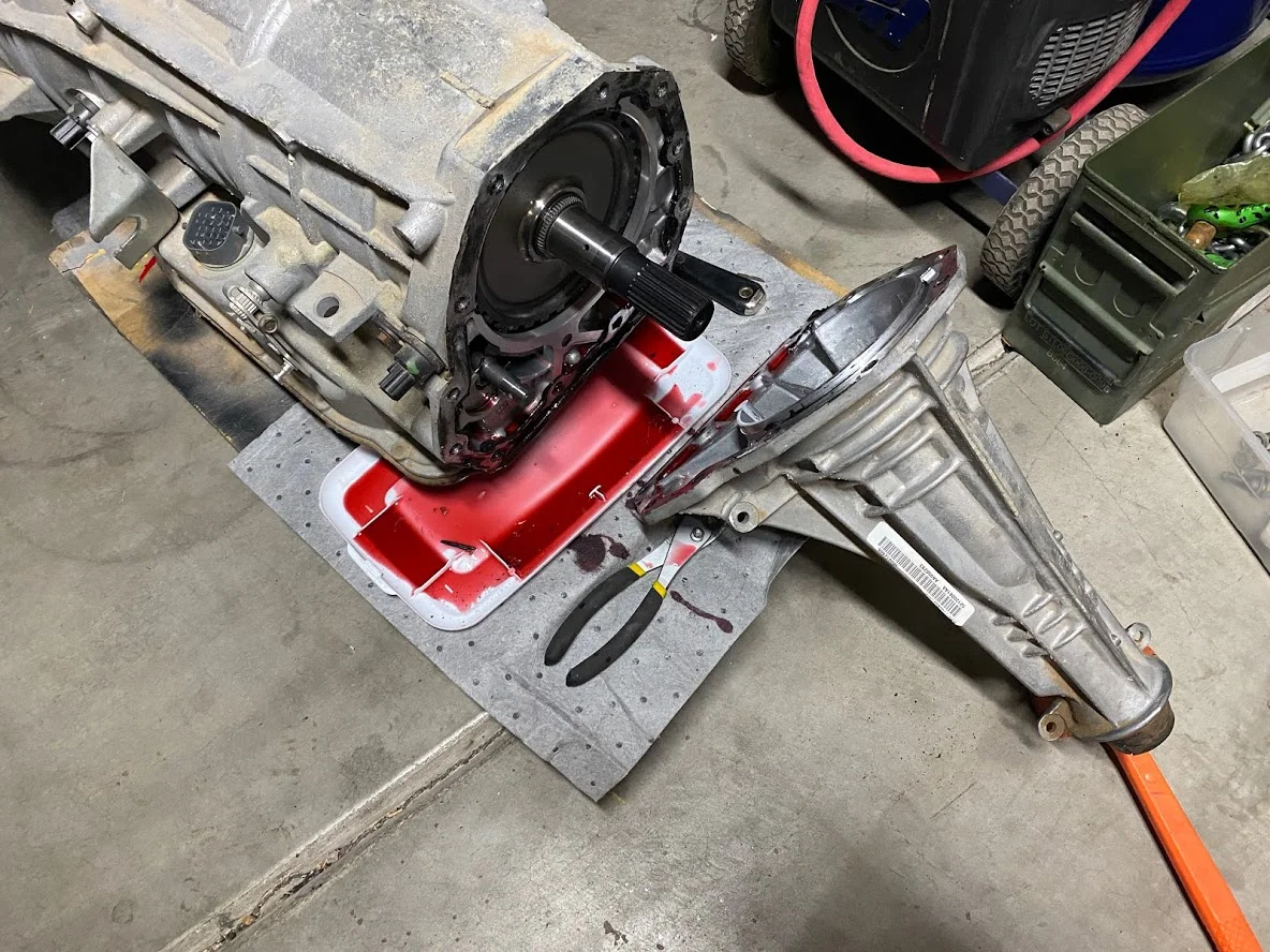

In case you missed it in the earlier post about it, the 545RFE and 65RFE are considered "modular" transmissions. While most transmissions can be converted from 2x4 to 4x4 configuration, many needed to be disassembled in order to do so and many needed new/modified output shafts. The 545/65RFE is different; going from 2WD to 4WD is simply a matter of bolting on the correct tailshaft housing/extension.
[Factory 2x4/RWD tailshaft of the 2012 65RFE I'm using for my swap]
[Removal of 2WD tailshaft extension]

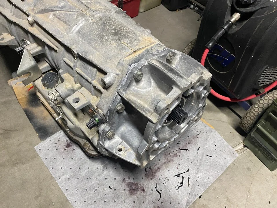

Removal requires nothing more than removing the 15mm socket bolts around the perimeter of the adapter, then using a small rubber mallet and a putty knife to break free.
[4x4 t-case adapter installed]
Both the 2WD and 4WD extensions are installed with Black RTV. My transmission-rebuilder friend (the one who gave me the extension for free) suggested "Ultra Grey" since the black will sometimes weep. When a trans rebuilder for 20-years suggests something, you do it! :)

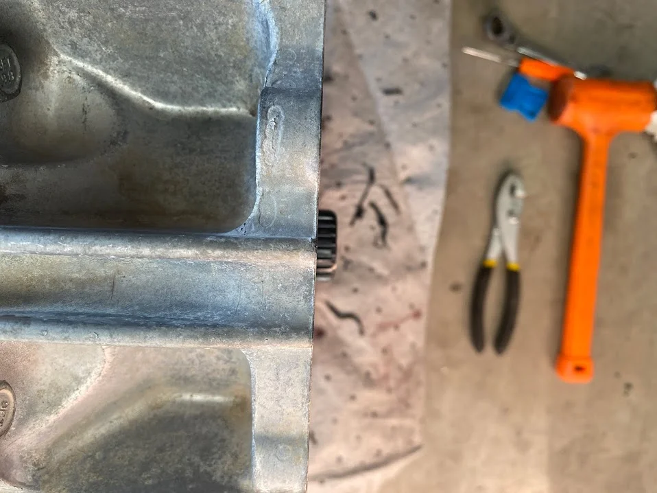

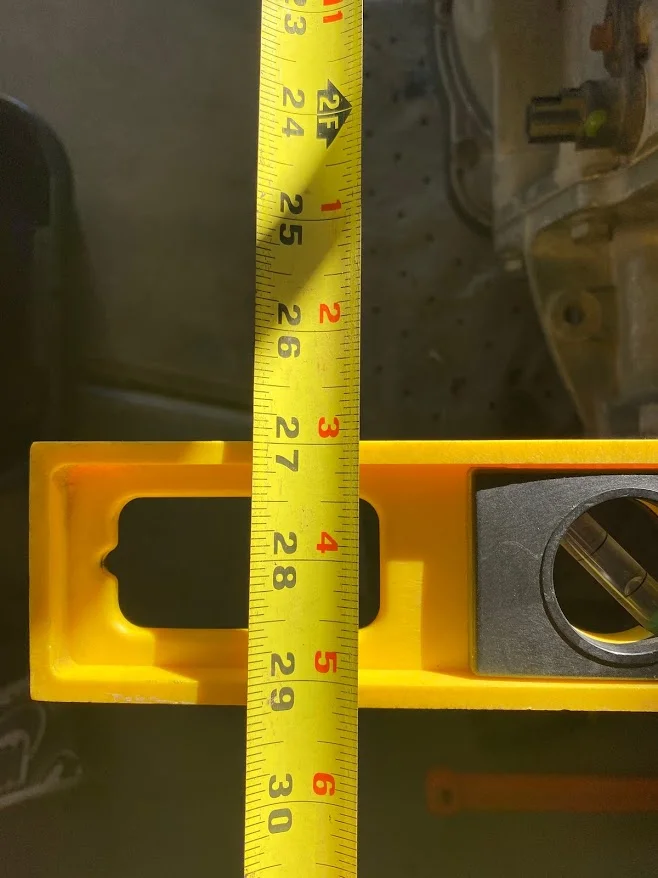

[Output shaft stickout w/t-case adapter installed]
[Output shaft stickout; edge of shaft to t-case mounting surface]
[New overall length of 65RFE w/4WD t-case adapter installed - nearly exactly 27"]

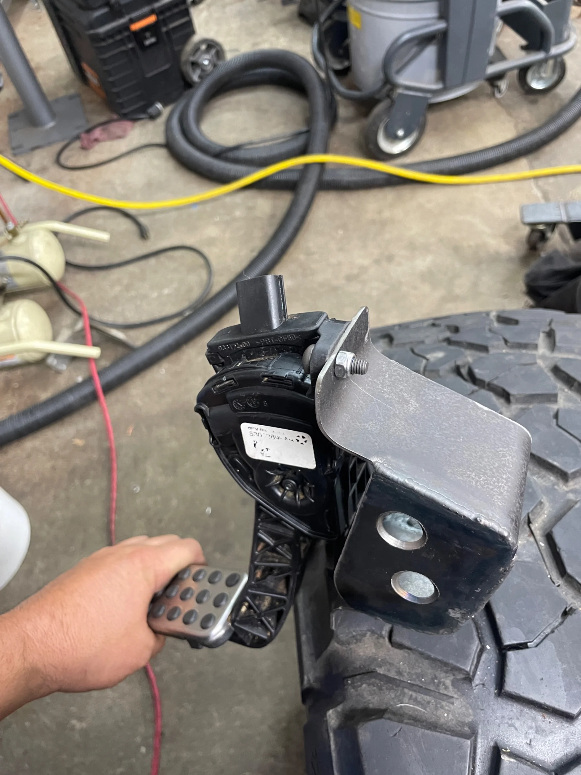

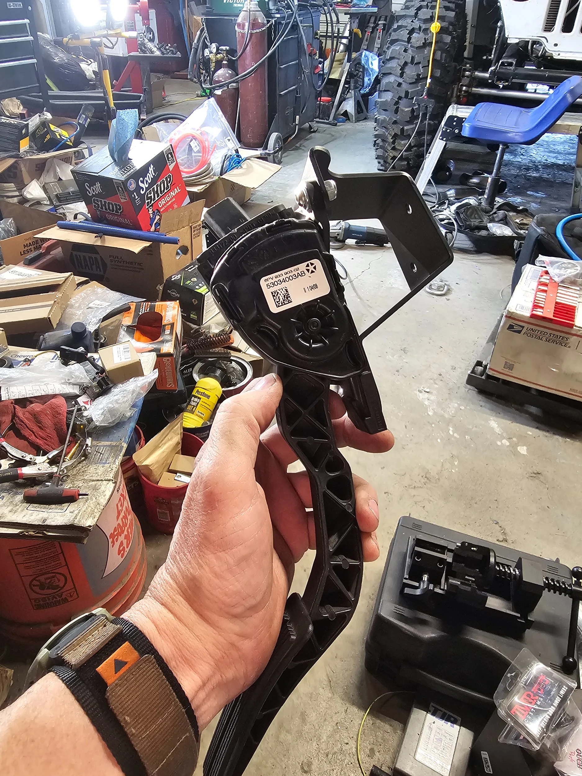

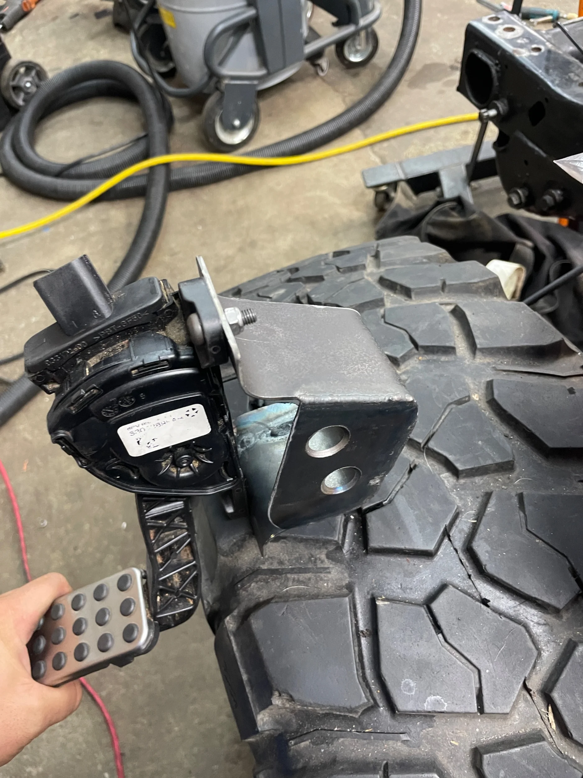

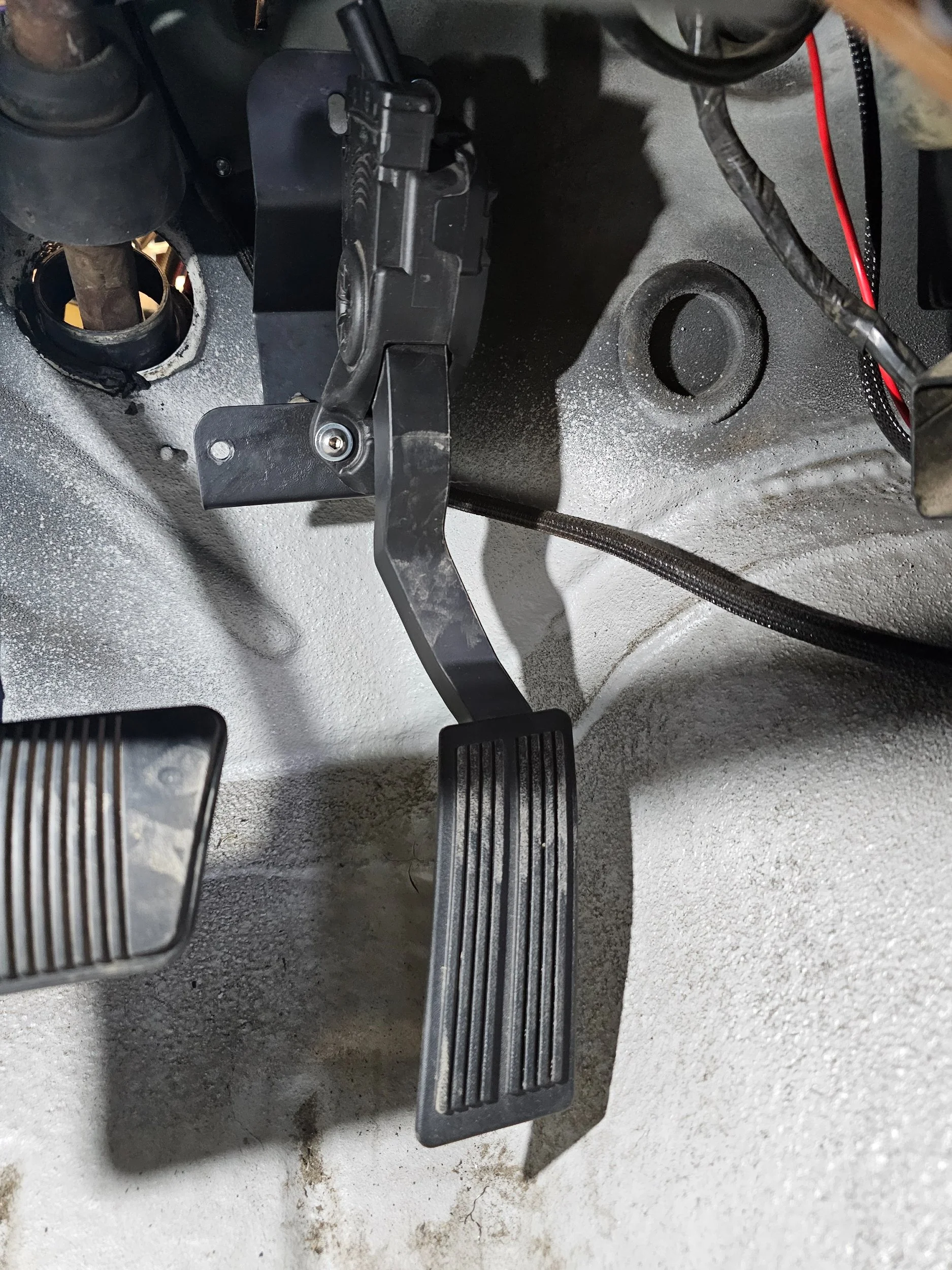

Hammer do you happen to have any pictures or drawings of your fuel pedal bracket? Be nice to have the information here plus I'm starting my Hemi swap and need to make or find a bracket.
Thanks
Sorry for the delayed reply, I didn’t see this until now. This is a very crude pedal bracket I bent in a vice but it’s been working great with no issues. I recently acquired a 75 ton press brake and when I get some free time I’m going to tighten up the bends and clean up the design :()
That’s not crude at all. Nice work.
Reactions: lBasket and Wildman
Even got speed holes!
Reactions: Wildman
As others have already stated that isn't crud.

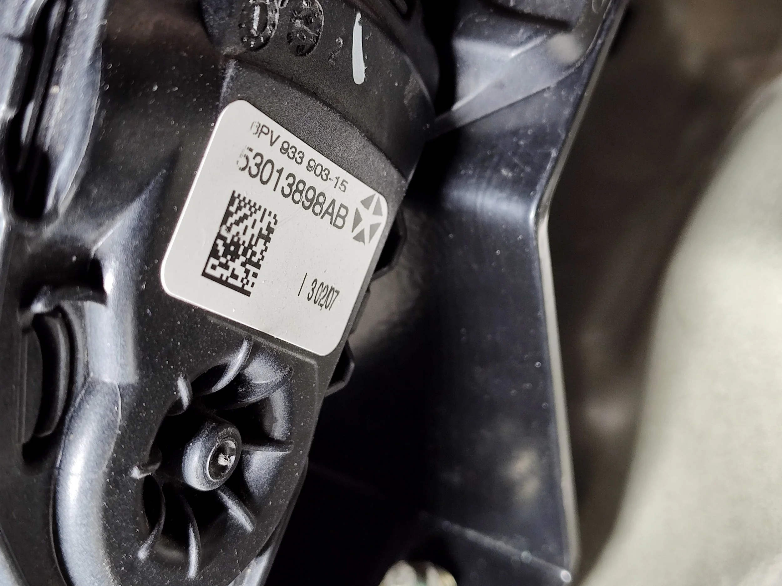

It looks like you are using the GC SRT pedal.

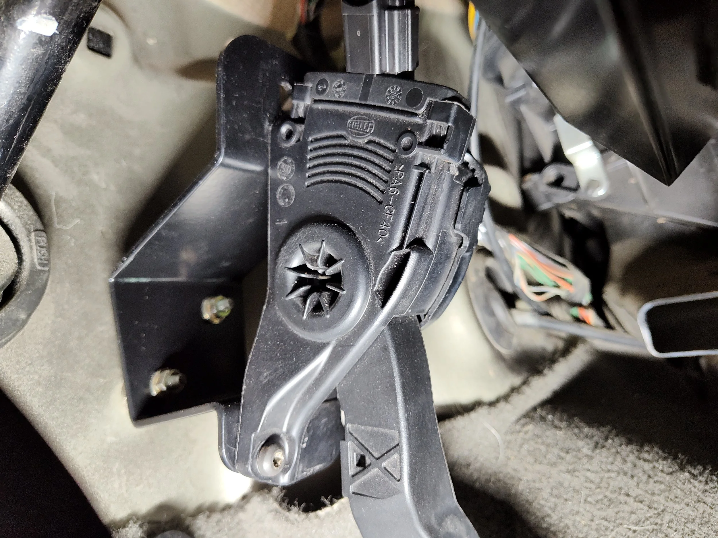

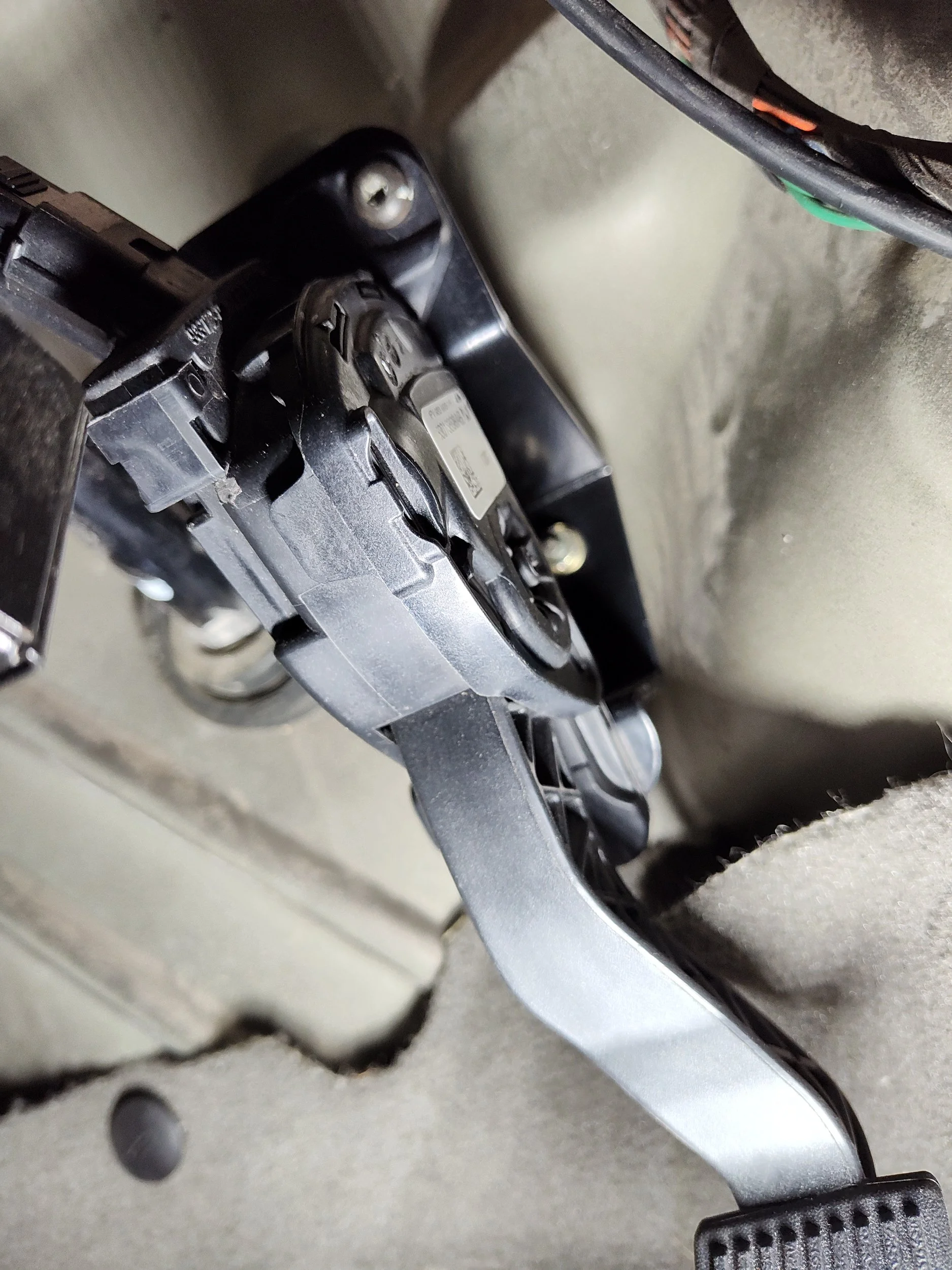

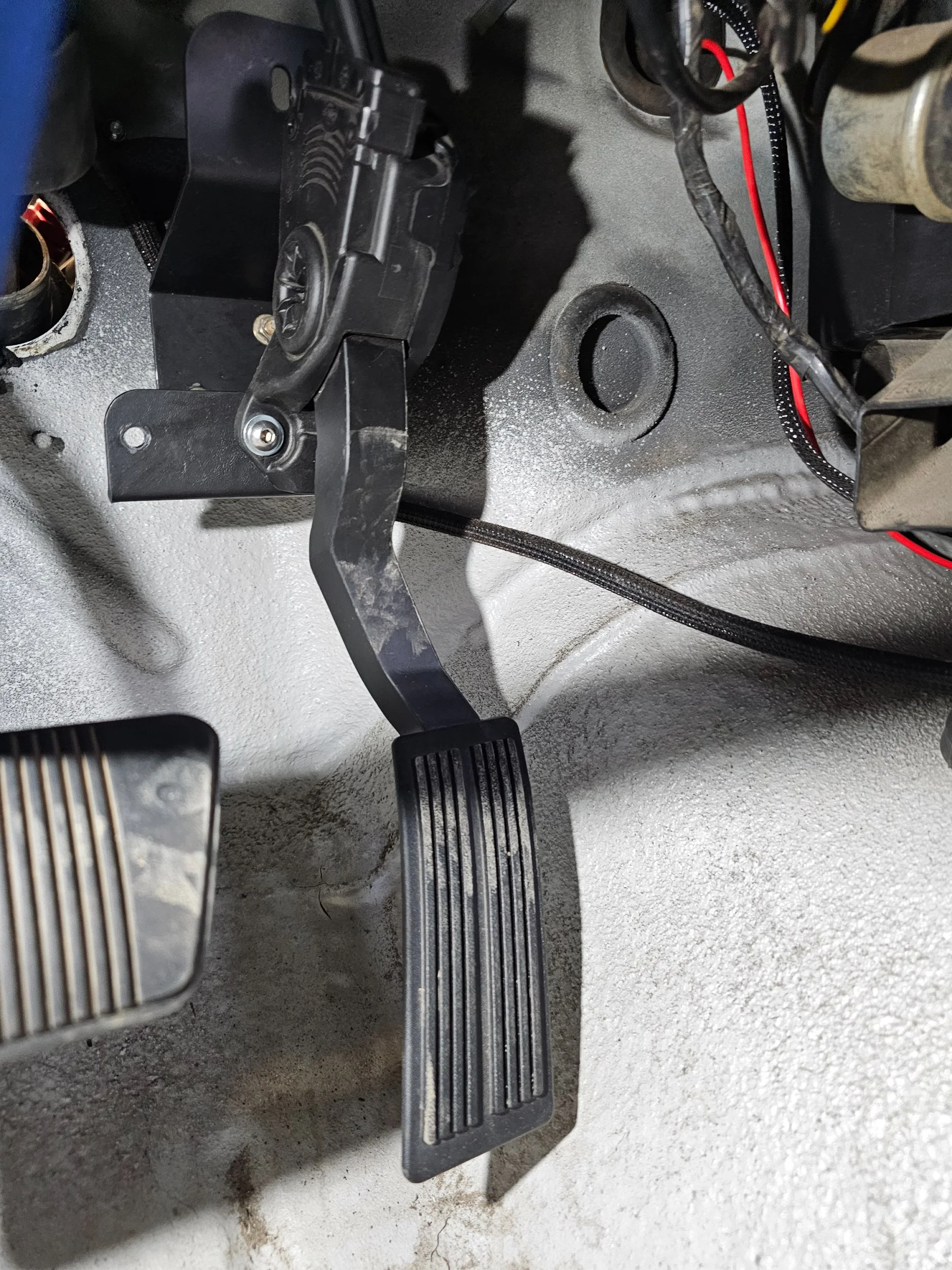

Don't know if helps anyone or not but I just tried to take some pictures of my pedal mounted. Hard to get good pictures because of space and lighting.
