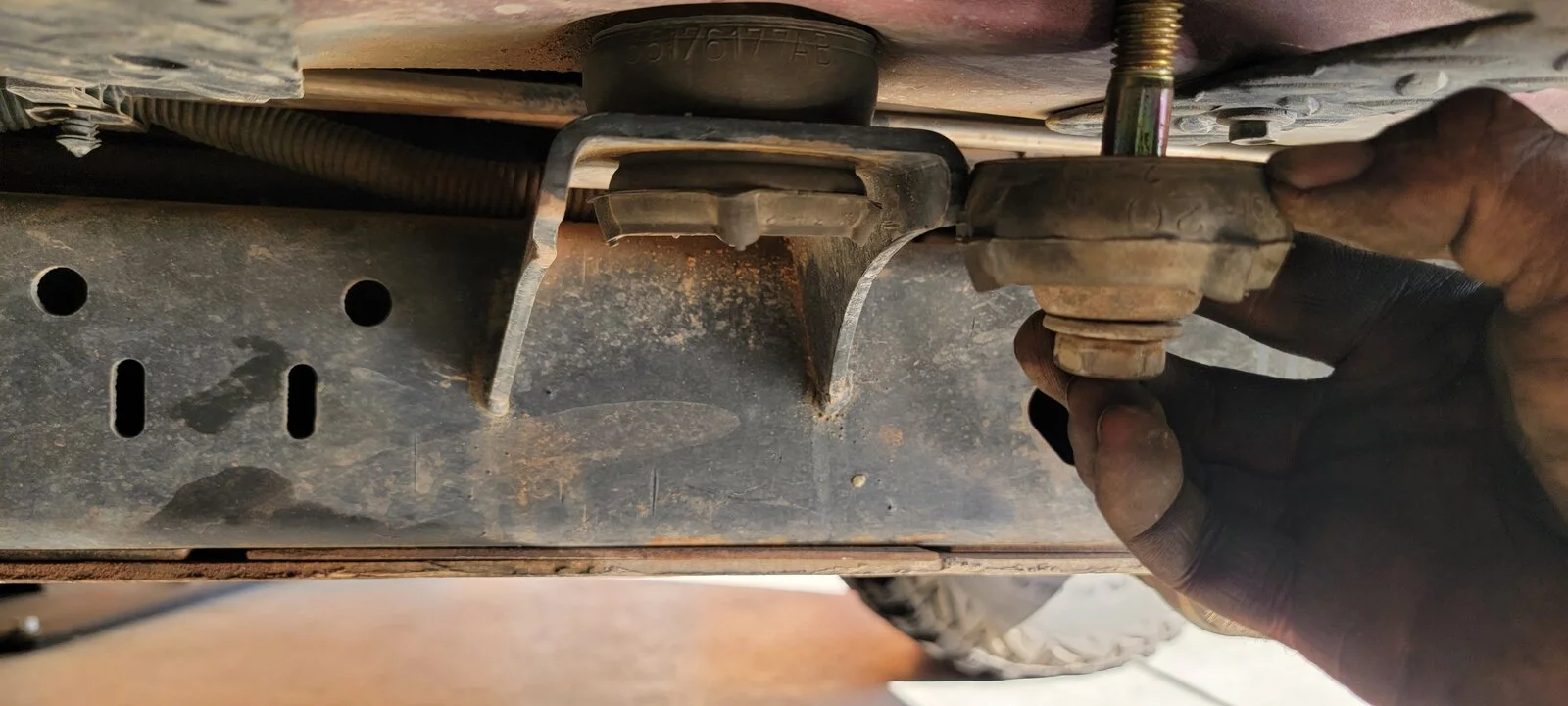

You can't hit what isn't there. Here is a Genright raised body mount with a modified smaller lower body mount isolater. This is as high off the ground as you are going to get and still have rubber between the body and frame. A mini boatside slider is coming.

How do you get/modify that smaller isolator, and does it change the bolt length? If so what bolt size/length would I need to use them in that combination?
