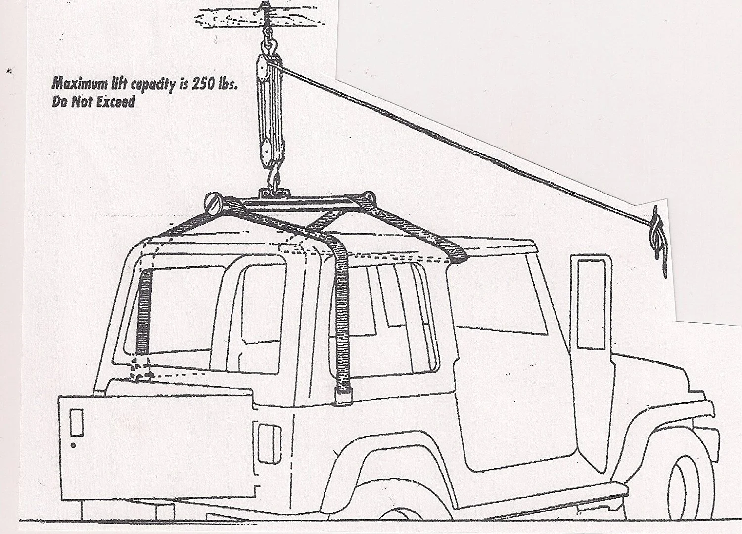

My boss was given a manual hoist setup (minus a few key parts). Does anyone know where the correct straps for this might be bought?

My boss was given a manual hoist setup (minus a few key parts). Does anyone know where the correct straps for this might be bought?View attachment 34390
That's the kind of rope hoist I use. You're kind of on your own for the straps. You should be able to find ones that are adjustable at most auto parts stores, hardware stores, Walmart, Harbor Freight, etc.

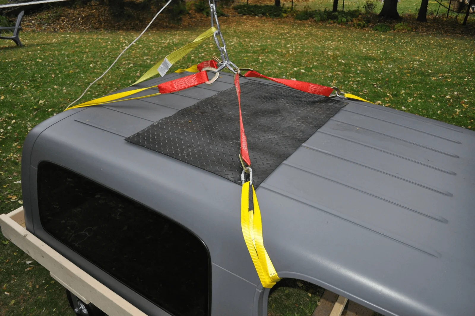

Here's a pic of my straps if it helps. The red ones are axle straps The yellow ones are ratchet straps.

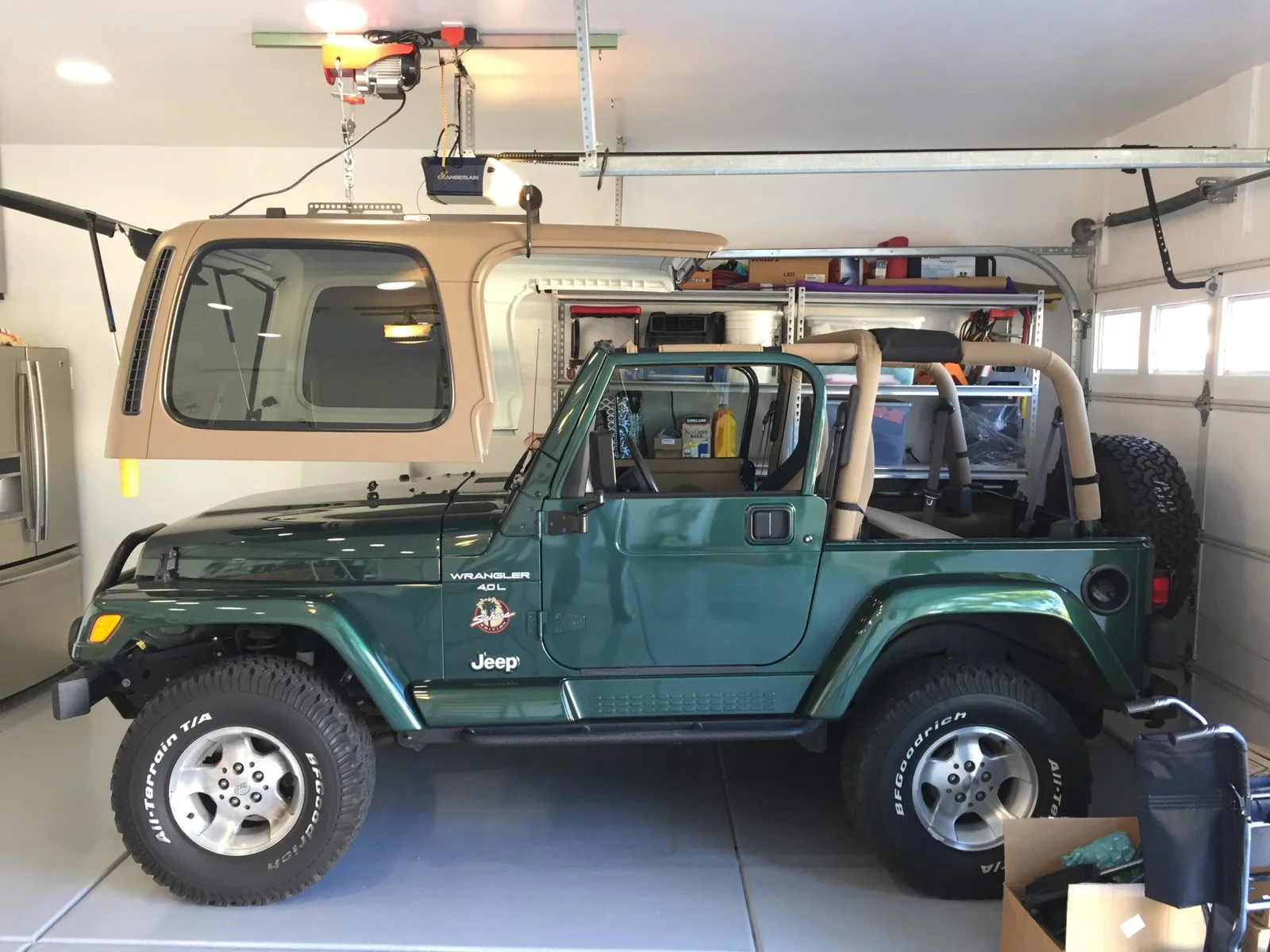

I was considering the Lange, but now I think I'm leaning towards the Harken.
The fact that the Lange only has one ceiling mounting point concerns me not really because of the weight, but because if you accidentally bump the hardtop, it could spin around and hit a wall or something, breaking the class or damaging it. Am I wrong?
The Harken has numerous ceiling mounting points, so this isn't possible.

I never had that issue, and believe me, since I have a somewhat low ceiling in my garage I've banged my head on it more times than I'd like to admit and it never spun much.
It takes me about 15 minutes to put on / take off the top by myself.
