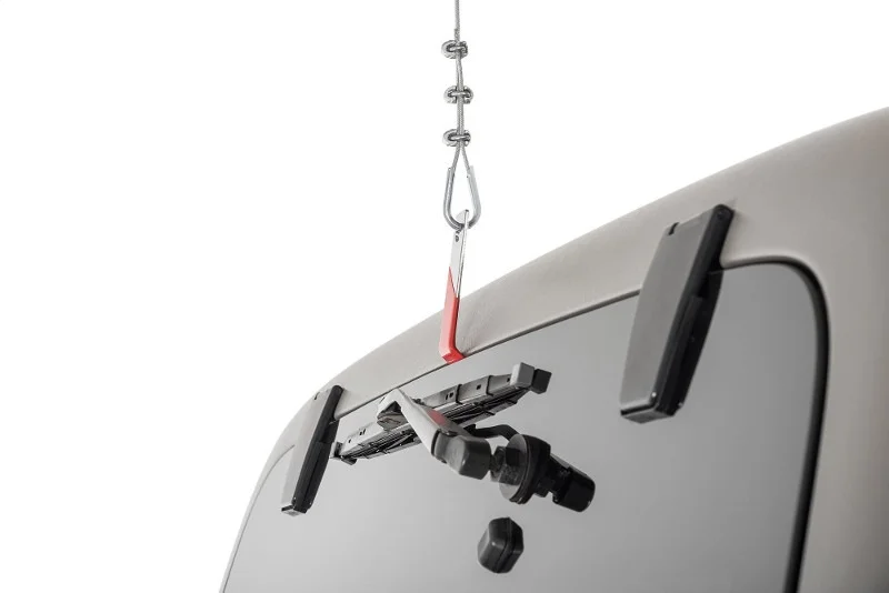

That was my #1 priority because of limited ceiling space in my garage. I wish I would have taken a picture before I put the hardtop back on a couple of days ago, but I can assure you that it worked great.
This 'J' hook fits nicely between the glass and the top with now stress on the glass. Just open the window, slide the hook in and close the window.

Here's a pic I found online ...
Ahhh, I think this sold me on the Lange then for sure. Being able to close the window is a big deal. Our garage doesn't have high ceilings, and I'll sleep a lot better knowing the window is closed and out of the way, especially since I've got other stuff mounted on the ceiling as well (i.e. a punching bag).
Looks like the rubber coated hooks protect the hard top finish as well?

...Being able to close the window is a big deal. Our garage doesn't have high ceilings, and I'll sleep a lot better knowing the window is closed and out of the way, especially since I've got other stuff mounted on the ceiling as well (i.e. a punching bag).
Same reason I got this one ... minus the punching bag :)
Shouldn't be a problem.

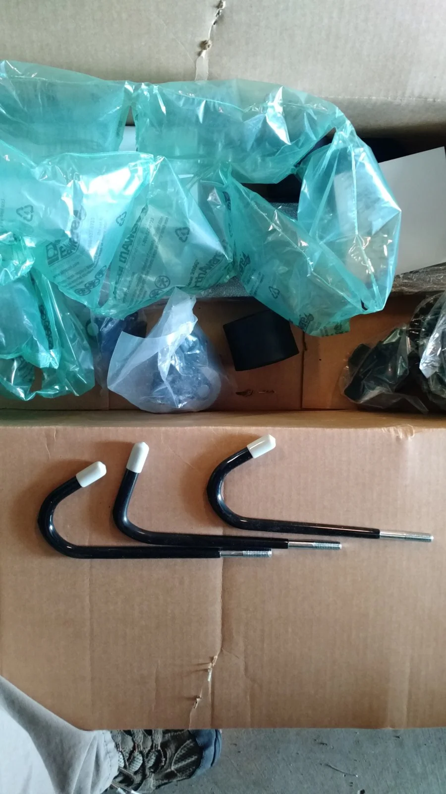

I ordered one last winter. Sure hope it has the "J" hook in the box so I can store mine with the back window closed. That was a big concern for me too. I'm going to go out and open the box.
There should be 2 "J" hooks, red for TJ and black for JK.
