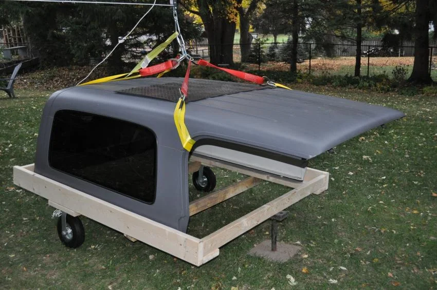

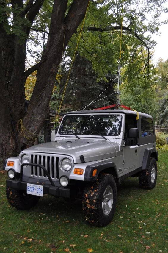

My garage is a workshop and space is limited so I store my tops in the back yard on wood "trailers" that I built. I use a $15 rope hoist to remove and install them. It uses 1/4" nylon rope and has 6 small pulleys. It's hardly confidence inspiring but it works surprisingly well. I haven't been able to find a stronger one of the same design but it wouldn't be hard or expensive to make one.
It also helps to have a big tree! :lol:
