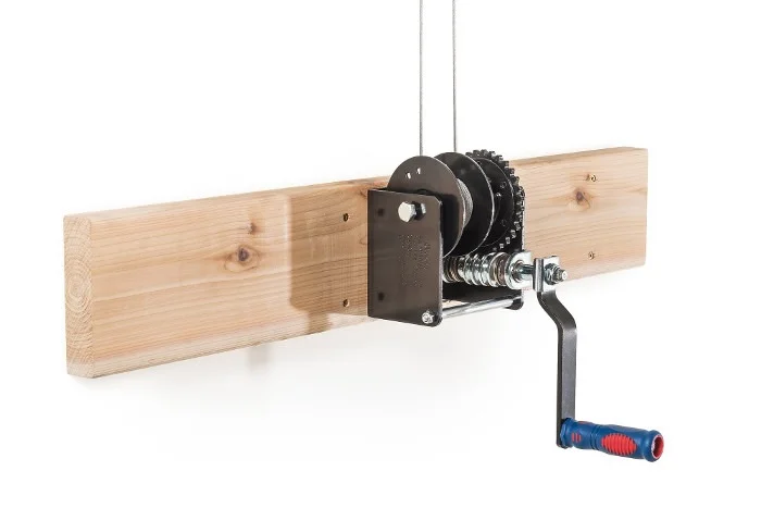

That was for the non-crank version. I ordered the hand crank version, which is why it costs more.
Huh? That one has the hand crank "Lifting power is provided by a reliable worm drive hand crank winch and braided steel cables."
No, that's an error on their part.
https://www.quadratec.com/p/lange-originals/hoist-top-simple-jeep-cj-wrangler
The one they are really selling is this one:
https://langeoriginals.com/products/frame-only-for-jeep-wrangler-cj-yj-tj-1976-2006
Hence the price.
The one I bought is this one:
https://www.extremeterrain.com/lange-crank-hoist-a-top-yj-tj-014488.html
Quadratec is selling the simple version that has no crank or power winch. They just have it mislabeled on their website. That's why the price is so friggin' low. I'm not sure if they realize this... yet.
I could be wrong, but I don't think so. No way Quadratec is selling it for that much less than everywhere else on the internet. I would understand $10 less maybe, but they're selling it for way, way less.

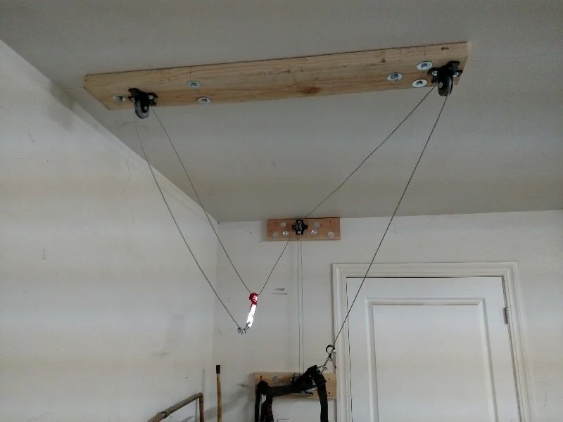

I just installed the Lange Hoist and it works great. Me and my OCD did a little extra to secure it. I used 2X6 backing braces on the other side of each mounting 2X6 and across the studs and rafters just to make sure everything held. I also didn't use lag screws to hold the pulleys on, I used bolts with large washers to stop them from pulling through. I used a spade bit to counter sink the hole for the washer and nut so it would sit flush.
I went with the Lange for a few reasons. 1) It uses cables vise rope and 2) And the main reason is it's setup for keeping the back window down which allows me to store it closer to the wall. Since it's closer to the wall, I angled the pulleys for a side pull. It does have a hand crank, but I use my cordless drill to zip it right up and down.
hi, do you have any issues with the cables not lining up and working correctly on the double pulley due to the other two pulleys being angled in?? I need to do a side mount of the same system but a bit concerned. Cheers!
