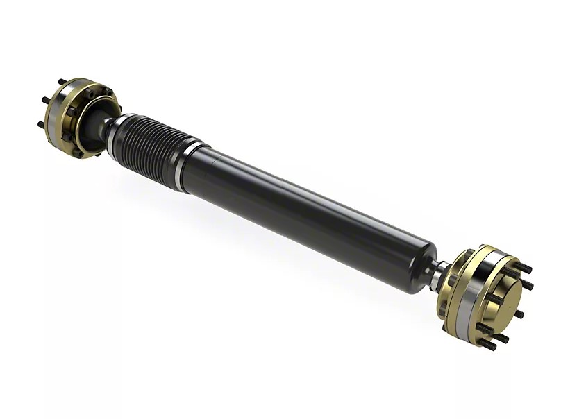

That's one of the comments in my post above... I haven't found any, but can it be built? A few high angle Rzeppa's would cost a bit, but if it was a fix and they would survive, I would do it. Still WAY LESS $$$ than the free spin kit plus new rear axle shafts and a new set of wheels to match the bolt pattern change.
There must have been a reason they went to the Rzeppa’s on the JKs. Is this it?
Is the concern on the Rzeppa the short shafts we have on the TJ's? Is it possibly better on an LJ? I know I was told that most CV's will cook the boot at highway speeds with too much angle on them. But that's what the high angle Rzeppa's are supposed to be good at, right?
Something like the photo below built with Yoke adapters... Can we get an adapter for both ends? Now, since we only have the problem when BOTH shafts are spinning, is it possible that just one of these would fix the problem? Is it strong enough? Would the rubber boots survive?
I know places like Tatton's sells an Rzeppa front for the JK, but it's just 1 Rzeppa. Seems like to solve this, it would need to be both ends.
No one makes a shaft that you can buy readily. I called both Tom Wood and Adams driveshaft and they actually recommended against them for use in a TJ. Their reasons were fast wear and tear and strength. Also .. if you do want to get one made, it will be pretty expensive. I also asked about a double double cardan shaft (ie DC at both ends of the shaft) and they said it will most certainly have balance issues at hwy speeds.
JB conversions makes an adapter. I really looked into this before I decided hub kit was the easier (and better) solution.
http://www.jbconversions.com/products/yokes_flanges/1961.php
