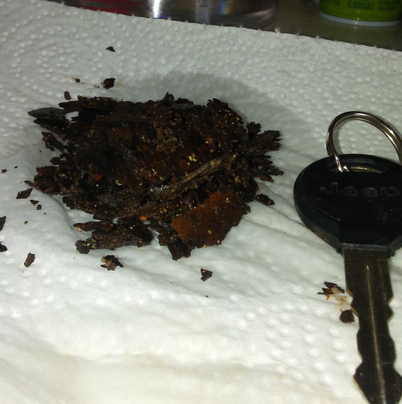

I just finished doing my "rust free" Texas Jeep that only spent 3 years in Washington D.C. Power wash at a carwash that the nozzle was small enough to fit into the frame holes. I got about 3 oz of flakes. Long flexible magnetic tool picked up the larger flakes too. I did this 5-7 times until I couldn't feel any flakes. Coated inside with 3 cans of Eastwood internal frame rust encapsulator, followed up with 2 cans of rust reformer paint.

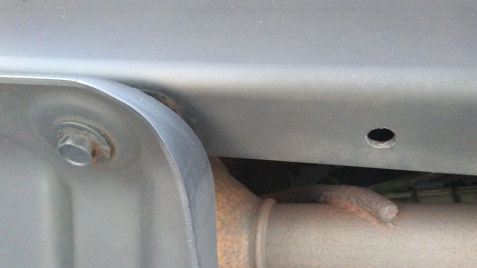

p.s. First thing I do with all my Jeeps is drill 3/4" holes underneath on the frame, about 6" on both sides of the skid plate (where water settles).
