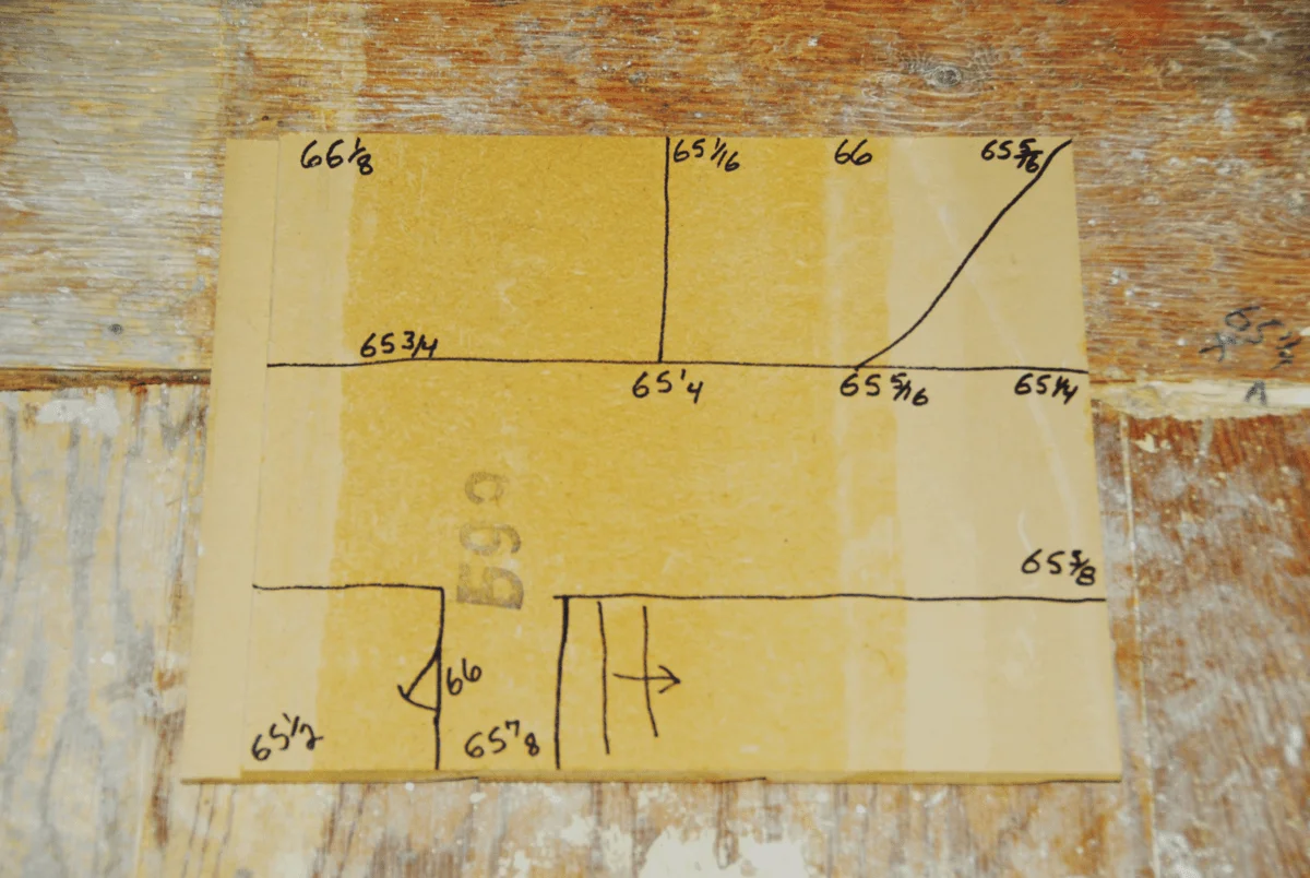

This is the elevations I shot in the living room.

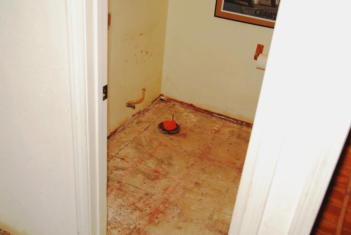

Powder room is drywalled, textured, painted, floor has been leveled, vanity light installed, and it has been coated with a decoupling membrane over the cementitious leveler to prep it for tile. I'm waiting on the vanity and the tile to finish it up.

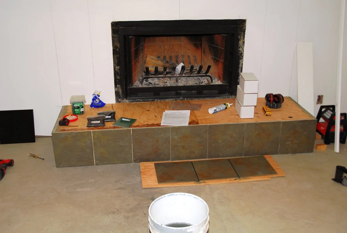

I framed up the fireplace hearth, got the ply on, backer board screwed on and set the tile. Currently waiting on some more grout colors to show up. The sample is a bit darker than I want. They sold our slab for the top of the hearth so we are looking for another piece.

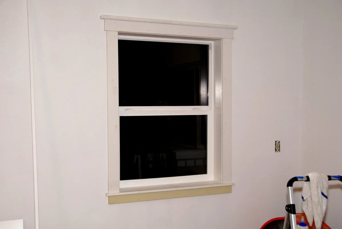

They delivered the moulding last night. I got to play with one of the new windows to see if I liked what I planned and so far it is tolerable.
Now I have to wait on them to come and swap out all but a few pieces for the primed pine I ordered and take back the primed MDF they delivered.

I do a lot of nickel gap and similar 1x trim , I really, really like what you did with the window head casing being wider, that's fixing to happen at my Macon Court remodel. That's tasteful.
Thanks, it has been too long since I did any finish work and even then it was basic base and casing. I wanted something different that was simple yet a bit more decorative than typical casing.
The hard part was convincing the folks at the moulding store that the header across the top has to be thicker than the verticals so there is a reveal. I ordered 113 and 113B which are 9/16" thick and 11/16" thick for the 1/8" reveal. They sent all 9/16's. I spaced that one out with some 1/8" Luan ply I had laying around but I'm not doing that for all of them. As it is, I had to rip one edge on the horizontal piece to get rid of the radius so the top piece could sit flat on it without the radius edge making a gap.
Makes total sense . Looks really thought out, and the extended 1/8 eliminates sanding that joint .

BTW- the internet refers to that as craftsman style trim. There are lots of different examples of it if you do an image search. I struggled a bunch with trying to find a balance between too ornate and too simple. I didn't want this style which is the most common that I found. The second sill piece at the top bothered me.
Looks like the old arts & crafts era with the wider baseboards and trim all around. Looks really good in big spacious areas but can also work in smaller ones. Nice progress.
Yes, the pictures’ craftsman style is what I’ve been doing ..ready for a new look ..what you did isn’t as heavy , and will work better with 8 ft ceilings . What you did looks excellent .

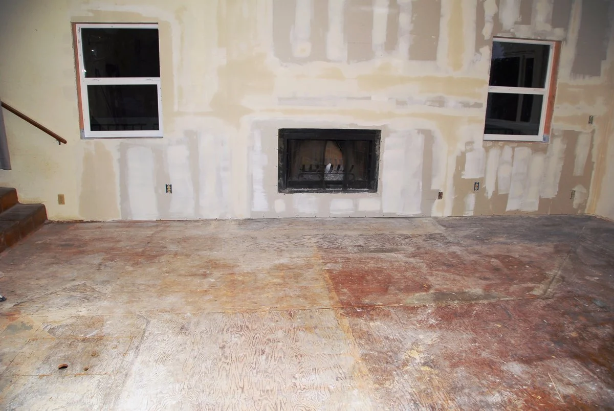

This is the living room front wall. View attachment 132771
We needed to be somewhat stealthy so we had shade cloth and plywood on the outside on the deck railing to slow down the lookyloos. That also meant I needed to hurry a bit on this wall so I demo'd out the tall windows and slider and framed it in. I started on it Saturday early and finished up about 7pm on Sunday evening. The hardest part was setting that 6 x 8 x 8'-6" long header by myself. You can see the old headers in place that I didn't need to remove since they were not in the way of the new window.
