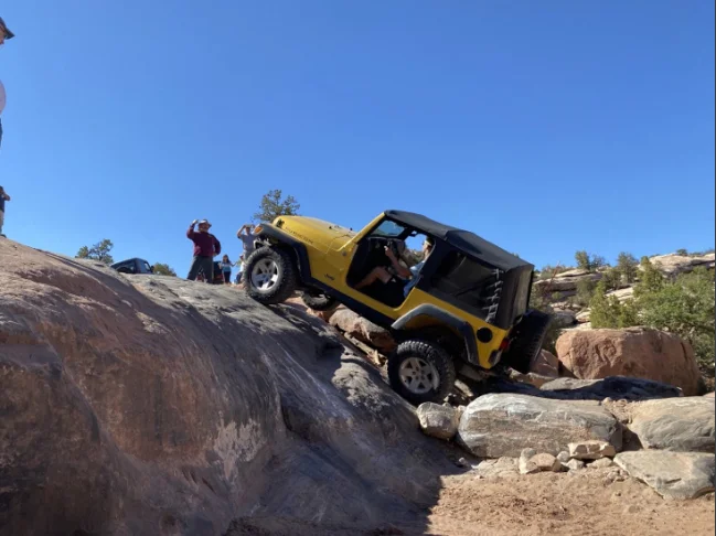

Keeping things simple and light is the way to go. Obviously ground clearance is also important, but there are ways to achieve that without getting too crazy. I would focus on underbody armor first, steering box skid, control arm skids, oil pan skid, and a thicker differential cover. Grab a pair of spare axle shafts and drive shafts, maybe a better tire/wheel combo, but I’d armor up the underbody and take it out to see how it does. You may be surprised.
This was Stolen from July ride of the month thread @SecondChanceTJ. I love this picture and It shows what a mostly stock TJ rubicon can do.
