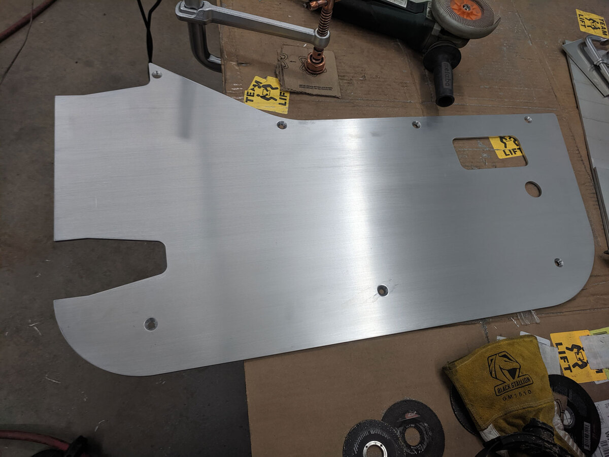

I've been meaning to get armor on the doors for a while now. During my first trip out back in May I tapped the driver's side door in against a friend's bumper going past him on a trail he was stuck on — he was okay with it but I wasn't quite ready for that kind of damage. The next trip out, just by luck, I narrowly missed the door again with a rock that jutted out on a hill climb.
I thought I was taking the easy route by buying Genright's half door armor. And you all know by now how excited I get with kits. Of course the kit had to disappoint me because it seems that they laid out the bolts using CAD instead of using an actual door except at the front where they had some fear of putting a nutsert into the "hat" so I had to place those myself.

Hey what tool/method did you use to follow the profile of your carboard cutout so well on that tub armor. I'm going to do similars when i add the Savvy tub slider, try to get a single rub path like you have.
I traced the cardboard onto the blank panel and then followed up with calipers, scribe, straight edge, angle, to get the lines perfect before shaping with an angle grinder.
