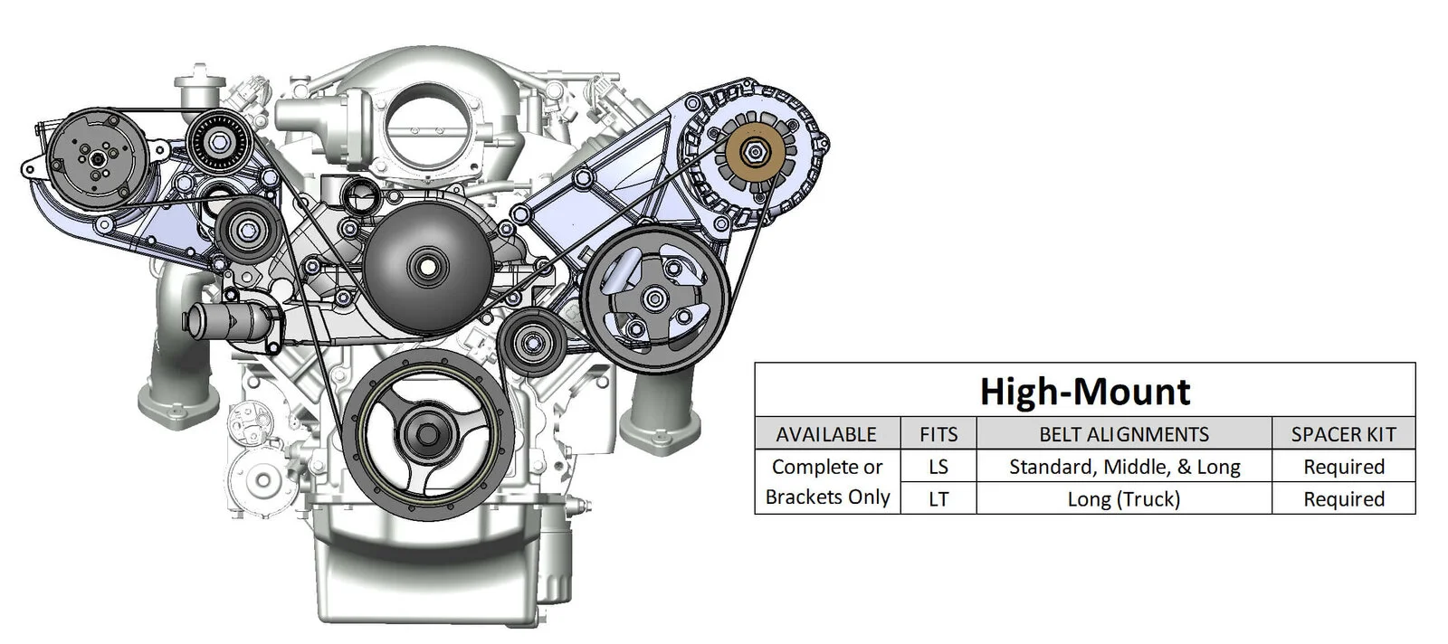

I found this diagram of Holley's 20-133:

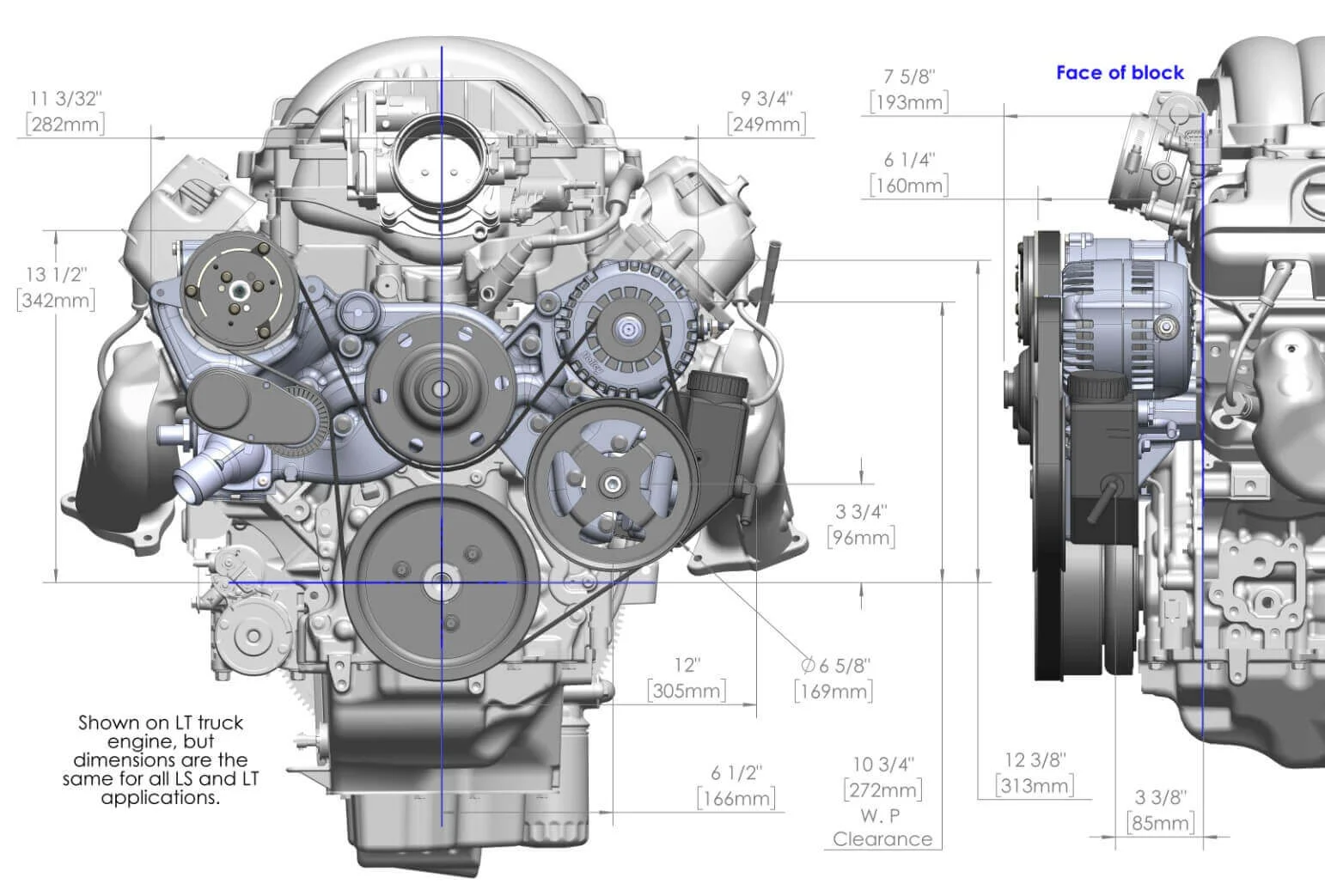

It looks like Dave's Customs Unlimited version is tucked in closer at the expense of requiring truck spacing:

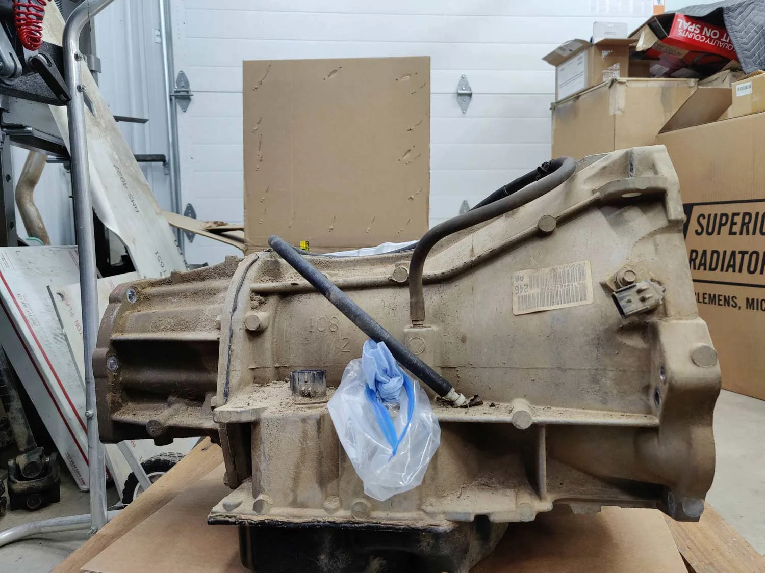

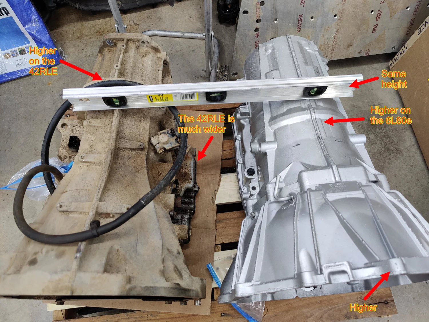

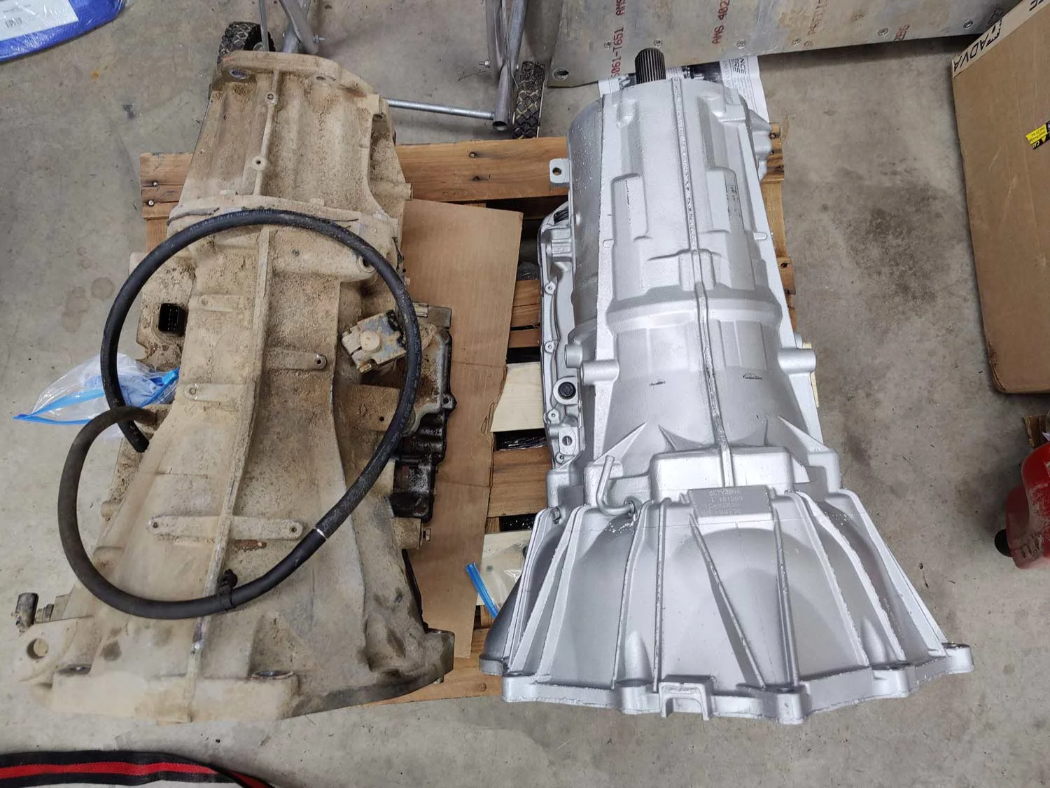

When I was researching the 6L80e I couldn't find any comparisons to the 42RLE so here's some more pictures with them next to each other aligned the same.
This picture is a bit deceiving due to the perspective, but the small area that shows through on top of the 6L80e is the biggest area of difference:
With the pans sitting on the same level surface, the centerlines (ie. input and output centers) of both transmissions are at roughly the same height.

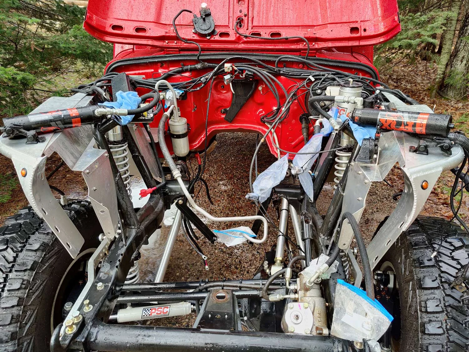

And lastly I washed the engine bay and my garage floor before pulling the Jeep back in:

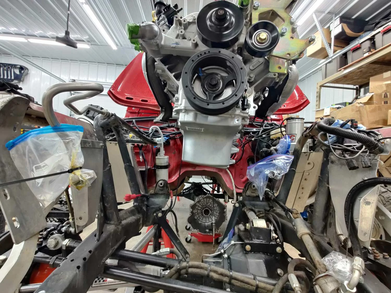

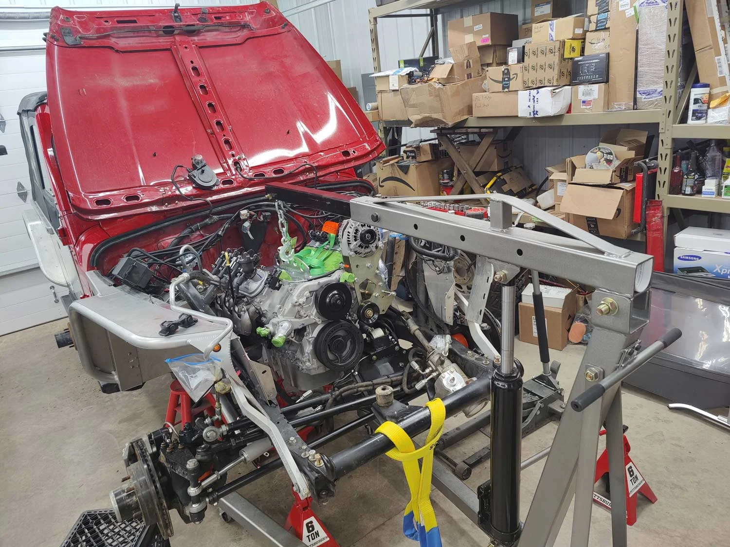

I set the frame at ride height and placed the front axle at full bump and then lowered the new engine down:
I bolted up the transmission and am pretty happy with how it's packaging. The LS is definitely a different shape than the I6. I'll know a lot more how it needs to sit once I get the Atlas in the rear.

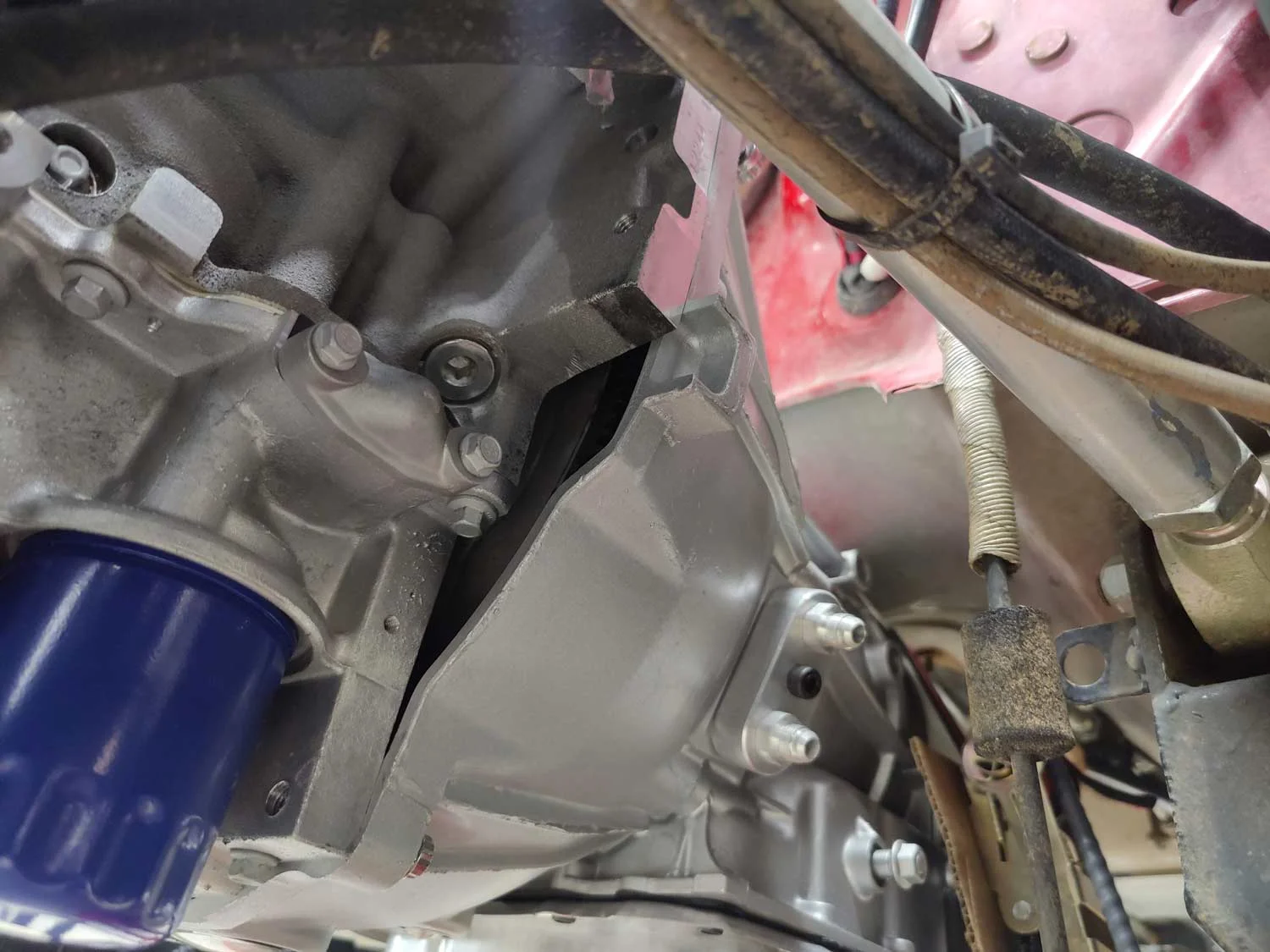

I need to find a cover to fill this gap between the engine and transmission:
