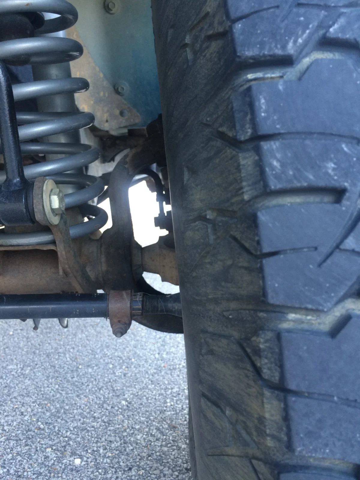

How can I fix a bent C knuckle?
my driver front side C knuckle that's welded on the axle has bent. Does anyone have any suggestions on how to fix it?
Id rather not replace the entire axle. It's still drivable but it's very noticeable
If you REALLY dont want to replace the housing, get an offset ball joint, just rotate it to kick the wheel out instead of correcting caster. Then weld on a gusset...

Hello, A shop told me that had just replaced my drag link after a case of the death wobbles. It is hard for me to see visually, I'm not all that mechanically inclined. But it appears the driver tire is angled. I have outside edge tire wear and constant pull that no one has been about to solve. I recently, bent a steer smarts tie rod which has been replaced but I believe that this is when my C bent.

It needs to be tossed on a good alignment rack with someone other than a fool at the controls. The read out will tell if it is able to be adjusted with a set of adjustable ball joints before you head down the road of replacing the inner C. If it is within 3 degrees of correct, ball joints will fix it.
Has anyone checked the squareness of the front axle to the frame and made sure that there are no other issues causing the pull?
I would get it to an alignment shop, that will tell you if it is actually bent, I would be more inclined to believe it is a ball joint problem.

Yes, I was told that the axle is square. Thank you. I will see about getting the alignment specs and see if the ball joints might work out for me now that I know it has to be within 3 degrees. I was reading on offset ball joints earlier today.
