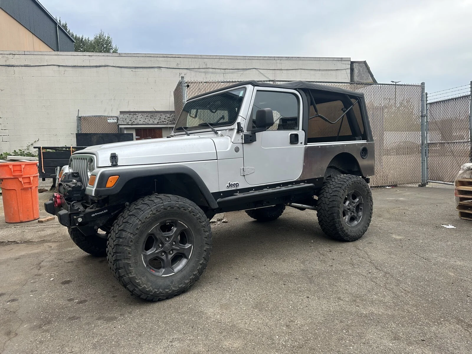

After looking at this photo I thought you were right, but it turns out it's just because the frame narrows toward the front so it looks like the frame draws up under the tub. I measured next to the LCA mounts and just like the tub, it's 1/16" higher in the rear than the front (20-1/16 in the front, 20-1/8" in the back).

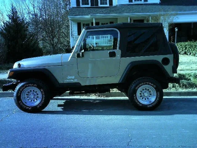

I don't have any truly flat ground to take a photo outside, my garage is too messy to be able to see the whole thing, and my cell phone camera is skewing everything, but this photo, while it doesn't look squatty, does maybe shed some light on why my brain is interpreting it the way it is.
1. The frameless top slopes toward the back, as can be seen comparing it to the line between the topmost panels on the garage door.
2. The rear wheel arch is about 3/8" lower in the back, which looks squatty next to our 4Runner, where the rear arch is higher than the front by 1-5/8".
At some point I might load all my gear back up and take another set of measurements to see how much it sags in the back. At this point though I think I've convinced myself that it's just my eyes playing tricks because of the roofline and the comparative wheel arches to the other vehicle that I often see it parked next to, so maybe I'll just leave it alone.

But it LOOKS like it's squatting. I would have sworn it was half to a full inch lower in the back but I can't argue with the tape.
IIRC, the flares are thicker in the rear.
This helps hide the factory rake since your eyes focus on the space between the flare and tire.
If you remove the rake, it will look like it's squatting.
A good place to measure is to the top of the flares (with a level).
