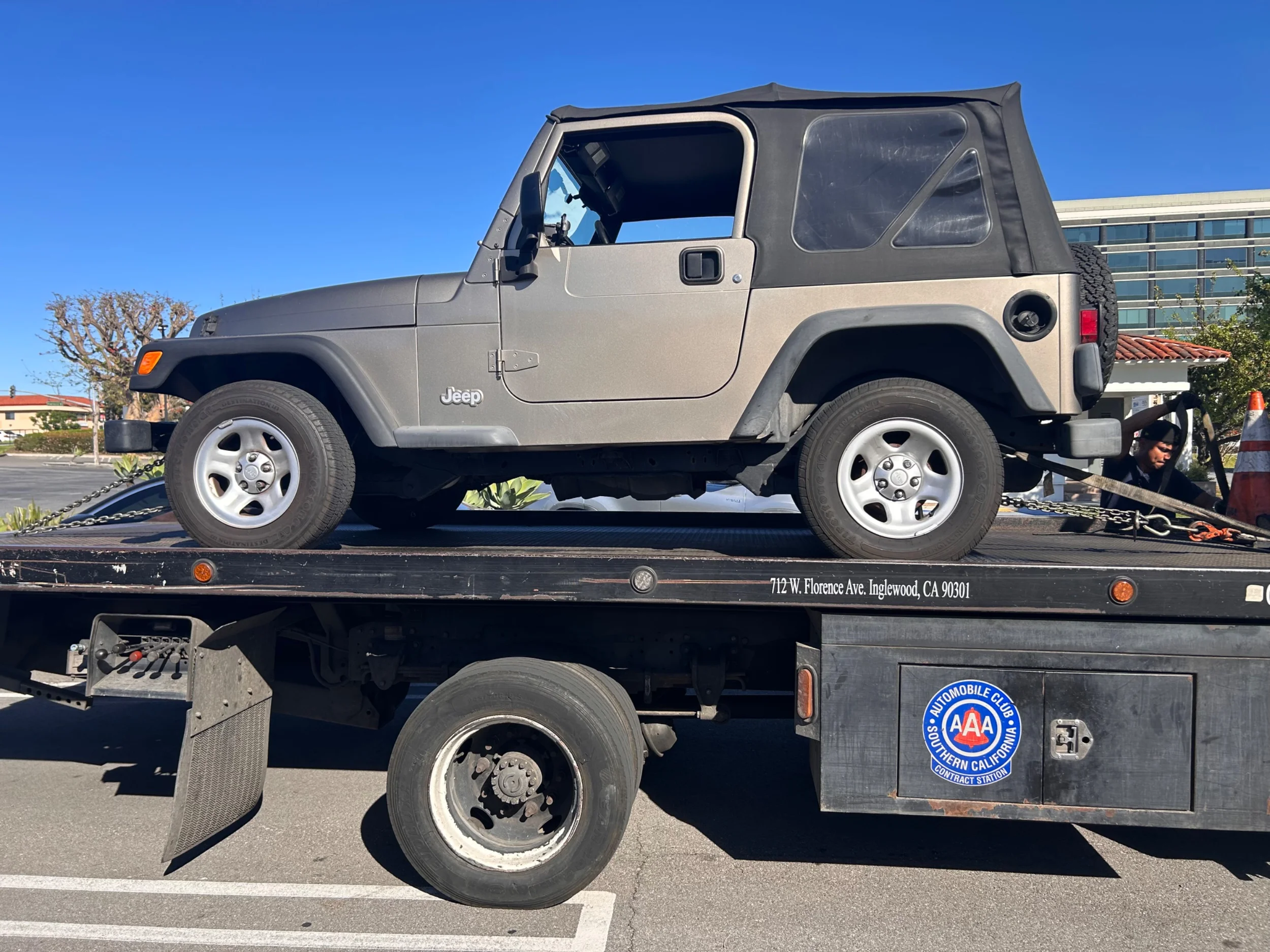

@macleanflood @hear idle gremlins update. Got her back from the mechanic. had a smoke test done and all the electrics checked. did a throttle sensor re-calibration. Found a leak by the evap canister. picked her up and the idle was good. dropped below 700 a couple of times. But she drives great now. called them about the drop and they advised, if it goes batty again, its the ECU. what do you guys think? gonna check her out for the next few days and see what surprises, if any, come up. Cant wait to get to the point of driving without the fear of a stall.
my 2001 4.0 idles at like 500rpm when warm, if it idled at 700 warm I personally would be looking at my throttle mechanism to see if something is causing it to be open a hair, but 700 may be normal for you
